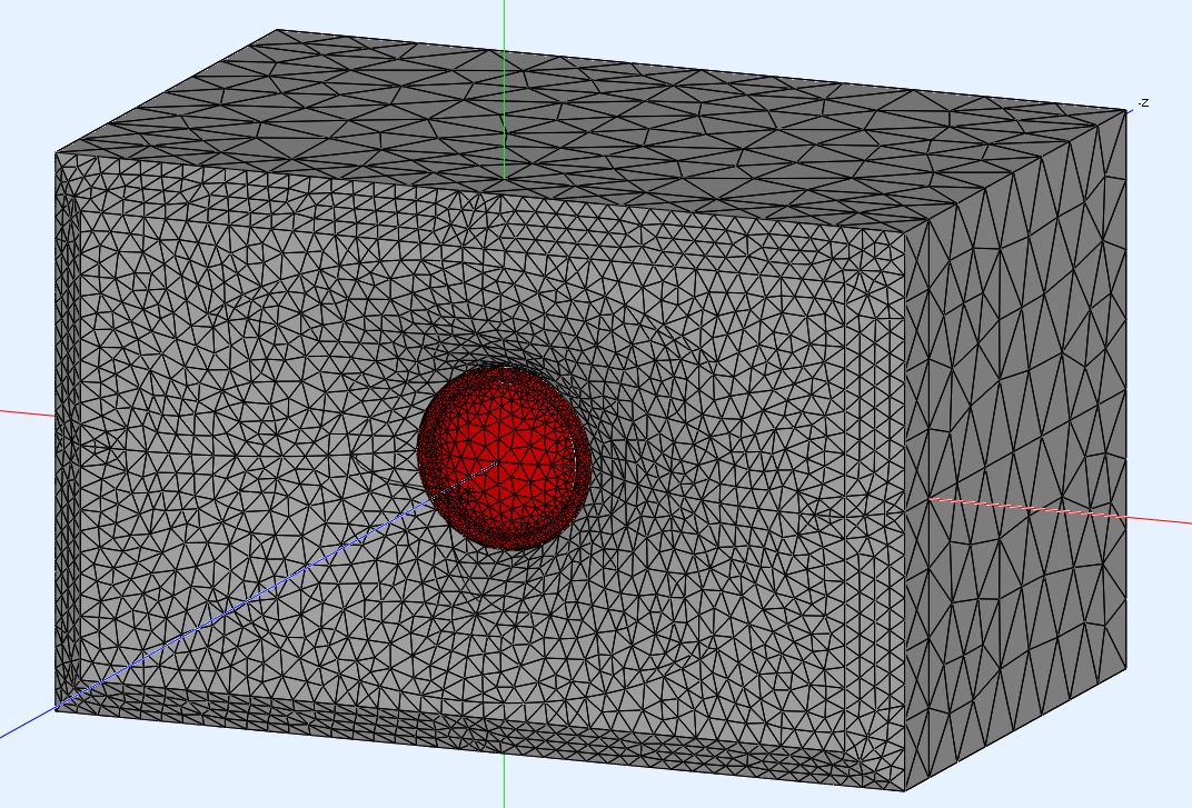

In your simulations are you simulating the woofer as a reflective boundary? This is what I did but it is not accurate as a woofer is not a totally reflective boundary exaggerating the effects, ABEC is not as comprehensive as COMSOL in these terms even though damping can be added in ABEC I would be guessing what amount use for different surfaces and it would depend on the construction of the driver and materials too.

Yes, I have assumed the woofer to be a hard reflective boundary. The multiphysics nature of COMSOL indeed offers a lot of possibilities for other kind of implementations... I should probably take this back to my project thread not to stray this discussion more than I have already done.I believe so, I did not specifically simulate the vertical. In previous simulations of the waveguide in the baffle both the horizontal and vertical were affected by including the woofer as a boundary. In the freestanding the horizontal was virtually unaffected. As long as there is some free air around the termination it is effective in both directions. It would not be easy to make an MTM like this but it could be done.

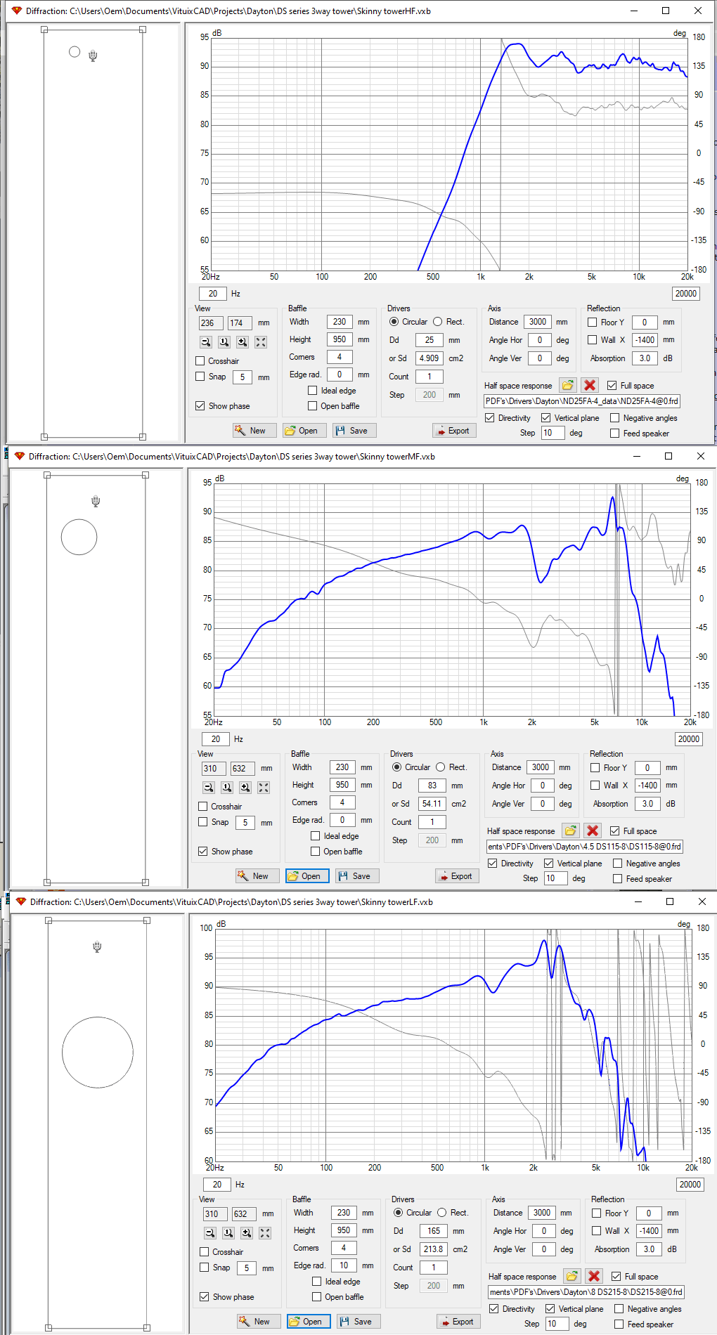

How do you go about simulating multiple drivers in the diffraction sim? I tried two drivers in the baffle, but could not make them different sizes. Is there a way place the drivers of a 3-way and move them around? I'm thinking that some diffraction effects in XO frequency range could compensate each other (small bump in tweeter response compensated by a small dip in mid response etc). Ok, it wouldn't be perfect in all directions, but maybe worth considering?
I'm thinking the same for FR for drivers, a dip in the response could maybe partially be compensated by a small hump from diffraction?
I tried loading some frd's in the diffraction sim, but can't get the to show in the graph. Could be scaling, or something else.. I can't find a way to change the dB scaling in the diffraction sim. Is it at all possible to use a frd as baseline and apply diffraction effects to that? I missed that functionality in Edge.
Seems making steep angles like 35deg next to the tweeter would be hard on a wide baffle 🙂 Maybe with a piece of MDF slapped on the wide baffle, but then again that would most likely measure completely different.
Re mulitway baffles, you need to do each passband individually like in the attachment. You also need the "fullspace" button checked to see the effects of the baffle on your selected frd file.
HTH,
David.

Just an FYI.....if one were to model the above as separate cabinet spaces.....VituixCad will still see all the baffles once positioned within the xover details.
Yes, David Morison is correct, we must do a baffle sim for each driver. If we want to apply the baffle sim to the measured or OEM-traced response, then we have to check the full space button and give Vituixcad a pathname to the response curve. If we are using ideal driver responses, the full space button is greyed-out.
