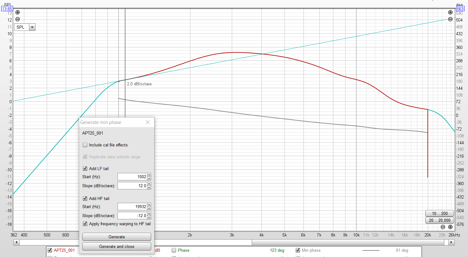

A Hilbert transform or other method for generating a minimum phase response from a magnitude only curve is a reasonable way to go. I haven't worked out yet if it is just a data to plot issue or if the simulation borks the phase in some way for some reason. My main interest has been in looking at the directivity which isn't affected so I have put zero effort into working out why so far.Understood... and if phase is useless, the VituixCad simulation will not be valid. I would have guessed that you could estimate the phase based on the magnitude, using Hilbert... but honestly, I know so little about waveguide simulation I am just guessing.

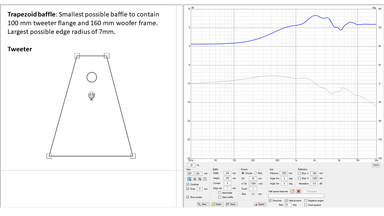

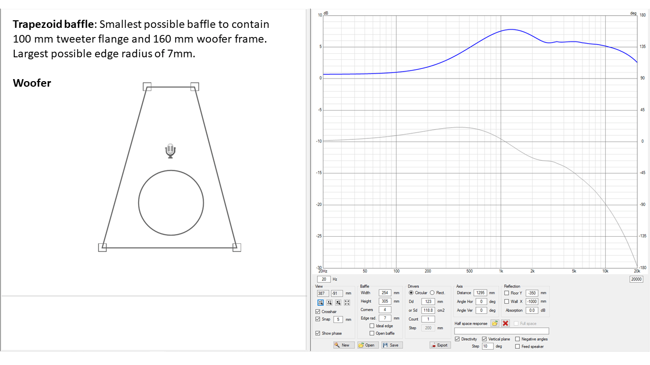

This next simulation is an example of making the baffle as small as possible. I am once again assuming that the tweeter we like has a 100 mm flange (very common), and our 6 inch driver has a 160 mm frame size. I want to stick with shapes that a reasonable craftsmen could make from sheet stock in a home workshop, without needing a CNC machine. So a trapezoid shape seems the most straightforward way to get the baffle as small as possible.
The baffle in this simulation is just big enough to encompass a 100 mm flange tweeter and a 160 mm frame midwoofer. There was just enough space left on the sides that I could accommodate a small roundover (or bevel) of 7 mm.
As we can see, the tweeter response is rather ragged, and I was skeptical that this sim could be salvaged. This is a result of an almost hard edge... 7 mm radius is not much, and we clearly get a lot of diffraction off that hard edge so close to the tweeter... The fact that the sides and top are nearly equidistant to the tweeter does not help at all. However, the final result was not too bad, and I was a little surprised at how well it turned out.

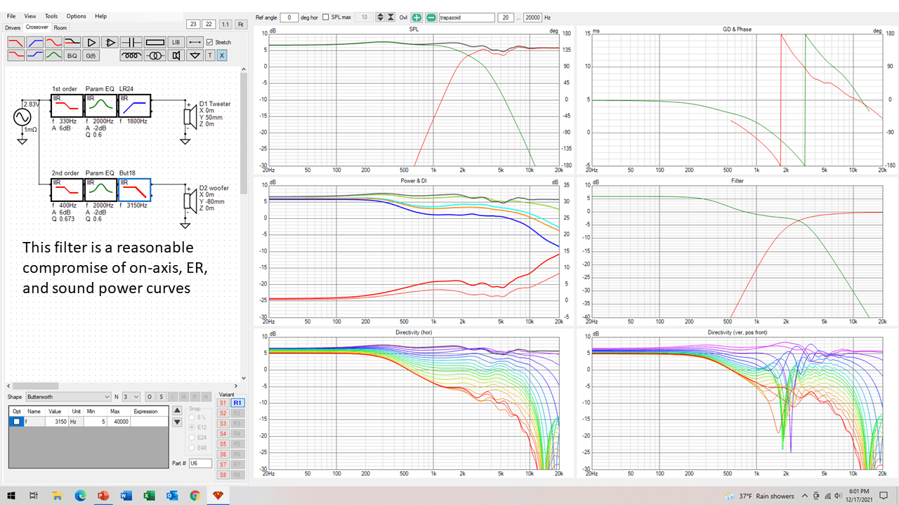

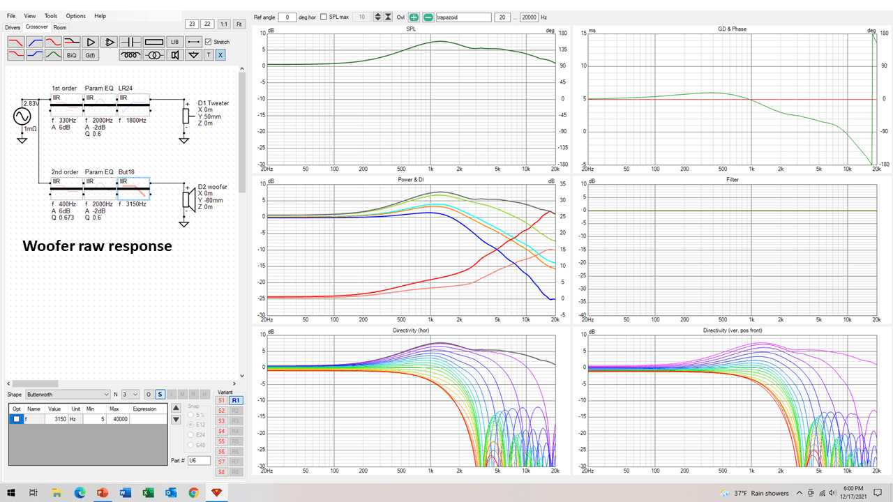

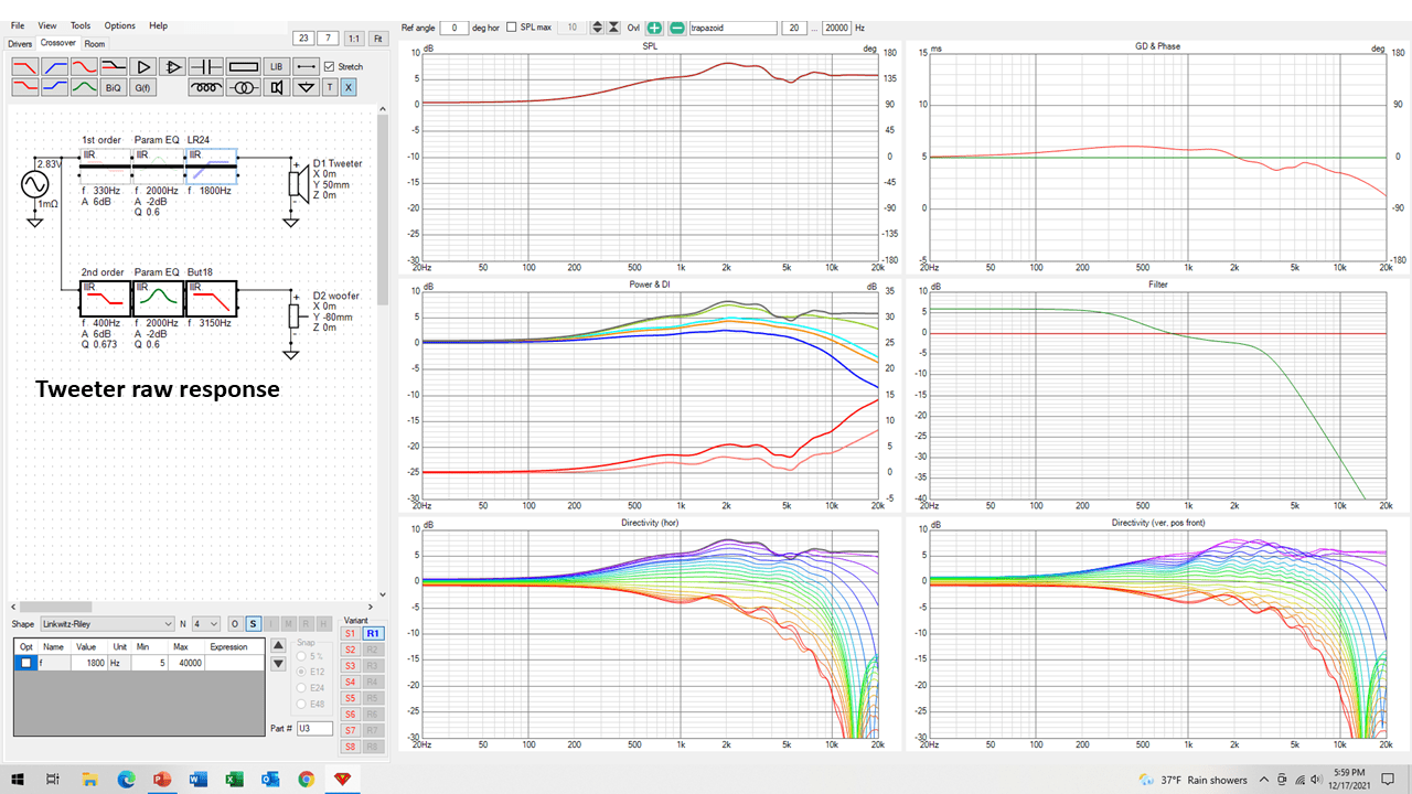

The best filter I could come up with uses a 3rd order on the mid-woofer, and a 4th order on the tweeter. At first I had the woofer filter modelled as a 1st order and a 2nd order cascaded, this providing me with a lot of flexibility... but a simple 3rd order BW ended up doing just fine.
Comparing this to the first sim in post #3, I conclude there was no advantage, in this particular case, of making the baffle as small as possible. This particular trapezoid shape did not seem to have any advantage over a rectangular shape, and the very small edge radius was a notable issue.

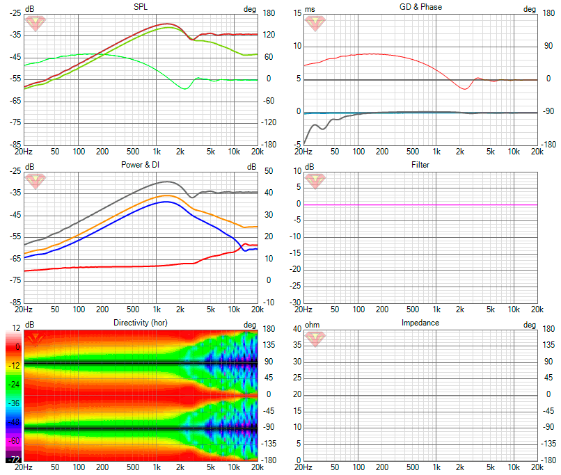

😮‼️ This suggests John K. with his NaO Note II RS, S. Linkwitz with his LX521 & Jorma Salmi with the Gradient speakers all were on to something long ago. Those minimal baffle designs did not feature, in general, rebated drivers nor rounded baffle edges.if the baffle is minimized the bulk of the diffraction is removed
The directivity of the LX521 and Note II being dipole over a large range also contributes as they effectively have 90 degree front radiation much like a waveguide helps reduce the effects of edge diffraction.This suggests John K. with his NaO Note II RS, S. Linkwitz with his LX521 & Jorma Salmi with the Gradient speakers all were on to something long ago. Those minimal baffle designs did not feature, in general, rebated drivers nor rounded baffle edges.
I think they all suggest crossing dipole drivers below the dipole peak, which I think they refer as peak caused by ideal dipole, since it is practically same as main diffraction hump with open baffle or boxed speakers and I would call it just diffraction peak 😀 But I only know what I saw in simulator, not much theoretical background on any poles.
Same trick can be used for boxed speakers as well, crossover below diffraction interference to another way. It just makes more ways to the system, which adds cost and complexity but gets rid most of diffraction. Still, there would be case with the tweeter, which you cannot crossover to another way above anymore, but for tweeter one can use very good waveguide, wink wink.
As sidenote I think open baffle speakers have worse diffraction interference, since the back wave diffracts too. At the baffle edge, the backwave has inverse polarity and diffracts around the edge towards listening position. This sums constructively with the front wave edge diffraction created secondary sound source, which is also inverse polarity towards listening position, making the effect worse. I think this was explained on some other thread but too tired to search for it now. The effect is seen in VCAD diffraction tool as well, the hump gets bigger and dip deeper when you engage "Open baffle" checkbox.
Here ideal monopole, dipole and some emulated cardioidish patterns cycle in single GIF animation, all with (practically) same size baffle and transducer. All of them have diffraction hump and dip after it.
