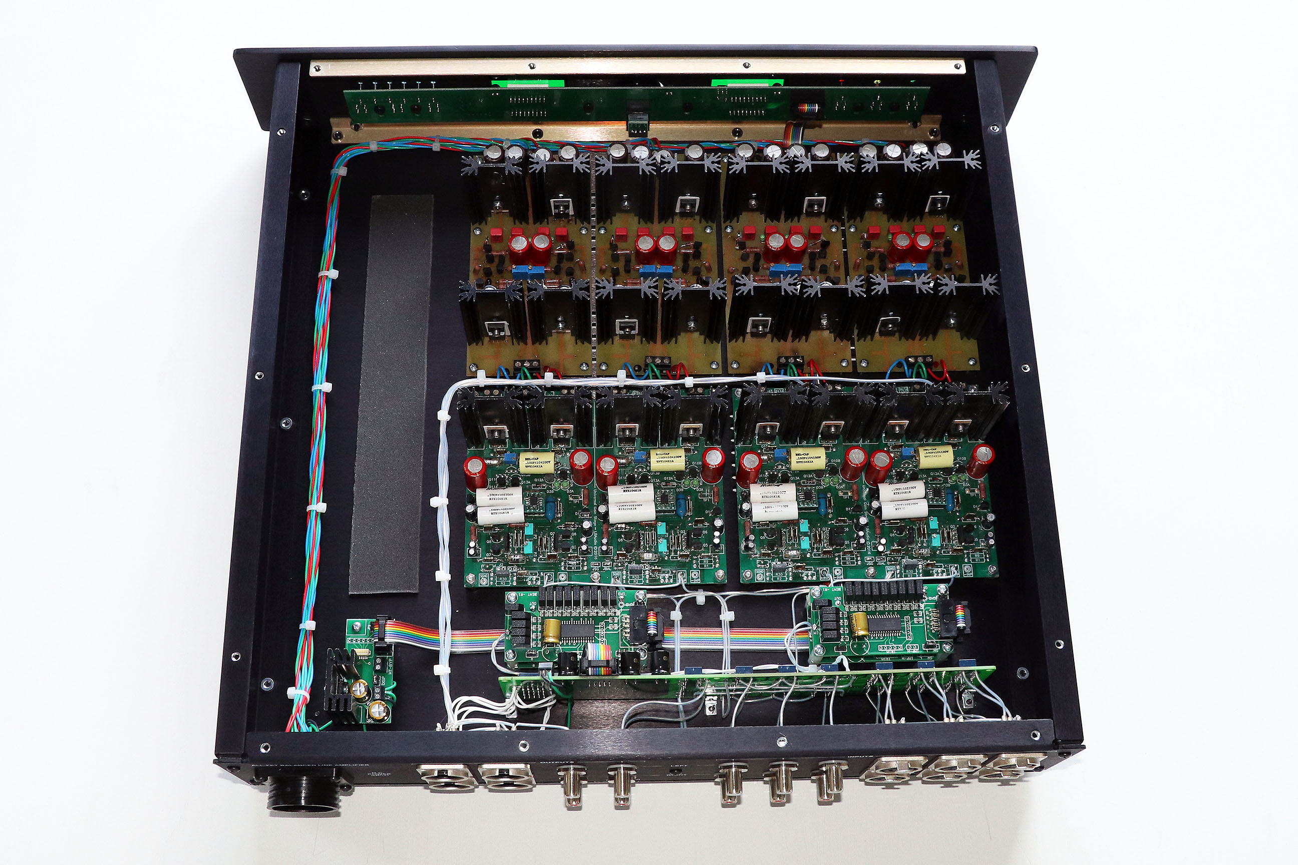

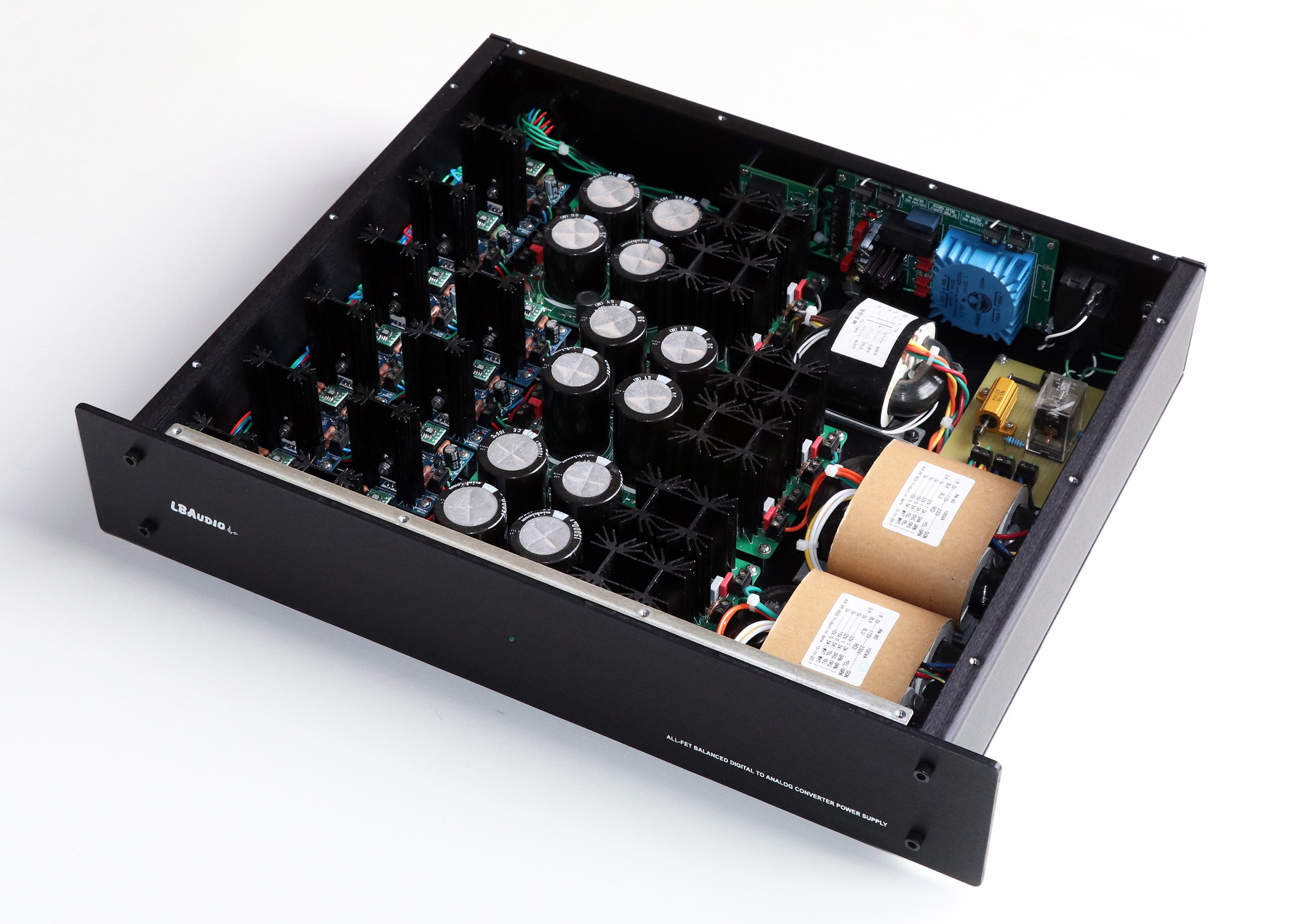

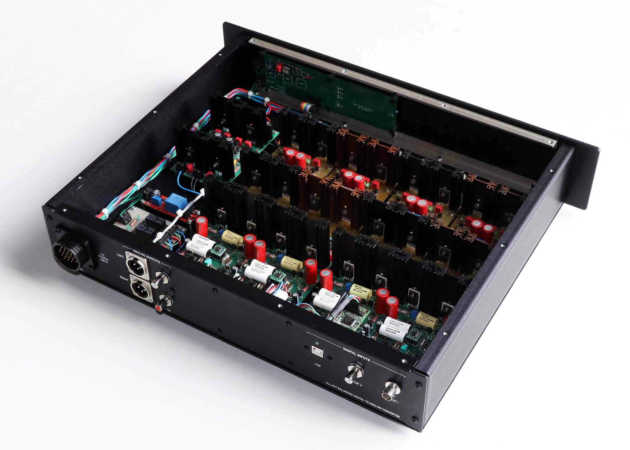

Dac with TX 2575 resistors
All discrete balanced jfet fet, direct coupled, single stage IV conversion with 80 ma output stage, jfet shunt regulators, Dale resistors in non signal path. Vishay bulk foil trim pots, teflon bias bypass caps, over 50 Blackgate N caps. 8 x BB PCM 1704K dacs in dual differential mode. Separate power supply chassis with Jung regulators used as pre regulators for the shunt regulators, 200,000 uf, Quasimodo snubbed hexfet bridges, R core transformers. Matching preamp and phono stages to the same build. Extremely resolving and smooth.

No, got them from Texas Components. Cheaper.
I previously used Holco non magnetic, then Vishay VTA ,and Caddock 132.
I tried the TX 2575 and found them more resolving, but maybe not the best for a power amp output stage as was suggested.

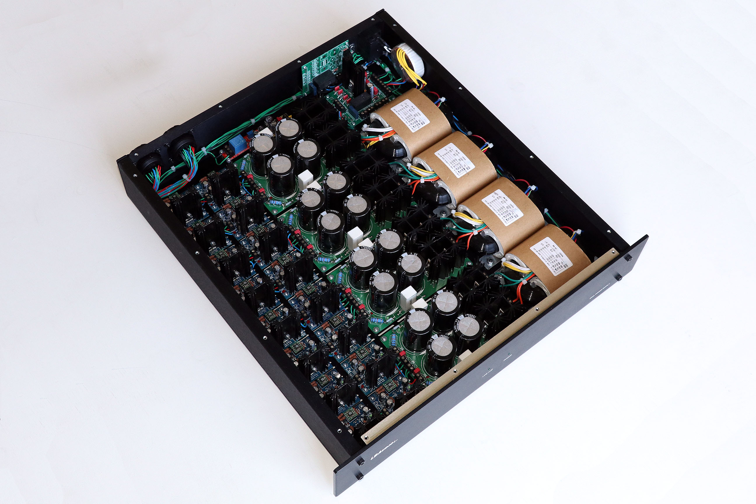

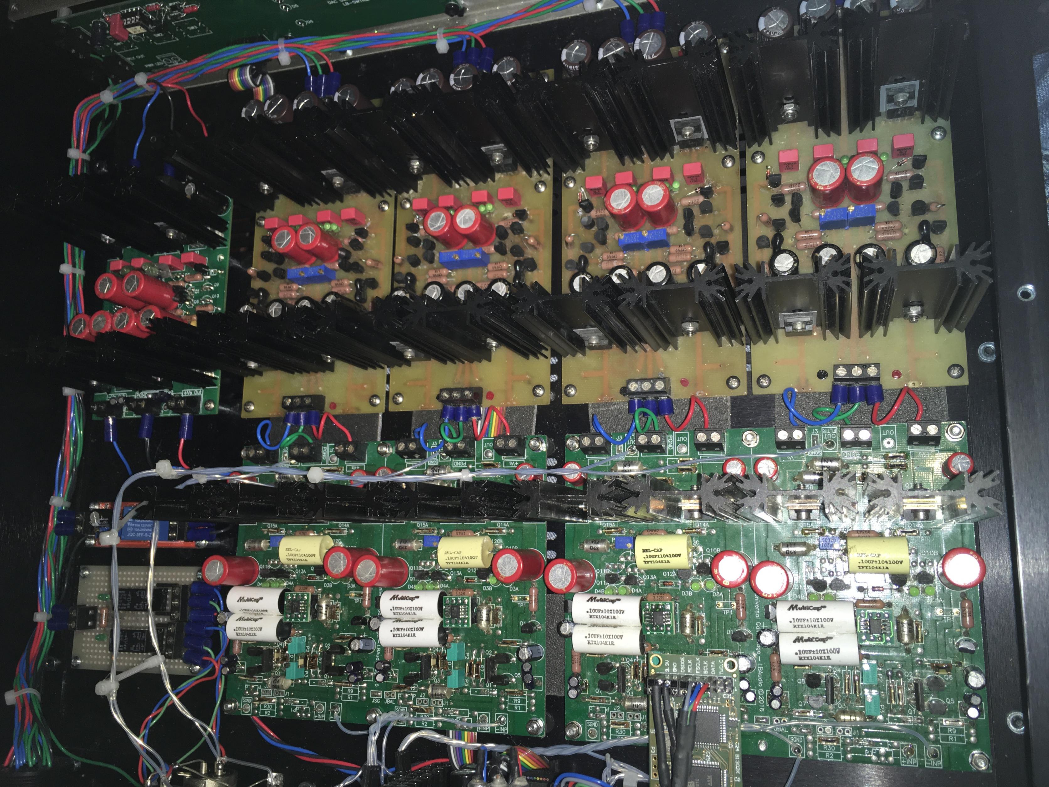

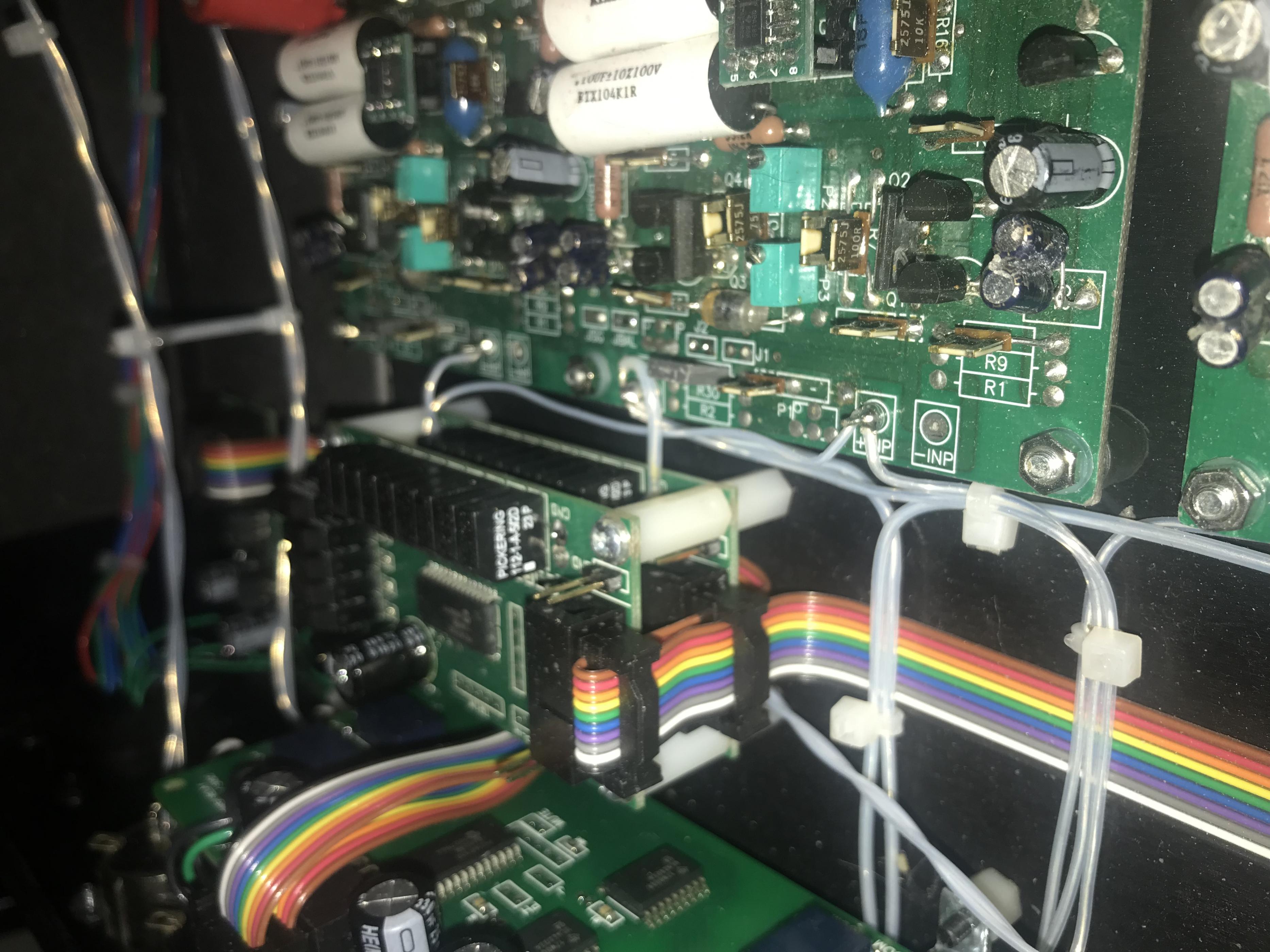

Yes it s cheaper to buy 0.1% from them than 1% from Parts Connexion. the tolerance doesn’t sound any better, but better for input differential performance etc. And yes A few custom values required for the phono stage RIAA. I built the boards and aquired the parts and Les Bordelon built and wired them.
the line preamp uses Bent Audio ladder attenuators that I’m trying to resist changing to surface mount TX 2575

Between the dac, preamp and phono stage there are over 160 Blackgates and they are all discrete jfet/fet direct coupled with servos. And TX 2575
The power amp has over 90,000 uf of Blackgates - 8 x 10,000 uf FK and 4 x 2,200/100V N
and 32 of the 0.1uf /50 V NX - and 400,000 uf Panasonic caps feeding 2 mh chokes for the filters before the BGs.
