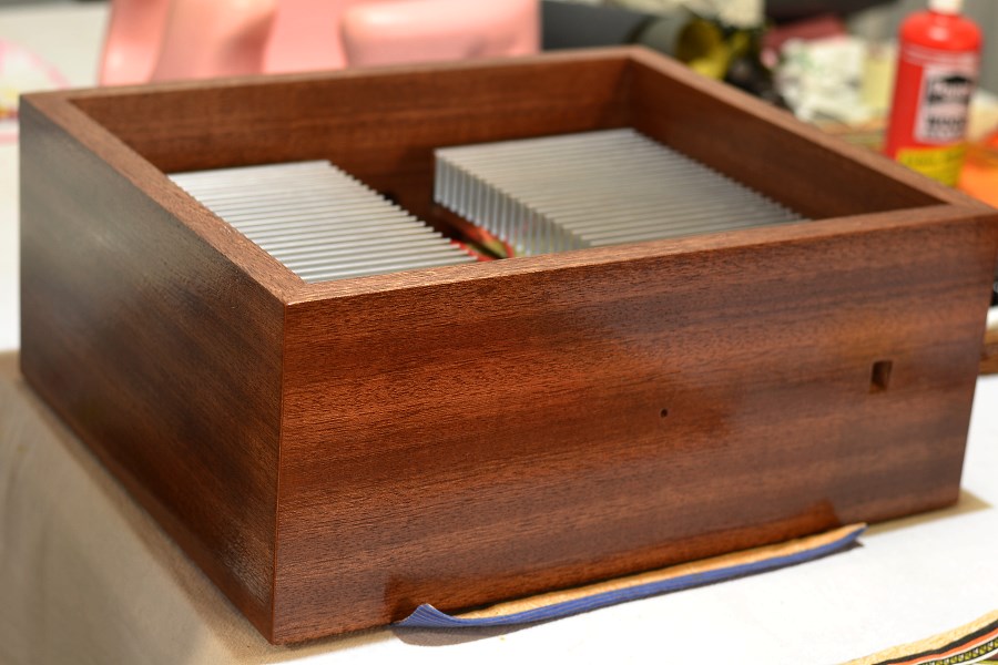

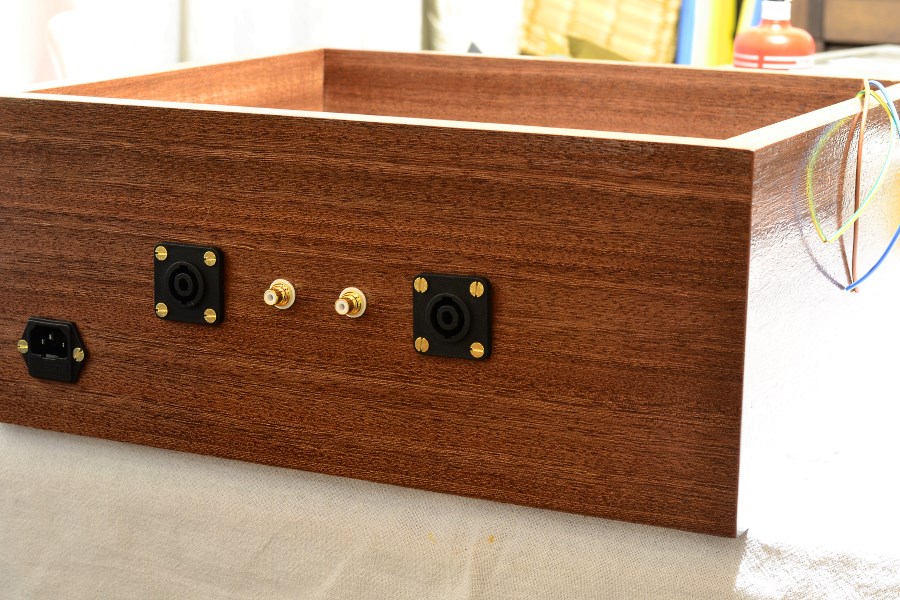

I'm going to post this here. This is my amplifier that I will hopefully put into shops as a new product. I'm proud of this. I might put these into the amplifier thread where I talk about the actual amplifier. I'm posting this here because it's mostly a showcase of the woodworking (which is relevant to speaker-building 🙂 ).

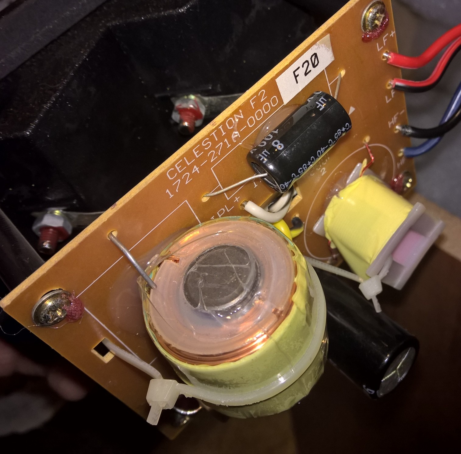

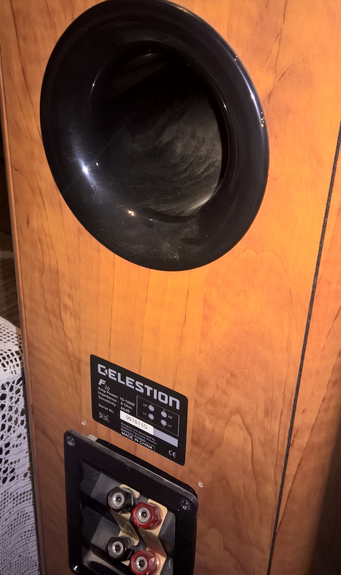

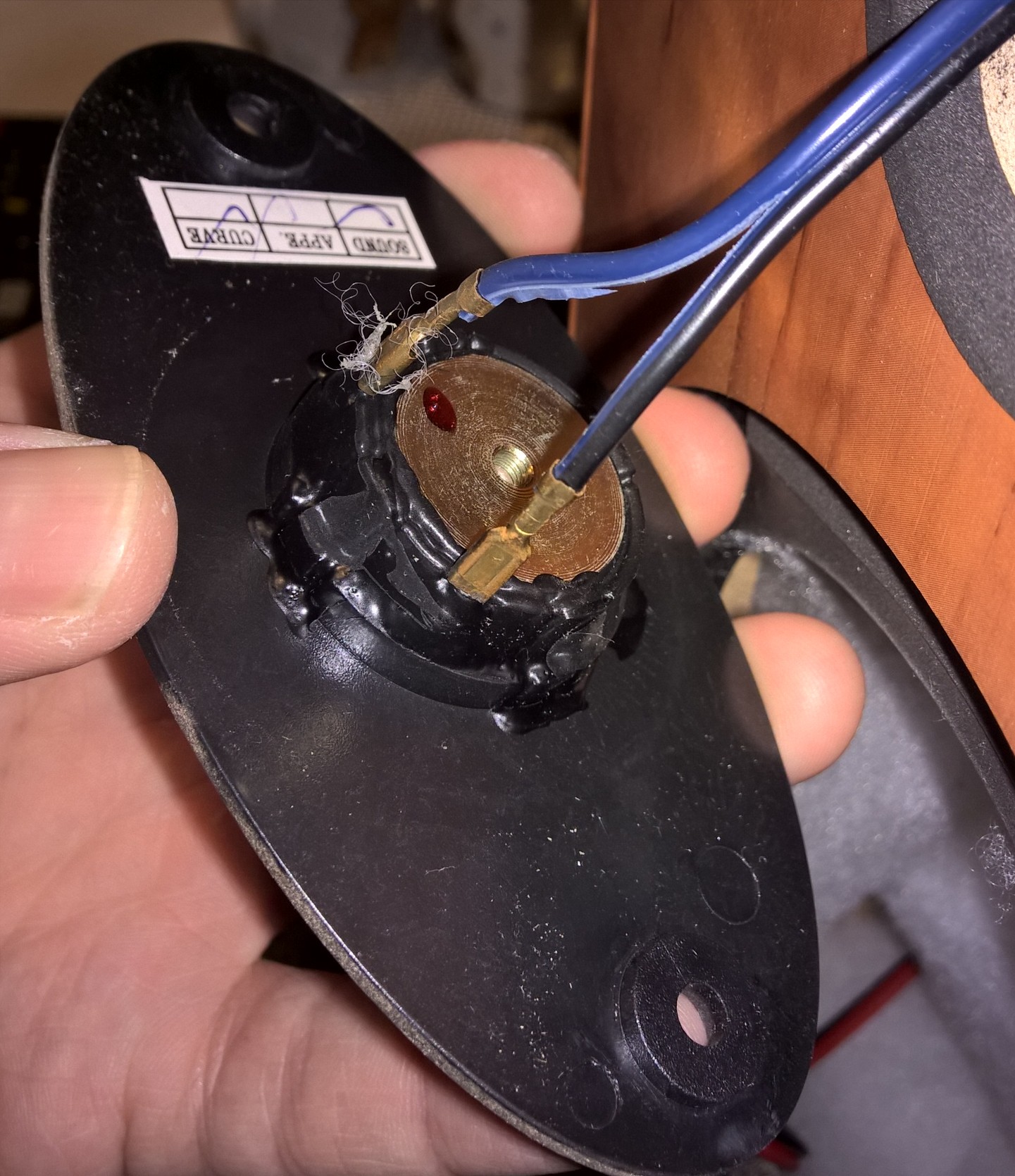

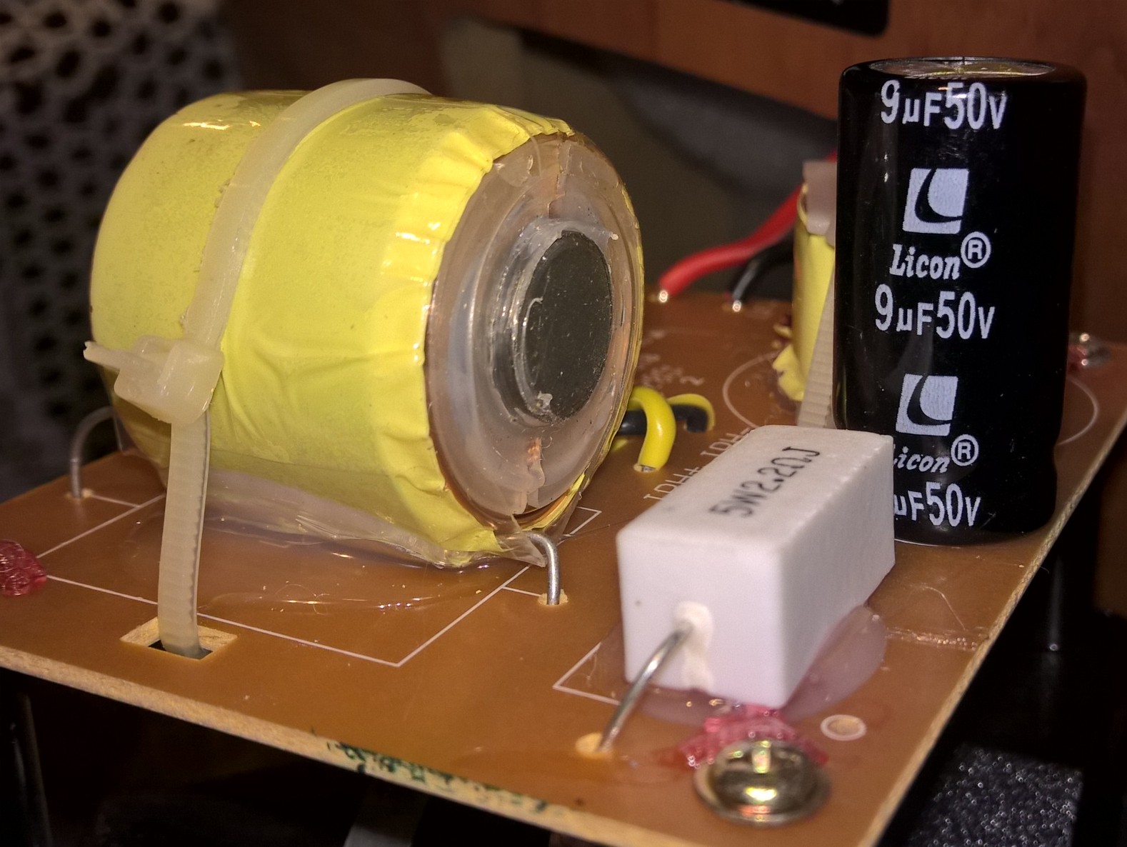

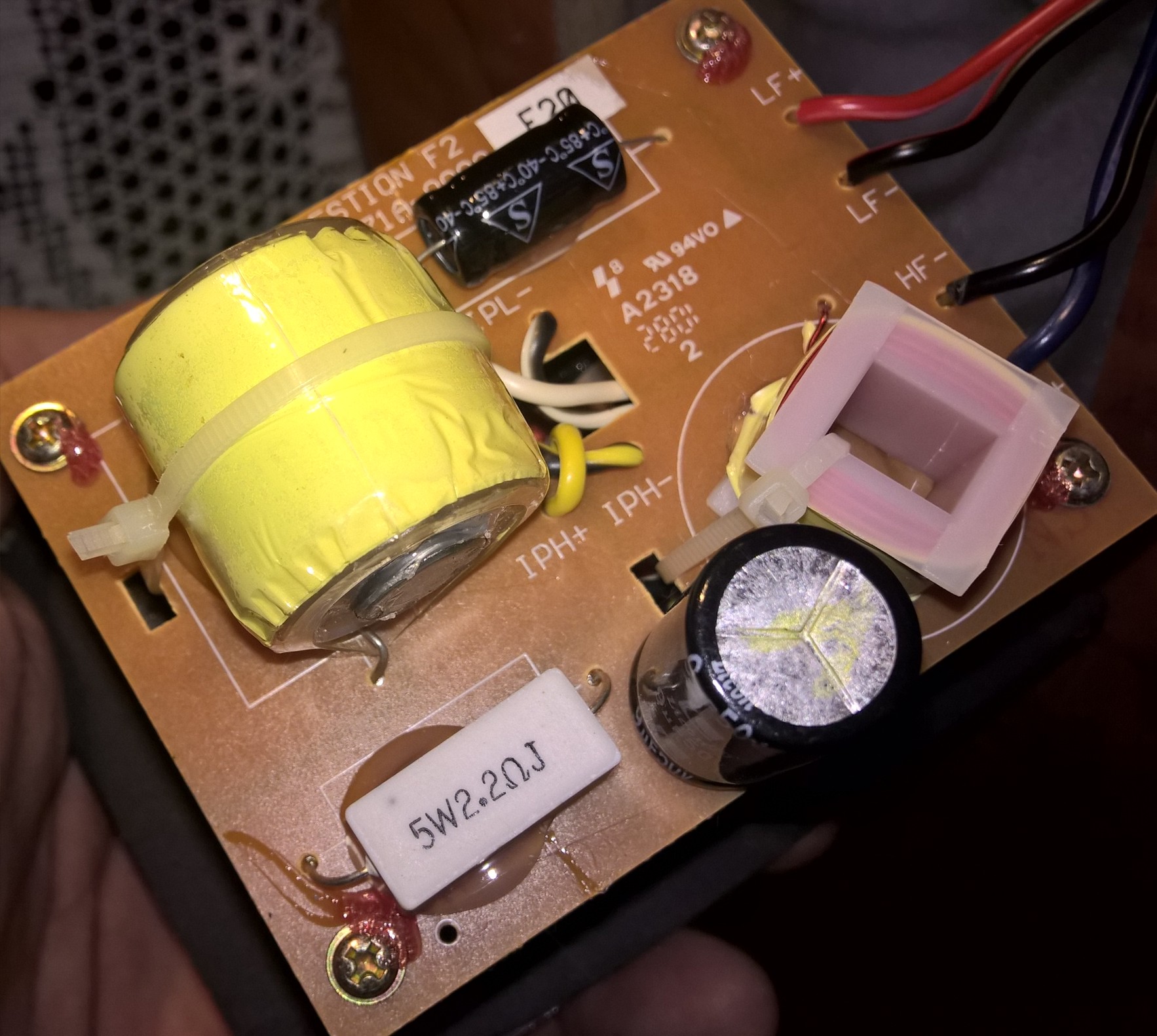

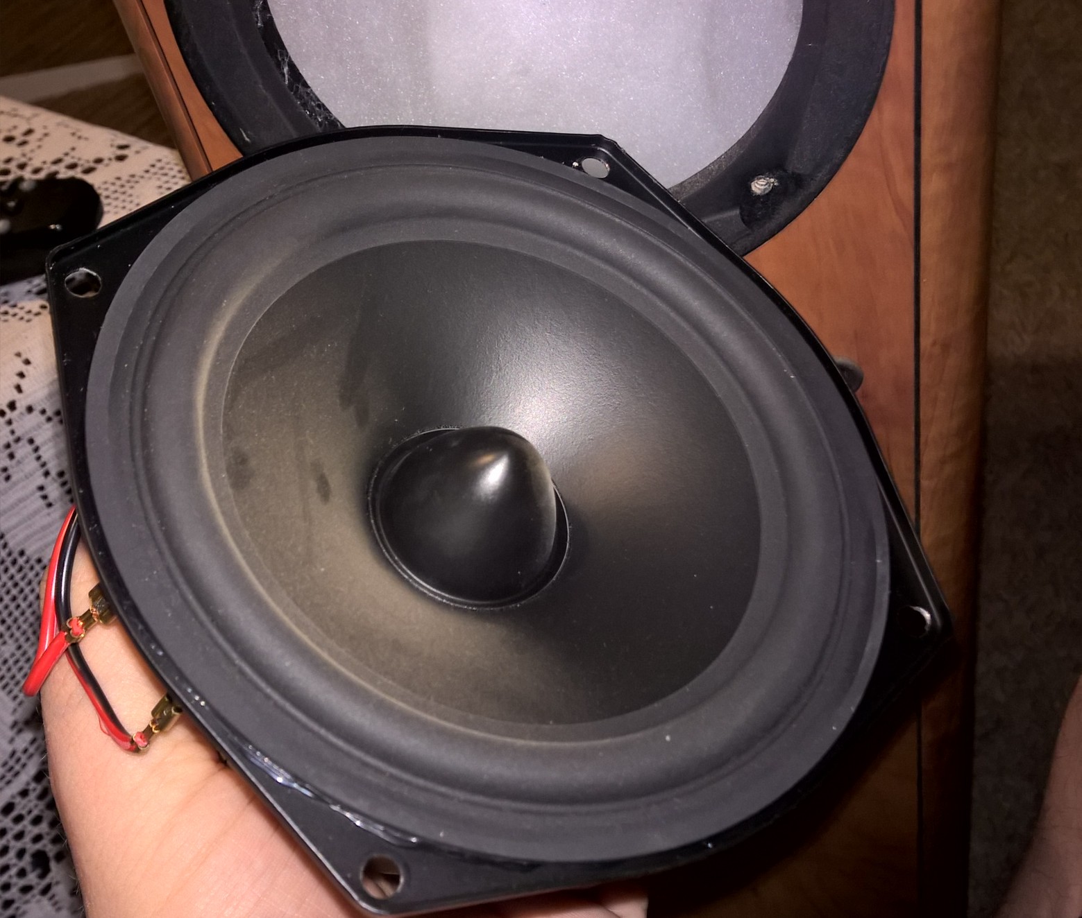

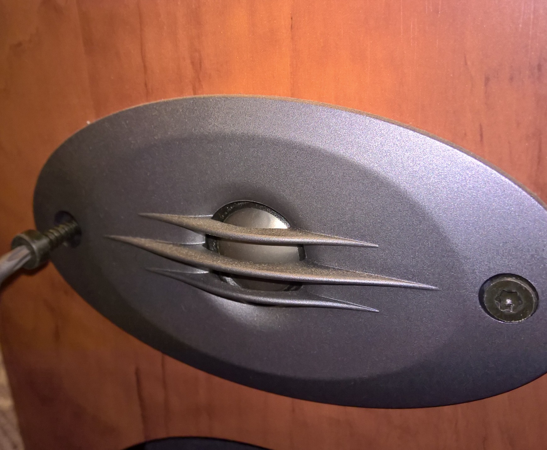

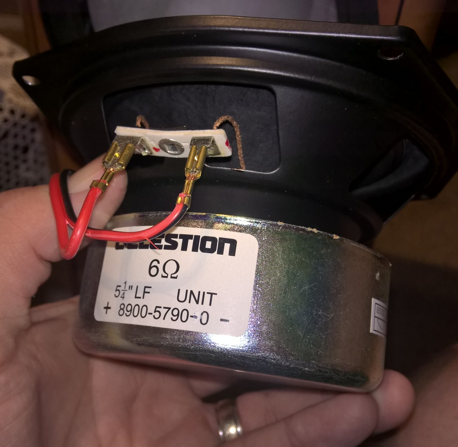

I took my Celestion apart. The enclosure is about 16.5L. The port is about 7cm diameter by 14cm long. Crossover frequency is 2.5 kHz. I have attached photos.

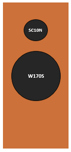

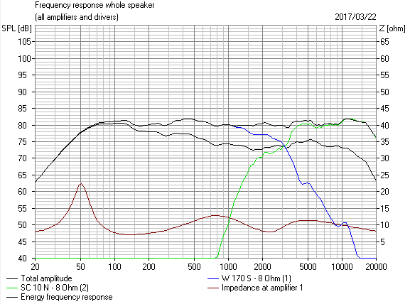

I've decided to go with something like the Gibbon 88 clone, but I'm not sure of a few things.

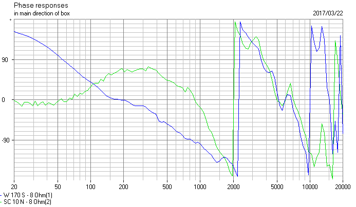

If I use a 100 cm high speaker which has a top chamber of 55x32x19 sealed off, giving a front baffle of 100x22 and a depth of 55cm including wood width, I get 32 L. Is that right?
Then, if I use the Gibbon 88 layout, the simulated frequency response isn't how yours comes out, Steve. From about 150 Hz to 1 kHz, the FR is down about 2 dB. If I put the tweeter at the top and the woofer below (like the Celestion F20, but quite a way down), the frequency response is far flatter.
I have attached my project file if anyone is keen to look (rename to BPJ).

Thank you, and yes, I agree, but what I mean about the frequency response is that I can't get what you get using the Gibbon 88 layout. But that's just what I'm finding.
Either way, I do see the nice roll-off of the tweeter with that layout. And I agree it's important because my Celestions struggle with a few songs, in particular, May it Be from LOTR OST. When Enya sings the Elvish chorus, the tweeters crack up something terrible.
So then, you mention a double reflex. I'm just going with 32L closed. So it should be something like this:
Is that right (with the top chamber being the 32L)?

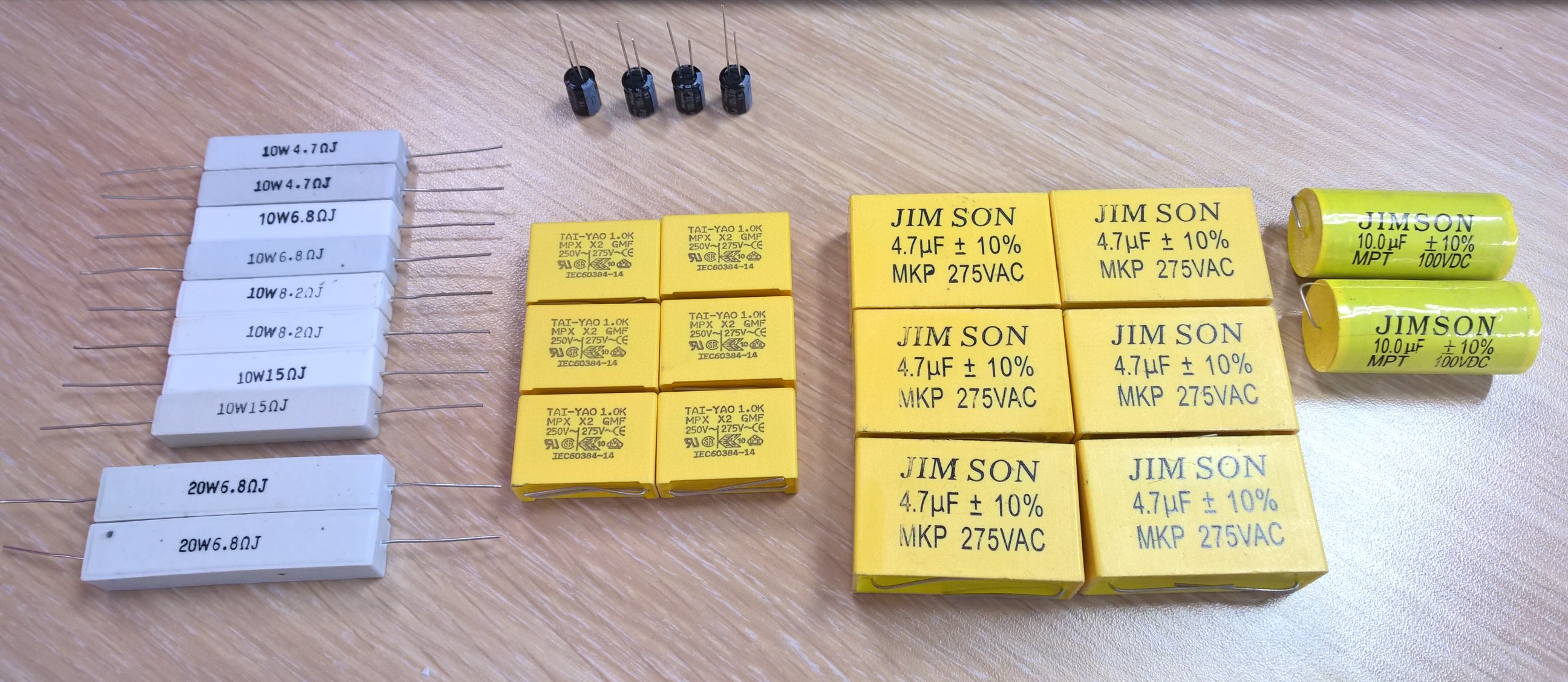

I've already started my final planning. Capacitors aren't the easiest thing to come by for this application, so I'm probably going to use 1uF, 2.2uF and 4.4uF capacitors in various combinations. I think i need about 90m of enamelled wire, and I can get 500g rolls, which are 44m each, so that should be fine. I'm very keen to do a peg board for the crossovers.

I've found polypropylene capacitors for all the values. I've had to use a parallel combination to get 15 uF and 6.8 uF, but it's worked out quite well. The caps are 275 V. Then I'm going to use two 33 uF (polarized) capacitors in series to get my ~18 uF. These are 100 V each. I'm using 16 AWG enameled wire. I ordered a kilogram, which is hopefully 80 - 90 m. I'm winding air core inductors.
I did some tests. The W170S does sound nice, and it has excellent bass extension. At 20 Hz, it's silent, so that's a good point for lack of distortion. I bought another 6.5" which cost about 8 times less, and that driver sounds very good too, but the Visaton is definitely in another class. So that's good.
Steve, I've followed your advice very closely. But I'm making one deviation with my crossover - rather than a 1.6 mH inductor in the bass part, I'm using another 0.82 mH. It's going to be much easier to wind 4 identical inductors, and the 80-odd extra turns are going to put me over the wire length budget. The impedance still looks great. Let's see how it works out. Components should arrive next week, which is well in time; I won't have the drivers in boxes by then. 🙂
