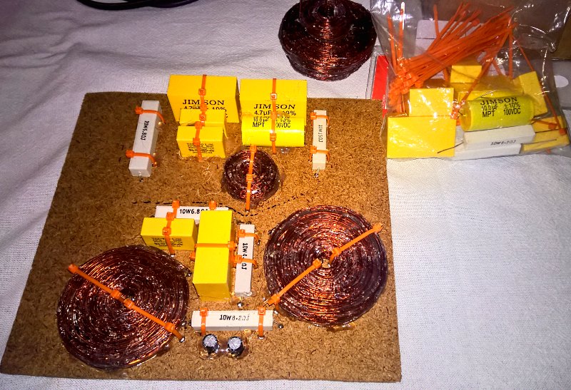

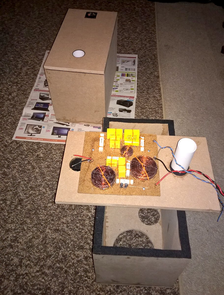

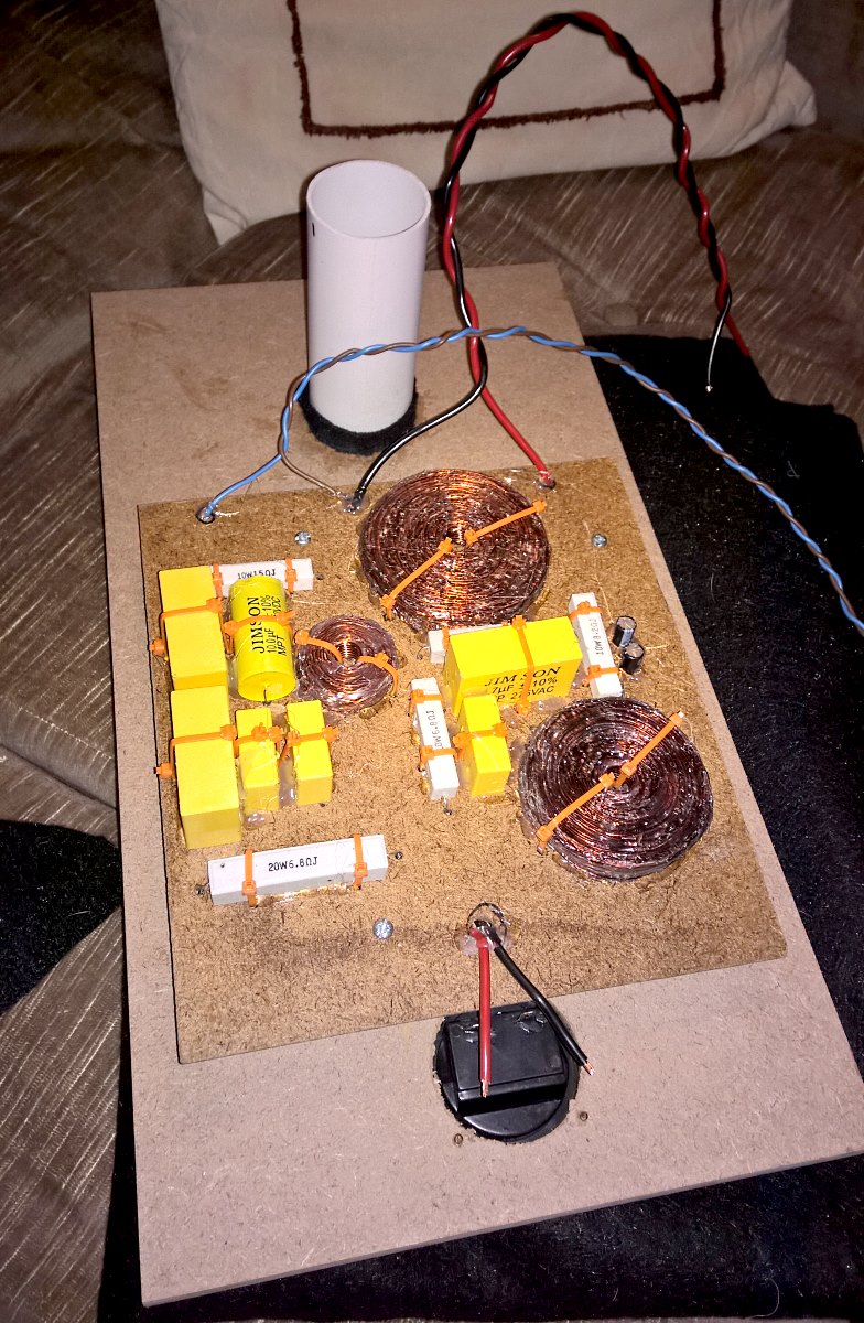

Well deserved rest. What do you think of putting coils in a tank and fill it with epoxy resin? That would have looked dynamite.
I would have loved to dip the coils! It's just not viable for me.
Had I dipped them, I'm guessing I'd have to drill a hole to make them air core again?
Why would you drill a hole at all? Just make these as if it were encapsulated transformers. And then put a sticker Moondorf Supreme Coils.

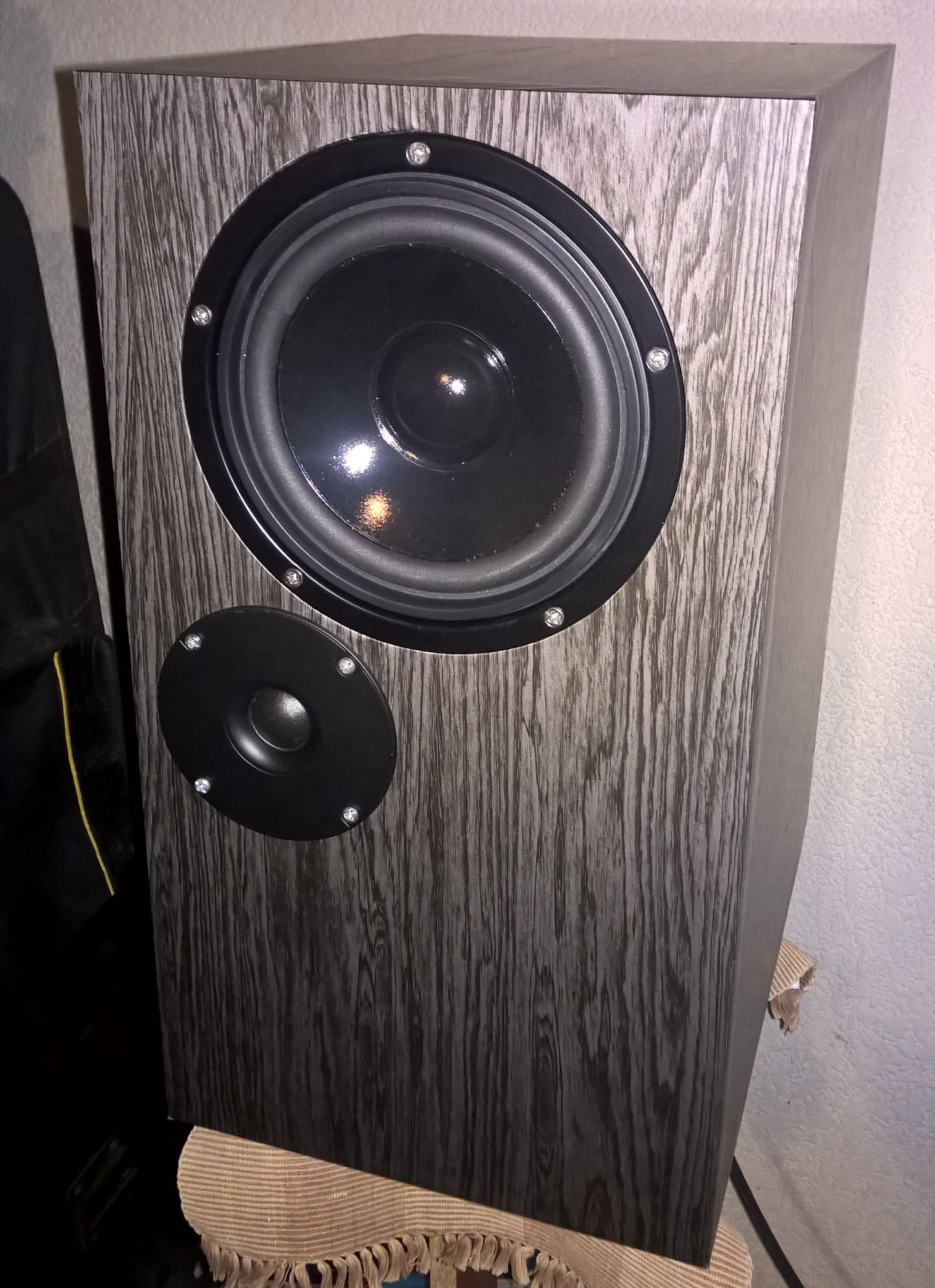

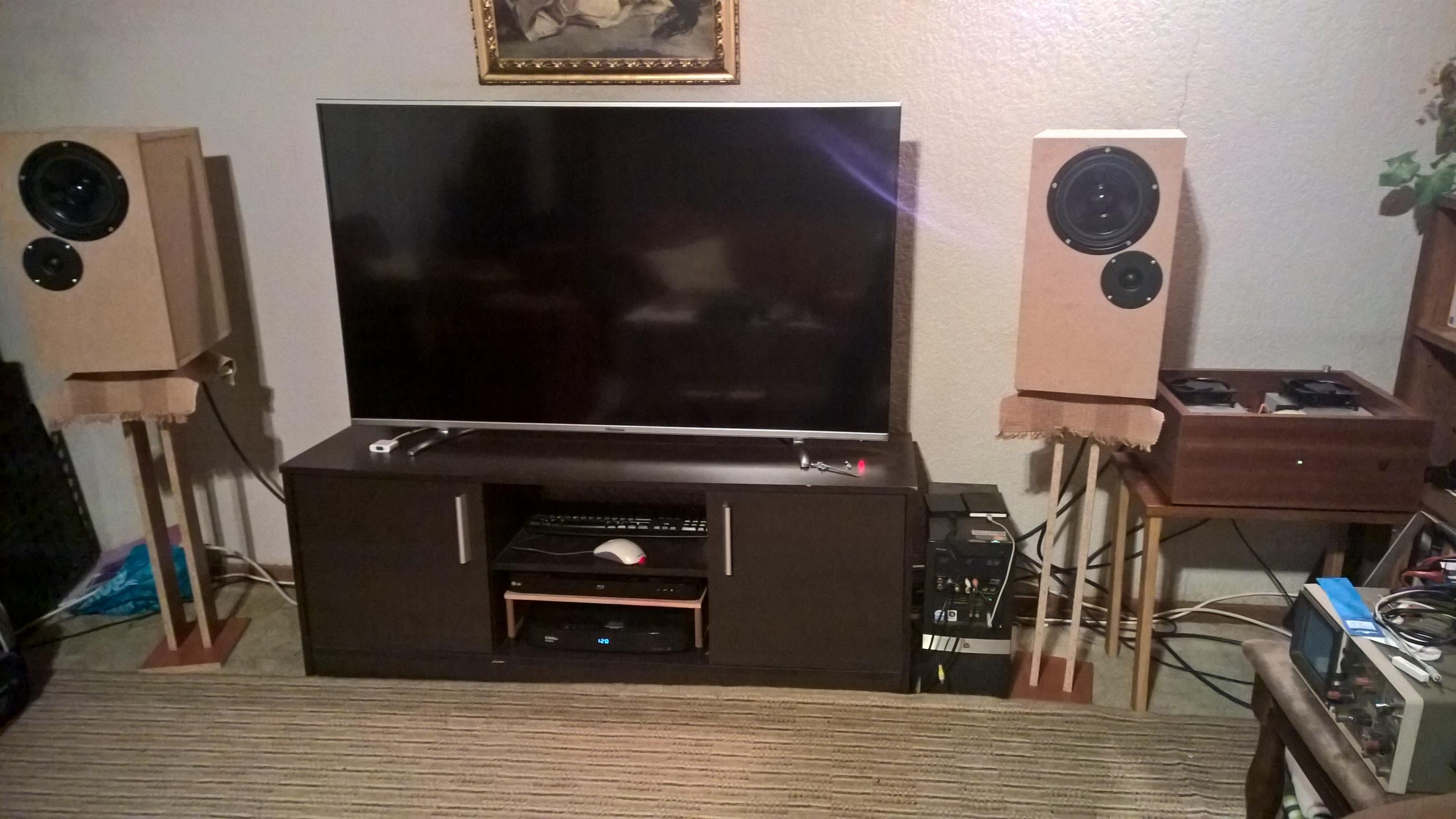

The speakers are built but not finished. That wasn't all that easy, to be honest.
They look very cool! I've set them up temporarily. They're a bit high up, but I can at least give them a listen. I am very well impressed to say the least. They are fantastically balanced! The major difference between these and the Celestions is that the Celestions push certain bass frequencies strongly, so the new speakers seem to have less bass, but it's actually just balanced.
I started off listening to a little ZZ Top, as these are "Gibbon 88" clones, so it's a bit of a tribute to Billy Gibbons. 🙂 Bass is definitely toned down. But after going through some high quality recordings of Tracy Chapman, I decided to get right to business and put on some Pendulum. Jumped right in and gave Set Me on Fire a listen. The bass is just spectacular. All the frequencies are present down to the lowest that song has to offer, and in an incredibly balanced way. I've currently got some Eric Clapton Unplugged on, and it's wonderful! I believe these speakers will need a bit of breathing space, playing in and to be much lower, but otherwise they're absolutely perfect.
And the best part - they sound superbly balanced at very low listening levels! It's uncanny. As you turn them up, they just go louder; they don't change their sound. I'm guessing that's a characteristic of the air inductors, but I can't say. These have definitely Changed My World. 😀
I will just say thanks for all the advice and help!! I believe I've made something worth much more than what I paid. I really hope this thread can help others.

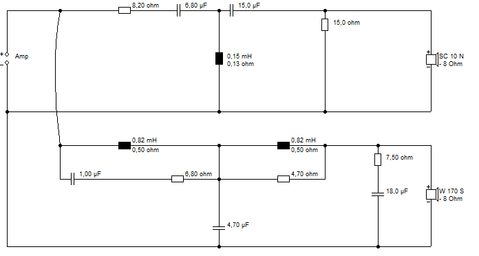

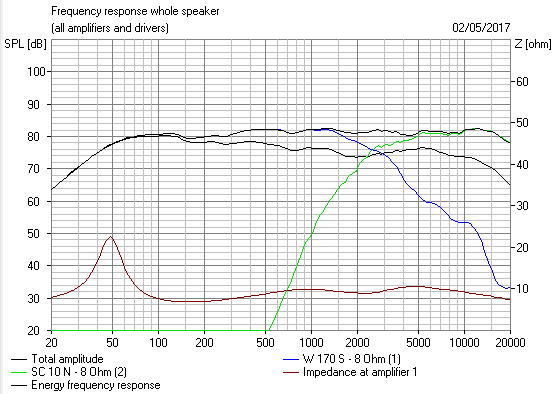

I think we should do a summary here! Sum it all up. 😀

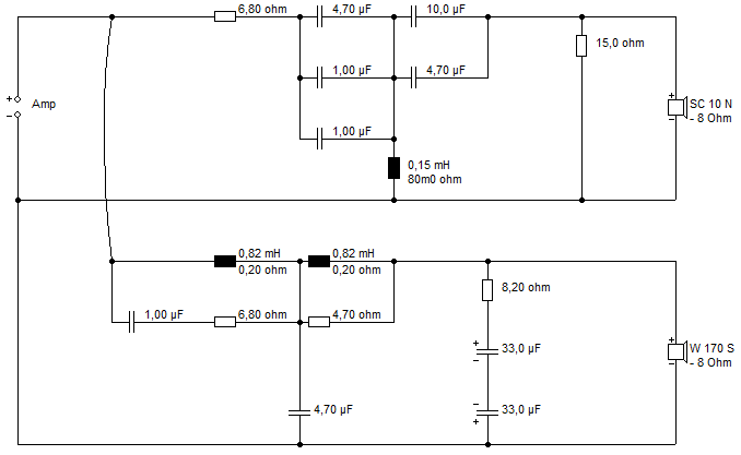

Drivers, W170S 6" paper bass, SC10N soft dome tweeter:
W 170 S - 8 Ohm
SC 10 N - 8 Ohm

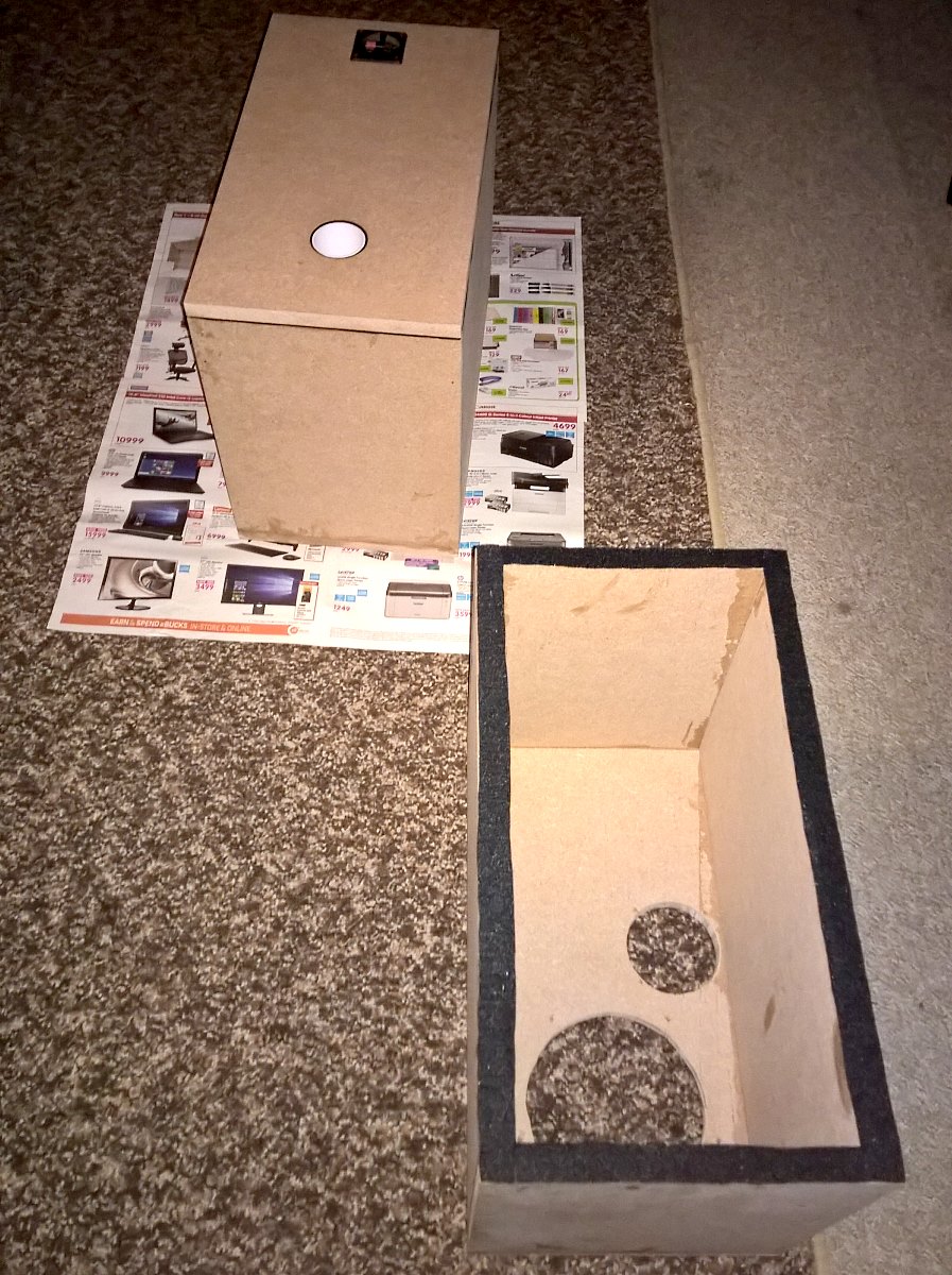

Closed Box around 32L wasn't it? No, I'm wrong, you did a reflex which is easily calculated with Visaton reflex data for the driver. DeVore style driver placement. The tweeter goes on the outside.

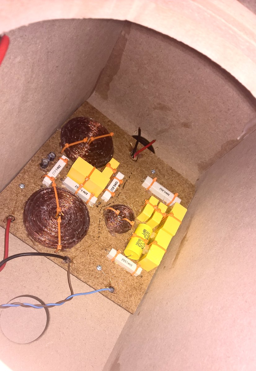

And a splendid old BBC style filter, with Impedance Correction on the bass and an unusual 3-4dB passive bafflestep with the 4.7R and 0.82mH coil in parallel. The 1uF and 6.8R is a notch at about 5.5kHz that aligns phase almost exactly. Nearly LR2. And the bass aircoils look good and are not huge values with this sort of bafflestep.

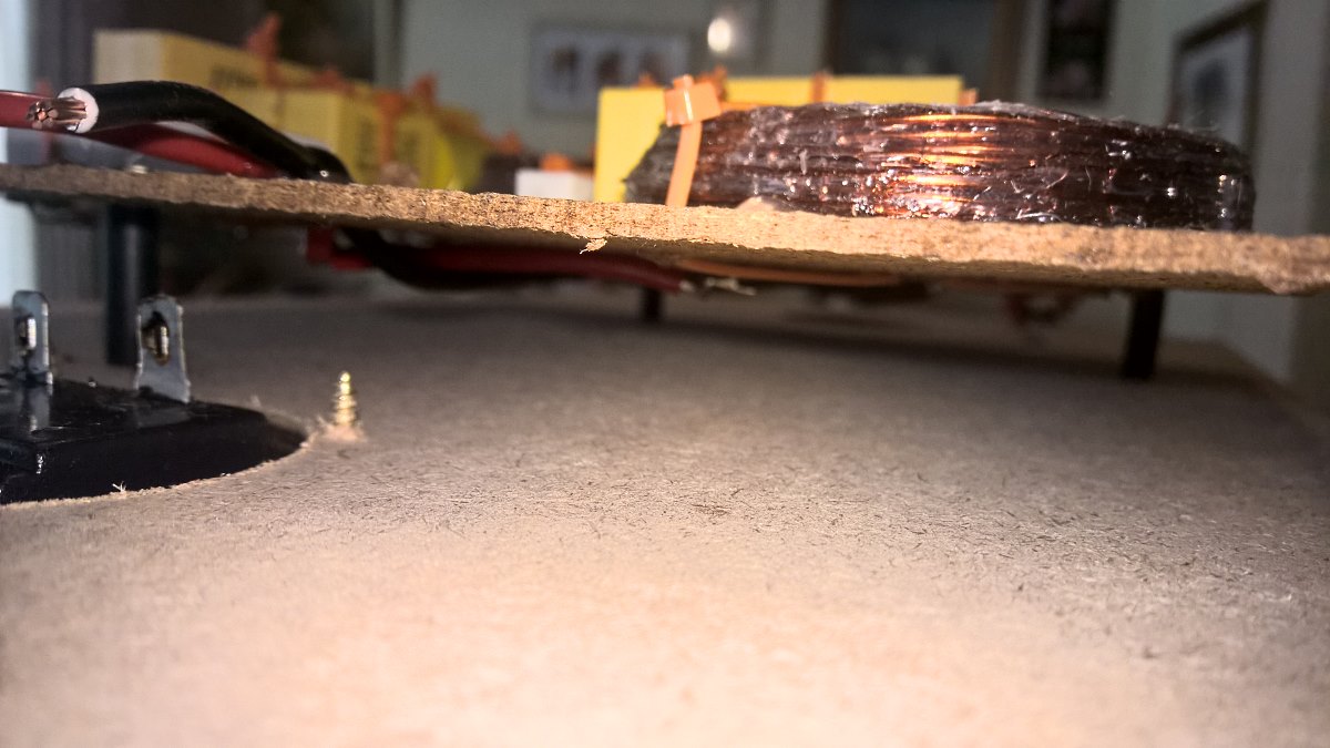

Now that is one heck of a good load for an amplifier! I think it helps. It would be highly suitable for a SET valve amp IMO. And I did sim that with a 6R resistor in front of the whole thing. Everything else is good too. I think you've done something interesting here that diyaudio people can apply and enjoy. Bravo! 😎
I could make one tiny suggestion, in that the tweeter coil axis might be pointed at right angles to the bass coils axes to reduce interaction. Because electromagnets do interact if close together. The simplest rule of thumb is that you can't see the second coil if you look down the axis of the first, and vice-versa. Like so:

Thank you Steve. You will notice I haven't put up any photos of the completed speakers yet... 🙂 I was going to write the summary and take decent photos. I took some this morning but they're appalling, so I'll take properly tonight like I wanted to in the first place.
I really put the speakers through their paces last night, and they sound excellent!
I will turn those HPF inductors when I start the finishing off process. Makes perfect sense - I wasn't thinking right when I made the boards. Thanks!

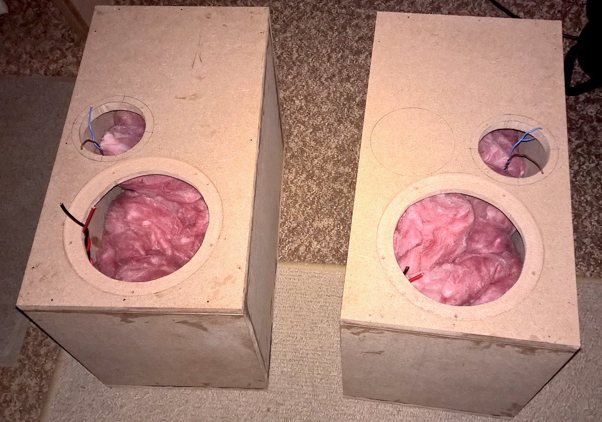

The enclosures are approximately 32 L vented. I'll put the exact inner dimensions on when I post the nice photos later. I went for the vented boxes because I can plug the ports, but I can't port the sealed box.

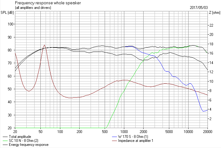

I will hopefully also measure the impedance tonight and post something about that.

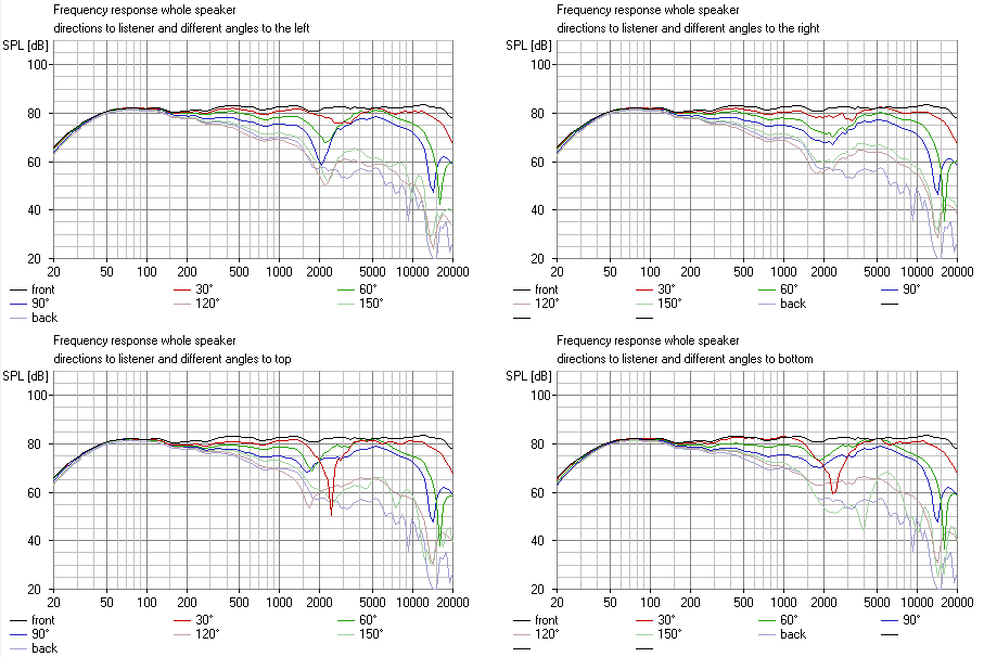

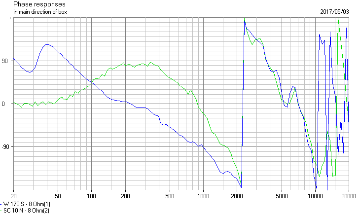

Tweeter pulled away to the sides is causing you lateral spl holes at an increasing off-axis angle. But you prefer it this way.
I'm definitely a beginner, so I stand to be corrected. You'll see on the "to the right" curve, the 30 degree line is very good. This is a simulation of the left speaker. It's not going to happen that these speakers are listened to at anything near 30 degrees. And if need be, a bit of toe-in isn't a bad thing.
The top and bottom curves are my main worry, but again, their position puts them nowhere near 30 degrees. They're very much ear-level. And my listening position is far away; about 4 - 5 meters minimum.
I did think about this a lot, and compared the simulation to other tweeter positions, and it looks fine. I'm going to try measure frequency response at my listening position to give a verdict.

Human hearing capabilities takes into consideration the average response of the multiple on and off-axis responses. Your power response curve is little less optimal than it could have been. You have probably seen and heard many times that some audiophiles prefer the tweeter moved a little bit closer to the edge for the simulation of baffle step does appear more smooth than strictly on-axis but when you calculate the average response of all the curves in the listening window than there is hardly any wrinkles anymore. I have posted a couple of months ago an excel based calculation with the graph that proves it. That's why manufacturers mostly don't bother with this.
Interesting, and definitely something I can learn more about. It is also possible to change the enclosure in the future.

As other told in Forum you only have to change the 10 Ohm resistor to 3,3
Ohm or so to use SC10N.
