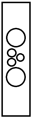

What you've been modelling looks quite a lot like the Alto IIIC:
ALTO III C
I was looking at the Alto II:

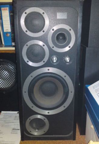

Your F20 speakers are actually part of a home cinema set. They match a Celestion S80 subwoofer. It wouldn't be outrageous to see if you could pick up some F15 bookshelves and stack them on your F20. Poor Man's MTM!

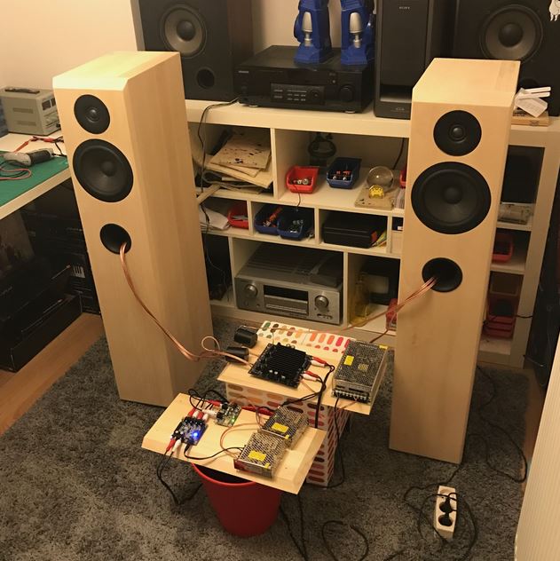

I was reading Michael Chua last night. He's a helpful member here. He really likes this Pioneer FH-X731BT car CD, which does all sorts of things like active filtering:
Pioneer FH-X731BT Car Receiver for Home – Loudspeakers & Amps
He has fearlessly lashed it up with a 12V SMPS power supply to get it working at home. But a bit of a bargain for what it does. No need to build crossovers, you see. Of course, people use Class D amps and active filtering units these days too.

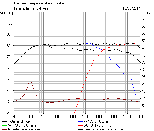

Ok, so I can order on eBay, and shipping is R1000 or so. With that, I can buy:
4 x W170S
4 x W100S / WS13E
2 x TW6NG
Including shipping for around R4000. So I'll do that. That's much much cheaper. I can just about afford that right now, depending on the electricity bill... 😀
4 x W170S
4 x W100S / WS13E
2 x TW6NG
I think we are making some progress here. If you can get the drivers for about R4000, which I make to be about £260, that's not bad at all. 🙂

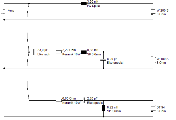

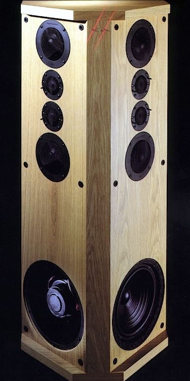

I'm the World's worst for rambling off-topic, but I was struck by how similar the Visaton Starlet is to the Wharfedale E50. A WMT design below. Or WMMT in the E70 crossover below.
And here's a WMTMW design by those enthusiastic forum amateurs at Visaton:
https://boxsim-db.de/experience-v20/

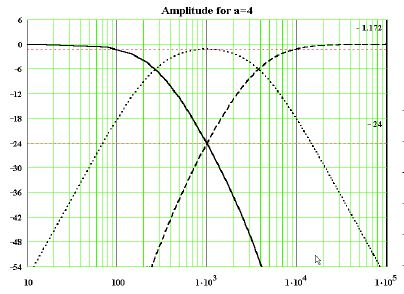

What I would say, is that you'll need to do some serious modelling and line up your crossover parts. This sort of project is a huge labour of love and enthusiasm. Nobody builds a good speaker in 2 days, because there is far more to it than frequency response.
BW1, LR2, BW3, LR4, room gain. Lobing. Power response. Loudness without distortion. Flat and easy impedance.

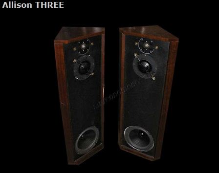

I regularly input to a thread called Classic Monitor designs, because I am interested in what designs seem to work well. Even simple ones. Seems like there are some good ideas in loudspeakers. And, IMO, they are the most important part of the chain.
Here's a guy I admire, Roy Allison. He thought about EVERYTHING, but especially the room. His speakers were designed to mount close to the wall or nearest boundary. But the main thing is to have good ideas, IMO.

Lojzek, thanks. I like it, but the only thing is the lack of midrange. I think 2 W100S's will be needed. Based on your suggestion of the WWMT, and combining that with the E70, I came up with that WMTMW. It's much like the Experience V20 Steve linked to, but it uses 2 W170S's. I also did the MTM configuration similar to the E70.
Steve, the cone tweeter isn't ideal. I've put the SC10N in, but I put that cone tweeter there in the hope you would comment on it I wasn't sure if it was a good thing or not. 🙂
And yes, this is no rush job. I'm mainly looking for direction. I think I've found that I really like the 2xW170S, 2xW100S and 1xSC10N combo, and I can refine that in time.

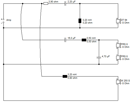

My reasoning was doubling up W100S drivers in series was going to improve power handling, Lojzek. Thus less distortion. The midrange is the main event IMO. And didn't someone suggest that lower quality midranges can work well a while back. Just coils and cones and magnets in the end. 😀
The physics says that each driver is only outputting a 1/4 of the SPL for the same overall level. Thus lower distortion. I also quite like Roy Allison's idea of putting the (single) bass near the floor below the bafflestep cutoff of 500Hz on a 22 cm baffle. You then effectively double up the bass response again with the floor gain. It's clever.
If it was me, with all the supply issues in SA, and availability of coils is the biggest one it seems. I'd be looking into availability of enamelled copper wire and wind them round a bobbin to correct inductance value.
This is just a hobby, in the end. To build a speaker, I have to be excited about the idea being tested. I liked everything about this DeVore Gibbon 88 clone idea:
Add the BBC impedance and passive RL bafflestep, and it all falls into place. Knowing Boxsim a bit, it overdoes the bass response when designed flat, but this 22cm wide, 32L design is a peach IMO. The W170S is actually more of a closed box driver, IMO, so a sock in the port might be good too. Joachim Gerhard used to talk vaguely about his diffraction module which adjusted for the cabinet. Well, if that isn't the BBC RL bafflestep circuit, I'll eat my hat. And John DeVore and likes easy to drive flat impedance. Ah, the secrets of high-end audio... 😀

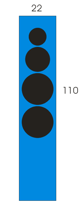

Peach of a Gibbon 88 clone, I'll just take it one step further. Make it 160 cm high, 22 cm wide and 45 cm deep. I like that height; it's nice and eye-level when I'm sitting. Put the W170S and SC10N where they would normally be at the top of the box, and then add another W170S symmetrically below the tweeter. Both low's 4 ohm, tweak the crossover a little, and this 100 L sealed box should sound quite nice, I would guess.

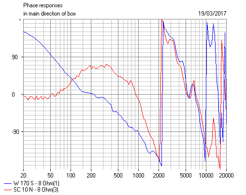

The phase for elevation angles is a bit bad, but I suspect this won't be a problem in my room. I sit about 4 meters from the speakers.
I'd expect a 6" bass to go louder than a 5" actually.
W 170 S - 8 Ohm
It doesn't like reflex at all, but then it's Qts 0.52:
mh-audio.nl - Vented System
3dB lump at the bottom end with reflex. Ideally you'd want a golden ratio (0.618:1:1.618) cabinet to avoid standing waves. Or 1:1.414:2 is another reasonable one. Something to think about there. I don't know the easy answer to that with a tower closed box. Maybe a lot of heavy stuffing in the box. Maybe divide the cabinet internally to 30L because overly big boxes worsen power handling. DeVore uses a double chamber reflex, you see.

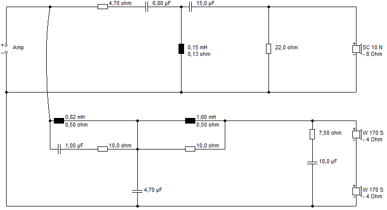

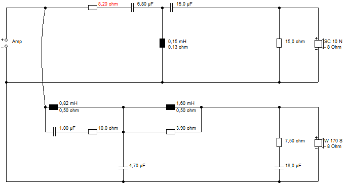

FWIW, I don't like that 10R resistor on the bafflestep.
mh-audio.nl - Home
Seems to worsen the impedance. It's too much. 3.5R and 1mH seemed about right for 4dB.

Hi. Thanks! I'll keep in mind that golden ratio - that's a cool thing. I actually changed the two 10 ohm resistors to 4.7 just after posting. I preferred what it did for the impedance. I was thinking of that tall box and using many deflectors in it - jutting pieces of bracing here and there. Or I could make two 50 L chambers.
When I tweak a crossover, I look at peaks and dips in FR and impedance, and then I can identify where it's coming from, and then I play around with the value of the suspected component. I imagine that one can get quite obsessive and tweak each component after building.
