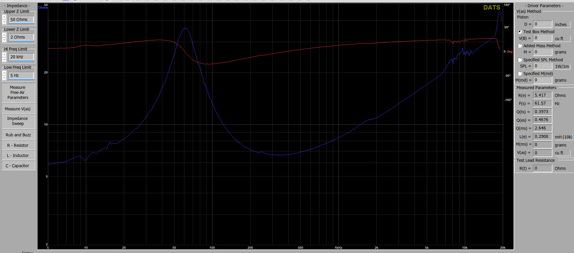

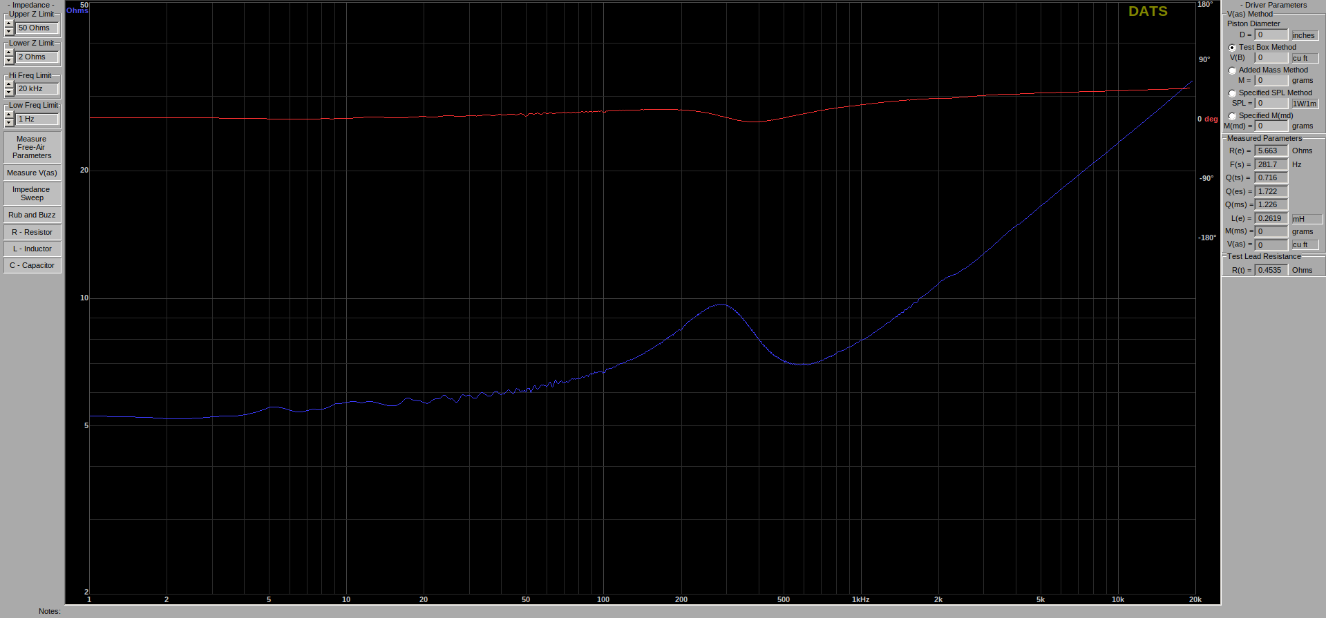

It's all the same as with my examples before the upper suspension was replaced. Complete change of all TS parameters compared to the datashhet.
Post #31
Post #31
P13WH before and after surround replaced.
Ebay rubber surround (thnaks @NIXIE62 ) , fixed with PVA craft shop adhesive.
fs was 281Hz - now 61Hz (data sheet 60Hz)
Qms doubled to 2.6 though. Does the adhesive affect this parameter?
1. : Old hardened rubber surround
2. with replacement surround
I never managed to get factory parameters by replacing the suspension. And I don't even know if the drivers had factory parameters at the start.
The new rubber surround is the reason for the changed Qms. I think that is preferable to have a higher value.

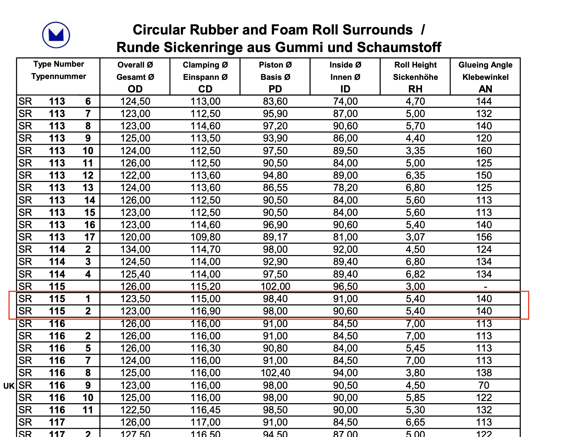

I emded up getting the surrounds from Speakerrepairshop.nl
They had a surround model # R5C11 which fits correctly.
Or should I say, we'll see if it fits correctly. According to the measurements, their R5C11 is supposedly the correct surround for the P13WH-00-08. The dims on these are 126mm, 113mm, 98mm, 91mm.
The original surrounds made by Kurt Müller, Germany has slightly different measurements, but the ones you found will likely be fine. Here is a screenshot from the catalogue:
I got confirmation by Scan-Speak that these were the original production surrounds.
