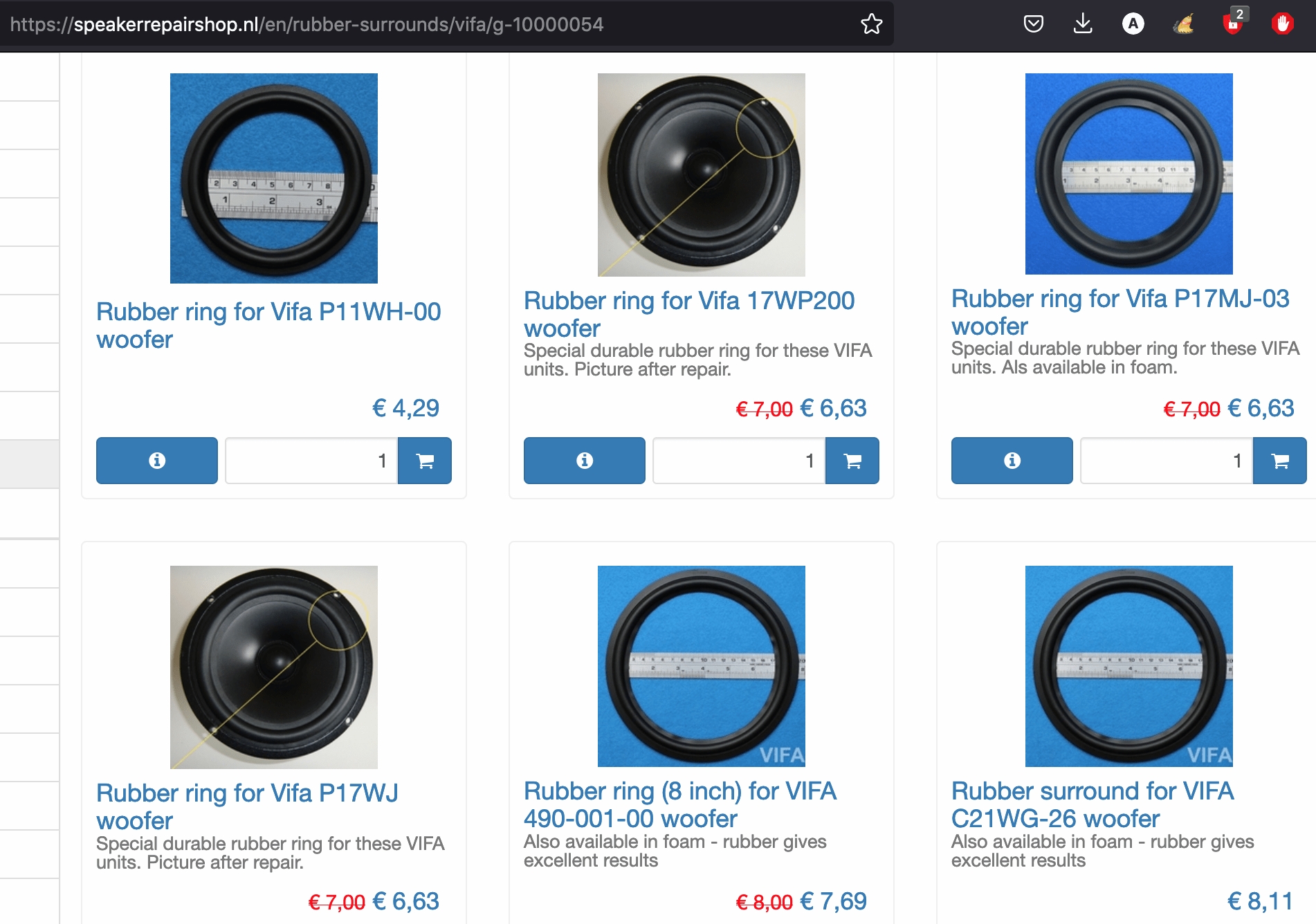

@profiguy - the ebay listing given by @NIXIE62 has the first example of a replacement I've seen that might fit.
5-inch EC113A rubber edge
Outer diameter(red line):125mm
Outer bubble(yellow line): 113mm
Inner bubble(blue line):95mm
Inner diameter(green line):90mm
Your dimensions in post #7:
122mm, 112mm, 96mm, 90mm
I measured the surrounds with a large vernier caliper as
A=123 B=113 C=98 D=91mm
- but C is the least accurate of my measurements, since I have not yet removed the old surround.
Does 95mm match the outside Ø of the cone?
Anyway they are so cheap that even I might be forced to try them.

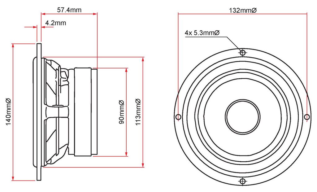

Check the 125mm, as to my knowledge the surround has to fall into a recessed ring on the frame. And does it have an angled ring for cone mount (140deg)?
I think the recess part of the chassis has a diameter equal to or less than 124mm (140-132-124). If nothing else, glue it and cut it off later with the metal edge nicely. And maybe it can be compressed a little, it's only 1mm difference.
One of those will work. It will also depend on how thick the surround is. Too thick and it will lower the sensitivity.@profiguy - the ebay listing given by @NIXIE62 has the first example of a replacement I've seen that might fit.

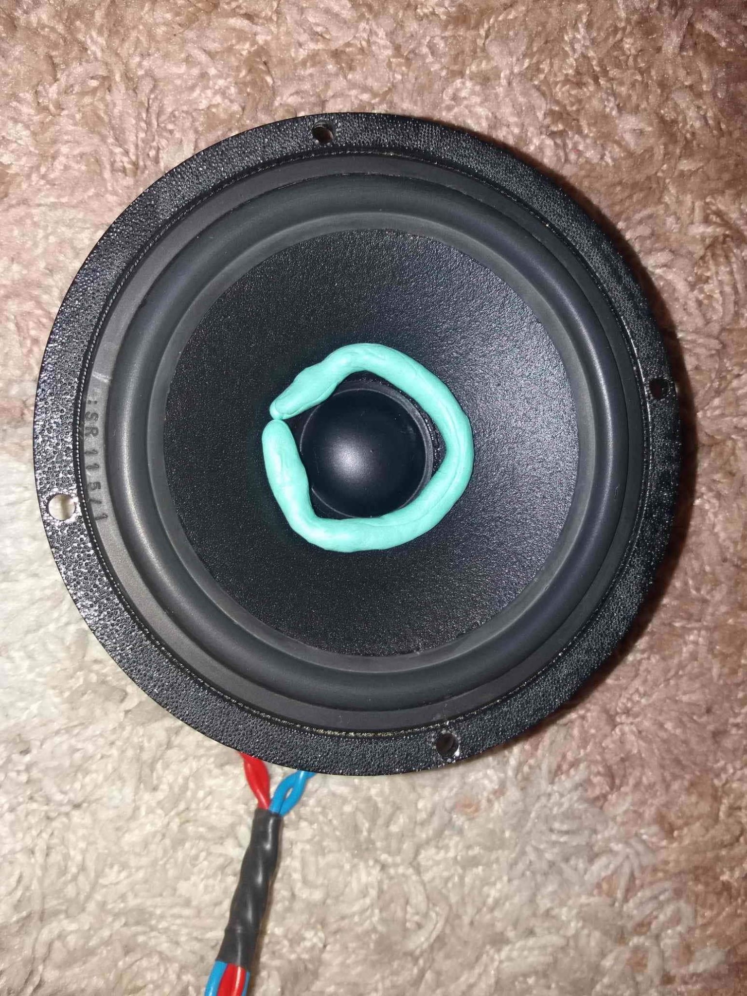

I cleaned up one driver for surround replacement and the other will be left as is, so I can measure both and compare.
I'll try those ebay surrounds and see if they're an option. Otherwise I'll have to scavenge something from another driver or try the flat foam surround.
Being a dedicated mid, I doubt a flat surround will cause more problems than it fixes (in this case at least).

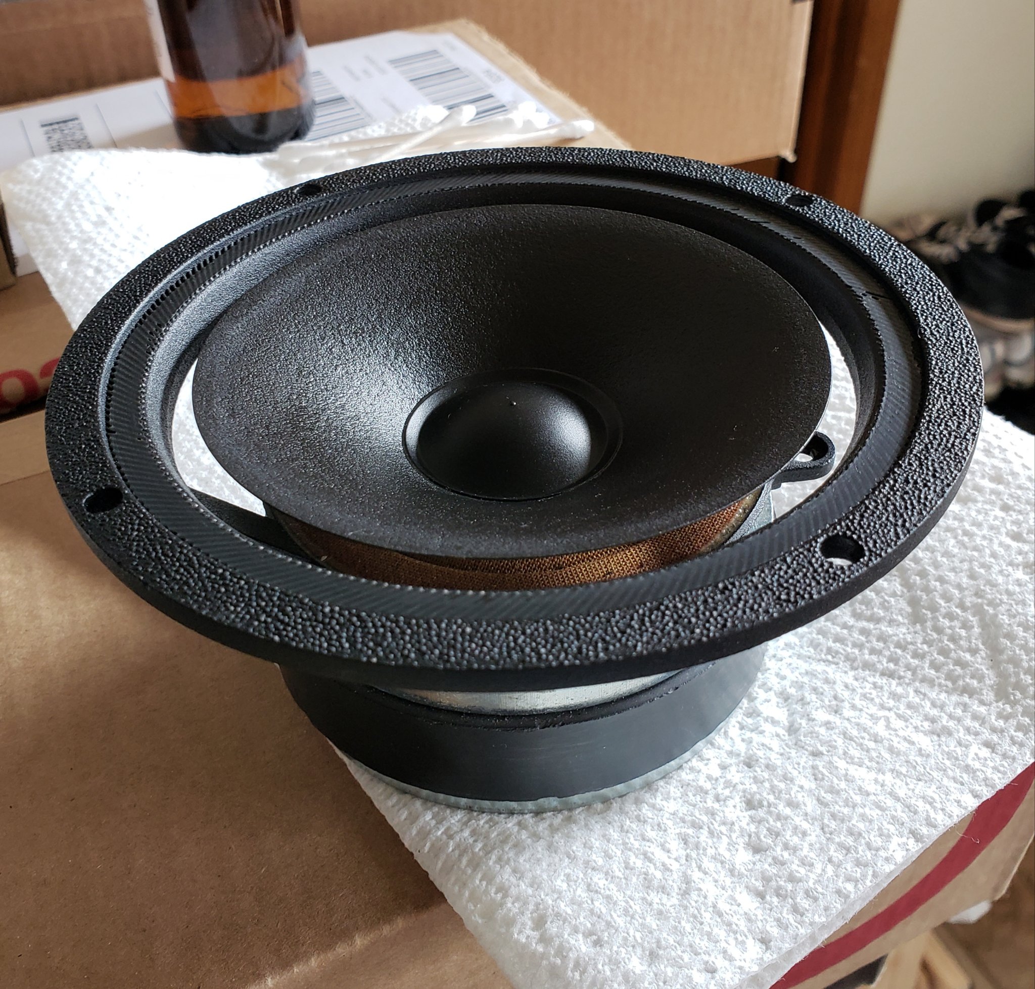

I'm pretty sure the reason this surround deteriorated this way is due to the use of armor all. The silicone oil found it that stuff will ruin elastomeric parts, specifically rubber based products. I have a set of older Boston Acoustics woofers, of which only one has a hardened rubber surround. I happen to know the bad one had armor all applied to it and not the other good one. Some furniture polish also has silicone oils in it. Not good to use on certain polymers and rubber.
