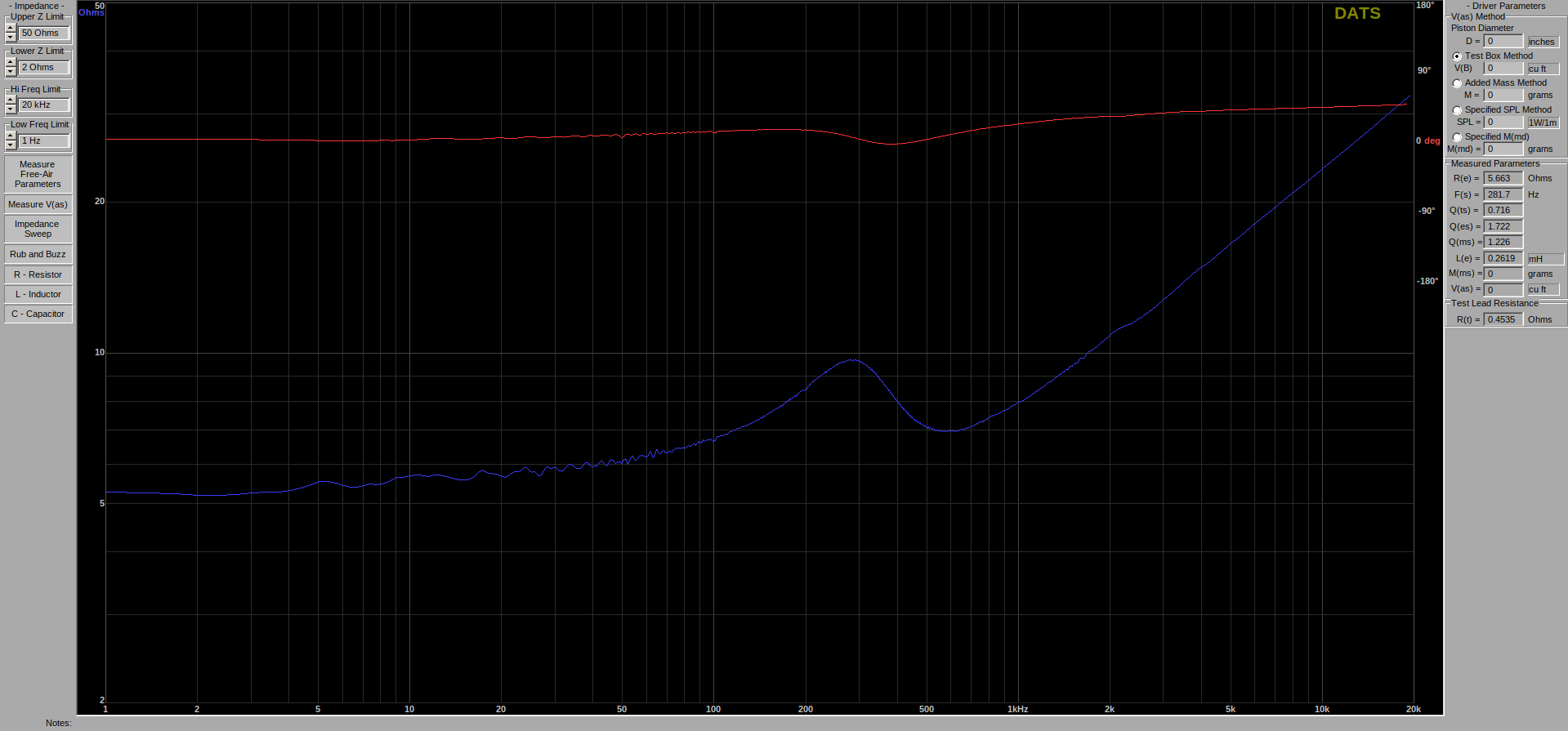

Here's a DATS Z-scan of one of my P13WH
It's probably worse thn usual - it's been stored at ca. 10 °C for quite a while...
Still fs = 281Hz is an impressive degree of degradation

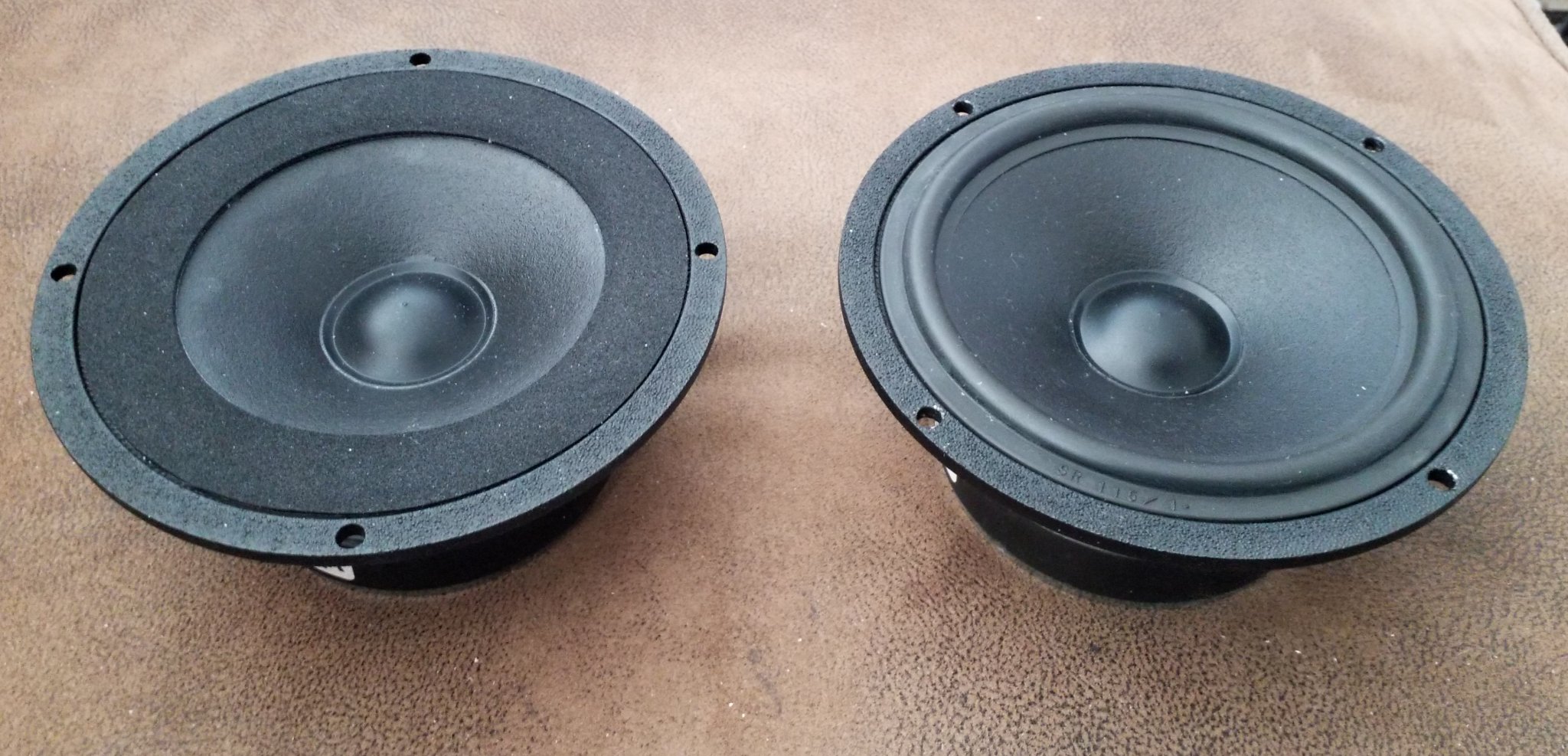

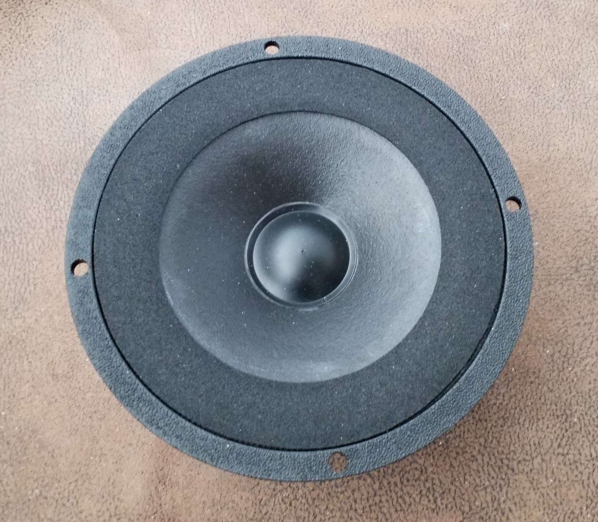

Patience. The glue is thermoplastic, a bit of warmth helps too. I usually start peeling with a scalpel, then pull very gently.
I put a new blade in my scalpel, cut & pulled up a end, and the surrounds came off in one piece. Easier than I thought.. I usually start peeling with a scalpel, then pull very gently
I ordered the EC 113A surrounds from the eBay site linked above. They arrived in a few days.
They are much more soft and floppy than the originals; the outer flange section is about 1.2mm thick; ca. 0.5mm at the Roll; and ca. 0.3mm where it attaches to the cone.
It will require a lot of care to mount them accurately to the cone, I suspect.
