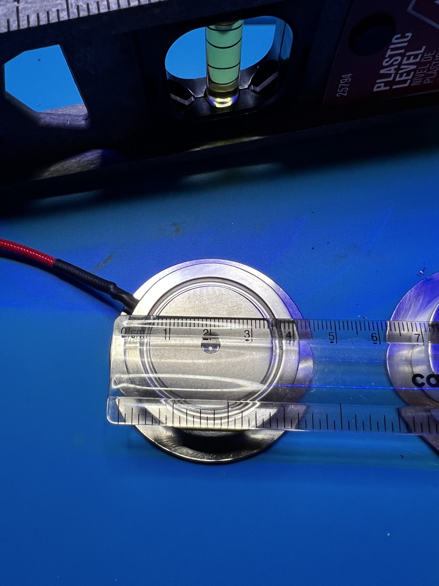

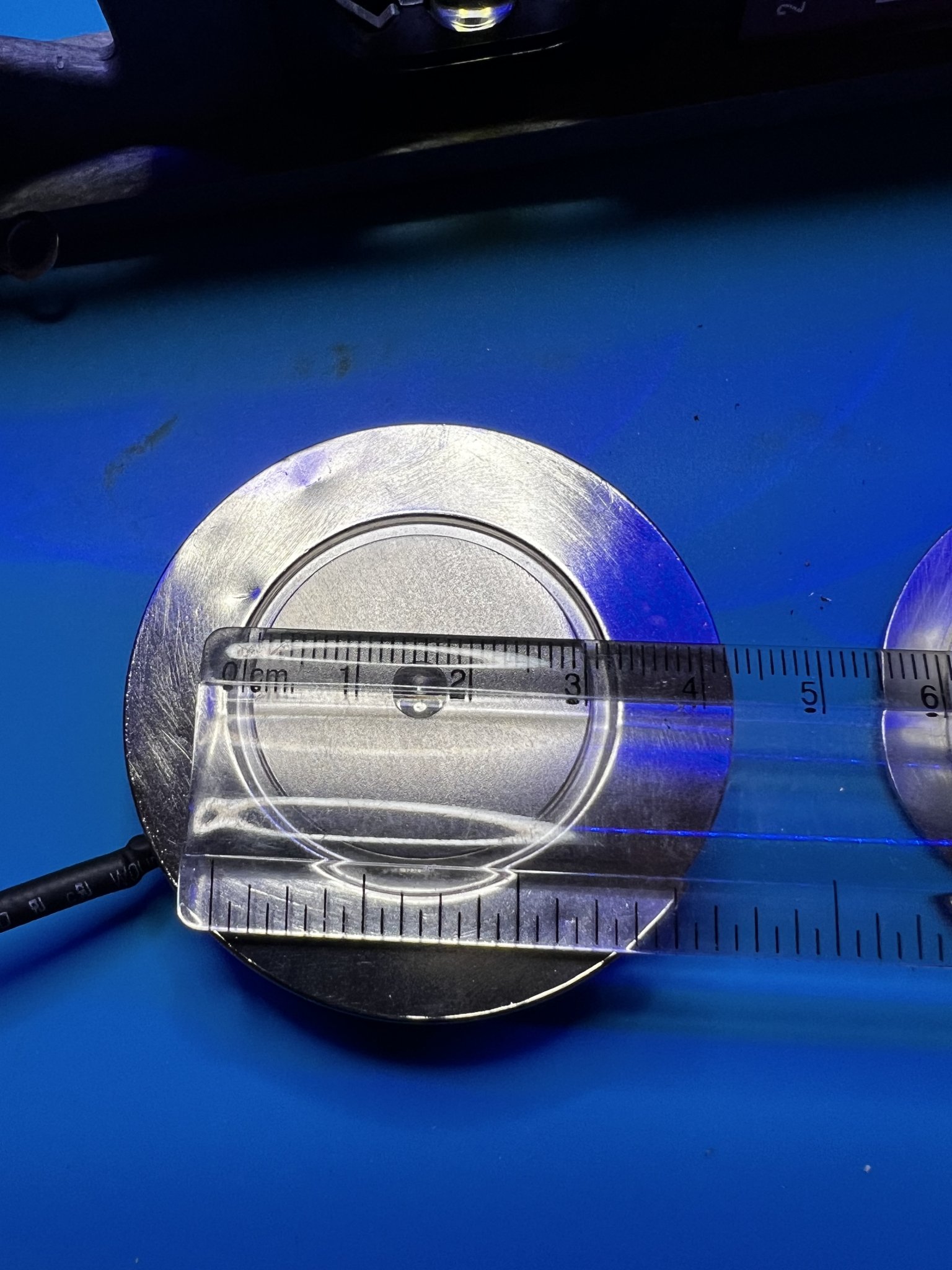

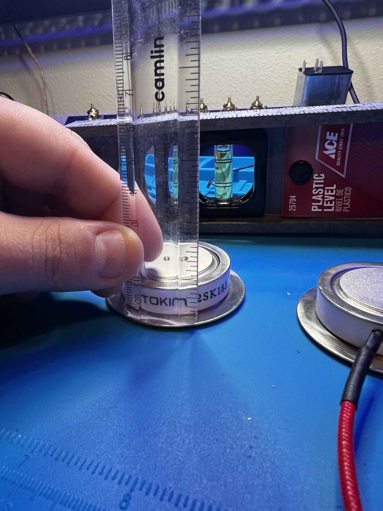

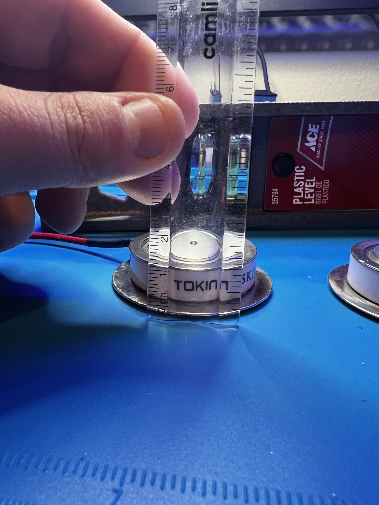

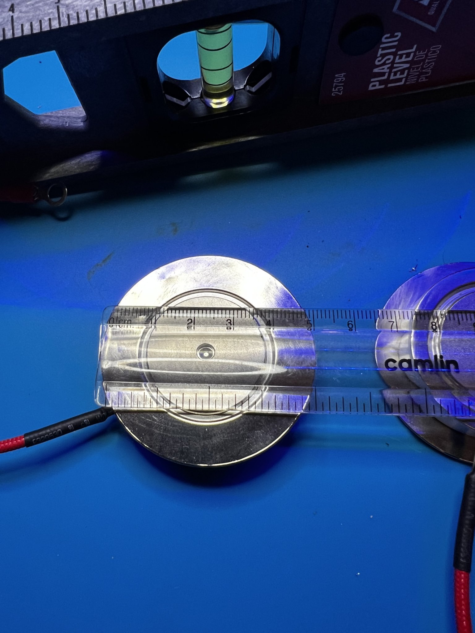

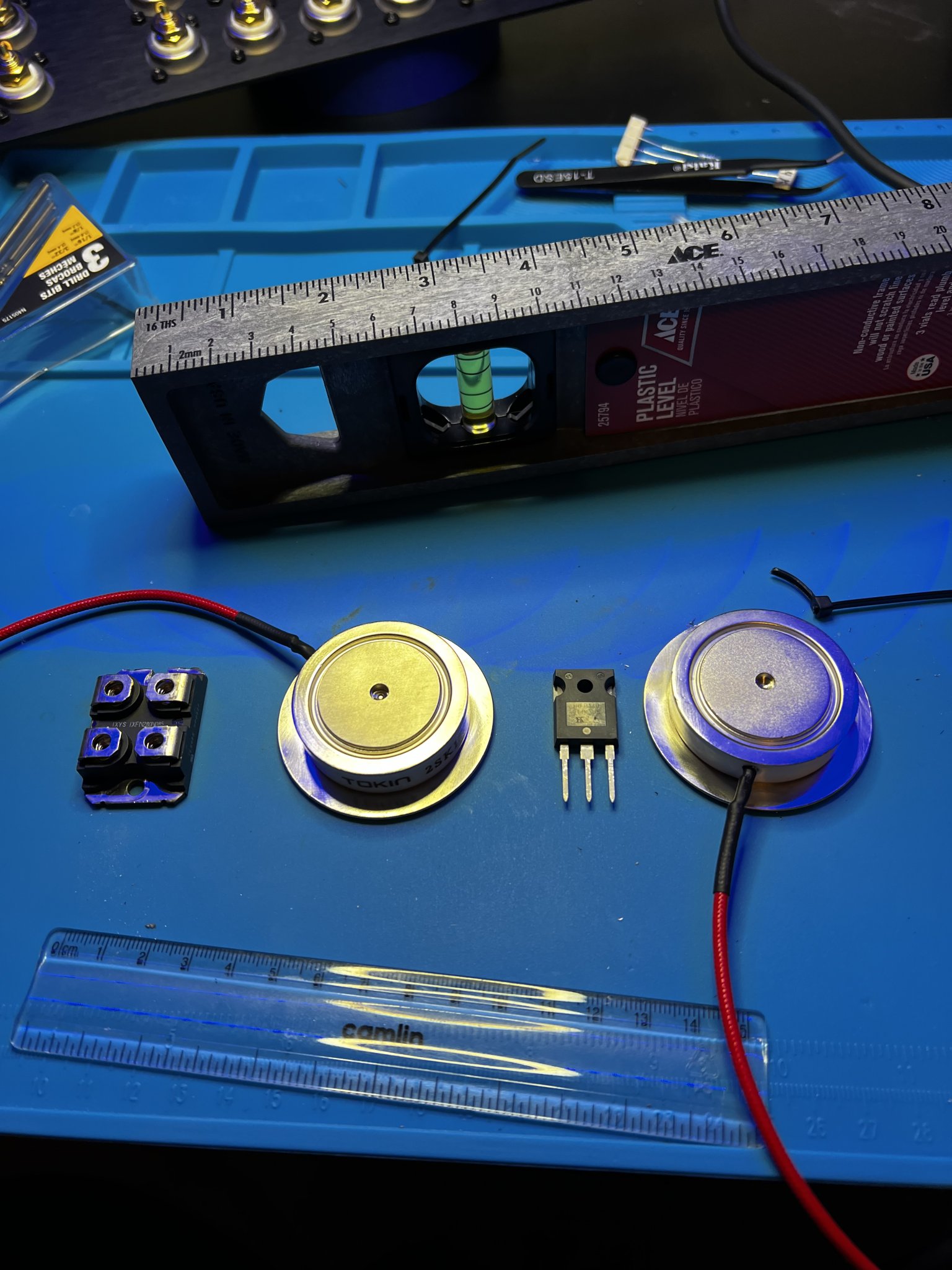

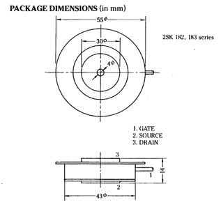

The very crude measurements that I took checked out. The skirt measures 55. Drain measures 30. The source measures 43.

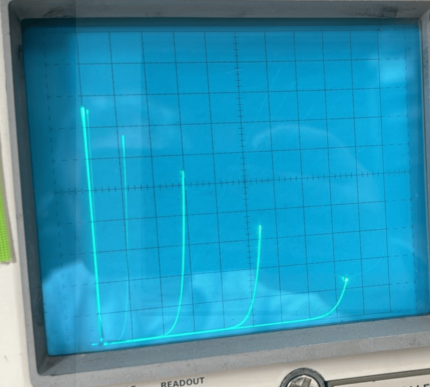

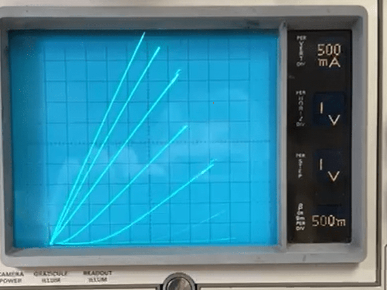

As far as testing, I have someone willing to curve-trace them for me. I'm just trying to ensure that they are real before I send them his way, not to waste his or mine.

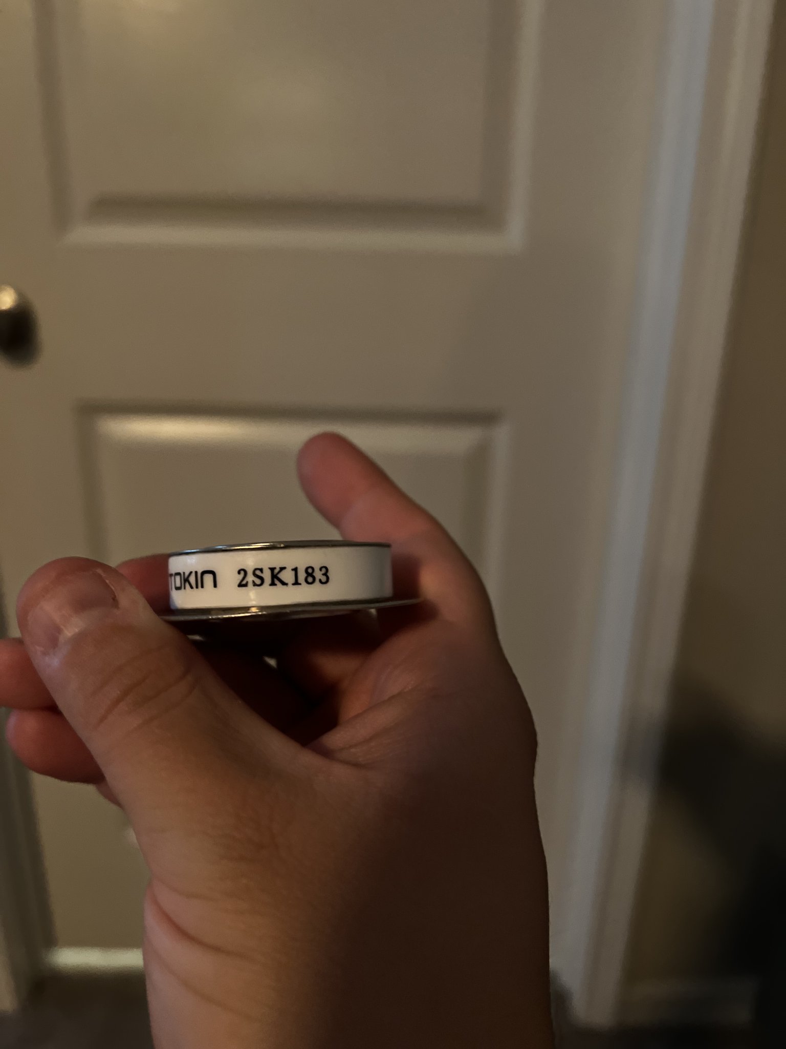

The only thing that I am unsure about at this point is the lettering. Usually, most I have seen only have Tokin on one side and the part number on the other, this one has it together. It looks like a newer part...
bigger circle plate is Drain, smaller is Source, wire is gate
though - hoping they're real deal, good luck with heatsinking arrangement
using Keratherm 86/82 as pad for drain, same for source, I should go with squeezing it between two heatsinks
or if luck is on your/our side, maybe it's possible to use just one side heatsink - for Drain; then it can be clamped with - say - proper plate made of aluminum sheet (at least 3mm thick) isolated with piece of bare pcb material
that, not going above, say, 100W of heat per device
for more, I would go with non-isolated direct contact, heatsinking on both sides ..... which means heatsinks isolated from chassis
all that, trying to recall in memory few pics of same ones in some industrial assembly ......... I believe it was Soundhappy who posted those
Oh boy... instead of getting my Furious amplifier builder badge.. more like a foolish amplifier builder badge.
So essentially I have two live heatsinks, one for the source and the drain?
It should be fun, If I don't screw it up somehow.... :clown:
or if luck is on your/our side, maybe it's possible to use just one side heatsink .......
that I meant - with Keratherm sheet as isolator; need to be confirmed with proper measurement, allowing no more than 10C of difference between drain plate and heatsink ditto to drain body
and .......... I wouldn't go without hefty follower as driver, say 30mA of Iq or more
