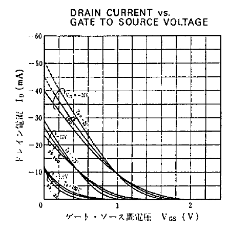

The complete Nippon Electric Company's V-FET "portfolio" (scanned from photocopies of their 1977 data book, hence the crummy look)

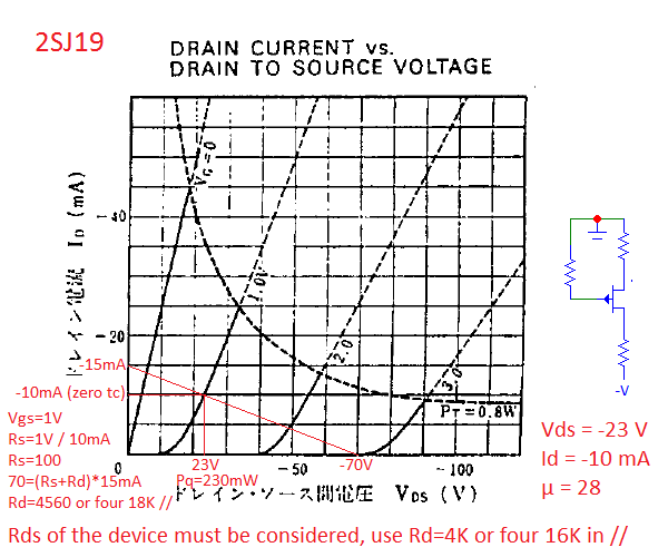

Thanks, it looks fine. Very interesting devices. The 2SJ19 has TC=0 @ -10mA
-Alex

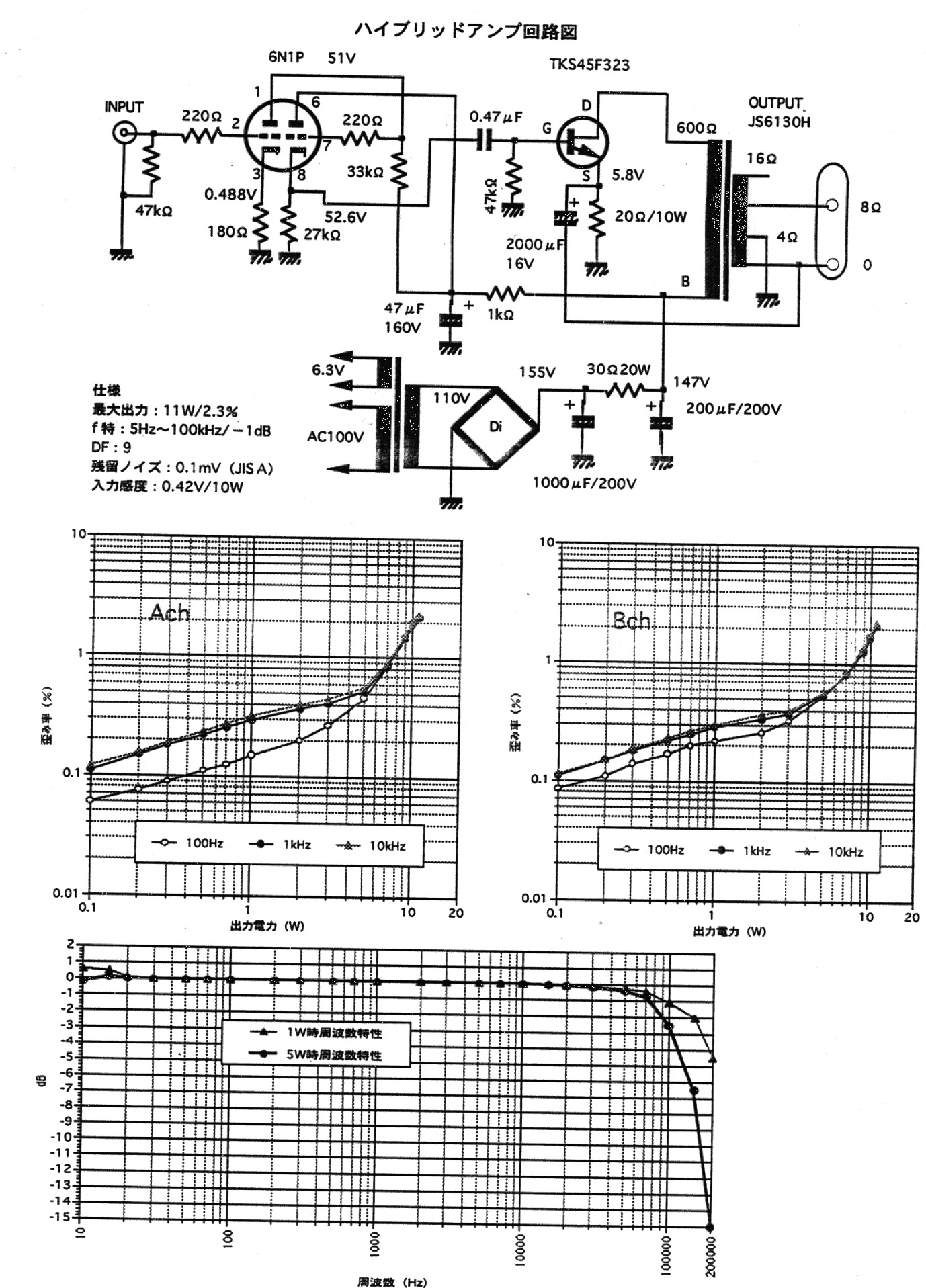

Example: SITampよしださん、ありがとうございました!

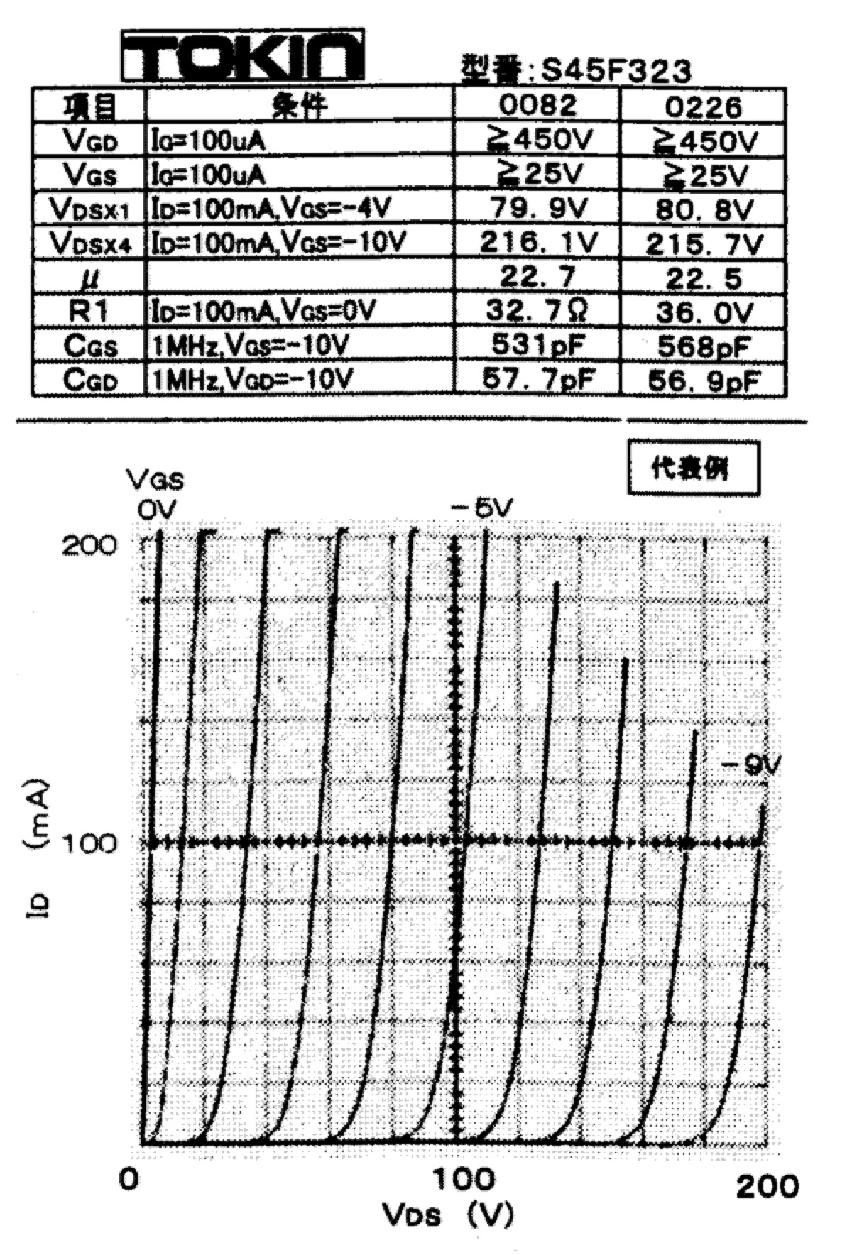

Have you ever seen those Tokin parts in person? 🙂
Edit: SITamp DIY schematics

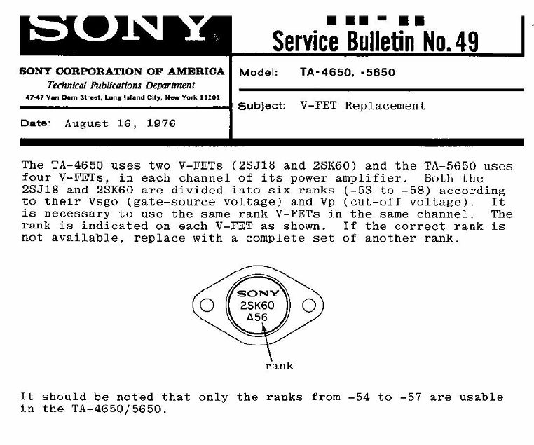

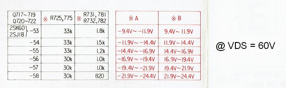

2SJ18/2SK60 ranking
Sony has been extremely shy in providing more elaborate details on their VFETs beyond the standard properties, let alone about the exact details behind their ranking system. However, the TA-8650 service manual provides a table with a hidden clue to their ranking system, as attached.
A/B are the DC gate voltages Vg, with Vds at 60V.
At the given Vg values, the VFETs are of course on, hence (slightly) above the pinch-off voltage.
Which makes me wonder if the second ranking number (3,4, etc.) simply means a factor of 2.5V for the Vp
Hence, the pinch-off voltage of rank 53 being 7.5V, etc.
It would make sense...

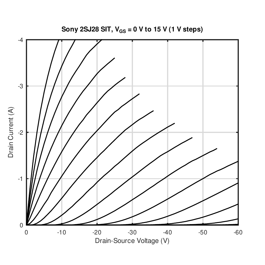

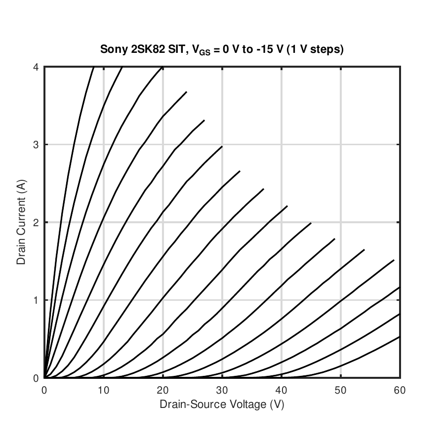

The single dies inside those are the same as utilized inside the 2SK82/2SJ28 duo, however as far as I know the 2SK82/2SJ28 par was only used in the Sony TA-N88 PWM amplifier until Nelson Pass designed his CSX class A pair.
Any clues on max. voltage, current and power for the Sony 2SK82 / 2SJ28 parts? "Hard" specs, educated guesses, and wild thoughts are all welcome!
True. Is there any information available on the "ranking codes" for the 2SJ28/2SK82? The parts I tested have labels "JD-33" (2SJ28) and "JE-33" (2SK82).
