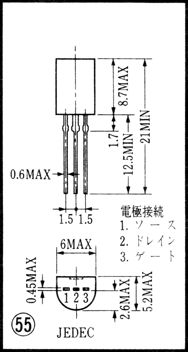

Just to corroborate mbrennwa's findings [1. Source, 2. Drain, 3. Gate]:

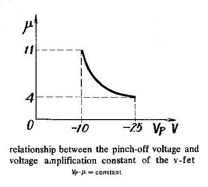

Will add SIT µ-chart from Sony. It says that lower digit grades will have higher µ.
Well, at the expense of the higher drain output impedance Rd. (µ=Gm×Rd)

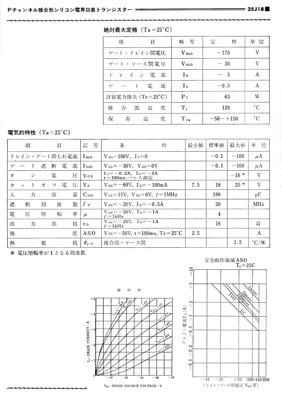

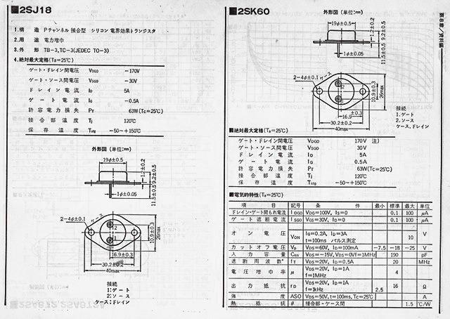

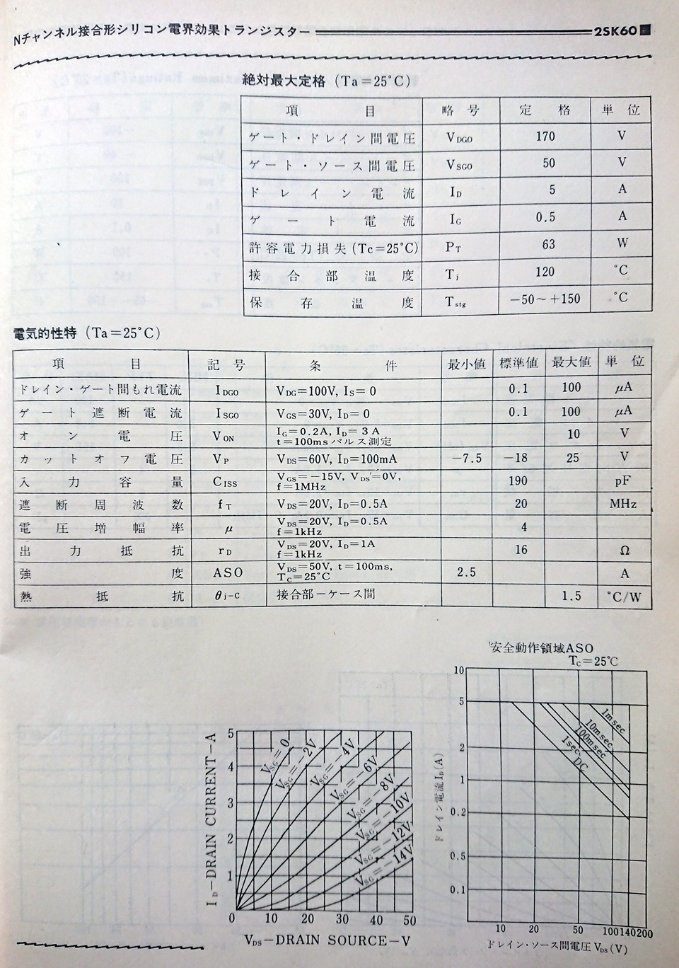

2SJ18/2SK60 ranking
Sony has been extremely shy in providing more elaborate details on their VFETs beyond the standard properties, let alone about the exact details behind their ranking system. However, the TA-8650 service manual provides a table with a hidden clue to their ranking system, as attached.
A/B are the DC gate voltages Vg, with Vds at 60V.
At the given Vg values, the VFETs are of course on, hence (slightly) above the pinch-off voltage.
Which makes me wonder if the second ranking number (3,4, etc.) simply means a factor of 2.5V for the Vp
Hence, the pinch-off voltage of rank 53 being 7.5V, etc.
It would make sense...
The above voltages should be reduced by around 0.1V and considered as Vgs voltages at Vds=60V and Id=177mA. This can be calculated from the circuit working parameters (rail voltage, bias current, voltage drop on the source resistor).
One rank 'bracket' is indeed 2.5V but it does not directly connect with the pinch-off voltage, which is actually quite difficult to define for a VFET because at some point the Vds will be enough for Id to rise (even at close to Vgs breakdown voltage!).

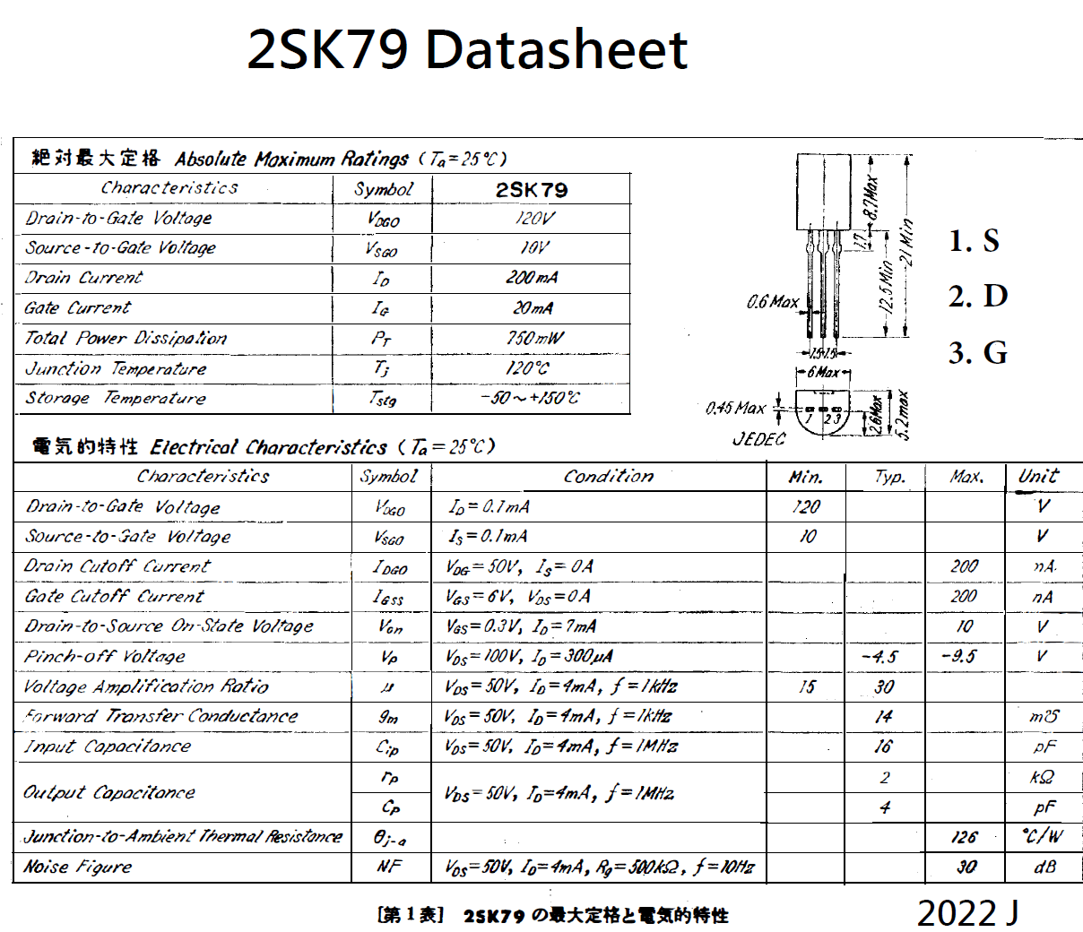

Revised Datasheet of 2SK79.

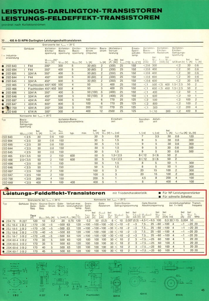

Some of the members here may want to investigate SIT program of the German
semis manufacturer Ditratherm (in the '75). They were made and marked with V###.
Sansui had to switch to this supplier (after NEC) with V132, V133 outputs.
TO-39 cases were, presumably, V214, V215. There were also V#### numbers,
maybe mosfets... I have noticed their mid-70s catalog in one Berlin National
library (with a membership fee...)
DITRATHERM, 1962, Elektronische Bauelemente Türk & Co KG,
8300 Landshut/Bayern, Ludmillastraße 23/25, Bundesrepublik Deutschland
Finally got around to this ==> the 1962 catalogue is too old to be of any use as that's way too early for VFETs, but I managed to find their 1978/79 catalogue which should be juuust the right vintage, unfortunately, it doesn't list any V### parts, only the well-known Sony VFETs. Which I consider a bit... suspicious. Could it be that Ditratherm's V### parts were just house-numbered Sony VFETs...? 🤔

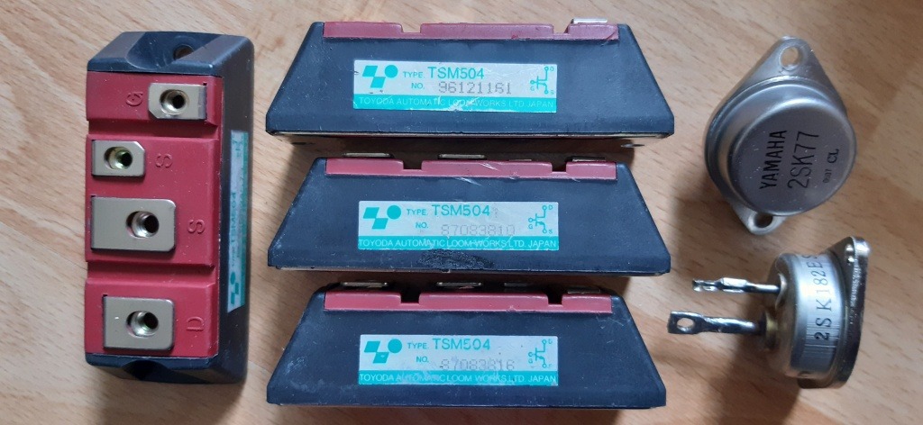

I looked into this too ==> couldn't find any commercially available SITs made by Hitachi, but speaking of Prius: Toyota, or - to be precise - Toyoda Automatic Loom Works [the parent (?) company of Toyota] does (did?) manufacture a range of SITs, e.g. TSM001, TSM002, TSM003, TSM504 or TSM506, and while the Tokin SITs were (supposedly) made to power elevators, the Toyoda parts were used in forklifts, hence, they're a wee bit larger. 😉 UNFORTUNATELY, despite the highly desirable SIT logo the TSM modules are marked with, they appear to be of the BSIT persuasion (bipolar-mode SIT with pentode-like curves).
I personally tested only TSM002 and 504, so there's still a chance one of the other part numbers could be a "proper" SIT - they can be found easily AND cheaply enough on eBay or Ali, but I suspect most of them are at least remarked if not outright fake (mine came from a trusted source, and every one of them has a unique numeric code / serial number, but in the photos online where there's more than one module shown they usually have identical numbers), so proceed at your own risk.
Forgot to add: I couldn't find a single data sheet for these online, so I contacted Toyoda, and was told this information were not available to the public... 😛

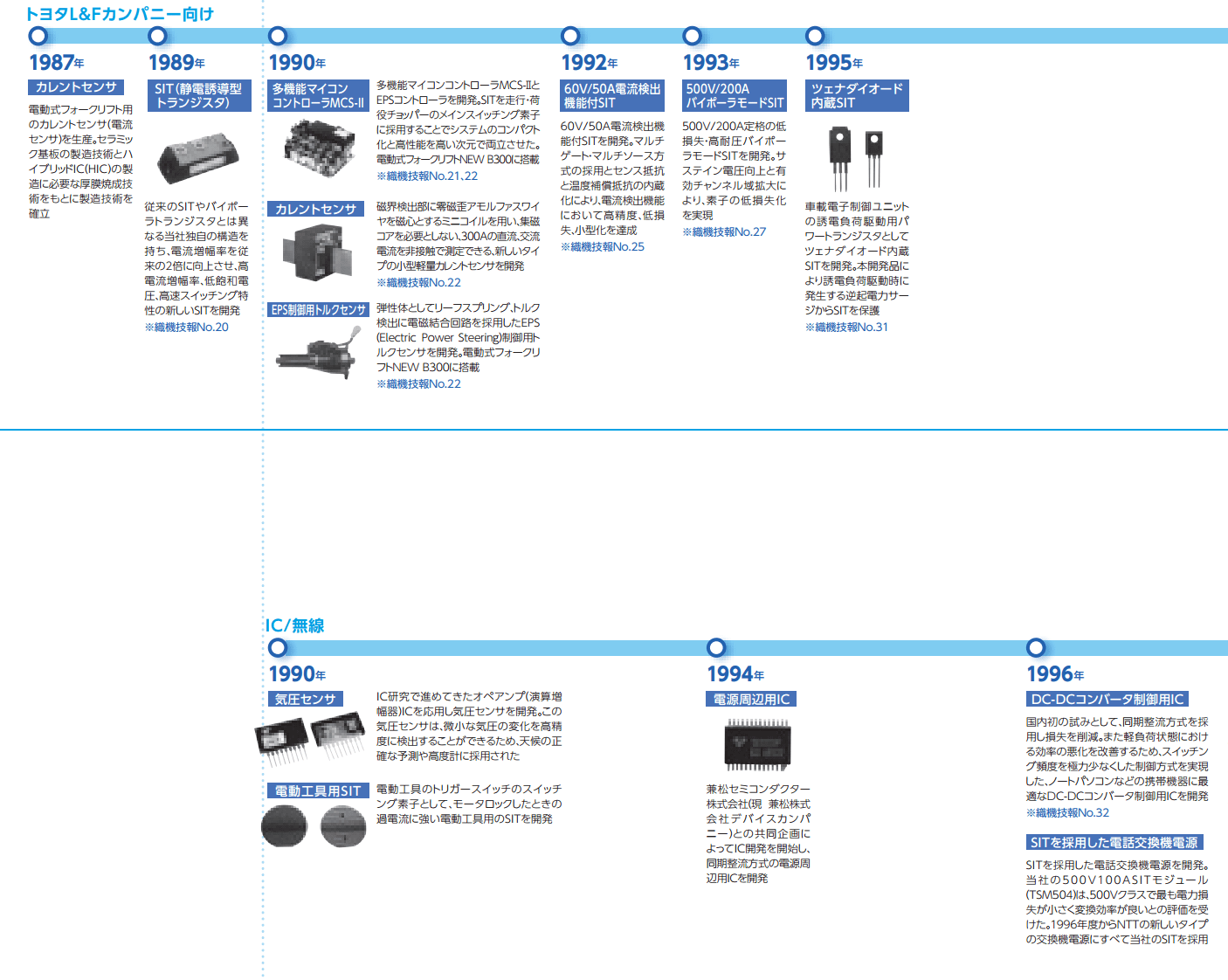

One more update: The link to the document the first image comes from.

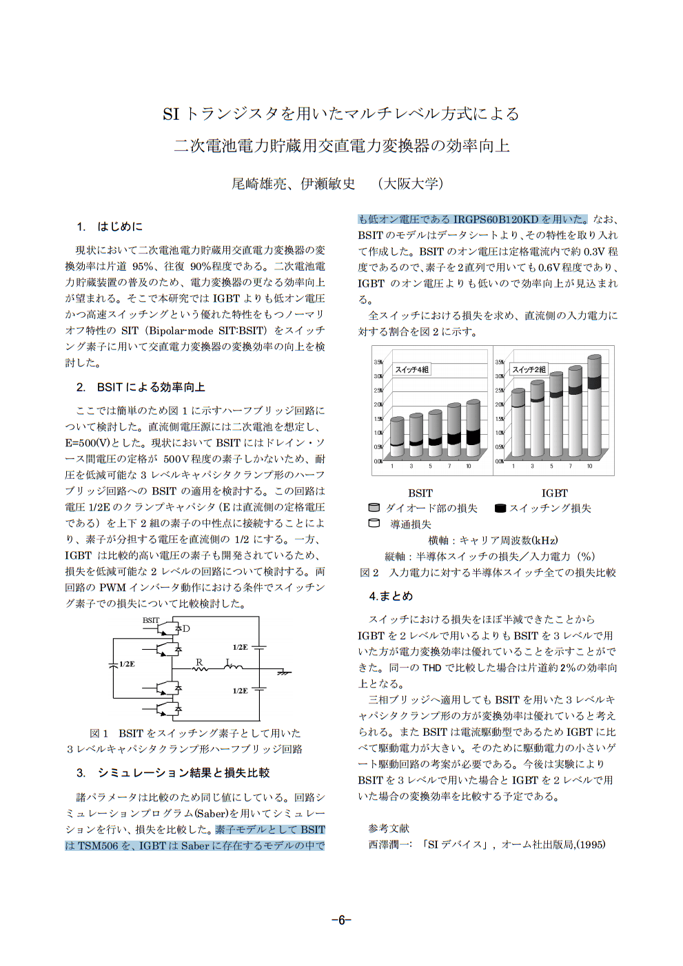

Update: TSM506 should be a BSIT too. That leaves TSM001 and 003 + the small buggers in what looks like TO-220 / TO-126 packages, whose part numbers I was unable to identify, unconfirmed...

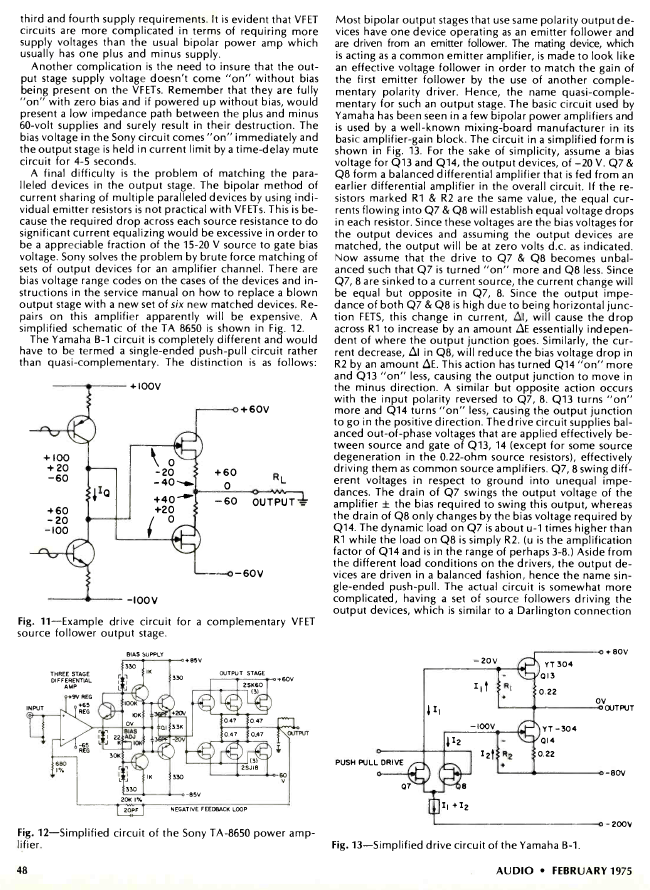

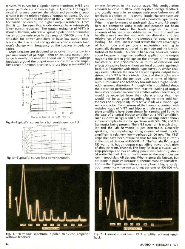

For me the advantage of these transistors is to use them (low power ones) as a voltage gain stage.
The biggest mistake of Sony with their SIT amps is that they used SITs only for the output power
stage, where the linearity is not as important (they work as source followers and with negative feedback),
so all lateral MOSFETs (made by Hitachi, Semelab, Exicon) can do this job even better. The most important
advance of SITs is that they can work without any negative feedback keeping distortions at low level due
to their triode like characteristics. This advantage was never used by Sony and Yamaha.
Reactions: Svjatoslav
Yes, but they are for high power, we are talking for the 1st voltage gain stage.
I have my own schematic of a two stage single ended class A amplifier.
The first stage is 2SK79, supplied with 115V, the second stage is a source
follower with 2 matched Exicon lateral mosfets ECX10N20, supplied with
31V (24VAC rectified and filtered). Distortions at 13.5W/4ohms are about
1%, mainly 2nd harmonic. Without any negative feedback.

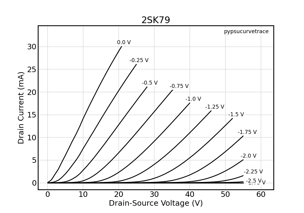

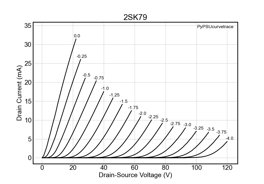

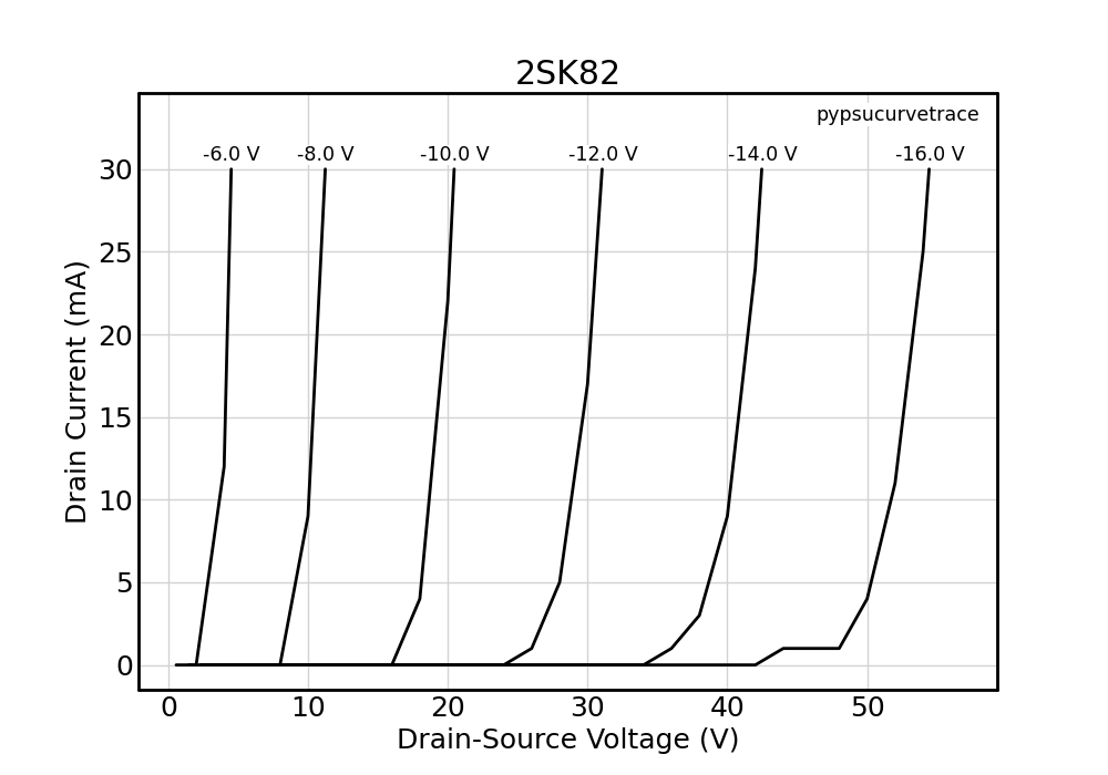

@pinholer Take a look at the attached curves measured from a 2SK79 and a 2SK82, plotted using the same x and y axis ranges. As you can see, the 2SK79 has much better linearity and more gain than the 2SK82. As mentioned by widowmaker, the 2SK82 is meant for higher power applications. (Sorry, the 2SK82 curves are a bit wiggly, because the measurement resolution was set for the typically higher power levels of this part.)

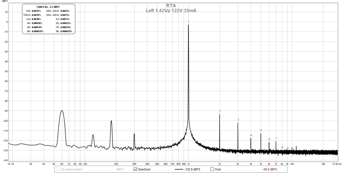

I have built several SIT amps using the Sony 2SK82 or 2SJ28 as voltage amplifiers. I also have a choke loaded LuminAria preamp using 2SK82s. My experience has been that operating these Sonys at high voltage can produce amplification with low distortion and large voltage swing. Great for driving source follower output stages.
Certainly, these Sony power VFETs may not be as good as 2SK79s, but I don't have any 2SK79s, and I have a number of the large Sonys.
Here is an example of the measured distortion of a 2SK82 choke loaded amp operating at 122V, 35mA.

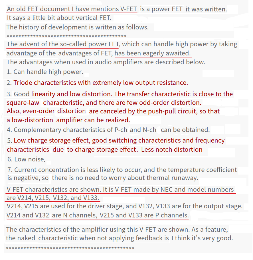

I will go back to Ditratherm story in post #63.
I saw that info in one document originated in Asia, which looked reasonably credible,
and, of course, requiring investigation.
Recently, I have clarified the origins of the V### V-FETs - it is from NEC - their development
parts numbers (for the registered 2SJ19_20_21 / 2SK69_70_71).
