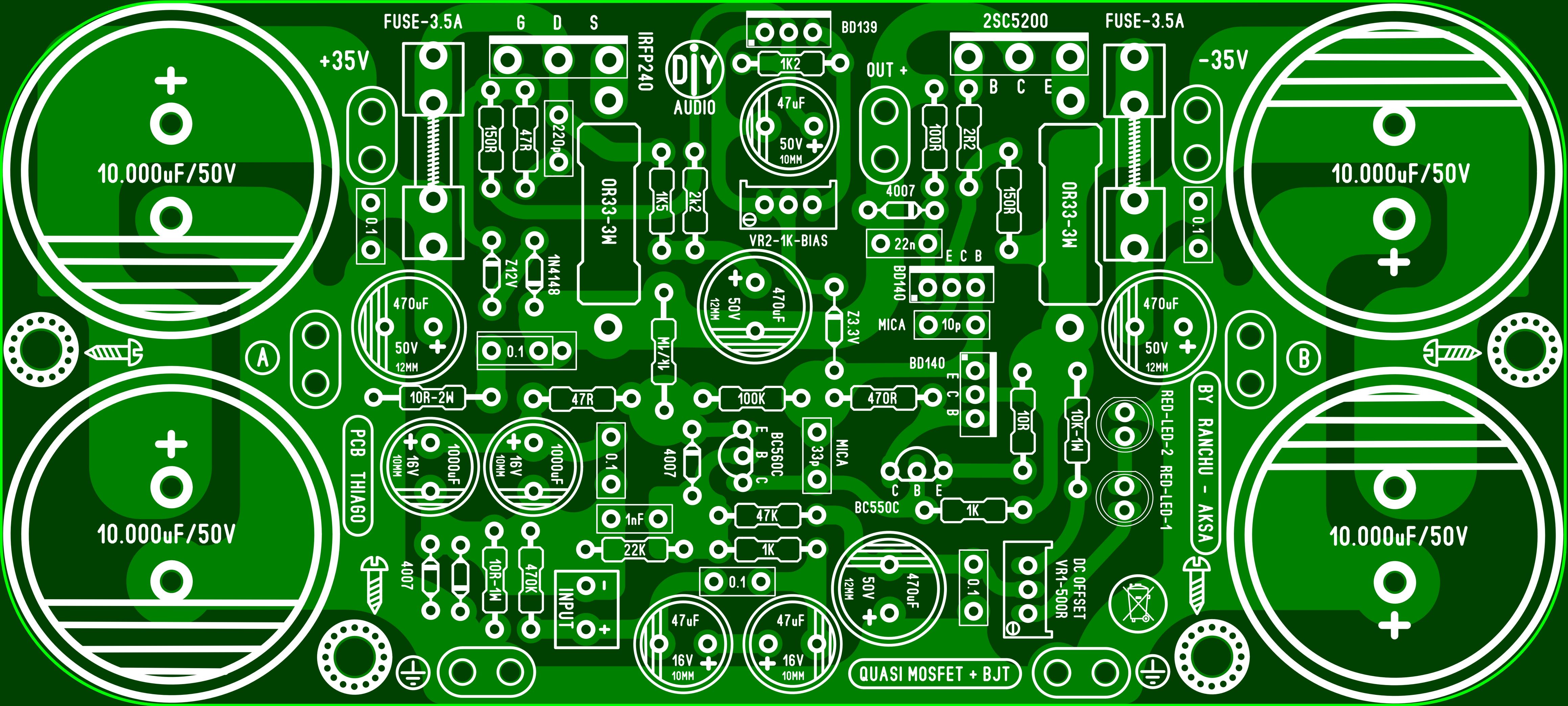

Hallo Ranchu and Prasi.
I also would etch your PCB, but the newer printer works so bad and i will not spent
money to new one- so i ordered, thanks your shared Files.
To Ranchu and you prasi, Thimios too and other i only can congrat to your creativity.
I am and Patrick, i hope also, are one the way to build, if boards received.
At moment i print the schematic and look wich parts are needed and reread where i must have attention.

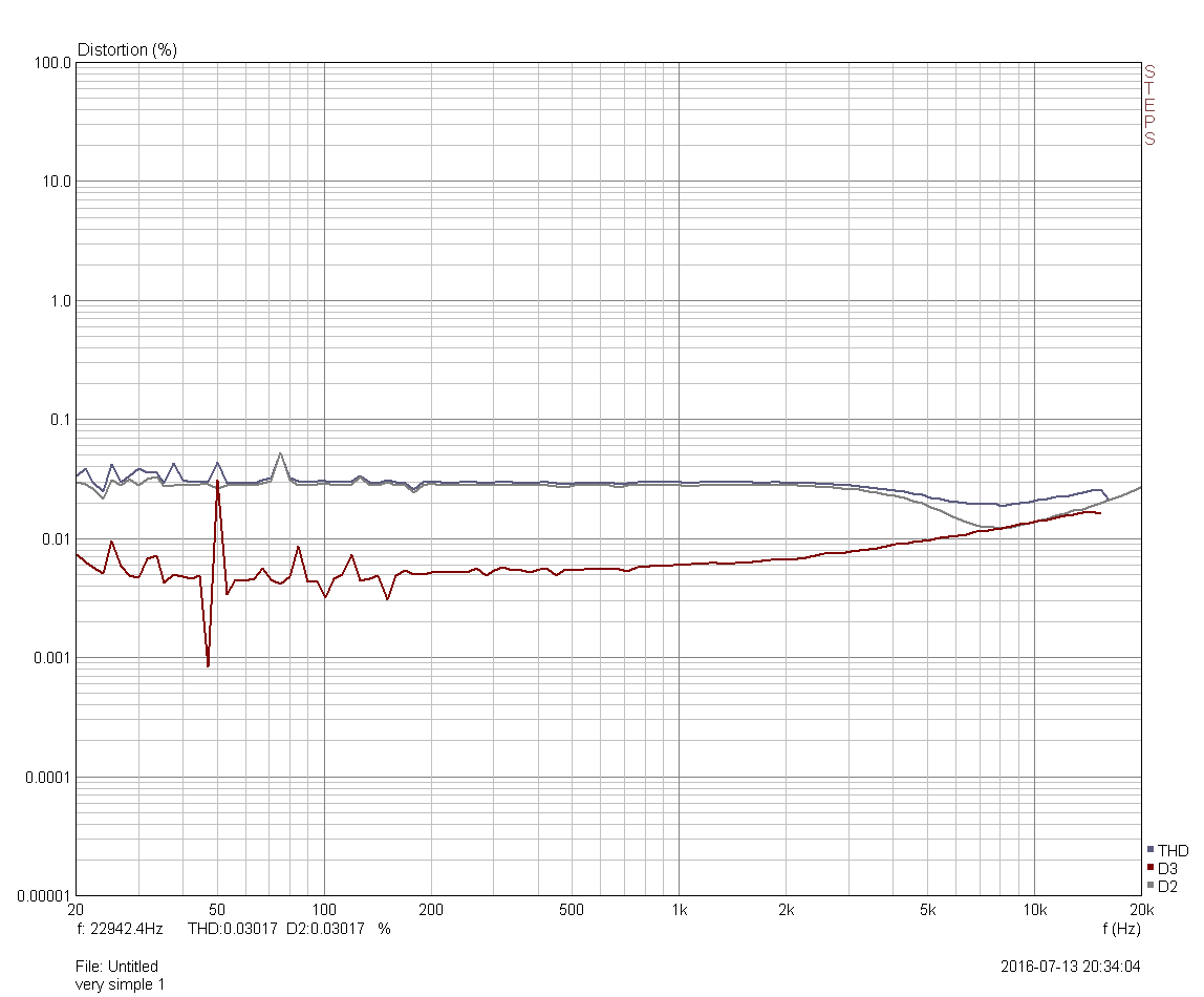

D8,C9,R19 back in position.
Now the Vbe multiplier is in normal conditions.
Trying to figure the distortion graph i see that one channel have a lower distortion than other. Same idle current,same offset,same levels,same power supply.
Duple checked.
Is this as a matter of transistors hfe ?
