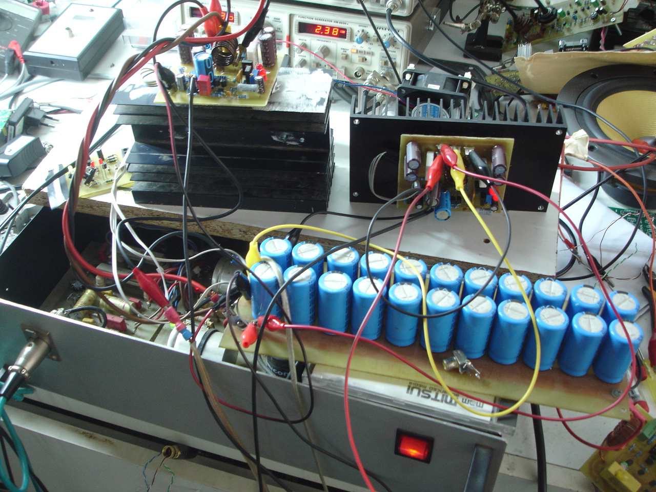

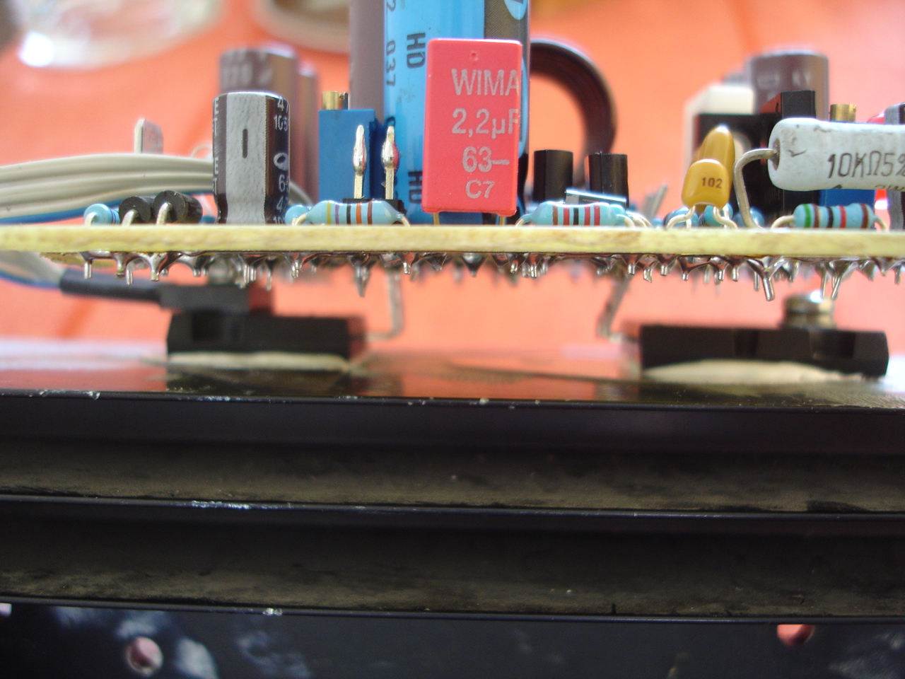

Now,here is this singing second channel,keeping empty positions for D8 C9 and a link in position of R19.
Prasi,i used the 1st ver.bords.
I don't know is the 2nd version. has improved for extra space between feedback capacitor and input capacitor.

Yes Thimios, reduce the single resistor between collector and base on the Vbe multiplier. You are using 1k2 so bring it down to 820. You need to bring it down to 120mA where it will sing at its best!
That will bring down the quiescent a lot and give you more range.

Hi Hugh,putting a second resistor(2K2) in parallel to 1K2 (result is 776R)I endet up with 0.042V on the emitter resistor(0.33R) when trimmer 1K is at max resistance,do you think that this new resistor must be even lower?Yes Thimios, reduce the single resistor between collector and base on the Vbe multiplier. You are using 1k2 so bring it down to 820. You need to bring it down to 120mA where it will sing at its best!
