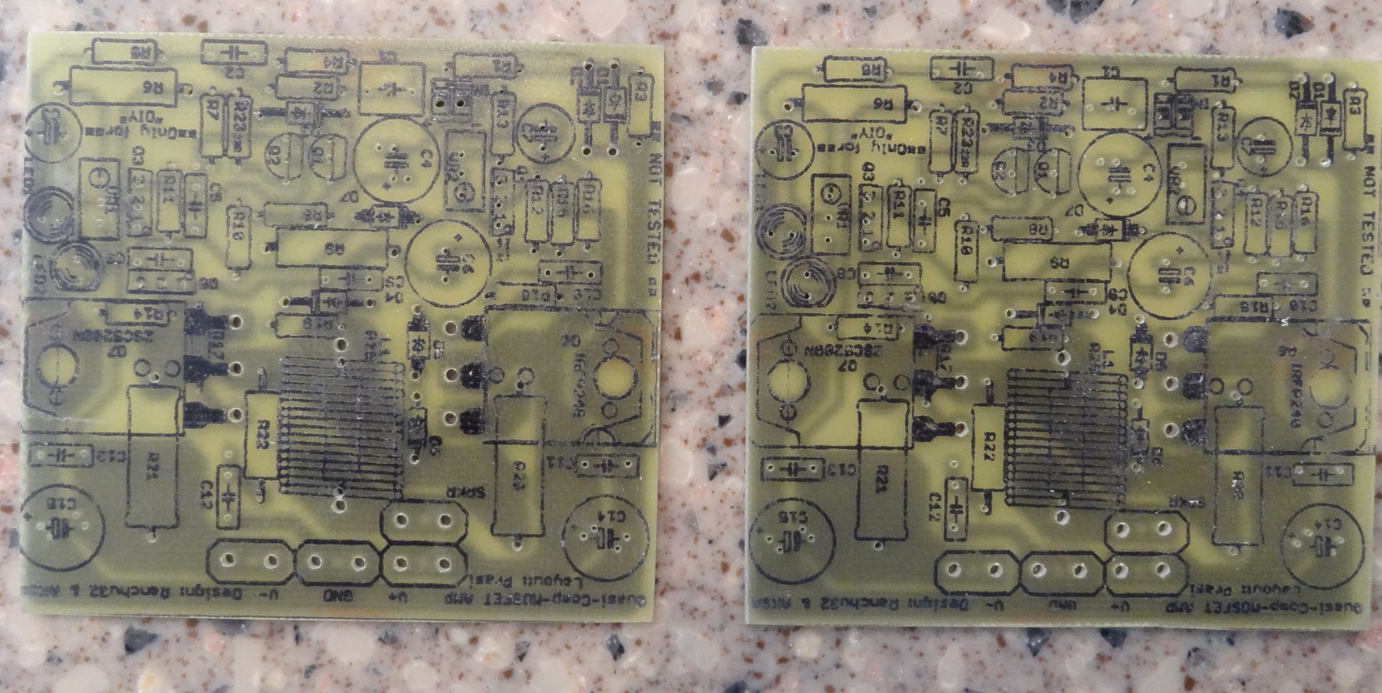

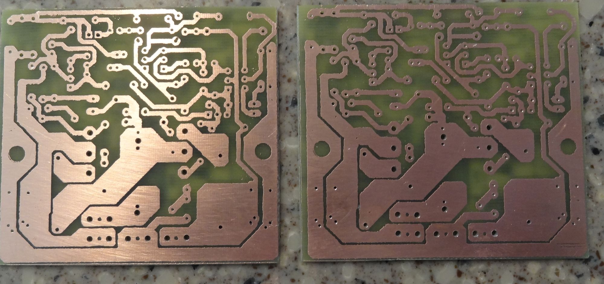

Very simple quasi complimentary MOSFET amplifier
I etched some boards. What is the best schematic? I've kind of gotten lost. :scratch:

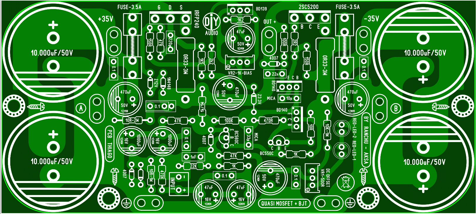

Hi Ranchu and AKSA ,
It would be a bad idea to put PSU CAP PCB amp ?
Any idea ?
Best Regards
Its a good idea to put the bulk decouplers on the PCB. 10,000uF caps are excessive. You would be more economical and improve performance if you used 4,700uF caps and insert some small R's (about 100mohm to 220mohm) to create a CRC supply
This layout you've done looks beautiful, but I worry about noise and hum with the bulk caps on both sides of the board. As you know, with a Class B amplifier, the output stage pulls heavy currents from each rail on alternating half-waves. This will result in heavy current through the ground trace, which runs across the board and very near the input stage, which is particularly sensitive to these disturbances. The ground lift will help to some extent but improved ground routing would be better.
Hi Guys
Mosfets tend to be more nonlinear at low idle currents, plus the circuit is highly asymmetric requiring higher idle to achieve reasonable performance.
I would suggest that the CRC supply idea be abandoned. It is good to have large local filters, and the use of multiple filters rather than single large filters is favourable. Keeping the supply impedance low over the audio band is preferred, even though there are examples from pass, Cherry, and others using CRC and CLC supplies. Those tend to be for class-A amps, or in Cherry's case, to enhance stability of a layout that might have marginal stability.
Have fun

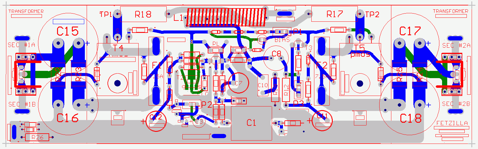

BTW, Christian, I agree, the FetZilla design would work extremely well and is fairly compact. Here is the pcb.
HD

Thiago,
I take my hat off to you, Prasi, and Alex MM. You three bring good ideas on this forum into layout reality; we need to foster this, along with incredible work from Terry, Thimios, Christian, Kevin, XRK and many others who build and listen........
We are very lucky to have you and others.
