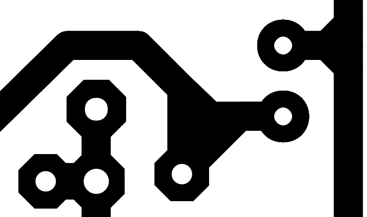

There's something proper about making a layout 'look and feel right' if you know what I mean. Electrical or not, it's that feeling when something is right that often makes a project special.
I get that feeling when I join all 90 deg traces and pads with a more elegant 45 deg angle. Dont know if its electrically significant but I like doing it and spend way too much time on it.
reg

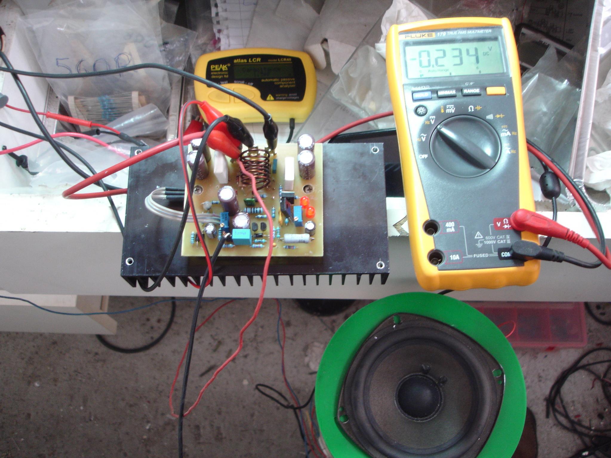

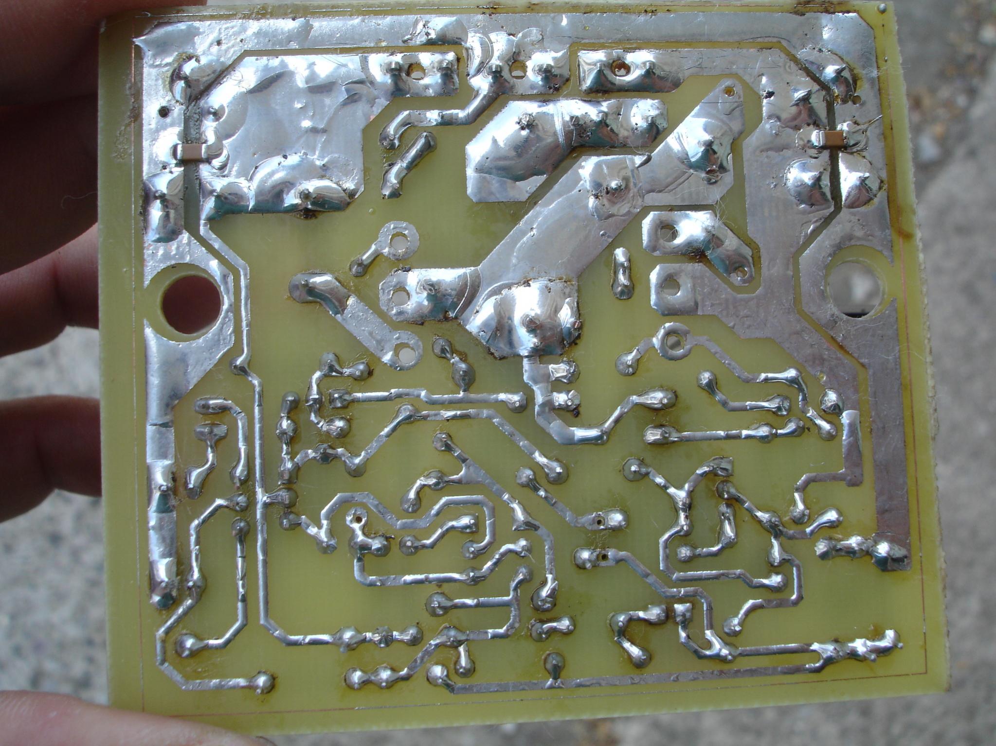

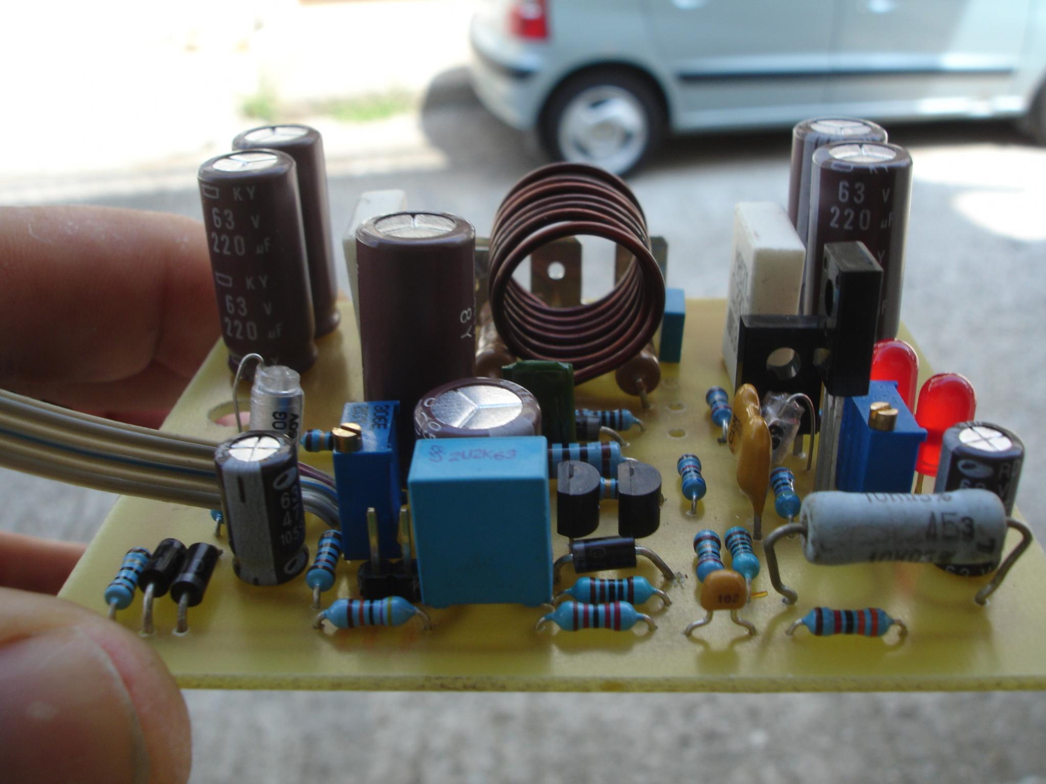

It is singing!

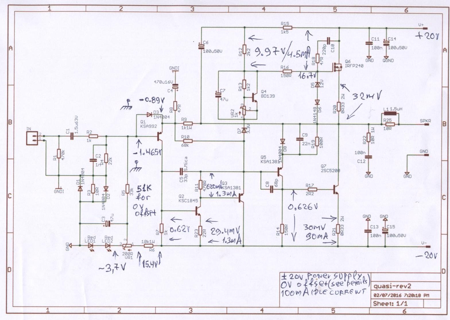

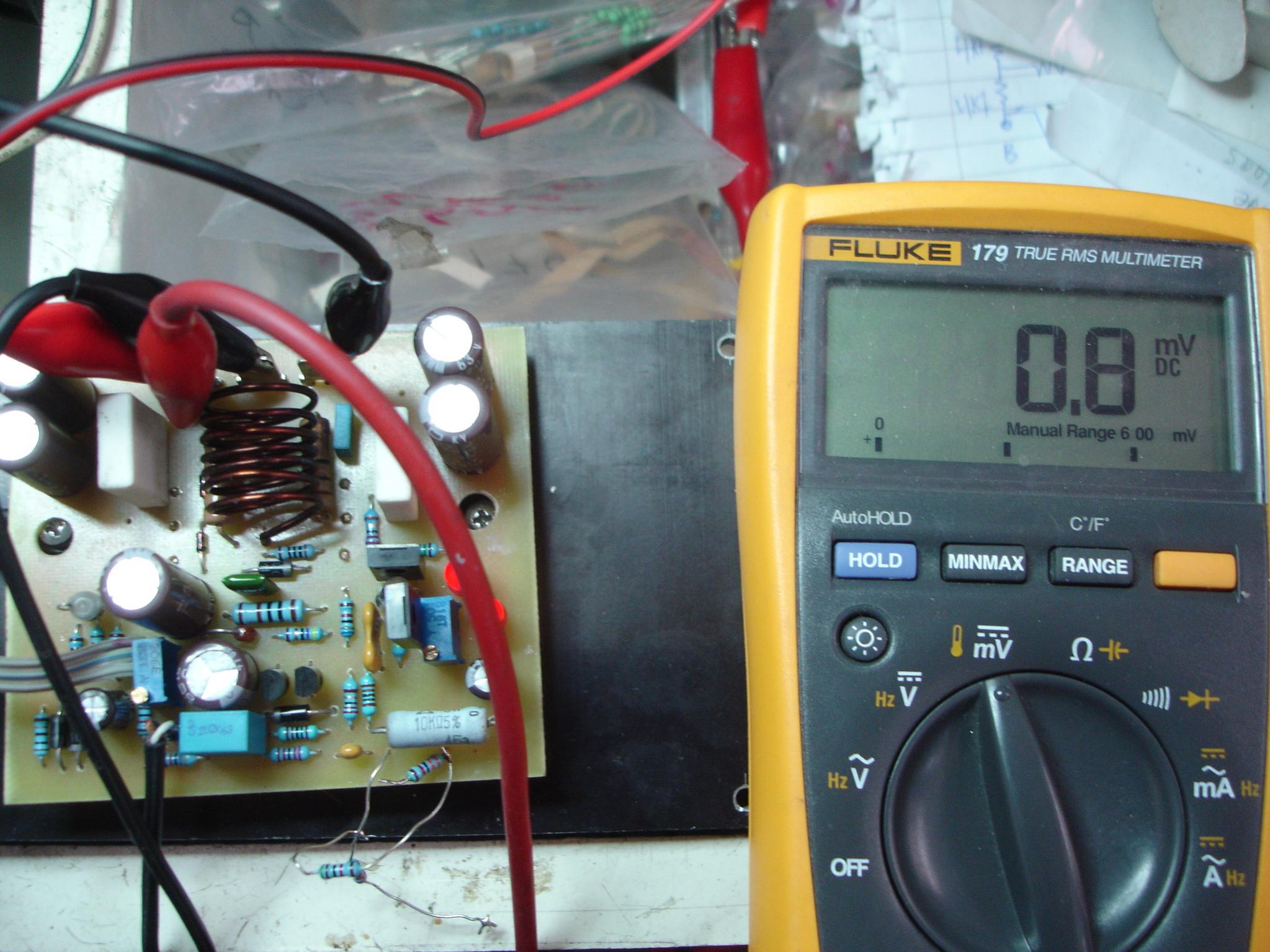

Using a 500R trimer for offset set i'm getting -250mV offset.
Increasing 33k to 51k it was possible to get 0mV.offset.

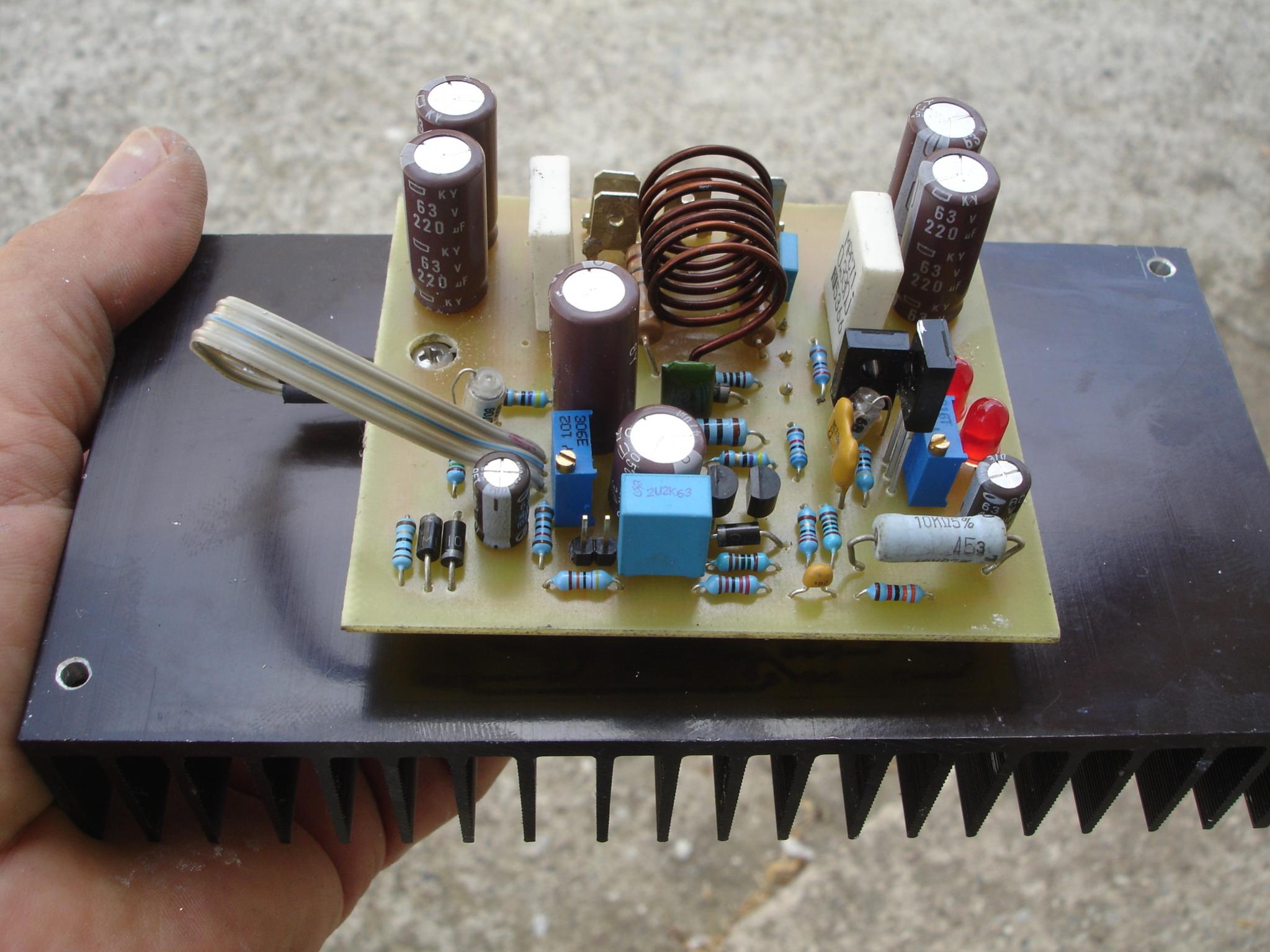

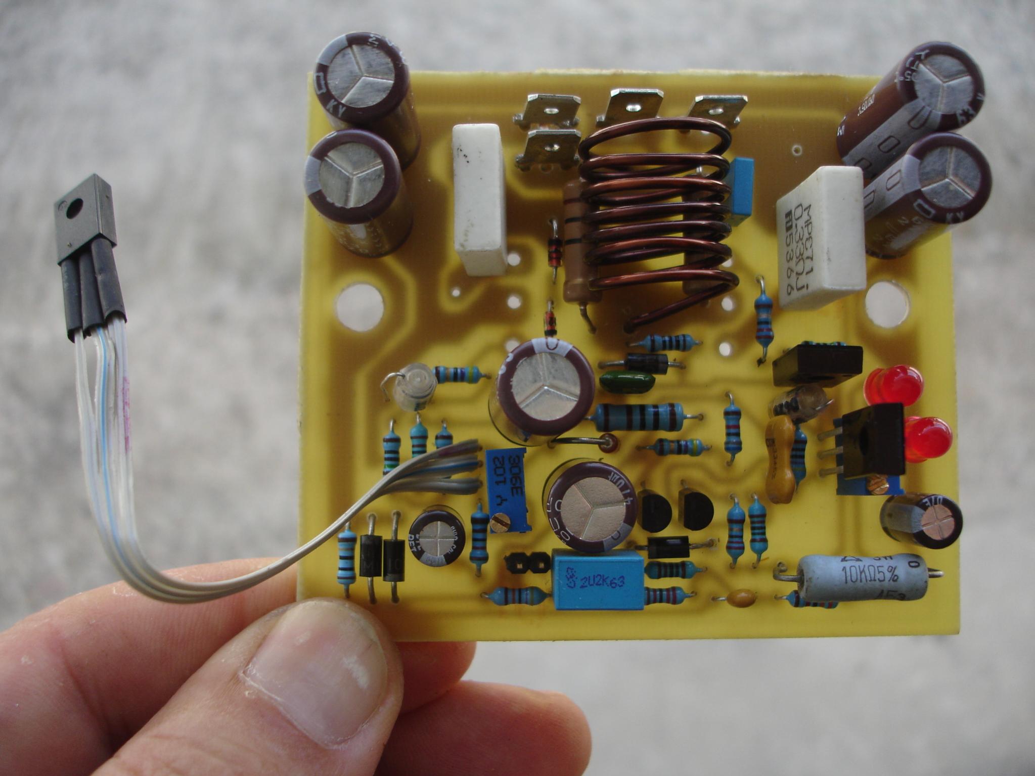

very simple
The rest.
1st Offset with 500R trimer and 33k to base of inp tran.(-250mV)
2nd increasing 33K to 51K.(0mV)
In this first test two regulated power supply was used starting from +/-10v and ended up to +/-20v

Great work Thimios & thanks for sharing pics!!
Different rail voltages will require some fine tuning of these values as you have noted.
Hi Ranch thanks you,AKSA and Prasi.What is the optimum bias setting?
What is the normal and what the maximum voltage for this amplifier?
My opinion about this amplifier (from a little hearing test) is that play lovely, something like a tube amplifier.
