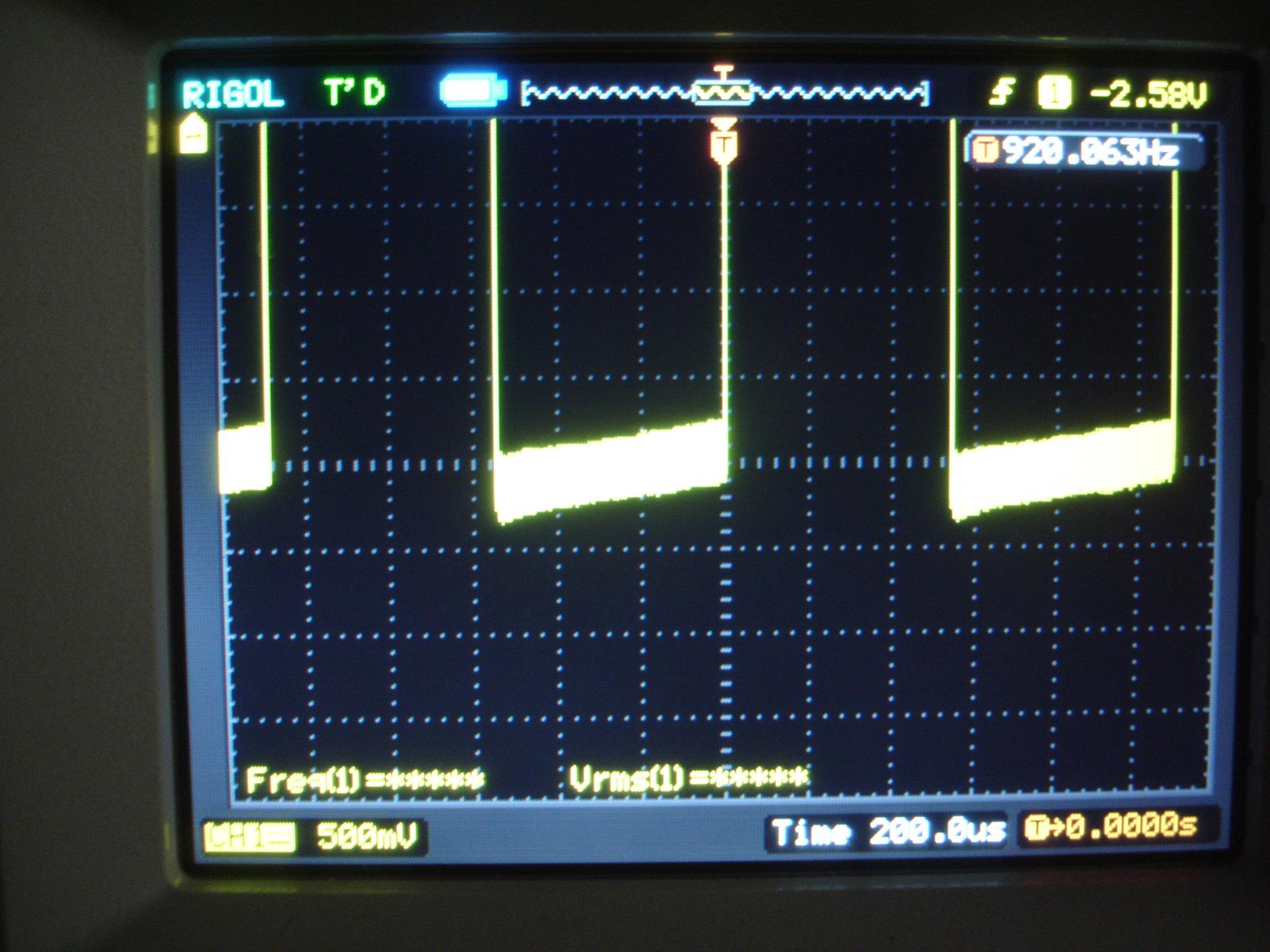

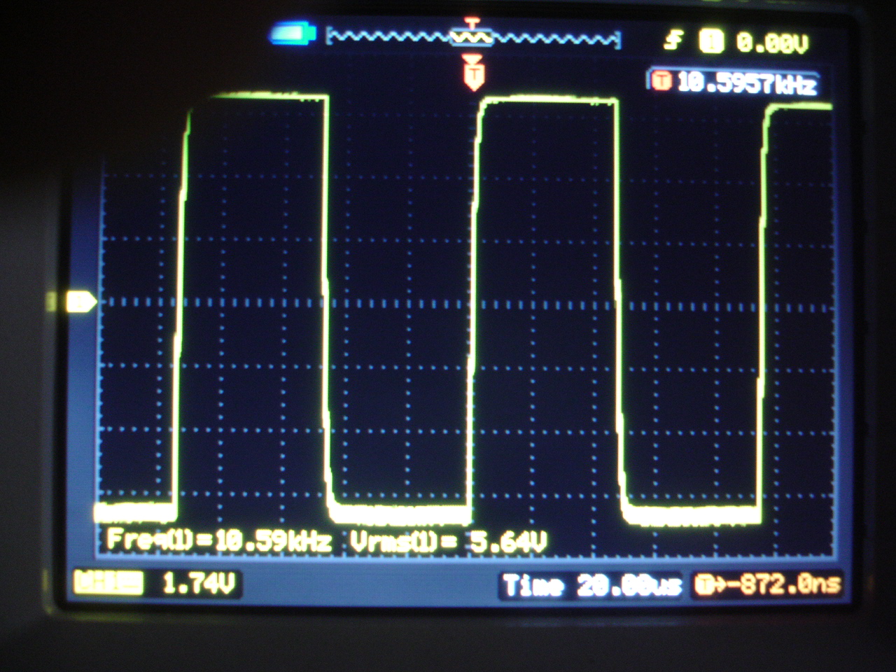

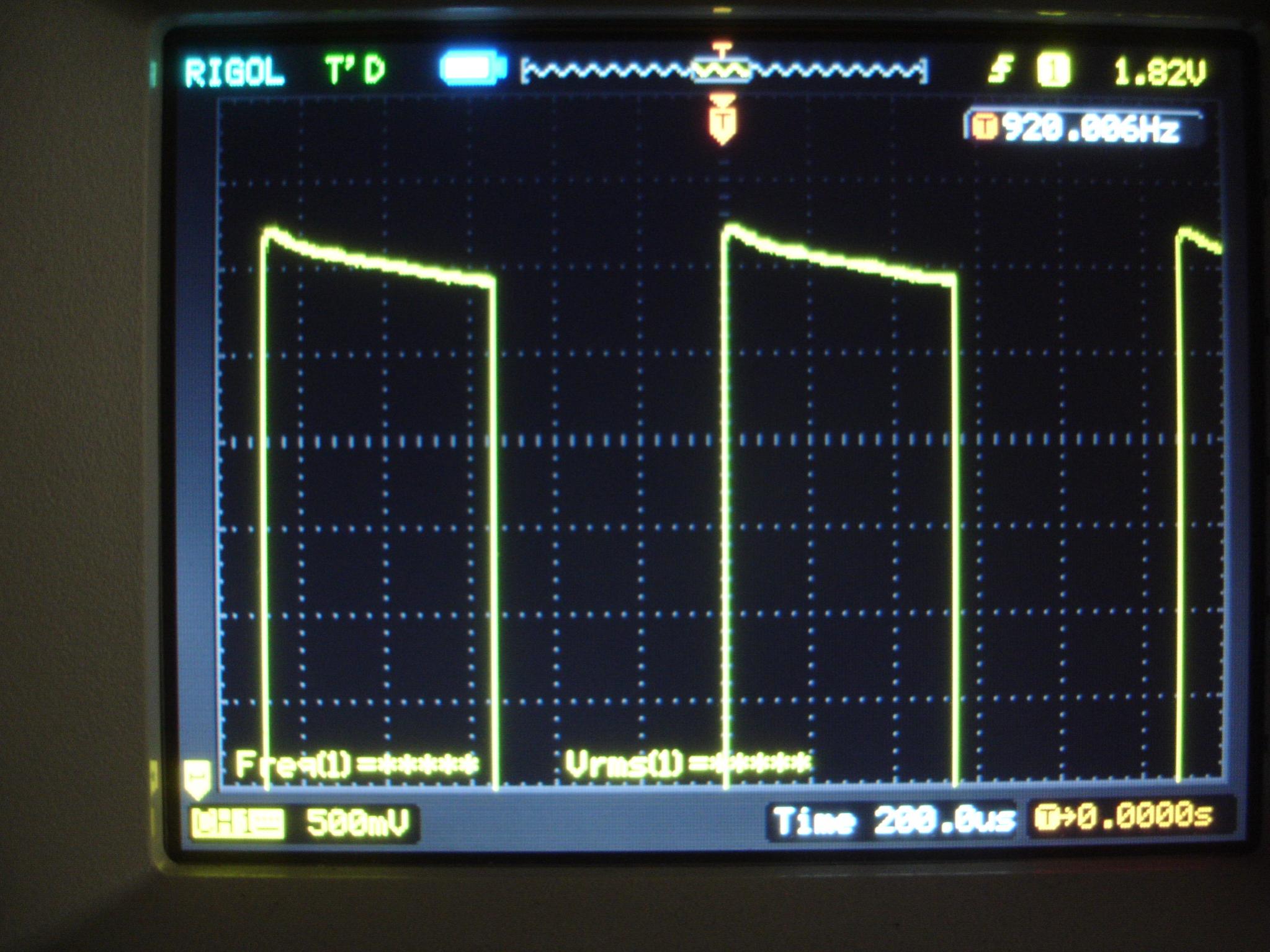

Now on the test bed.
+/-30V
36.000uF/rail
Idle current 150mA
Offset=0mV.
Not so good results🙁
I see some instability on the negative side of pulse?

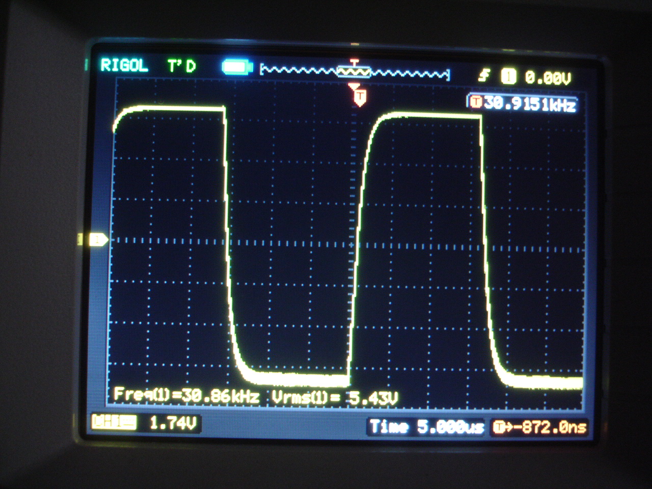

+/-30V
36.000uF/rail
Idle current 150mA
Offset=0mV.
Not bad 20KHz by the way.

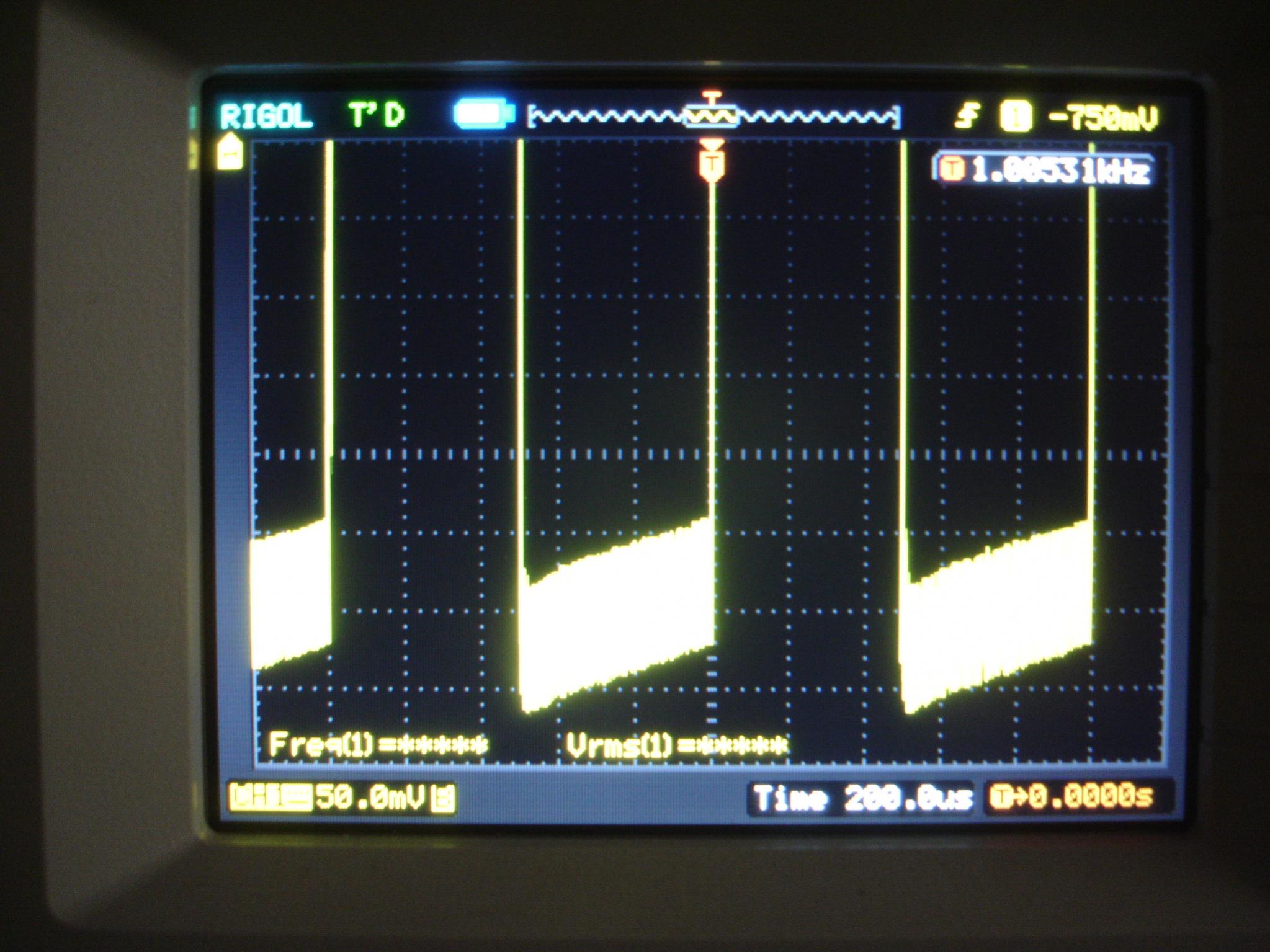

Yes, there is some local oscillation on the negative half-wave (you will see it on the sine wave as well). Not "fatal", but needs to be corrected.
Also, 1KHz square wave response is showing the response is rather limited at the lower end of audio bandwidth (those "spikes" in the beginning of each half-wave). Most likely, some capacitor (either input or feedback) value has to be increased.

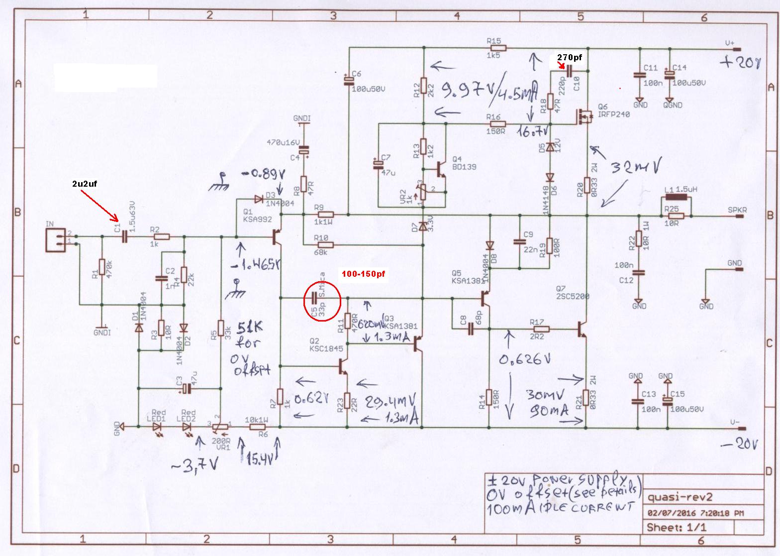

The negative waveform needs more LC on the base/collector of the phase inverter. This is always empirical, but I would try with 100pF, and if not enough, 150pF.
Agree with the input cap. These are quite good, actually, but there is a difference between measurements, oscillographs, and sound quality. It's one of the wonders of the world how these issues connect........

My calculation shows - if you roughly double both C1 and C4 (3.3...4.7uF and 1000uF accordingly), you will have -1db at 10Hz and practically square curve at 1KHz.
Phase response at the low end will also improve.

Hi Valery
I said a couple of pages back that 470u is the bare minimum for the feedback cap (C4) and recommend increasing this to 2200uF. A 10V or 16V polar type is still relatively compact.
Somewhere along the line we also replaced the bipolar input cap with a small film cap to to improve sound quality. Rather than increasing the value of the film cap (it starts to get bulky) I suggest increasing R4 to 47k.
So to clean up the LF response I suggest trying:
C1 = 1.5u
R4 = 47k
R5 = increase as required
C4 = 2200u
The oscillation on the -ve half wave looks like it is caused by instability of the CFP driver/output. I don't recall seeing this on the scope when I tested mine (could be differences in silicon or board layout?) but I have seen it on other designs that use a complementary CFP output stage. Increasing the ceramic around the phase splitter should fix it up. My gut feeling is that you're going to need to increase to at least 150p, but start with 100p as Hugh suggests.
C1 = 1.5u
R4 = 47k
C4 = 2200u

Hi Ranchu,
Absolutely - makes sense.
Valery
Thank you all for reply.
Coupling capacitor C1=2u2.(that is used)
Just to be clear,i haven't any 220pf for C10 position so a 270pf is used.
Is the value of C10 critical?
Your recommendation (to stop instability) is to increase C3 from 33pf to 100-150pf ?

Hi Thimios,
Not C3 (that's a Miller correction one), but C8 - try gradually 100pF -> if still "rings" - 150pF.

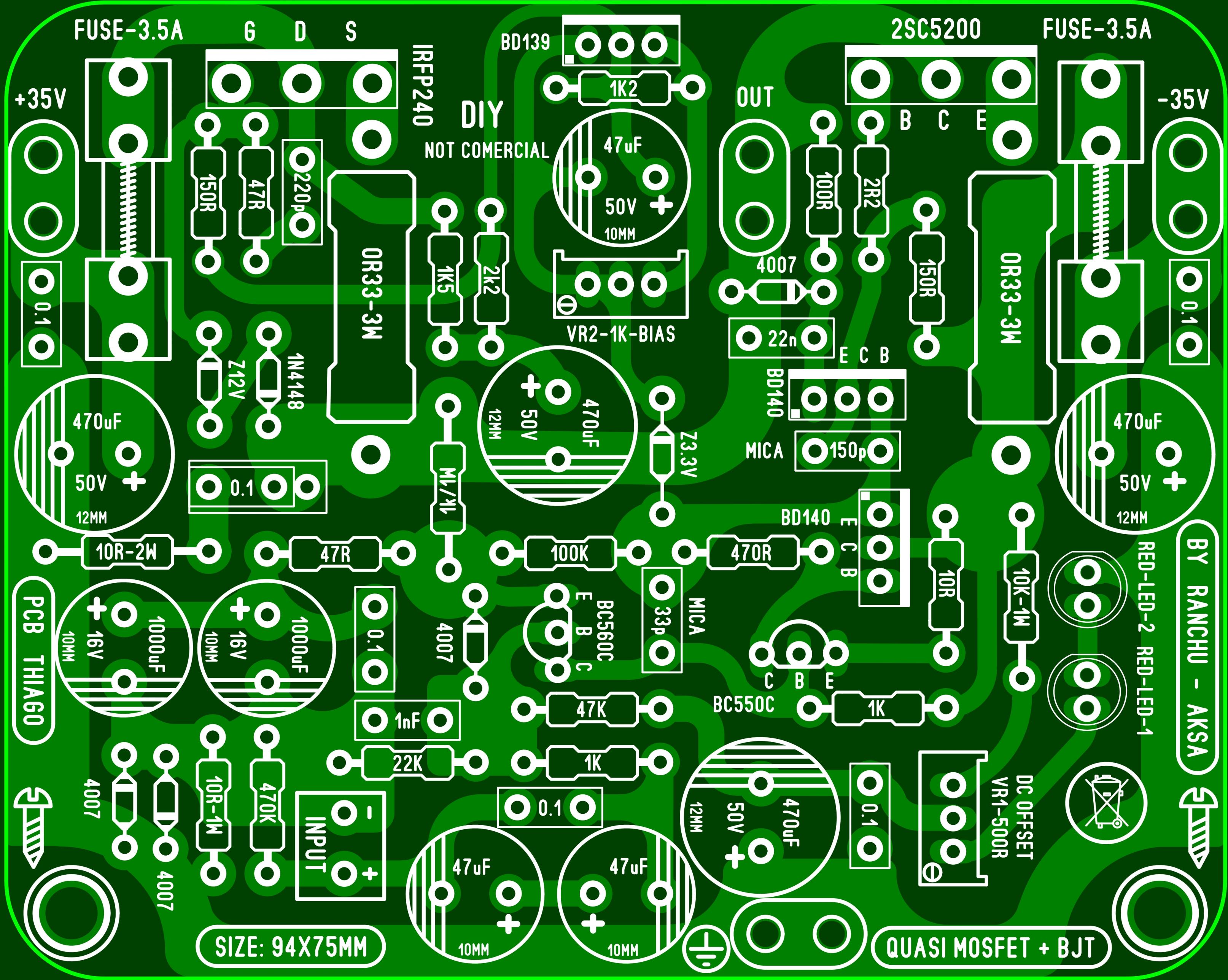

Thanks.
Just to make room in my PCB for these values.
2 cap 1000uf on feedback (10mm)
C3-C6-C14-C15 470uF (12mm)
C7-C1 47uF (10mm)
C8-150p
OK?
Regards
