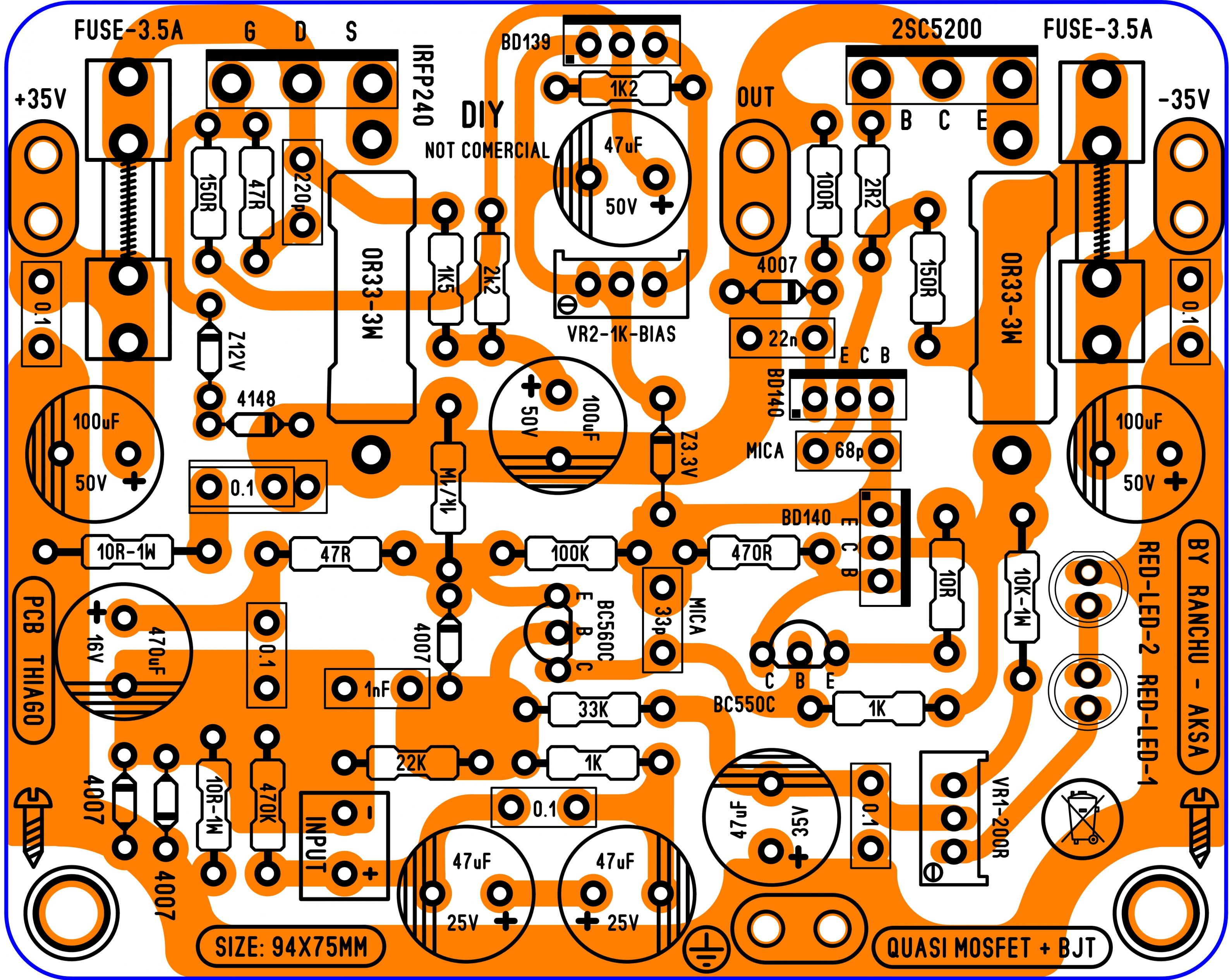

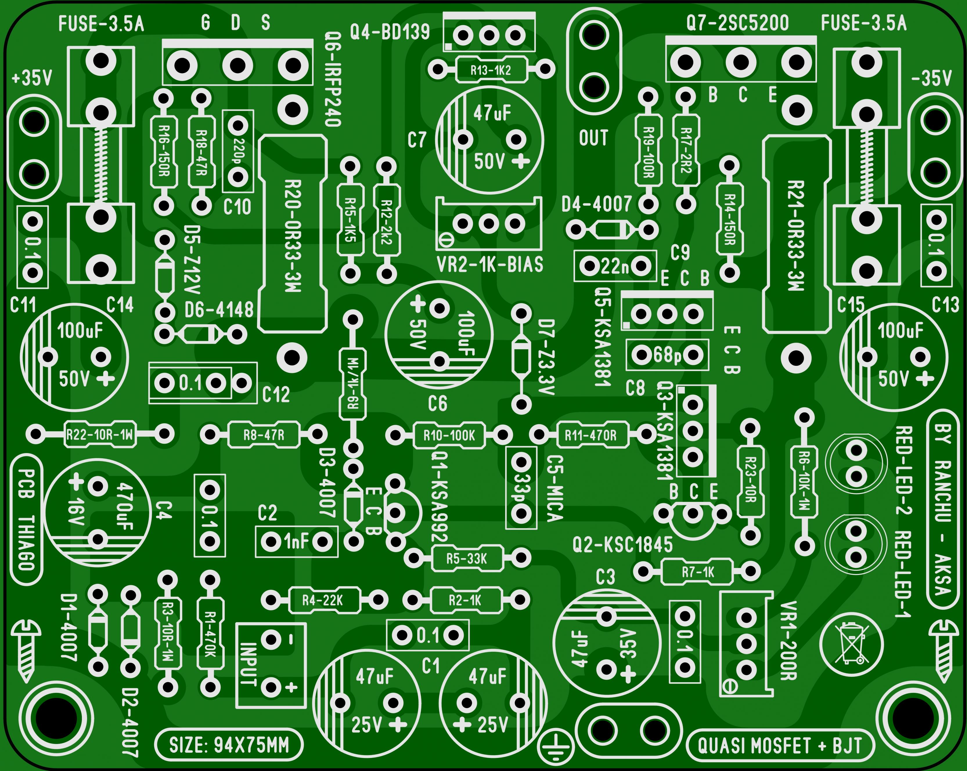

Nice curvy layout. Some thoughts that I considered while making the layout are as follows.
1. Q1 Q2 should be close together so that they can be thermally bound.
2. feedback should be taken right at o/p connector.
3. As ranchu32 suggested, Q2 should be some distance away from Q3 to avoid the heat from Q3.
just some thoughts for you to consider.
reg
Prasi
Prasi,
1. No need to have Q1 and Q2 together; they are not a diff pair, no requirement.
2. Yes, this is significant but your layout will be fine. This is a very small issue.
3. Good point, but with 36V rail Q3 will be dissipating 255mW and Q2 only 47mW.
These are small energy prints, and if the pcb is horizontal there will be no thermal connection.
On basis, your pcb is very nice and when you mount the outputs and a heatsink, you could mount the pcb on top of the outputs and then securely the pcb attach your complete amp with just two M3s.
Very good layout!
Hugh
PS: Only a few layout software permits curvy tracks. They look nice but are not electrically important.

Hi Christian,
Here is the modified layout. I think this may as well be the one that will satisfy the criteria set out by Hugh and yourself (hopefully). Size is further reduced to 69mm height. now the o/p are almost at center, only about 8-9mm offset towards the top.
-1W resistor, I have increased the size to 4.6mm x 15.24mm. one may also piggy back two 0.6W resistors, if required, i think.
-C4: both 3.5mm and 5mm pitch options included.
-C6,14 and 15 sizes increased to 10mm diax3.5mm pitch. 100uF, 220uF and 330uF will fit. may be difficult to find 470uF.
and yes emitter resistor for Q2 (22R ) included.
How does it fare now?

Sure... ver2 posted is final as it is🙂. here are the gerbs and pdfs for a ver3 that i improved silk slightly + clearances + minor trace tweaks😉. so that its more diy friendly
