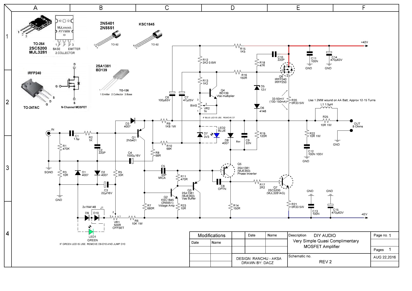

You are absolutely correct! Many small signal transistors will work in this amp, but variations will change the harmonic profile more or less in unexpected ways.
The big issue is the voltage rating. We have 42V rails, so we need to have Vceo figures on all these devices higher than 85V and preferably 100V or even 120V. The A1381 is rated to 300V and 150MHz; far more than we need. The 5401/551 are rated to 160V and 150MHz too, but BC557/547 are rated max at 65V and 300MHz - not adequate in this role. Some transistors are noisy too, so you have to avoid them as well.

My plan is using Thiago latest layout,the one with psu included.Instead of using the BC and BD trannies I'll use the KSC/KSA trannies with component values you see on the board.

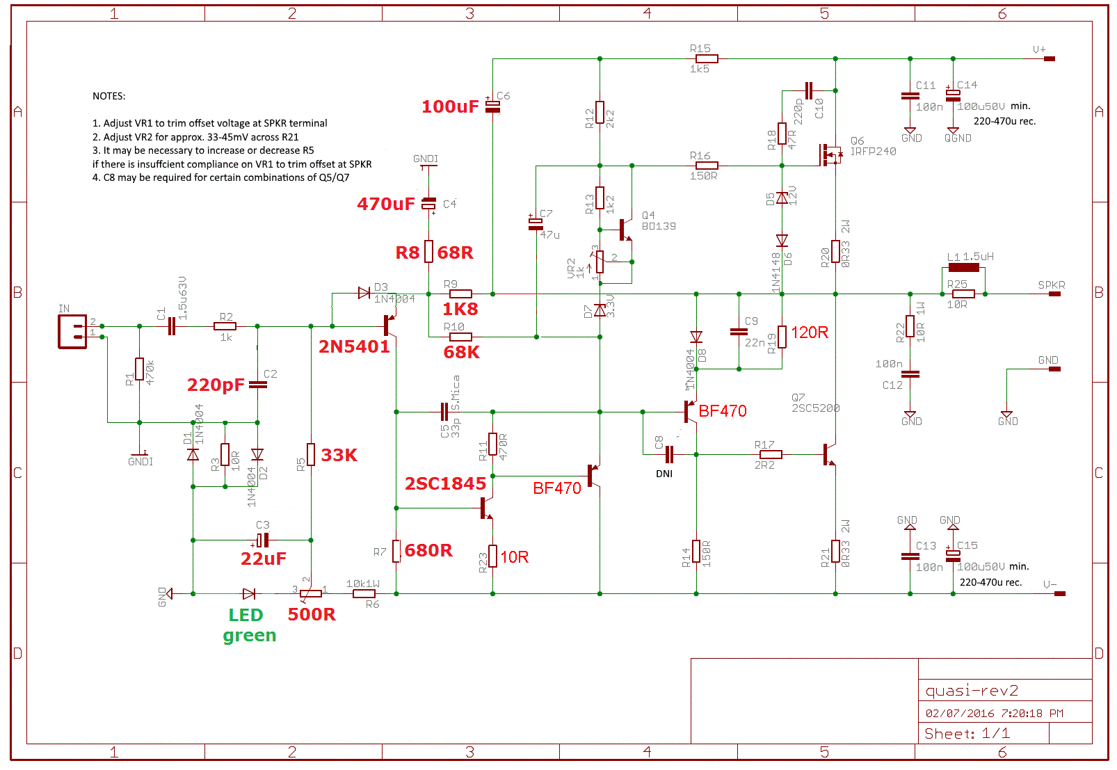

Can some plse help. According to the circuit that I have used there is no resistor in parallel with C2(220pf). In some of the other builds there are a 22k resistor in parallel with C2.What will be the effect soundwise be by adding the resistor across C2 ? Thanks for helping !🙂
Thanks Andrew. I also see that Thimios used 2x1000uf for C4 instead of 2x 500uf and 47R for r8 instead of 68R. This is in the feedback. Would this be beneficial ? Bigger caps and lower resistance would give more bass ?🙂

According to the schematic from Hugh the negative from capacitor C7 must be connected to the anode of D7. In both Prasi's and Thiago's circuits the negative goes to the cathode of D7 which is wrong. Did anybody try to change it ? If so,Were there a difference in sound ?
Bangla, thanks for the reply. I think I will cut the trace to the cap and jump it to the other side of the zener. That is the original way that Aksa has posted in his schematic. It works now as is but it could sound better after the mod.
Why are you changing it? The schematic as shown works and is tested.
Yes, these schematics above is correct. I have build boards from Thiago and these are not correct. This schematic of yours is not correct either. Post 1114
