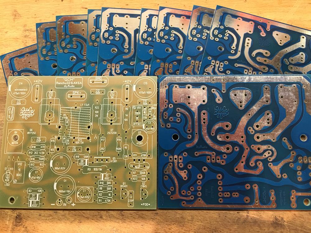

Funky Phunk boards received
So, I have been following this thread for a while, and finally got around to ordering a run of PCB. I decided on the lovely Phunk POD layout, as the compact form factor fits well in an old (dead) Toshiba amp I can use for testing 🙂
I received the boards yesterday, but they turned out a bit more "Phunky" than I was expecting: Bottom is blue, but the top is just plain FR4 🙄 Also just single sided pads. Which is fine of course, I am just so used to seeing through plated holes.
Phunk > I much appreciate your work (and others who made their layout available here), so please don't take this as criticism. I didn't really check the Gerbers before sending off, so not sure if the color issue stems from the files, or if PCBway made a mistake. Will have to check up on that... Silkscreen looks quite good though, and the boards are fine otherwise.
I really look forward to trying this design, but it may be a few weeks before I have it up and running. I think I have most of the components, and will likely use MJL4281 and IRFP250 as outputs. I plan to do a fair bit of objective testing on varying voltages and loads, before moving on to listening and general use.
In the meantime, to give something back to the community:
If someone would like a set of these unique two-tone PCB, I will send you a set for free. I can spare 4 boards, so can send out 2 free stereo sets.
And last but certainly not least: Big thanks to Hugh (Aksa) and Ranchu32!

The unusual coloration is the result of not having through hole pads on the top. This it is a single layer board and the color comes from the solder mask. As there is no solder, no mask. I would ask layout artists to please generate Gerbers with top side pads to make it "double sided" in the future. Then colors should all work out. I had same issue with Thiago's board. I suppose one could have requested a solder mask on top side despite one sided. However, having pads on top increases durability of solder joints and nice to have. Costs nothing extra.

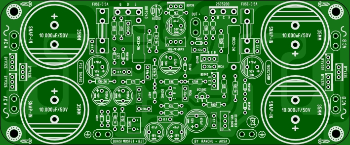

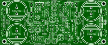

Is there a schematic for this layout?There are some difference with the regular schematics.
Looks like Thiago substituted BC560 for 2N5401 and BC550 for KSC1845, and BD140 for KSA1381. Not sure why (maybe the usual parts harder to get locally?) but he says it has been tested. I think KSA1381 has special properties and may sound better than BD140. They are pin compatible at least.
Another victim of sterile online Chinese board houses, read the advice here
JLH 10 Watt class A amplifier, rest assured, it will work fine.
