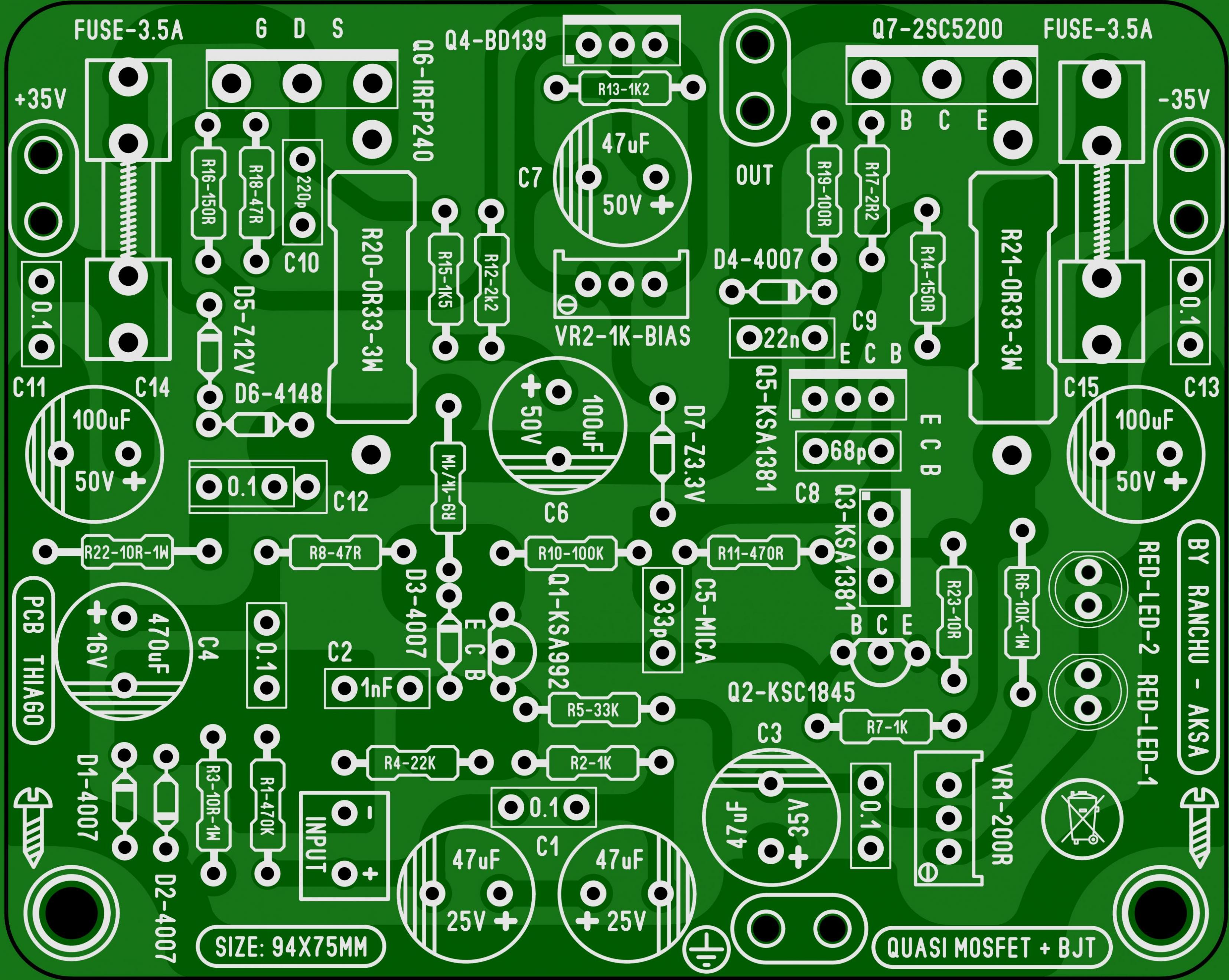

The 2.2nF should be across COLLECTOR/BASE, not emitter/base.
Don't bother with C8 just yet.
Hugh
Hi Hugh,
Have you an advise of what type 2.2nf cap to place? I have my version allready in tube with FQA40N25/MJL4281.

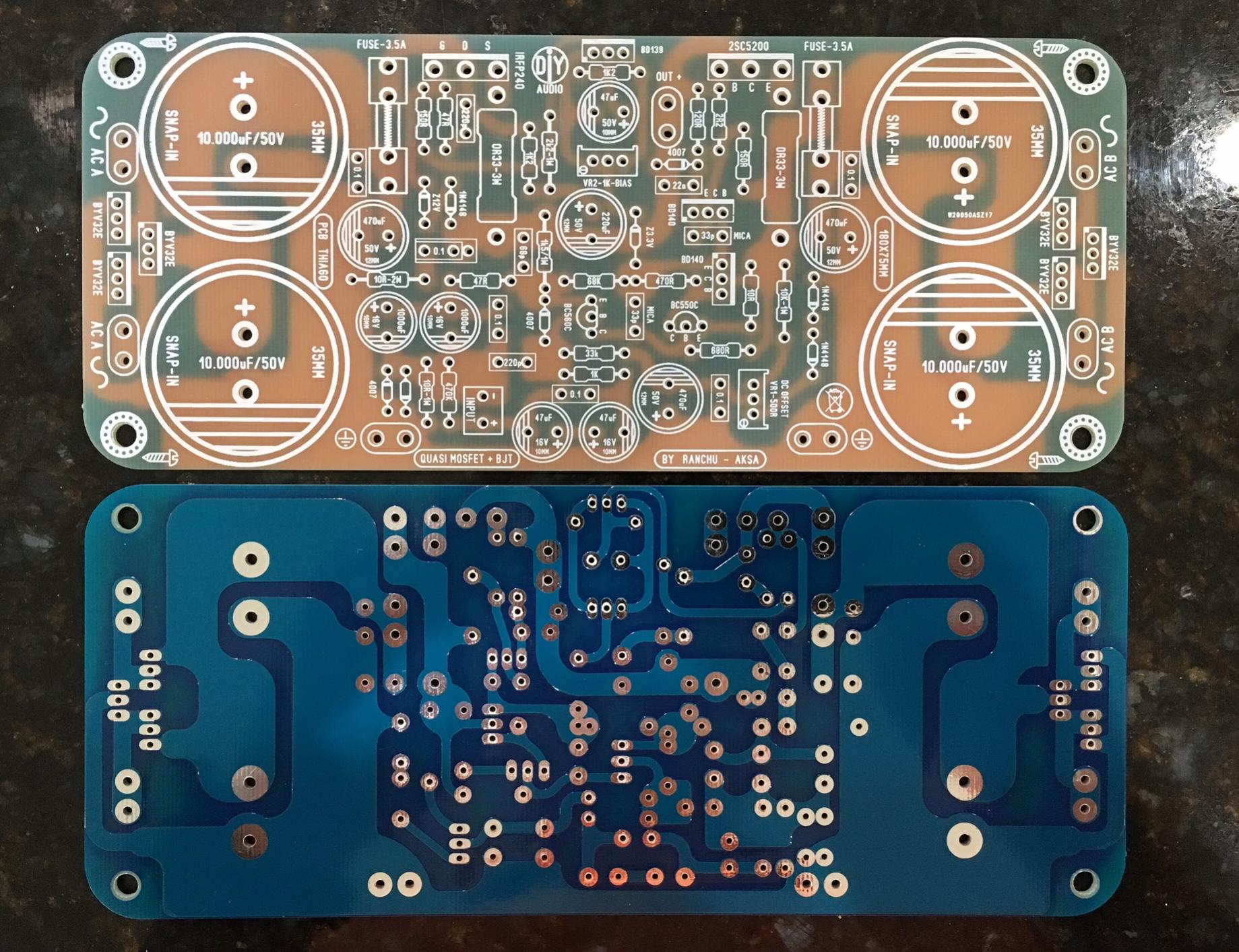

All Thiago Quasi PCB's sent out in mail today. Please let me know when you receive them.
advice for next time, make them 2 sided , there is no extra cost with Chinese board Houses.
The posted advice is here., however its cool to have some different looking PCBs.
JLH 10 Watt class A amplifier
and here is the result of a single sided layout but masked from both sides.
The light color you see , is a reflection from roof, otherwise its all jet black!.
Yes, that would have been nice to at least have pads on the topside to give some additional bonding strength, especially for spade terminals. But that is all up to Thiago who did the layout. Although, as you say, it is a unique looking board with translucent satin finished see through top side and blue bottom side.

While busy building the second channel I found that I have put in a 470R resistor in the place of the 470K R1 input resistor. This is obviously going to change everything.I suppose bias and offset will have to be set again. It does sound very good as is. Will change it tomorrow and see what happens. I wonder if it could have caused the oscillation that needed the 2.2nf on the MJL3281 to cure it ? The head does not think where the eye's are looking !😀
G'Day
xrk971 received my boards today less than a week from the States.
Cheers
Bruce
Great news. Thanls for letting me know.
X
R1 is there to stop the input cap from charging up and causing nasty pops when the input cable is connected/disconnected. The value isn't critical but it needs to be high enough so that it doesn't excessively load your source equipment. Any value between 100k and 1Meg is fine.
But that 470R you have in there now is going be difficult for your source to drive and will result in a loss of gain if your source has any appreciable output impedance.
