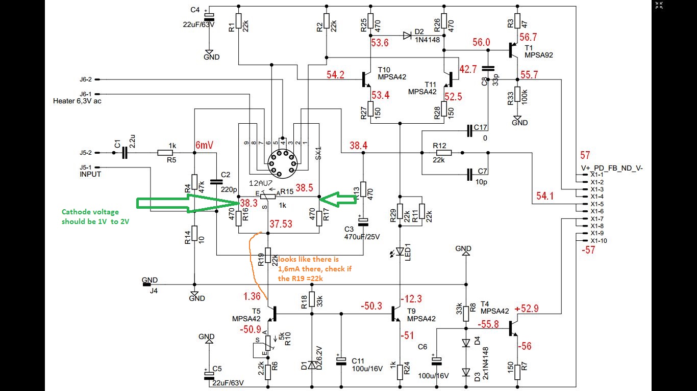

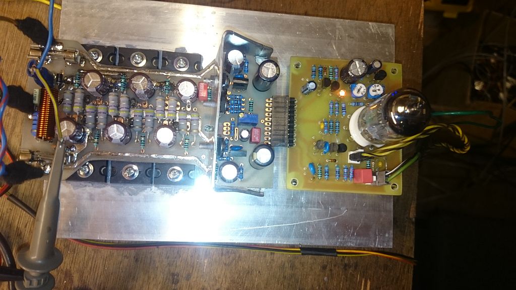

Looks like there is no current flowing threw the triodes. Please make sure the heater is connected (observe tube if it is starting to glowing after 5 seconds). On the top of the R16 and R17 resistors (cathodes ) there should be approx 1-2V.

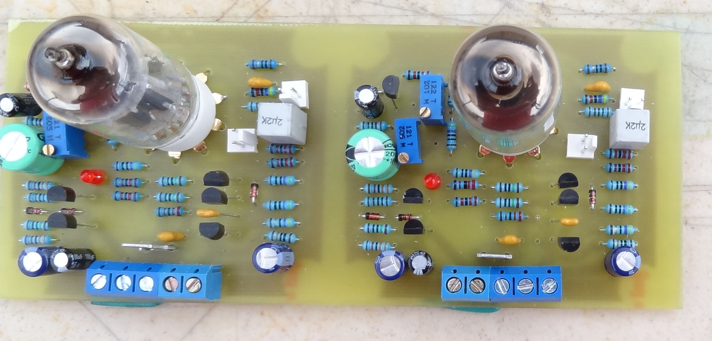

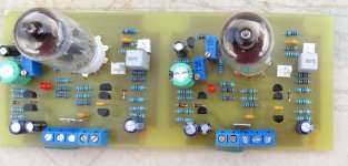

The heater is good, tubes are warm. I'm not sure what you mean by " on top of R16 and R17. Is that where I am reading 38.3V?

The picture will explain better than me.
This layout is build but only with BJT OPS, very simple very basic. With mosfet I used different VAS - same as symasym, and with fast mosfets is working perfect.

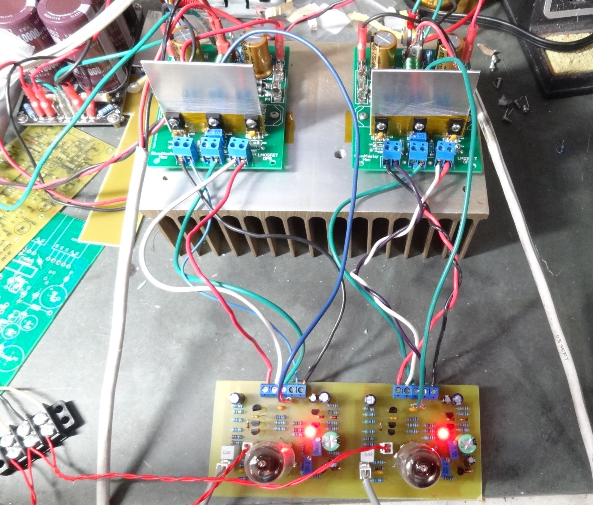

Hi Borys,

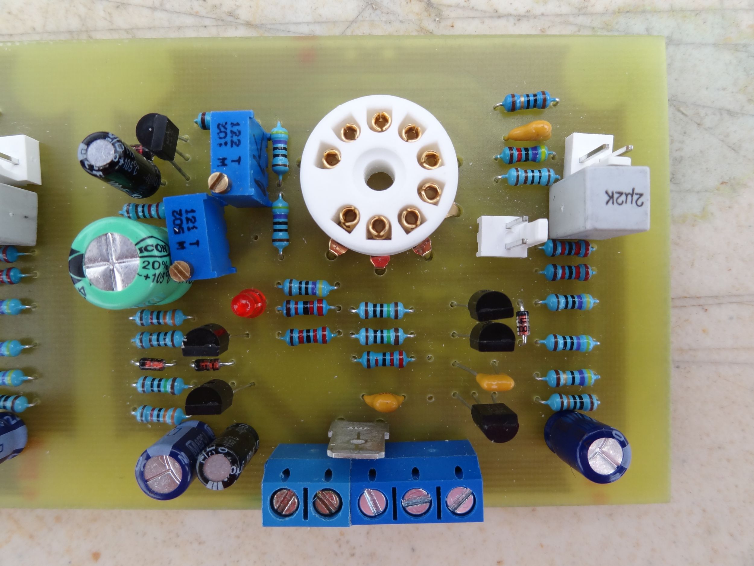

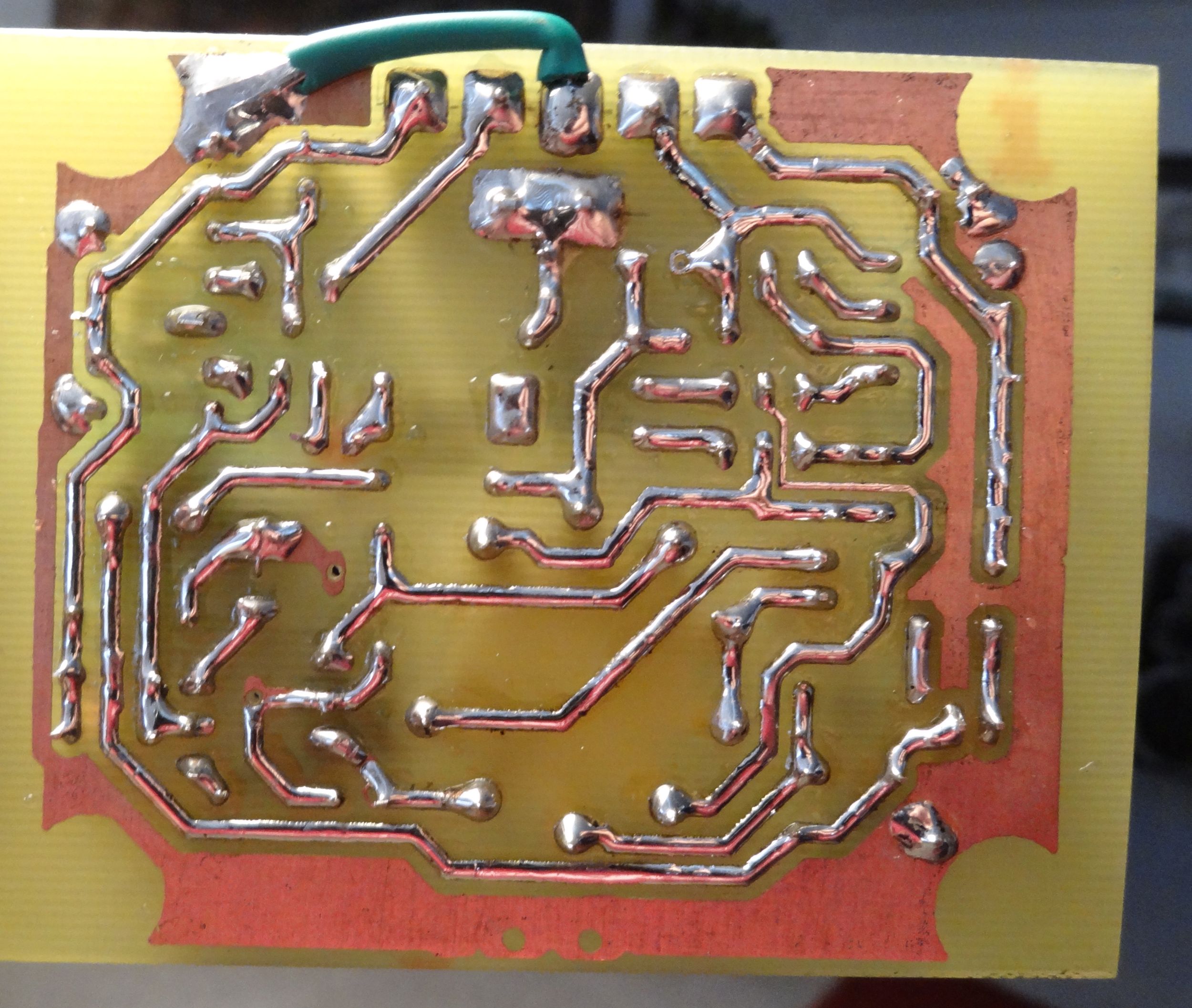

That is where I understood you say it. I checked all the values and they are correct. I'm attaching some pics. I am testing it with a Slewmaster mini OPS. This OPS works perfectly as I have been testing other IPS with it all week. Are you saying that you built this layout and it works with your BJT OPS? This is very strange.
BTW, I have it wired with the center terminal as ground and the spade feeding NFB so I can easily attach to the Slewmaster OPS.

I just taken measurement from it bellow (15V).

Please measure voltage across R19=22kR resistor (according to pic it is working ok 1,6mA) but where it goes. Than measure voltages across R1 and R2. Please check if R14=10R GND separating resistor is not blown. I am in lab now so will try to help. PS what tubes you have ??
All looks soldered OK (my eyes hurts a bit).

There is only one MPSA92 all others are MPSA42, just quick take a look please.

I think you found it. I just checked and T1 is a MPSA42. Not sure how I missed that. It is midnight here so I will change that in the morning and retest.
The marking on the MPSA92 and 42 are looking very same, I am soldering them other way around alll the time.

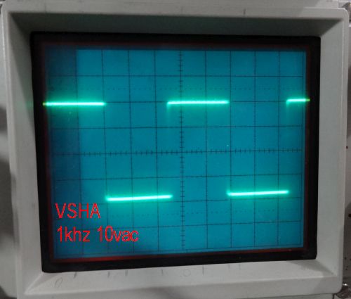

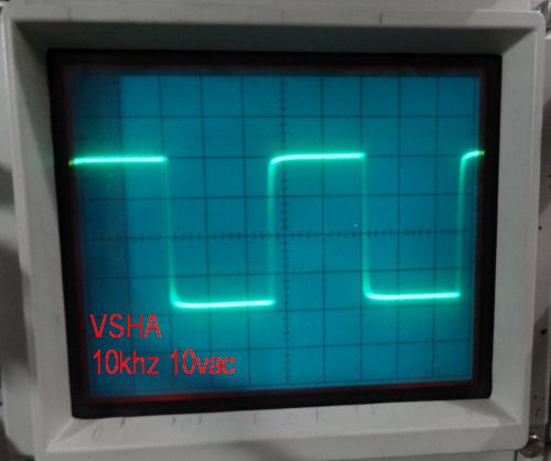

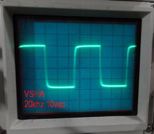

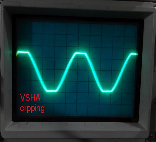

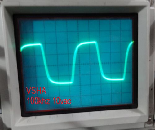

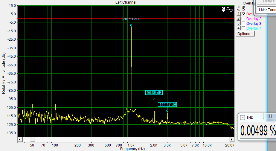

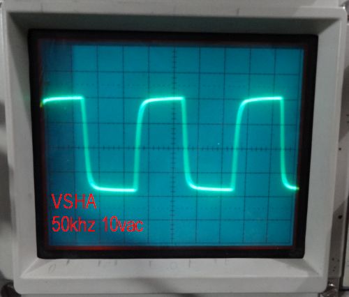

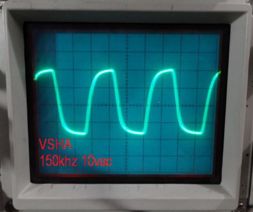

Love it! Plays beautifully. Offset settles quickly and holds solid. I didn't see a large offset at turn on. Less than 2V at switch on and settles at +-2mv. I have the cathode set to 1V. I am just playing it through the Slewmaster mini OPS at +-45V rails. Really, really nice sounding. I will hook it up to the A/B setup a little later and give a better comparison to some of my other amps. As for now I am very impressed.

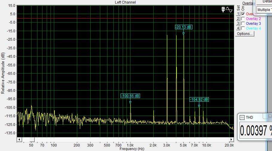

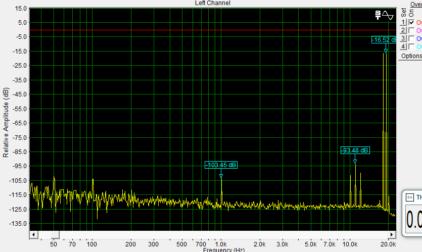

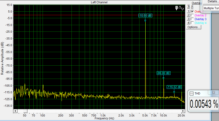

Clipp is nice and not sticking, squares looks good too. I am going to add one 100pF cap just in case because of input tupe tolerances (they all are not the same).

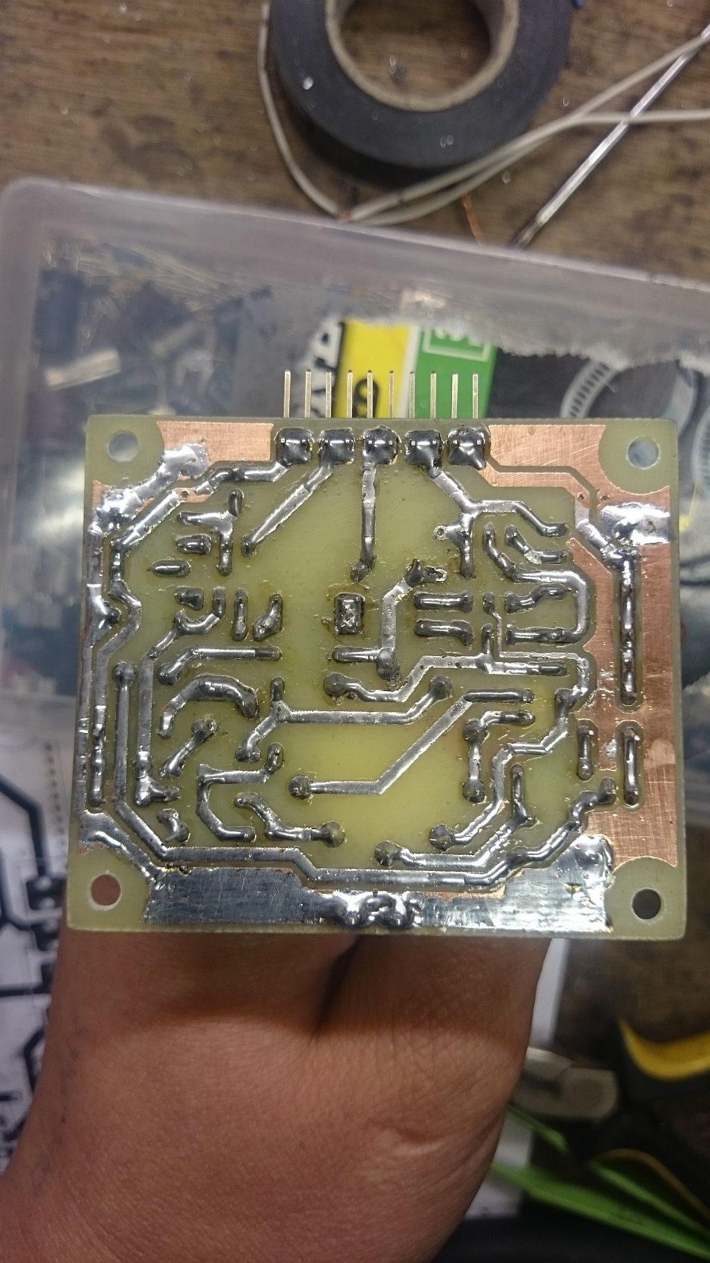

I have stuffed enclosure with all pcb's psu's etc, so my hybrid is up and running, but it needs a small update, I will have to add a V bias generator to compensate drivers Vbe, becouse I do not like to wait for bias to climb up.
Other than that amp is playing nice enough to bring it back home from the workshop.
