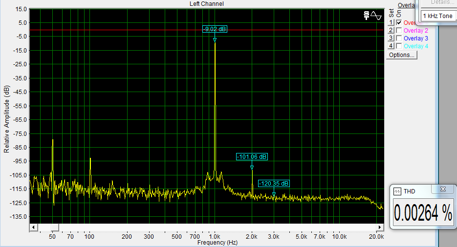

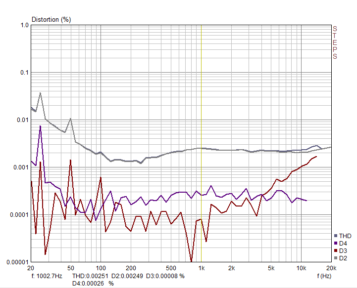

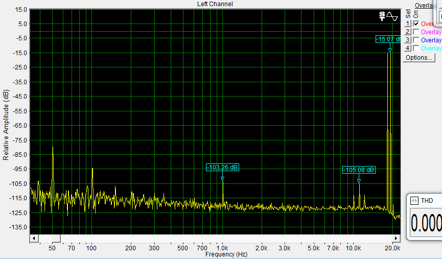

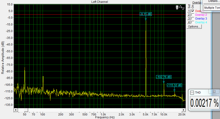

In my opinion Hitachi VAS have something magnetic, lots of details in background (tube is helping here too). There are two VSHA versions, HD with Hitachi vas and Classic (Terry have it) with simpe transistor and ccs vas. I am surprised the simple version is performing so well at the top octave (H2 is dominating threw all audio band in roughly the same quantity).
Terrys version measured bellow .

Peter,
Could I suggest that BECAUSE there is higher H2 that the top end is 'sweet'???
The other issue is the tube choice. You have a 12AU7, which is known to like higher voltage. Have you considered a 6DJ8, or a Ruskie high perveance device? These can run very linearly at only 40 Vak, and with a much lower rp, suited to the 3k3 load here.
BTW, high loading with tubes gives you more H2 and H3, reduced of course with high global NFB, but still evident in the distortion profile you showed us.
Bloody good work, Sir, good design.........
