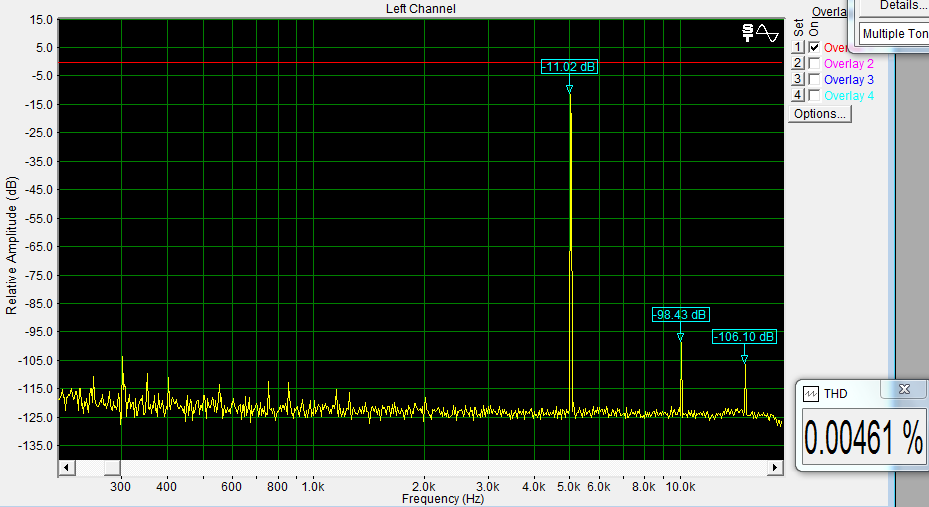

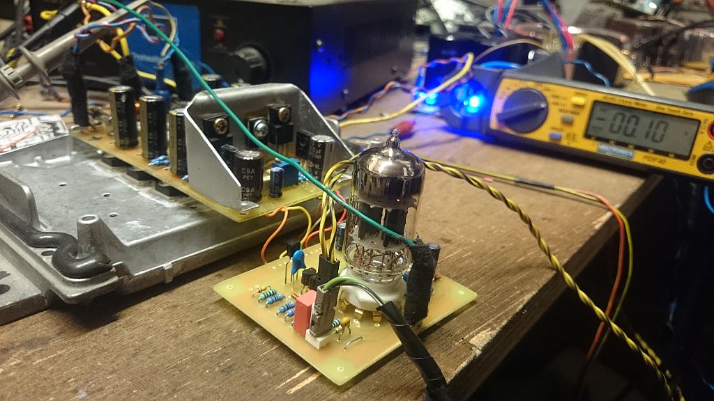

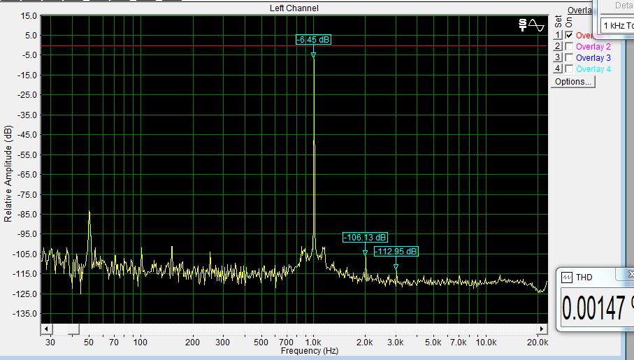

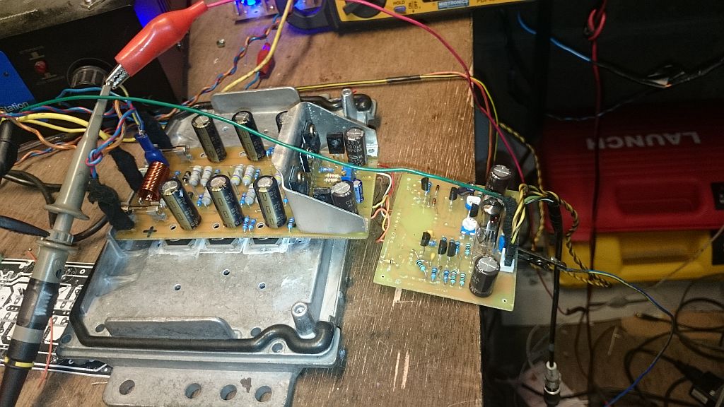

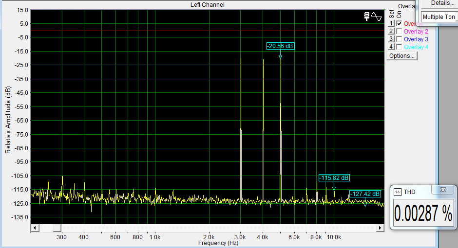

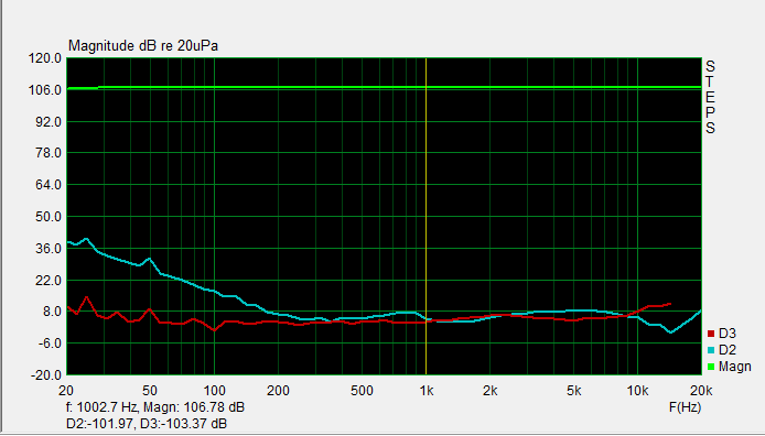

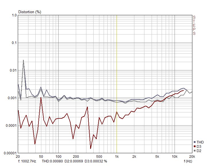

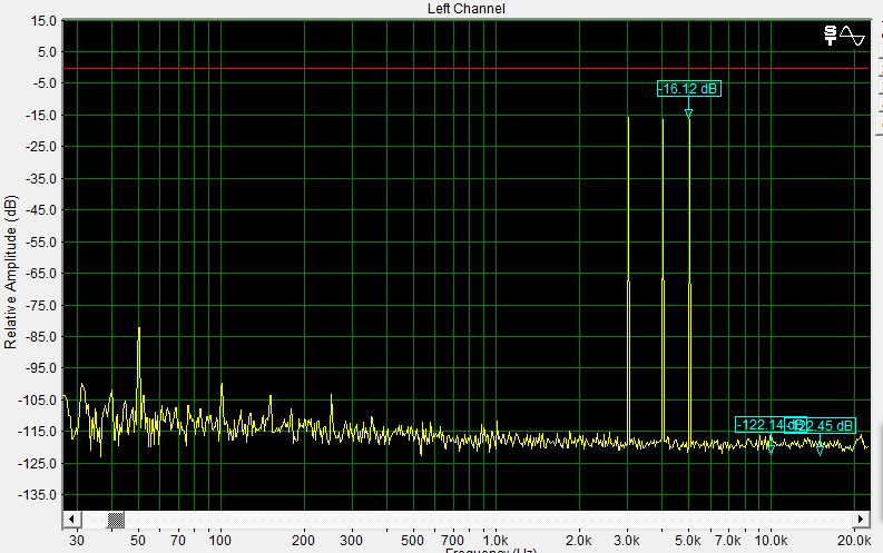

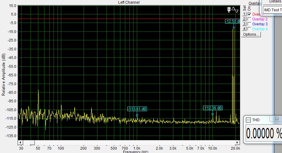

I have prepared another board (to be fitted flat with the heatsink), I did some minor changes + added emiter fallower just after VAS. Looks that there is some improvement made. The IMD products are gone, there is only 50/100Hz hum visible from my crap wiring setup 😛
I have some meas on my table with wires ect. but for now it looks like bellow.
No problems with bass either, very dynamic clear sound.

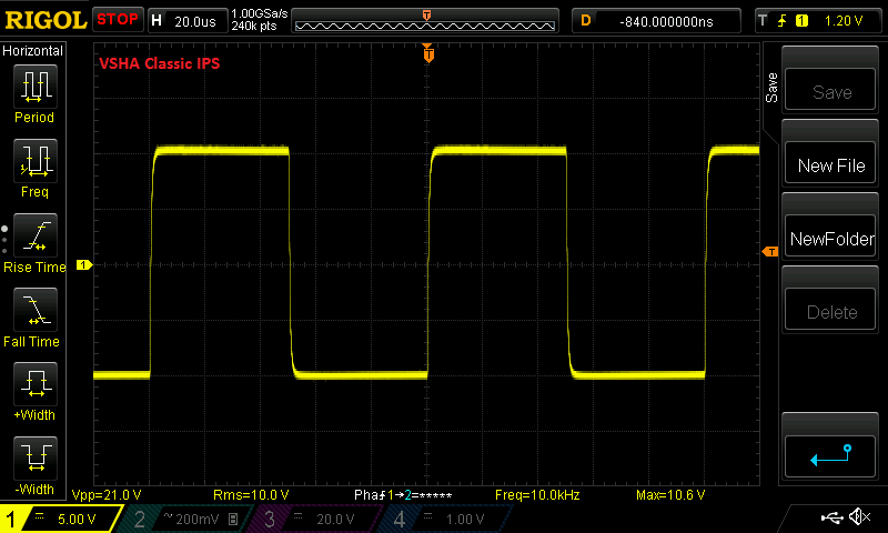

I have tryed to drive 2 pairs of LATfets dirrectly from 4,5mA VAS and didnt spotted any issues, squares were very clean without any signs of problems. Those transistors maybe are not the stronges ''horses'' but to drive them is very easy.

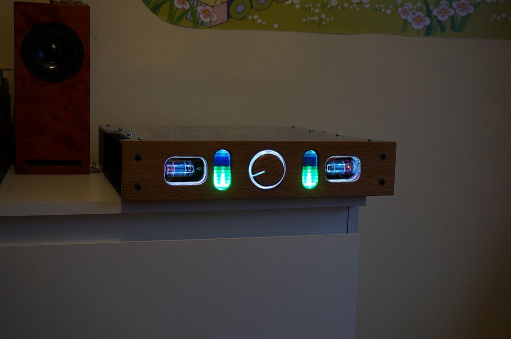

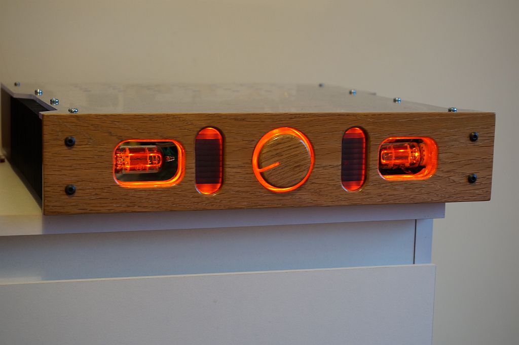

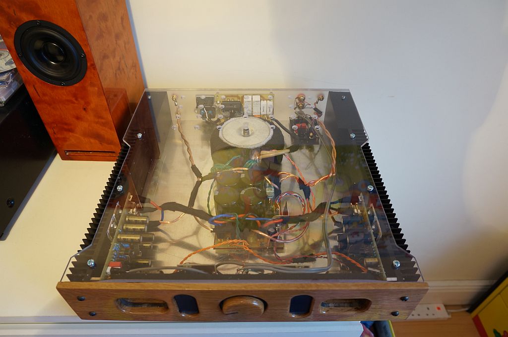

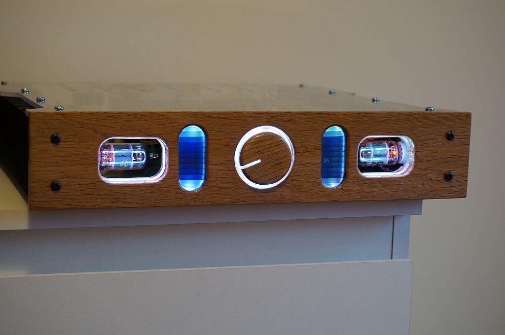

I have stuffed enclosure with all pcb's psu's etc, so my hybrid is up and running, but it needs a small update, I will have to add a V bias generator to compensate drivers Vbe, becouse I do not like to wait for bias to climb up.
Other than that amp is playing nice enough to bring it back home from the workshop.

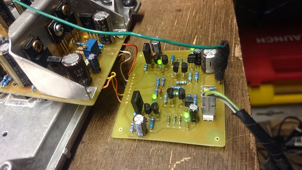

And I did tryed the hybrid with the BJT OPS (poor man's slevmaster).
I decided also to make a few changes to make it more classic. So I have removed Hitachi VAS and putted CCS with single transistor VAS instead. I have some work left to do with it but it looks really OK.

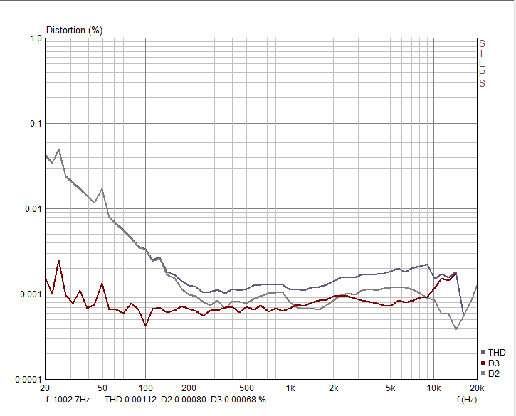

I just can not find out why I have so much H2 at the bottom end. Sound is really good for me. The story with latfets in my case is finished anyway.

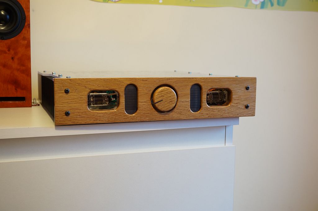

BTW nice enclosure!
That enclosure never failed me down 😀
No fire and all staff is alive .

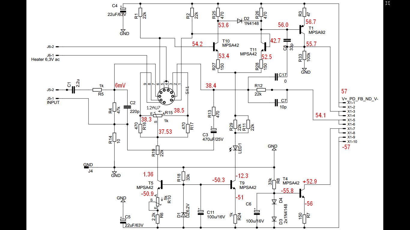

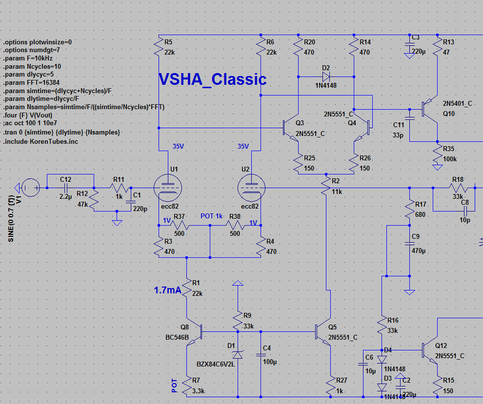

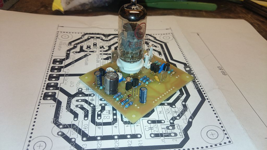

I have plugged in a hybrid IPS with ecc82 and ecc83 (with small adjustment).
The ips is named VSHA Classic now because there is no any fancy super duper tricks in it.
Everyting is classic/old school/simple. Tube and six transistors soldered together.

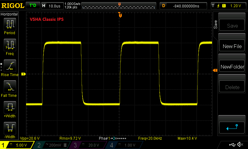

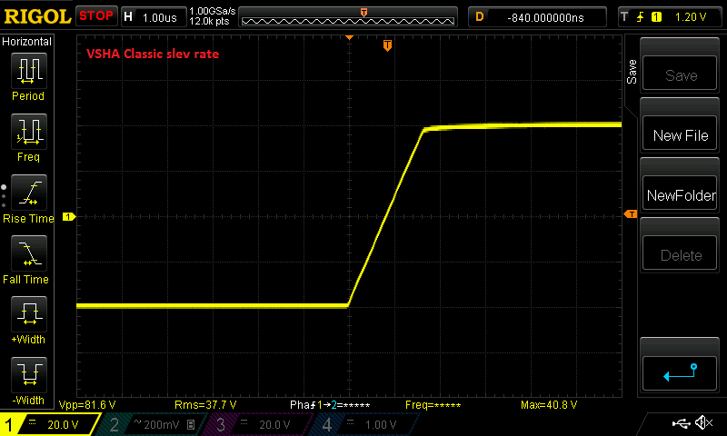

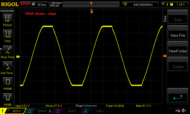

The slev rate is around 50V/us, THD is very low and sound is really good.
The IPS is connected to the poor mans slewmaster board 😀, it is bit over compensated for some safety reasons (unknown parameters of 12au7 tube).
Soon I will post final board.

The PCB is ready anyway, there is only left some resistors adjustment.
I will post the boards at the weekend.

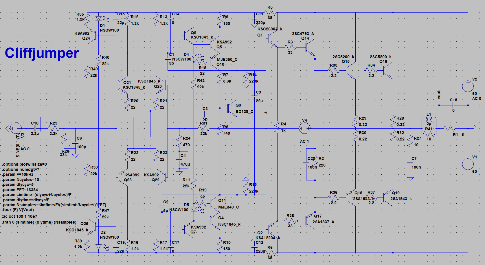

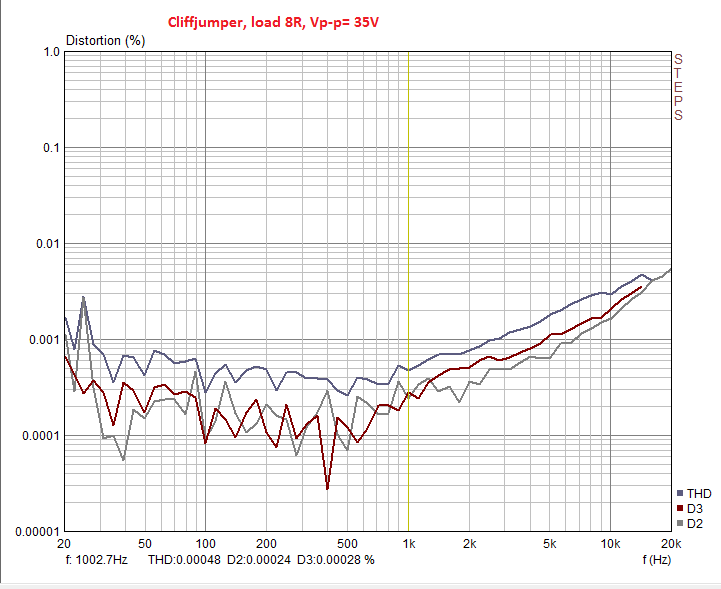

Today I was working on third IPS and suprisingly the whole top octave was more smooth/delicate in transistor IPS than tube IPS, looks like good sound have a lot of virables which are not easy to find. I had to try that super fancy VAS 😀
Bellow Cliffjumper
Regards
Peter
Bellow Cliffjumper

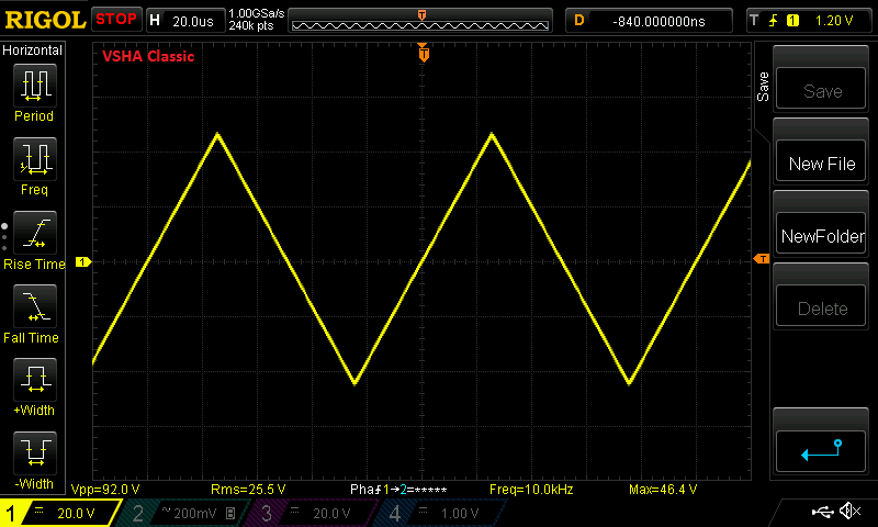

Unfortunatley I use DDS cheap'e from ebay, the analog one would be much better, but for my needs is ok.
