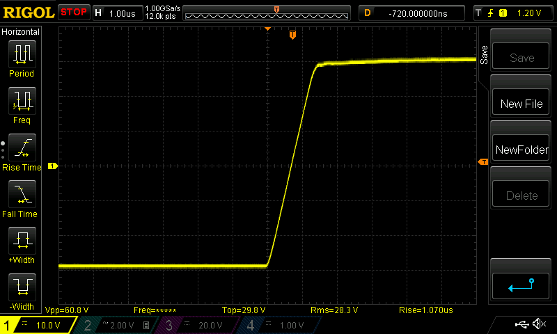

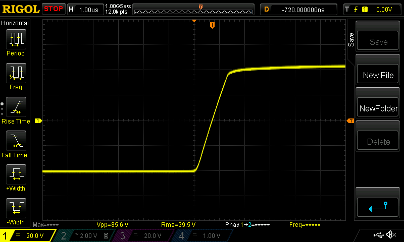

The HD version for 12au7 tube is bellow (same as post no #23), heater is 6.3V ac , but you can cut one track and make it for 12DC.

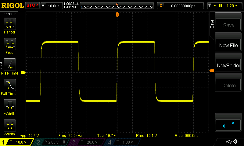

I didn't have any problems with it but had some with 6n16b tube and had to add another compensation cap.

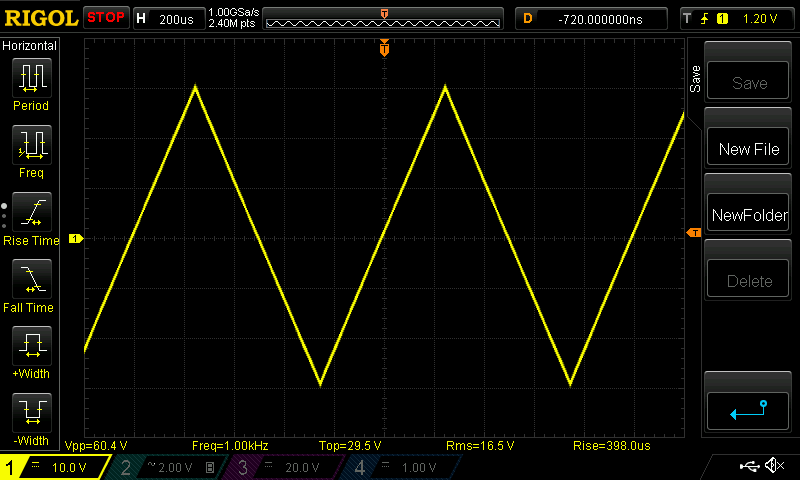

Just in case I have made a tests on v4 version too with additional miller cap at tranistor T1, amp is rock stable, no changes in performance.

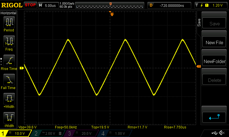

Bellow few squares and triangles from it (2 x 47pF miller caps at the VAS stage)

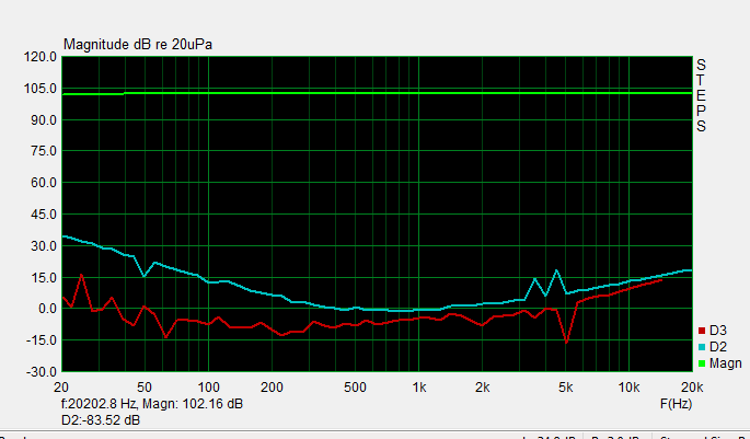

Yes, the bass isnt the most powerfull but I am not sure how to improve it, or it is just the type of the mosfets used. There is quite a lot of second harmonic and maybe that is why the bass sounds like. I have never tryed to bypass the cathode resistors but I think is worth of trying.

Sorry i have the simple version only.Yes, the bass isnt the most powerfull but I am not sure how to improve it, or it is just the type of the mosfets used. There is quite a lot of second harmonic and maybe that is why the bass sounds like. I have never tryed to bypass the cathode resistors but I think is worth of trying.

I have spotted that too, I have vssa and with single pair of latfets the bass isn't the strongest one but with IRFP the bass is really good. I have similar feedback from the few persons using latfets, middle and top octave beautiful but bass isn't the killer.

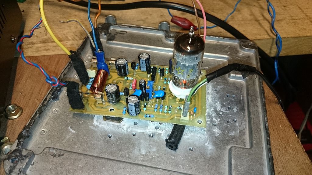

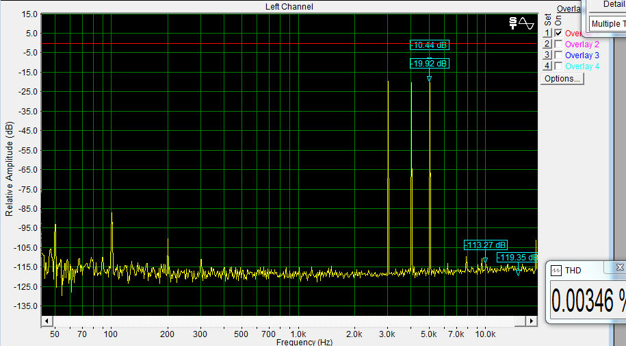

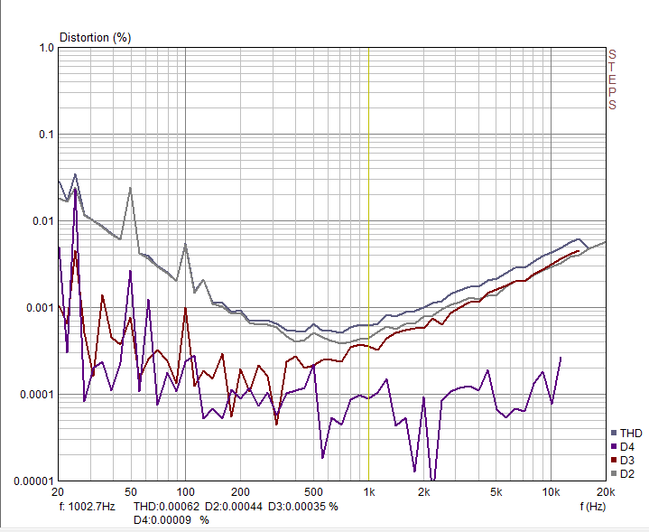

I have prepared another board (to be fitted flat with the heatsink), I did some minor changes + added emiter fallower just after VAS. Looks that there is some improvement made. The IMD products are gone, there is only 50/100Hz hum visible from my crap wiring setup
I have some meas on my table with wires ect. but for now it looks like bellow.
No problems with bass either, very dynamic clear sound.

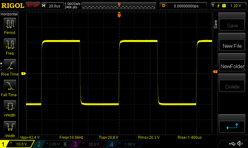

I have tryed to drive 2 pairs of LATfets dirrectly from 4,5mA VAS and didnt spotted any issues, squares were very clean without any signs of problems. Those transistors maybe are not the stronges ''horses'' but to drive them is very easy.
