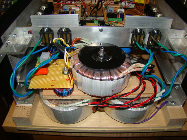

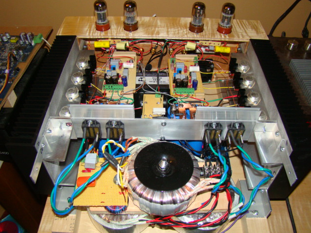

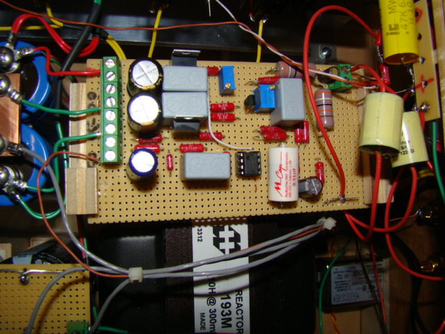

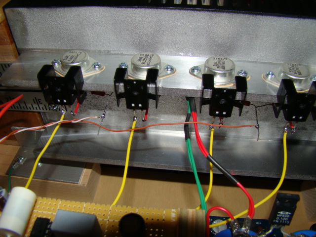

some photos.

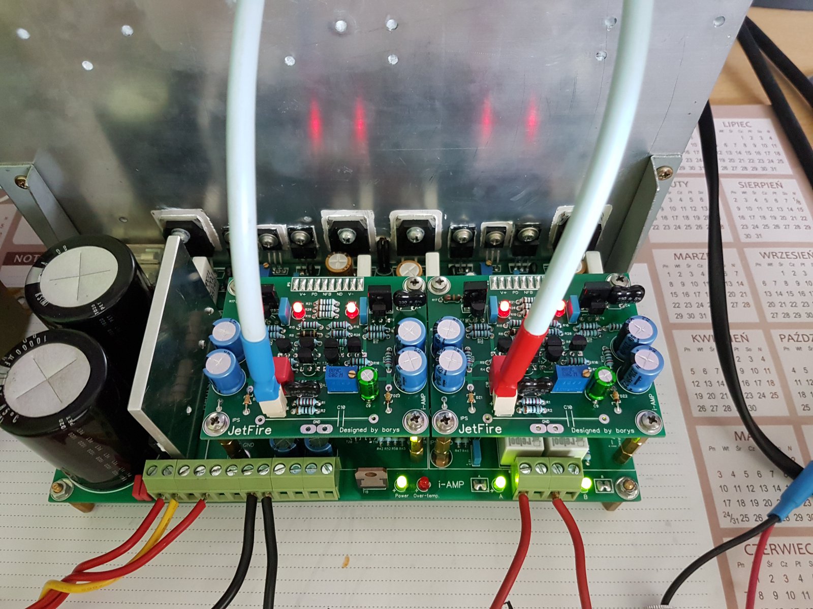

I think I started to like simple stuff, If you will spend some time and putt a bit of the ''hart'' into it, it will ''rock'' really nice. IMHO the simple amps have some ''magic'' so I will stick with a few componnet ones.

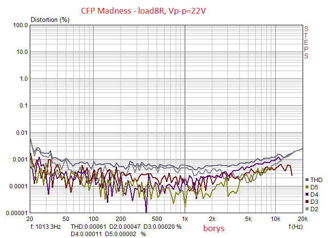

IPS from post no #206 - I just got a good bit listen to it, so far it is the best 6 transistor amp I have ever made (the VAS transistors are MJE350). Measurements are preatty good too (2x 45V psu + EF3 OPS). Now I am in progress of some fine tuning of the thermal behavior (just two resistor tweak).

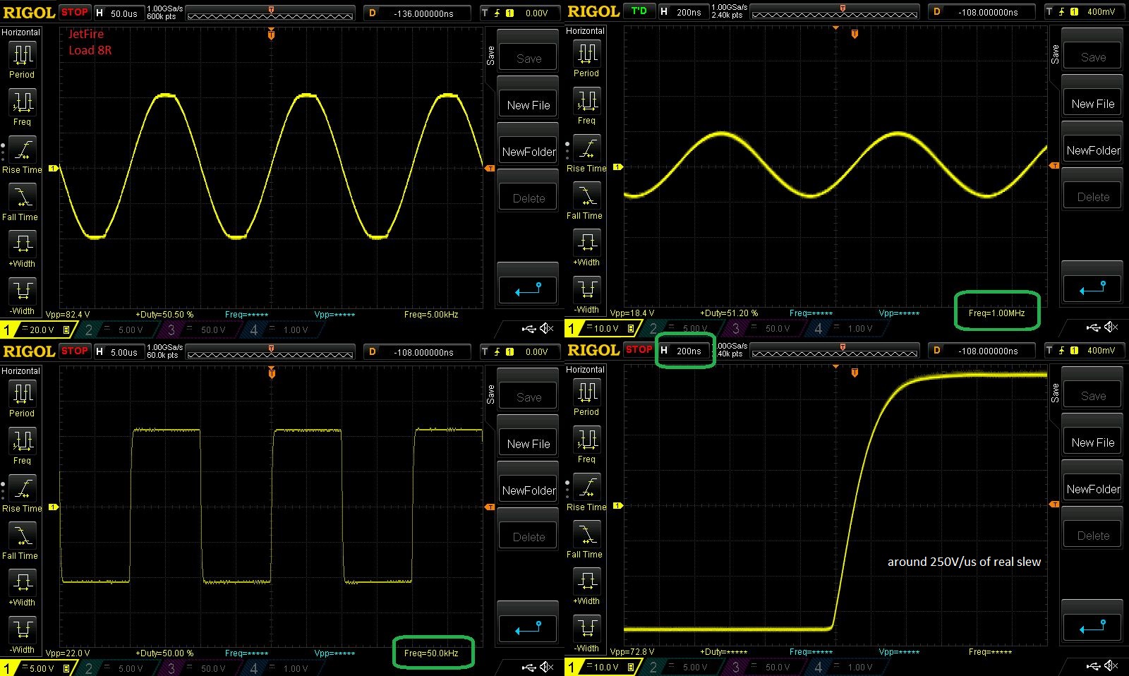

Measurements are impressive
Valery

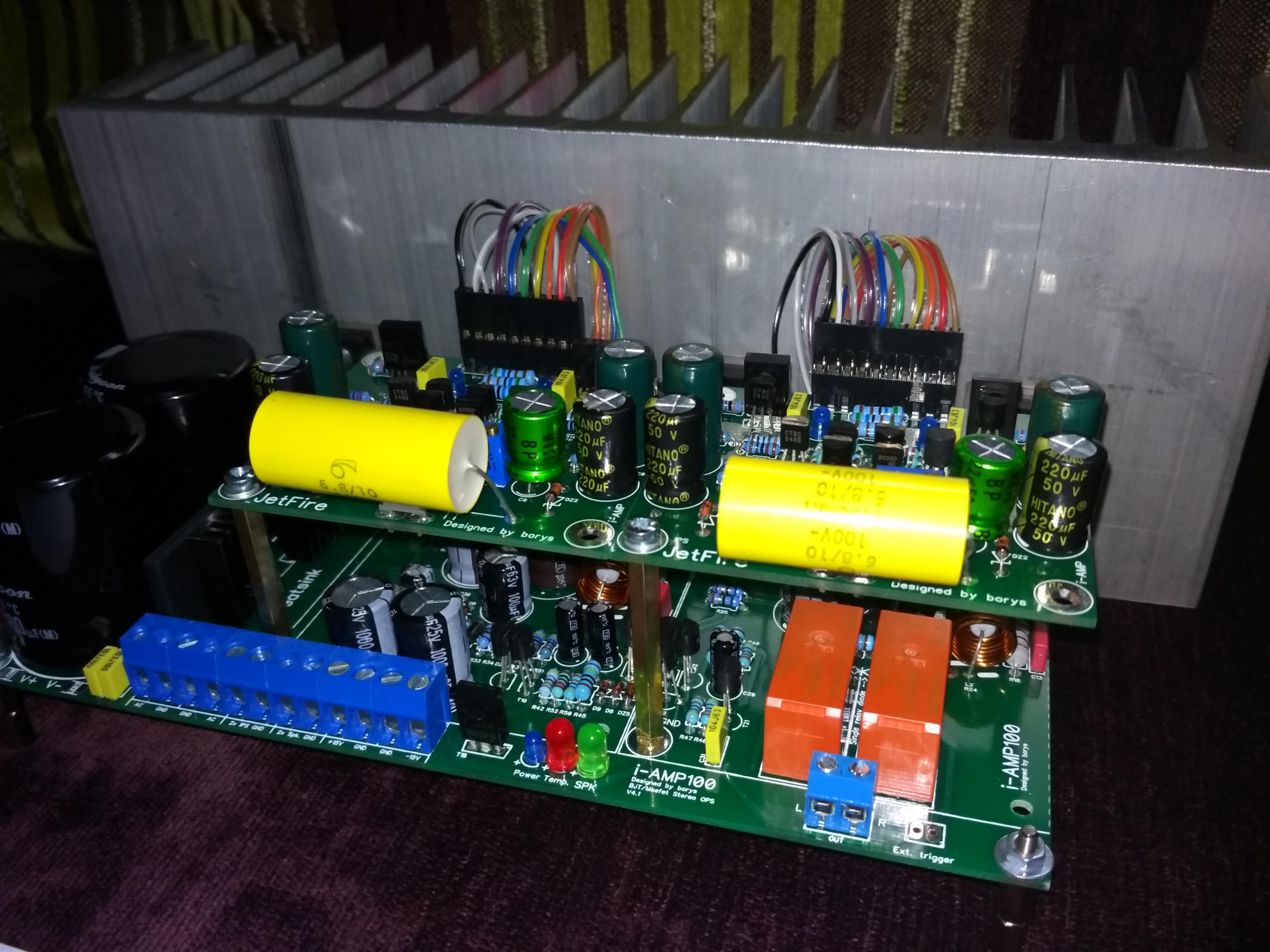

The amp above names JetFire, it is a very simple CFA IPS board with a potentiometer "DC servo''. Nothing special, looks like a basic cfa amp form the book but it plays really nice.
Bellow my PSU unit for amplifiers, I have spent nearly two months for testing and designing it and still see the way to improve it.

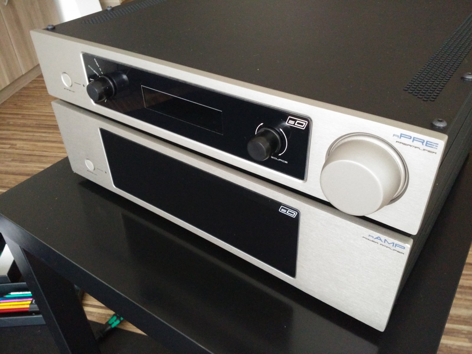

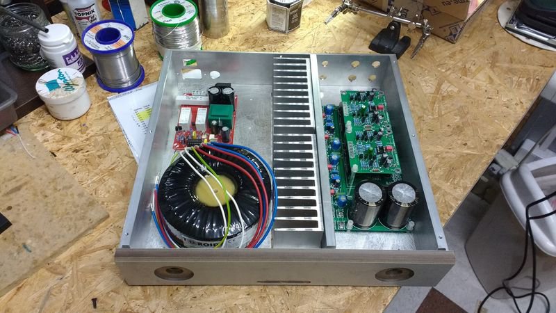

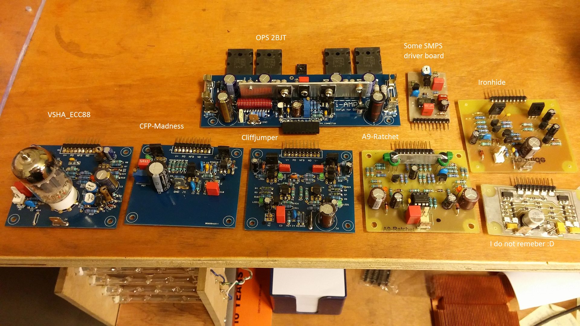

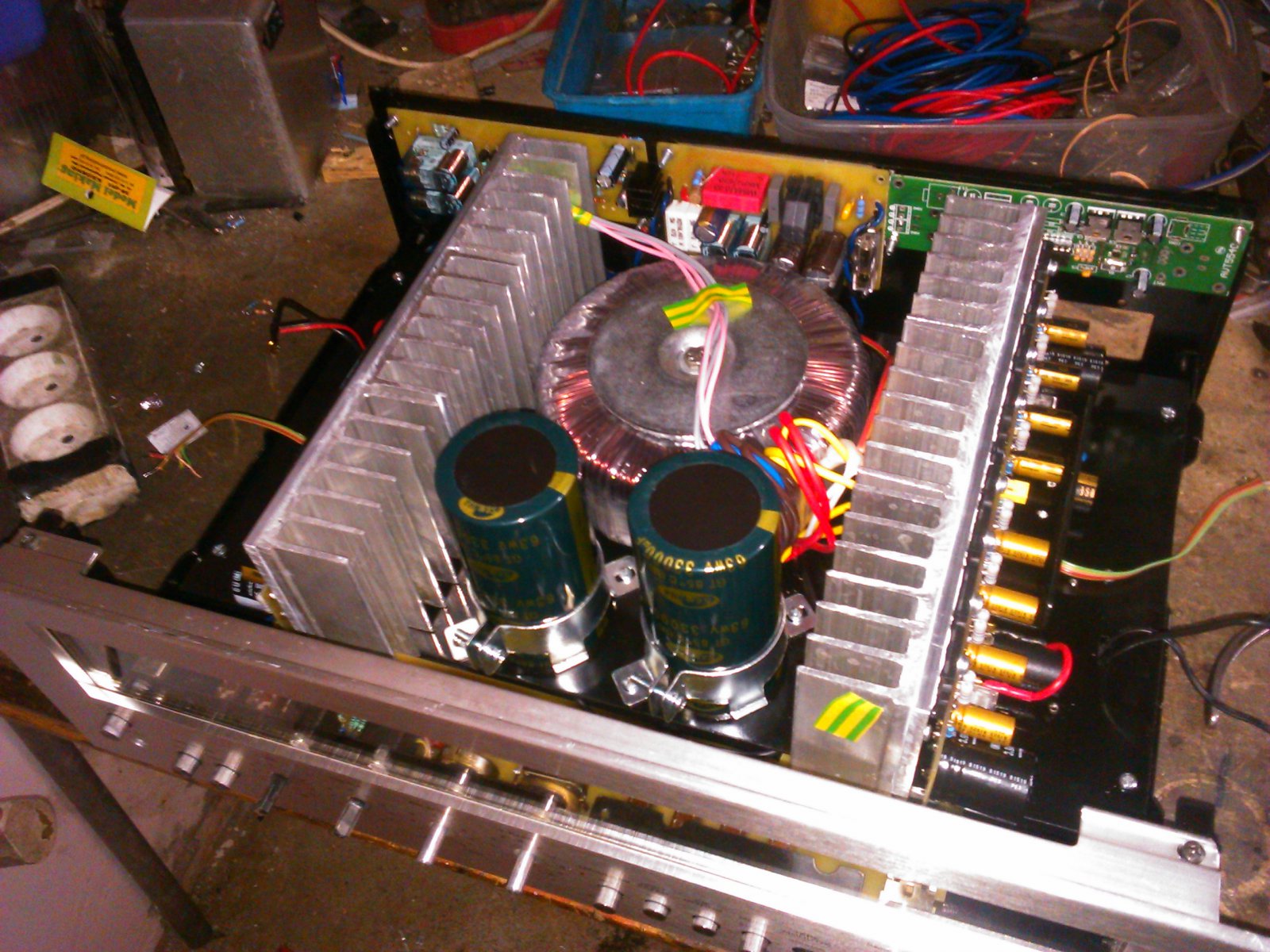

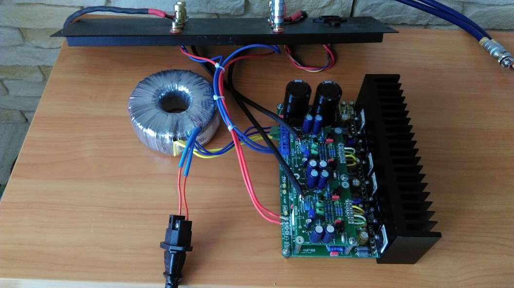

A few builds of iAMP100 and a bigger brother. The very first generation of it. Looks good, hope it sounds good too😀
