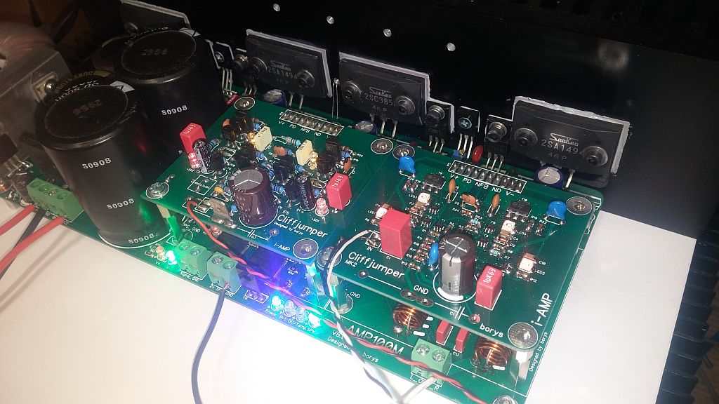

A few more toys 😀
Complete system including modular preamp and selector with DAC.
My sound card is not sufficient to measure the system anymore, time to get a new one..
Regards

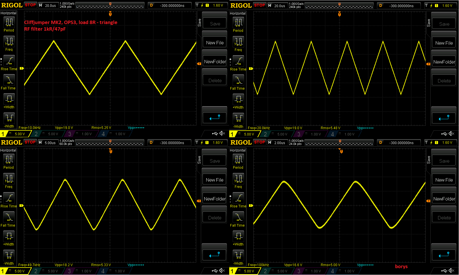

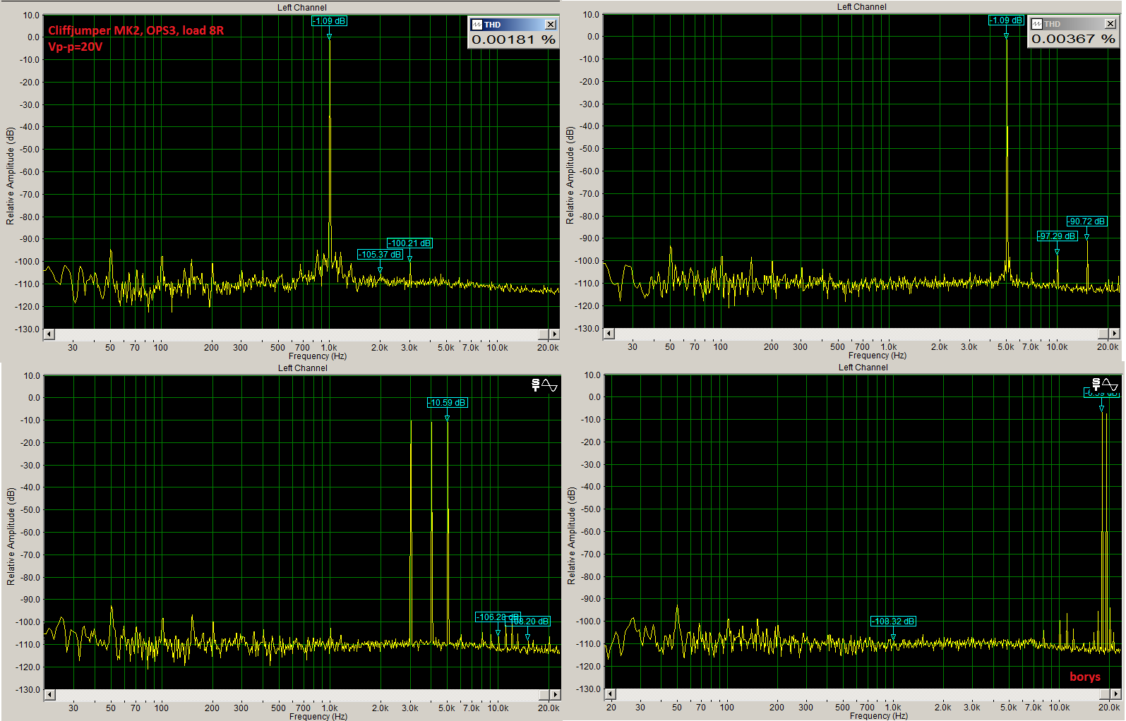

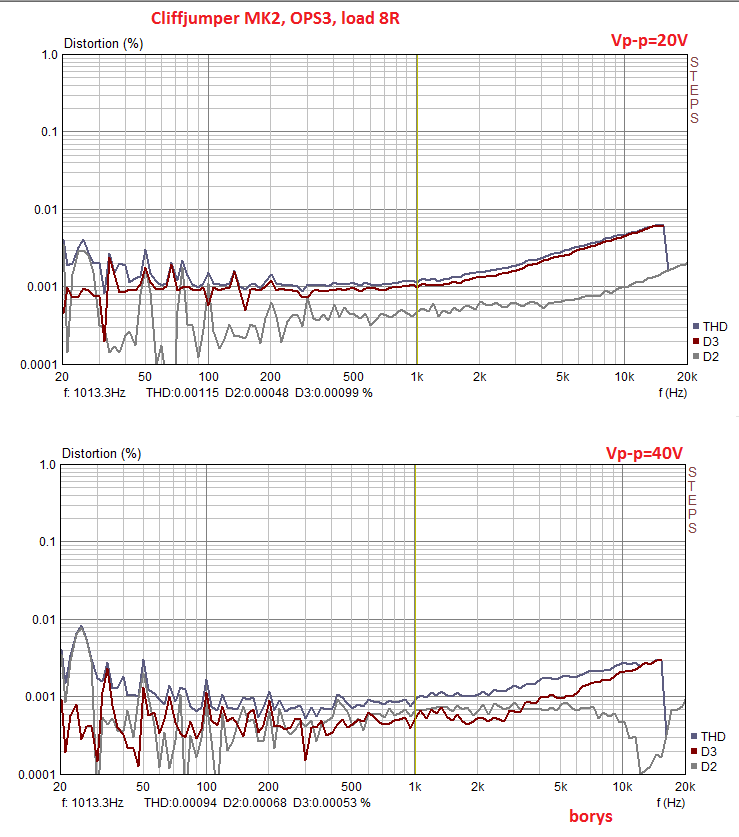

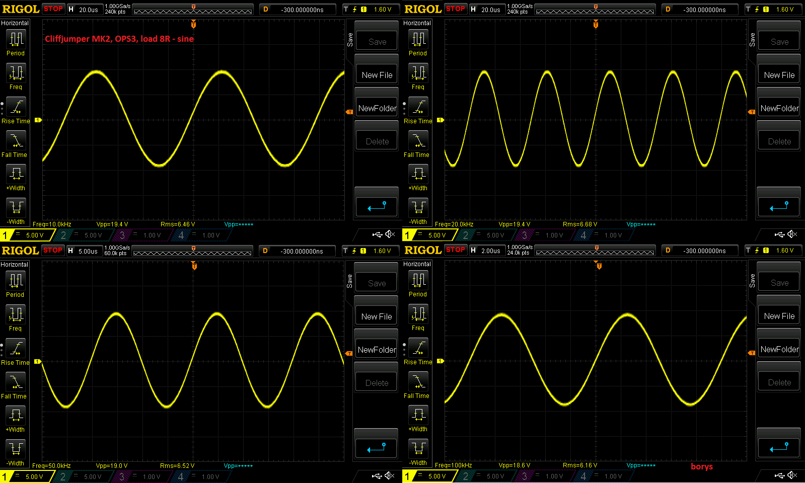

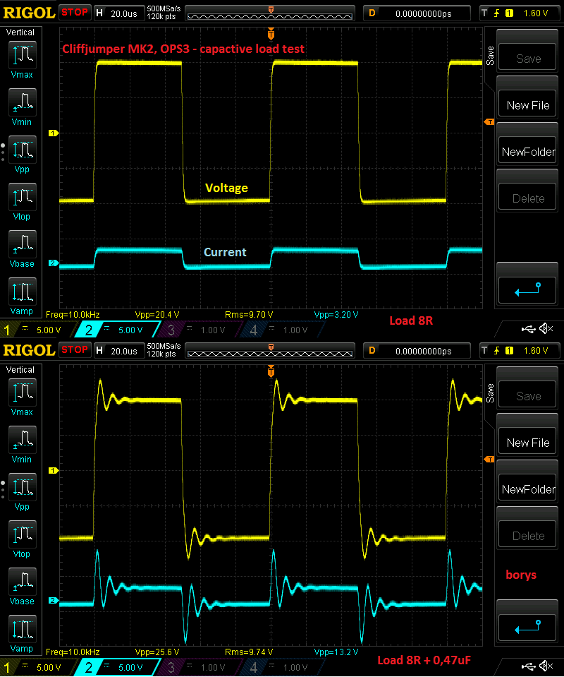

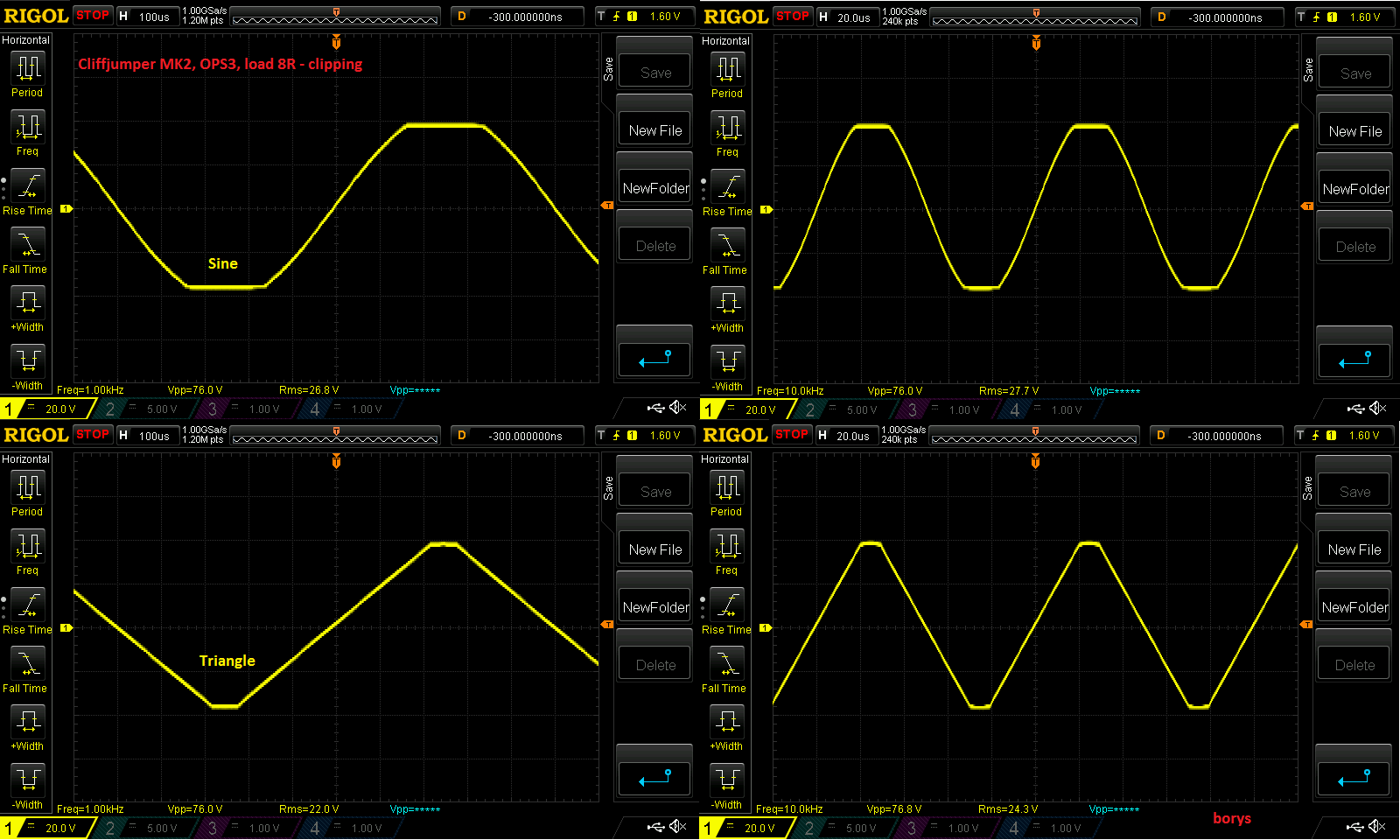

New Year, new projects must be made. So here it comes, new version of Cliffjumper IPS.
It is very simple, VAS is running threw a LTP current mirrors so there is no problem with ''unknown'' VAS bias. There is still a bit of work to be done with it but so far it sings really OK.

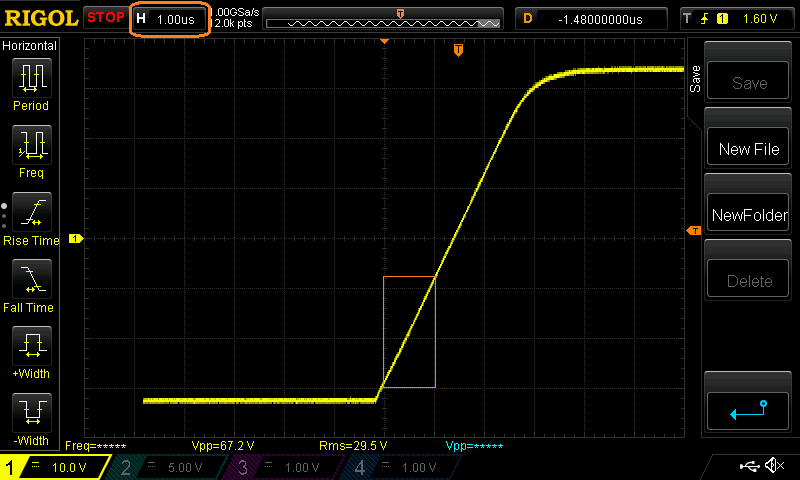

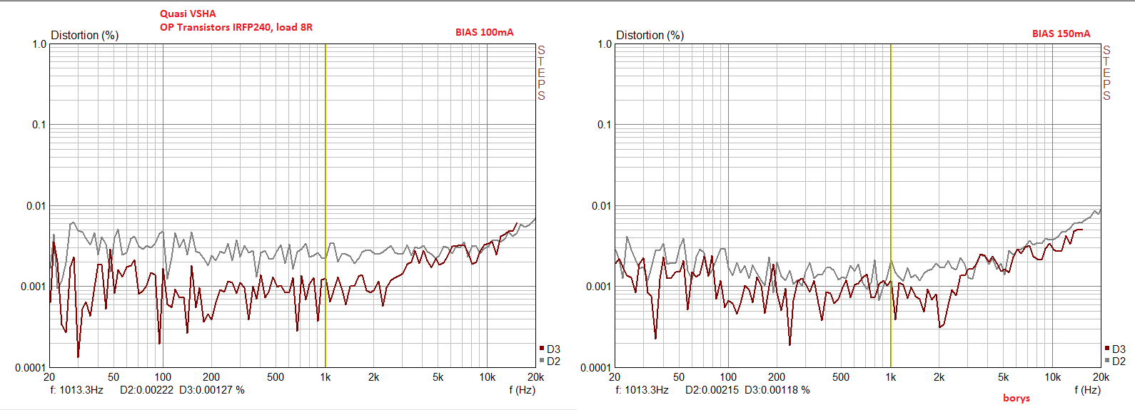

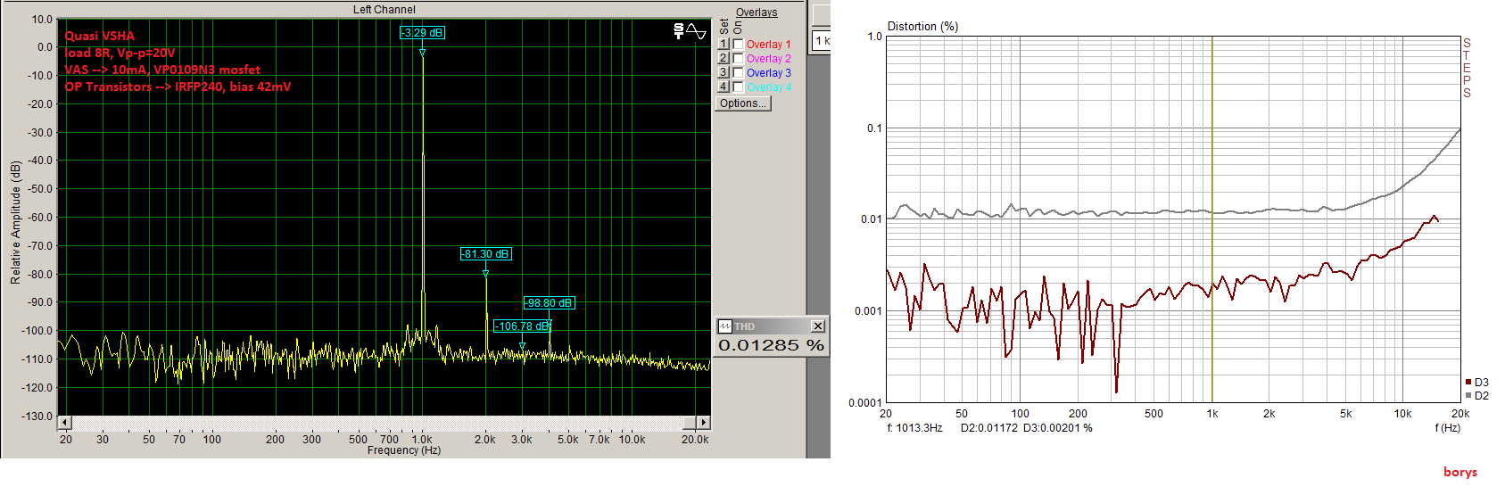

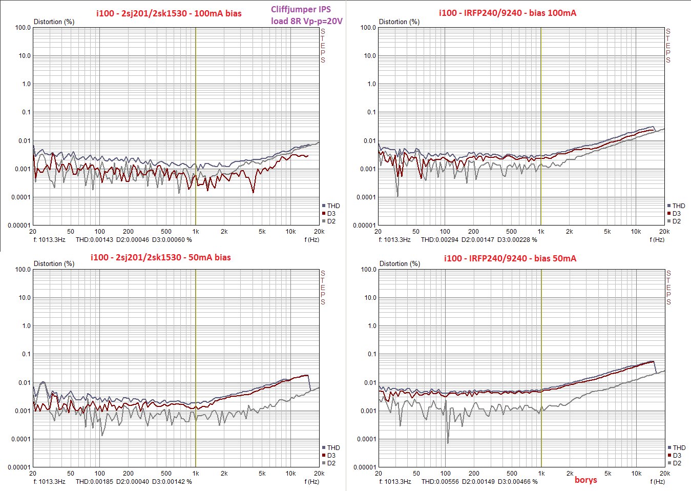

Just for curiosity I have made a small comparison in two the same circuits but differend output devices and differend bias settings.
The setup contains the same IPS boards, the same OPS and emu204 as a measurement device.
Reasults show way better performance of good old 2SJ201/2sSK1530 over IRFP240/9240 at the similar bias settings.
The third harmonic is going down a lot with higher bias, heh it looks like a warm heatsing=warm sound. And I must say the Toshiba mosfets ounds very, very nice and smooth.
Regards
Regards

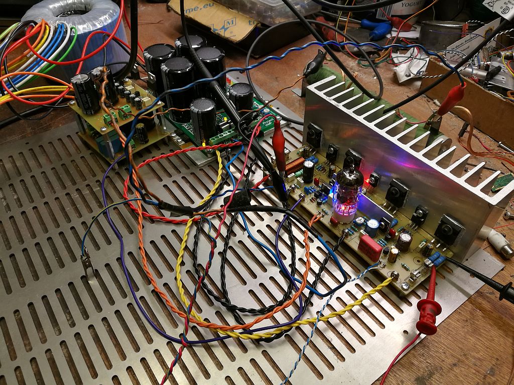

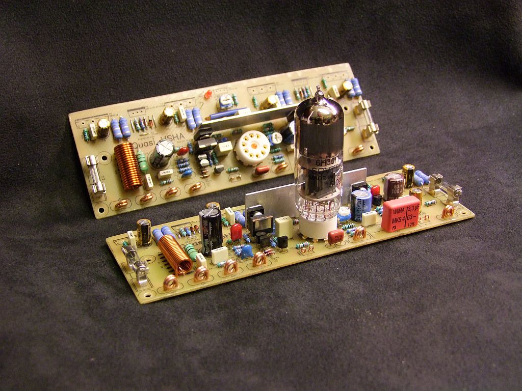

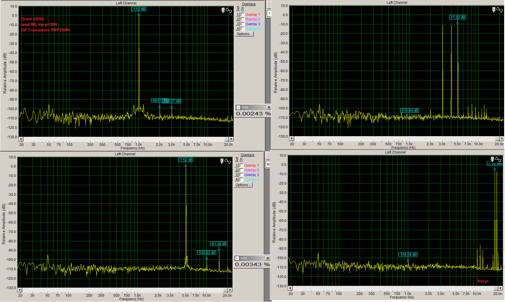

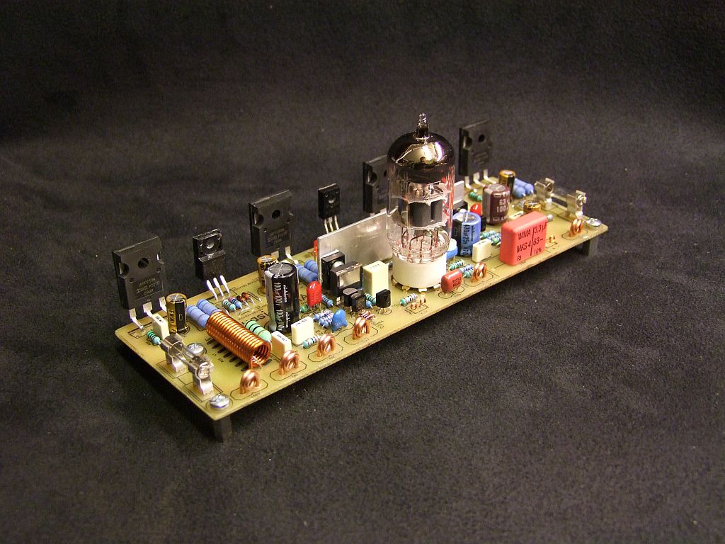

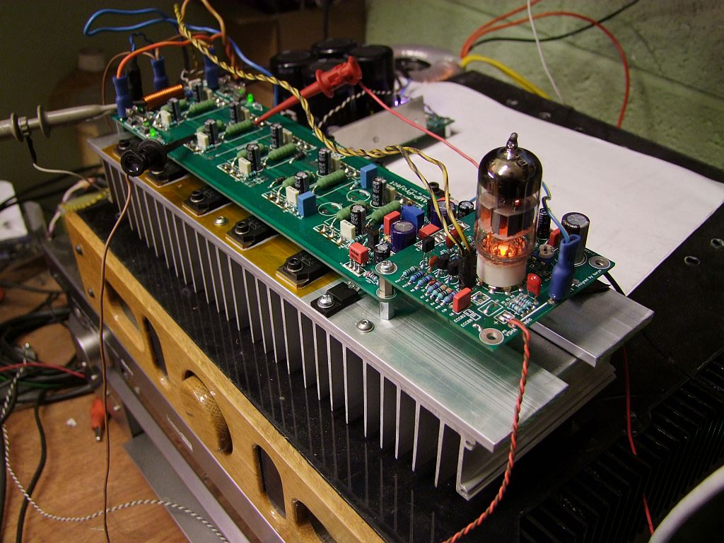

This time it names Quasi VSHA. Not the best, not the worst but I like it.
To make long story short:
-ECC88 input
-mosfet VAS cascode
-quasi n-mosfet output
As I like simple stuff this one makes me really happy. It will need some more listening sessions and some fine tuning but basicly the circuit is in ''ready to go'' version.
Any advices, upgrades allways welcome.
Bellow all documentation.
Regards Peter

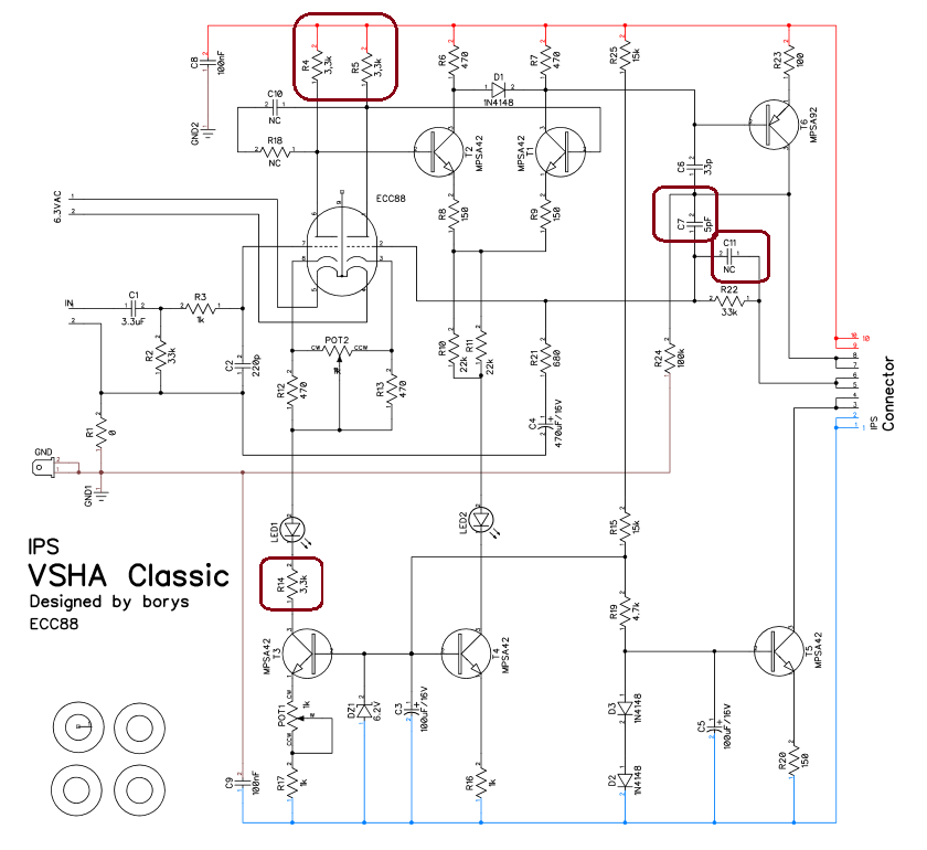

Peter,
I really like your tube/mosfet hybrid. I do have some concern about the very low B+ 12V for the tube, however. Would you consider using a HT supply for it to reduce the THD a little and add a bit of slam and impact?

Hugh, I don't get your point regarding the plate supply voltage. Where do these 12V B+ result from?

Hi Kay,
I rechecked and I was wrong; the B+ appears to be 45V rail on Borys' amp, my apologies.
He mentions 1.7mA and 34V Vak. This is marginal for a 12AU7 and also for a ECC88, though Broskie recommends Vak 100V and 10mA. But I know that it sounds good because Borys told us, so clearly it's not too low!
I would probably use a cathode follower rather than a plate load, but it's a brilliant circuit which accommodates the lower voltages of transistor amplifiers.

You don't need C5 and C9 in the NFB as it goes to the grid of the tube. Unless you want unity gain at DC. Would sound better too as the 'cap sound' would be eliminated ! You already have an input cap blocking dc signals.
Big Thanks for kind words !!
The tube supply is stabilised at approx 65-70VDC (voltage doubler PSU). With active load the anode voltages are approx 57Vdc (measured from GND), the grid is at 1,6VDC. With higher tube bias it was hard to get it to work linear, I had problem to tune compensation to make it work perfect. With lower bias (aproxx 5,5mA) triode started to work perfect. Maybe with resistive anode load it would be better at 10mA. I will try it later on.
I will remove C5 and C9 and try how does work.
Yes LED1 and R9 are not necessary. LED1 is only kind of diagnostics + lighting the tube from under the socket, after the tube is heated, current starts to flow through the cathodes and LED1 is starting to glow (so I know it is operating). R9 only takes a bit of the thermal losses from T3, I didn't know what bias amount I will use (10mA * 50V = 500mW = wartm TO92).

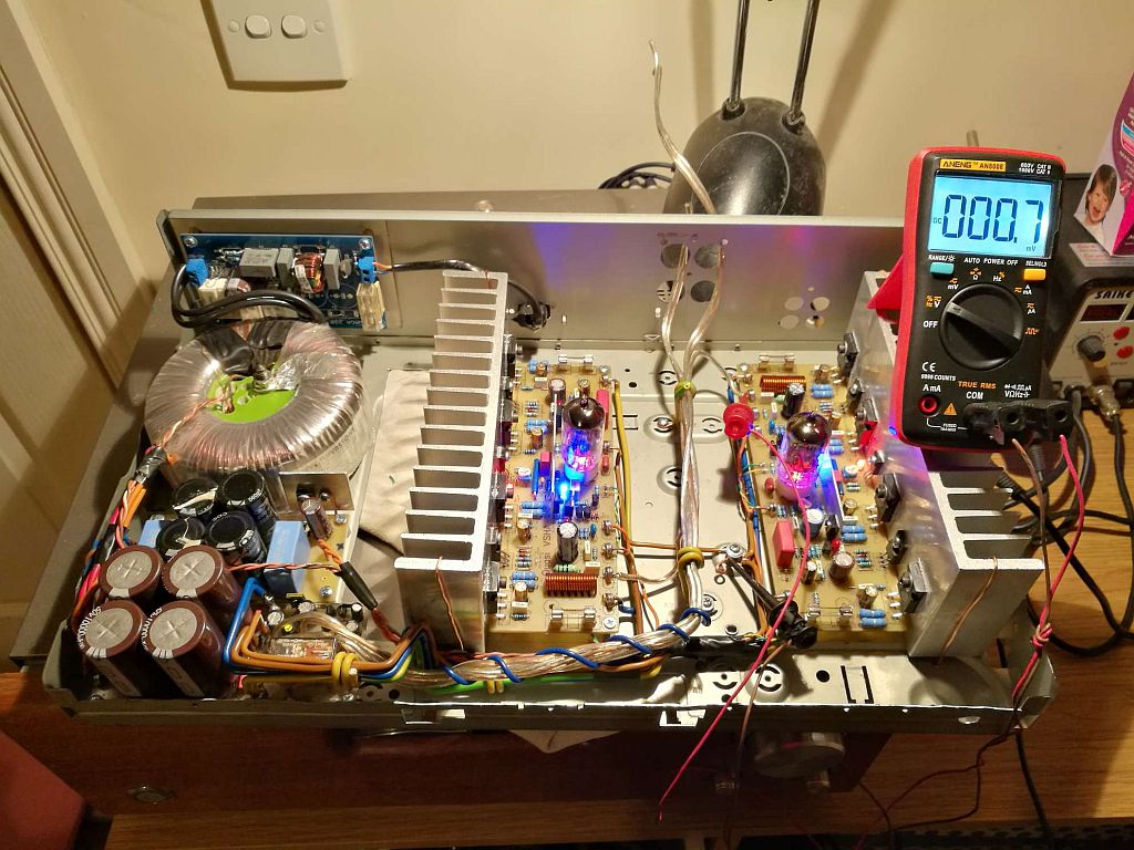

I have prepared some very temporary home (with solid core wiring) for the stereo setup and i next couple of days I have listen to it.
Bias is very stable, offset sits in the right spot all the time.

Peter,
I built a hybrid amp using a 12AU7 and a ETI SS amp more than twenty years ago but used a slightly different topology which was very different sonically.
I put the triode OUTSIDE the fb loop. You have put the triode into the amp, and used global fb to linearise it. This gives excellent figures BUT the sound of the tube is muted because it is played down by the loop gain.
If you put the triode at the output of your SS, then proportion the output of the tube to your normal fb signal and apply it to the inverting node, you put 'tube' sound directly into the fb path and confer the tube sound.
BUT you need more voltage on the tube because you are dealing with higher signals, although you can dimension the output lower so it does not overload the tube.
If you use a cathode follower, you can keep the output to fb node in phase, and ensure the lower output is low too.
You have a simpler SS amp, but you do need to accommodate the slow tube turn on so there is limited gain during those critical 11 seconds.
