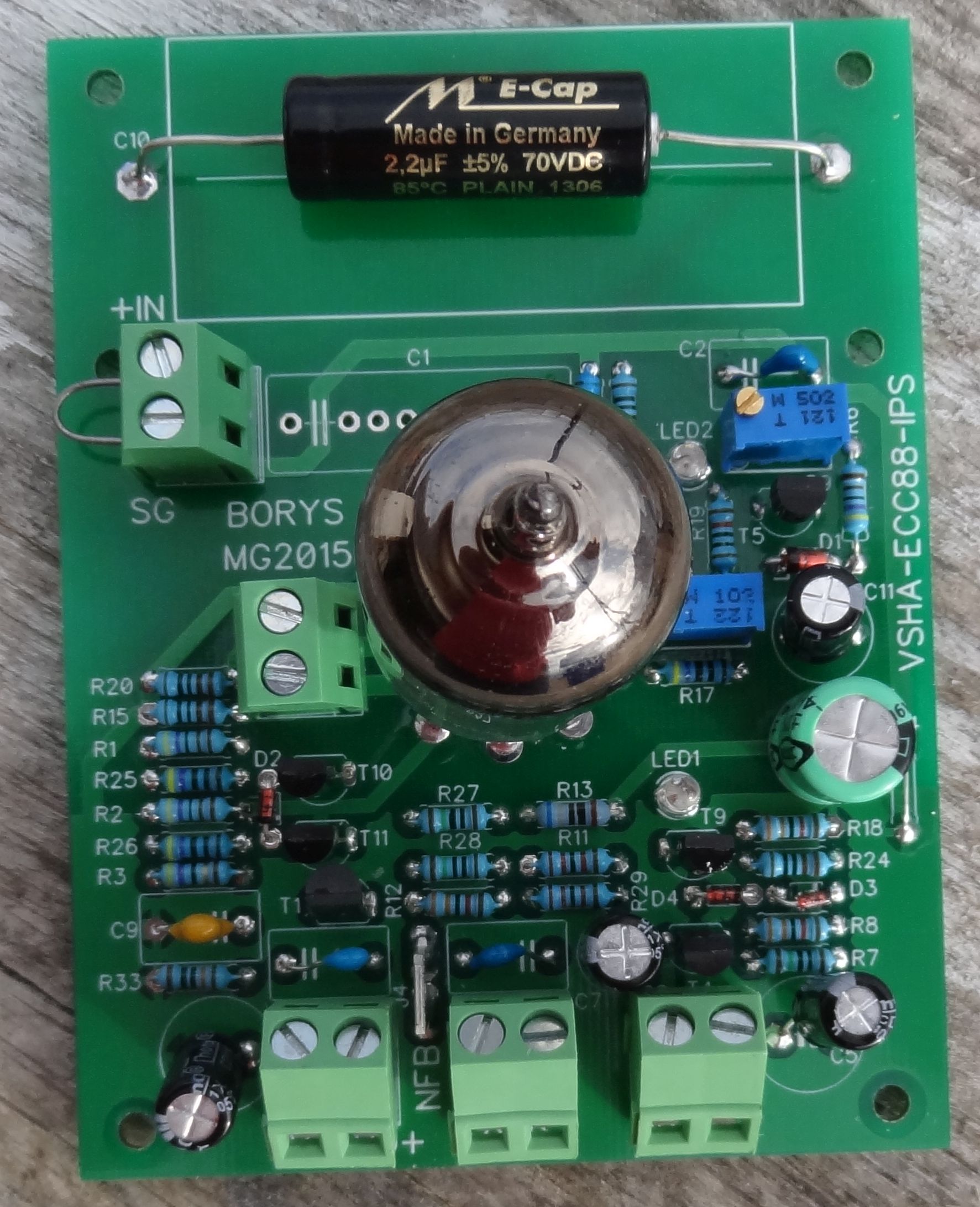

Hi Guys,
I asked in the tube forum for some help getting the 6N1P to work in this amp. There are three components that need to be changed. R6 becomes 4k7, R19 becomes 10k and D1 becomes a 15V zener. It works.
  • 6N1P.pdf
    6N1P.pdf

Hi Guys,
Hi Terry, thanks for sharing et give poeple an alternative to ecc88 hi coast. It will be interesting to have your allways objective opinion how 6N1P.
No issue with board layout?
Marc
Terry,
Using your schemat from post #391, what are the voltages:
1. Across R19 10K
2. Across R1 4k7 and R2 4k7.
3. Across R25 470R and R26 470
4. Across R29/R11 (total 11k for the two)
What sort of output stage are you using? A 2EF? Where is R9?
When you have these voltages, a full examination can be done.
Interesting in the sound quality. Good?
Hugh

R19, 10k =14v=1.4mA
R1, 4k7 = 3.58v=.76mA
R2, 4k7 = 3.90v=.82mA
R25, 470R = 3.5v=7.4mA
R26, 470R =.814=1.7mA
R29/11, 11k =102v=9.92mA
R24, 1K = 2.6v=2.6mA
For 1v at pin 3 R9 is set at 2k6
I don't have an OPS attached yet. Still testing the IPS. I have 100R resistors from PD+ and ND- to NFB. I'm getting .480v=4.8mA across each of those.
Blessings, Terry
Hold on and don't build this 6N1P circuit until I can do more testing. I suppose I should have built the ECC88 circuit first to verify the board layout. Right now I have no sine wave on the output. I will build one for the ECC88 to today so I can verify the boards first. If that tests OK I will come back to the 6N1P.
Stay tuned.
