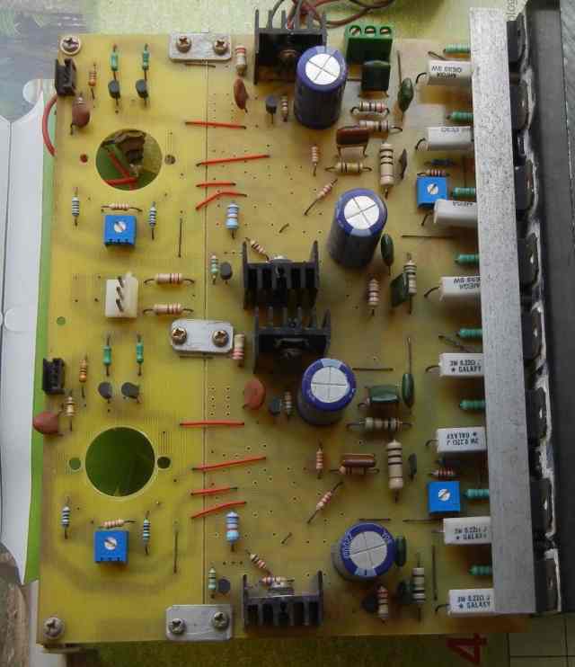

I have made several hybrids over the years. The tube stage being part of the power amp and some just ahead of the power amp , like a low gain preamp with a low gain power amp. Sound was quite nice I recall but don't remember it being 'spectacular'. Whatever that could mean !😉
I searched for the last one I made in 2005 ! Appears that I have removed the tubes and sockets as I was busy experimenting with some new preamps ! Maybe I should put it back and see how it sounds. I can't seem to remember how this one sounds. I do remember that I had to turn on the heaters of the tubes before powering up the ss part. 6922 tubes and Darlington TIP142/147 power devices.
Will have to deal with it after studying it again. Can't find the files on it.
There are a few components below the board. Don't remember why I added them. I did add a dc servo that hangs off on a separate board. You can just about see the wires on the top. Will go over it again to see what I had done and why.
There is another older one ,still intact, which is just an emitter follower stage with a triode strapped 6L6 input tube. That used to be good but all I remember is the clarity of the sound. Don't remember the bass or mids etc ! Maybe I should add a power supply and refresh my memory !

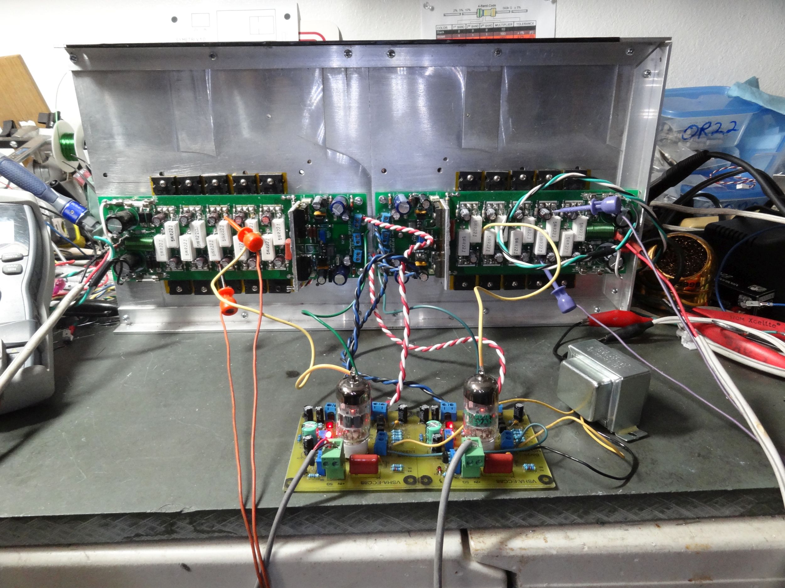

Hi Marc,
I got a chance to play your boards through my Slewmonster OPS today. Wow, sounds awesome. I had it playing on +-70V rails and it is quite nice sounding. I didn't try it without C9 so I can't comment on that but it is very good sounding and stable. Offset drifts a bit but not too bad. I used 100v 10u caps so no issues with the higher voltages.
Blessings, Terry

Thanks terry for reporting. So Board layout was not the reason of your poor sound quality feelings with 6nP&. Good to know.
Marc
Yes that tube is not a drop in replacement for the ECC88. The pinout is the same but it need something different in order to work. I would like to find a circuit that works with it as I now have quite a few of them.
I am going to try and set up an A/B setup using two pair of Slewmonster OPS so I can do a comparison between the ECC88 board and the 12AU7 board. I want to see if I can hear any difference between them. I have about 7 different Tube hybrids now. A couple have noticeable differences in sound. I'm not sure yet about these two.

Hi Peter,
The first tubes I tried were the 6N1P. Someone suggested them earlier on in the thread so I ordered some. They just don't work in this circuit. I just received the Electro Harmonix 6922 which I used in your ECC88 layout and these 6DJ8 SYLVANIA tubes that I used in Marc's layout. I tried both of them in your layout and they worked perfectly. I did need to make slight adjustments on the cathode bias and offset trimmer to fine tune them when I swapped them but that was probably unnecessary since they were so close. I think folks could swap out tubes and not notice at all if they didn't have a meter attached. I have kind a of a busy day ahead of me tomorrow so it may be evening before I get a chance to do any more listening. Thanks for another interesting design.
