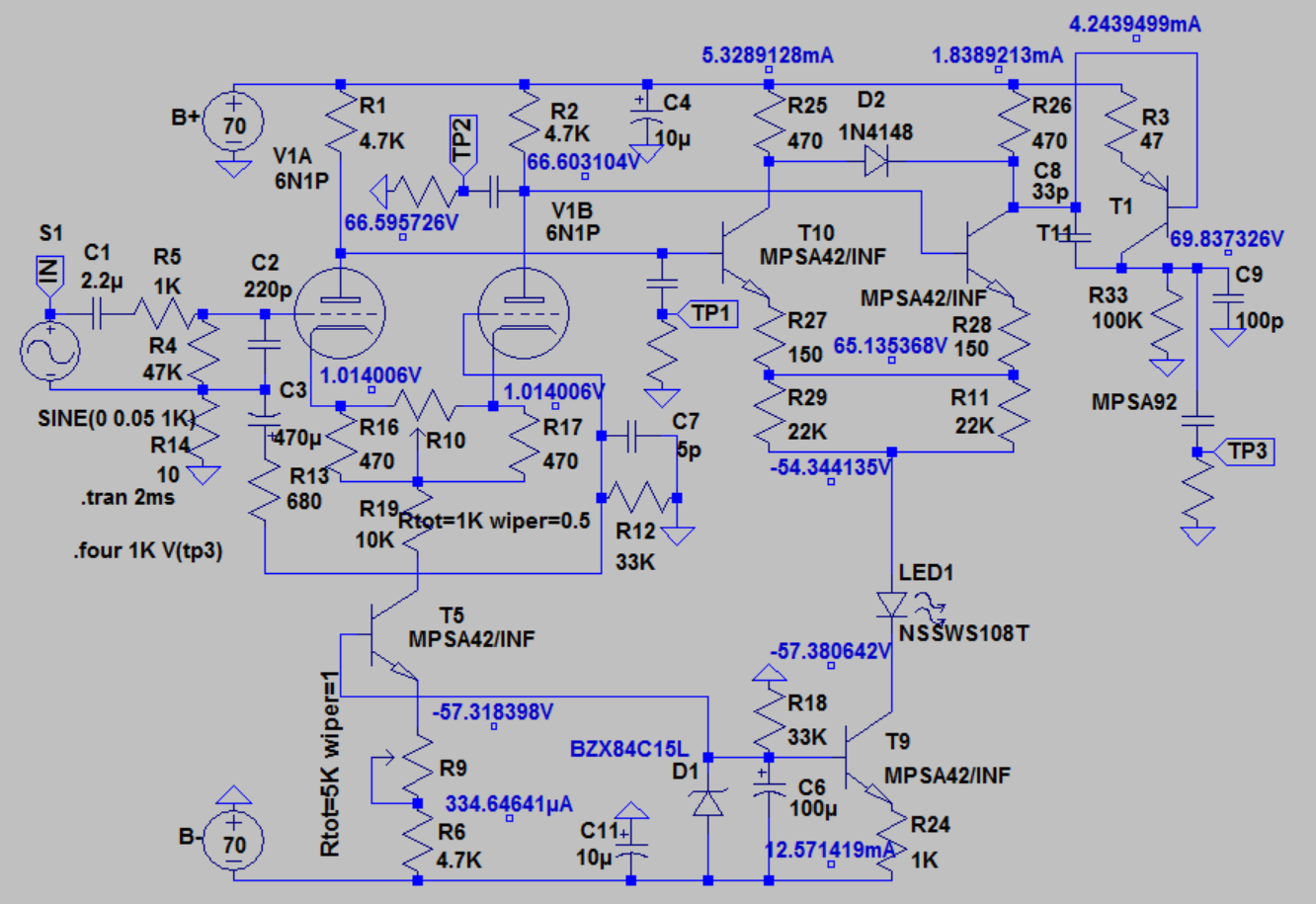

OK, I did some more testing. It seems my sine wave generator was acting up. Now that I have it working again the 6N1P IPS is playing beautifully. So far I have only played it through the Slew mini because that was handy. It sounds wonderful. The only thing I may change is using 1/2w resistors for R11 and R29. If my math is right, 103v across 11k is nearly 1W. The 1/4W resistors seem to be holding without burning though I'm not sure why. Probably those little .6W resistors will fit right in.
One other thing I noticed is that if I bias the tube at 1V the offset is not stable. Lowering it to .8v settles it down.
So the layout seems to work fine. I will still build one with the ECC88 just to be sure.
R19, 10k =14v=1.4mA
R1, 4k7 = 3.58v=.76mA
R2, 4k7 = 3.90v=.82mA
R25, 470R = 3.5v=7.4mA
R26, 470R =.814=1.7mA
R29/11, 11k =102v=9.92mA
R24, 1K = 2.6v=2.6mA
For 1v at pin 3 R9 is set at 2k6
I don't have an OPS attached yet. Still testing the IPS. I have 100R resistors from PD+ and ND- to NFB. I'm getting .480v=4.8mA across each of those.
Blessings, Terry
Current of R25 plus current of R26 is almost same as current of R29||R11.
7,4mA + 1,7mA ~= 9,92mA. OK.
That current is almost same as current of R24.
9,9mA ~= 2,6mA ???
This does not make sense. Is the schematic correct?
Sorry, I just checked my notes and R24 measured 10.8v so 10.8mA. I will take new measurements tomorrow now that I have it attached to an OPS and have the offset set. I'm attaching the schematic that the guy from the tube forum posted.

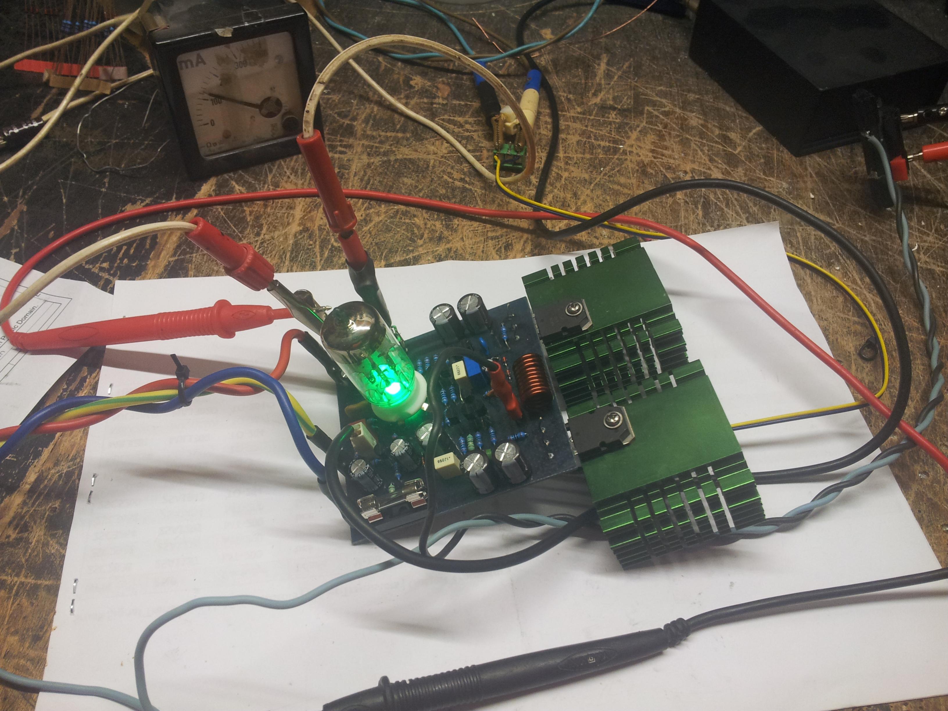

The HD version is working now. There is hidden diode in the tube socket to make them look nicer 😛
The quick home made measurements bellow, the amp is stable, there is no oscillations present when the tube heater and main psu are powered at the same time, only DC is going bit up/down until the NFB is starting to work (heater takes around 5-8s to heat up the tube).
Unfortunatly I have pulse regulated psu for the heater so there are small artefacts present at the output (with good filtered supply all is OK).
Now there is some time for the listening tests of both versions.
Suprisingly the different tube gives a bit different sound signature.

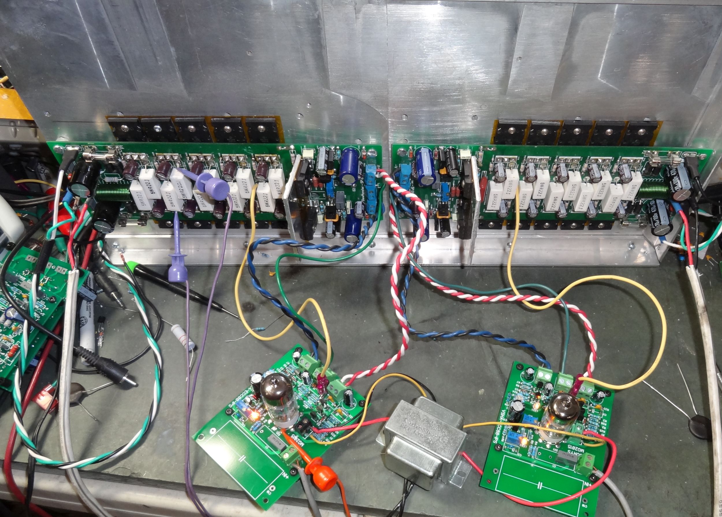

OK, so after some more testing, the 6N1P works sort of but is a little noisy. Some of the guys on the tube forum suggested that the 6N1P may need a lot higher rails to work properly. I have been testing at +-50V through my Mini slew boards. Tomorrow I will try it with my big boards so I can get the rails closer to +-77V and see if that helps. As of right now I say stick to the ECC88 schematic. I know for sure that works well.
More tomorrow.
OK, I built the boards for the ECC88 and it works perfectly. Running it at +-75V had to reduce R6 to 390R in order to get the cathode to 1V using a 1K trimmer for R9. At these voltages, R9 ends up around 100R. However, at +-40V rails, with R9 maxed at 1k the cathode is only .8V so either R9 should be 2k or R6 needs to be adjusted for different rail voltages.

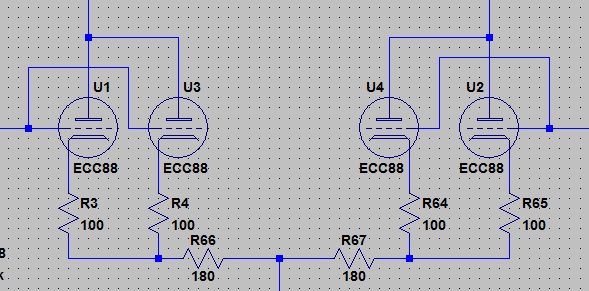

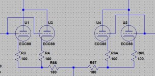

The ECC88 has much higher gm than the 12AU7-ECC8 (about 3x difference) and much lower plate resistance (almost 6x difference) according to an old Brimar book I have. The 12AU7 has a mu of 20 where ECC88 is 33. In general, low-mu tends to sound smoother although in a given circuit the overall performance will be effected by gm, rp and mu.
As long as the heater voltage is within 10% of the rated value, the cathode will be at the correct temperature for proper emission. Once heated, all that is required is to get the plate positive with respect to the cathode for current to flow. That current will be limited by rp, so at low plate voltages a lower rp is beneficial if some target current is required for the rest of the circuit to function properly. In standard tube circuits, operation at very low voltage was common despite their reputation for high-voltage use. The fashion in the 90s to operate the heater at 5.5V was completely without merit. Where the heater life is extended, the cathode life suffered so overall there was no benefit.
Bimo's parallel input triodes gives the expected result of smoother sound and improved performance as the composite device has lower rp and multiplied gm compared to the single.

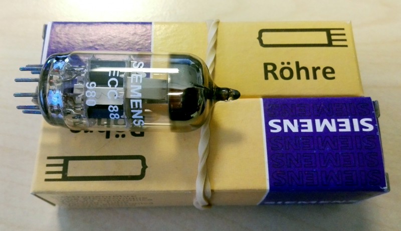

I have exacly same siemens tubes and they are superb !
