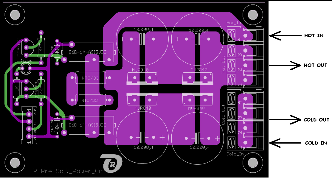

Patrick, the functionality of the "Soft-Power-On" - PCB is very simple.
Just have a look at its implementation (image attached, showing the current version with Mains-DC-Filter).
Attach mains' hot and mains' cold to the PCB connectors as shown on the image.
As soon as the top relay closes (the "close-signal" comes from the µP of the VCPre, after a "Resume-from-Standby - command), the mains current flows through the NTCs (the bottom relay is still open!), thus delimiting the inrush current.
After 600ms of delay (as been programmed in the PIC processor) the VCPre sends a signal to close the bottom relay, thus letting the mains current flow unhindered. The status LED will shine then!
I cannot explain better!

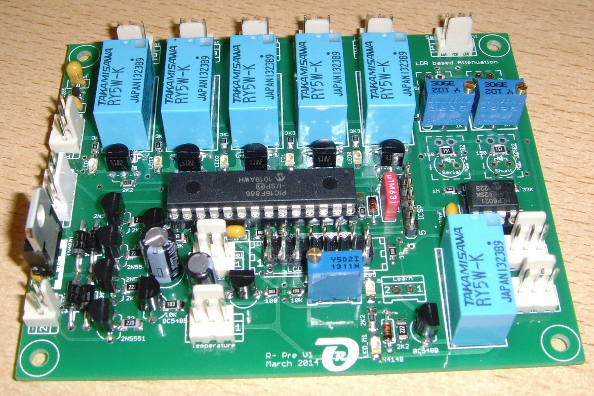

Patrick, I am sorry, but I do no longer have a Reichelt-cart for the VCPre.

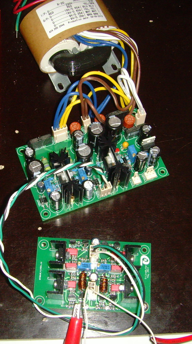

I have been working on the R_Pre (which is the sequel of the VCPre) since some time now (see attached image; the image shows the R_Pre without the LDRs being soldered), and I do share your impression.
This Pre (attenuator) sounds very well, ..., because: "it does not sound at all; it does not have a sound of its own!".
The "LDR - attenuation" does not veil (? - is this the correct translation?) anything, nor does is emphasize anything: it plays the music as it has been recorded!
All of the functionalities of the VC-Pre have been kept (all of its functions can be controlled remotely, has 5 (!) input-sources, has access to unmuted and muted signal, ...) and will be equipped by a very
well performing, LM3x7 based tracking-pre-regulator PSU, my version of CALVIN's line buffer (2nd image) ...
I am currently evaluating (a German DIY - friend with very well trained ears! is assisting) the performance of the R-Pre.
Best regards - Rudi_Ratlos

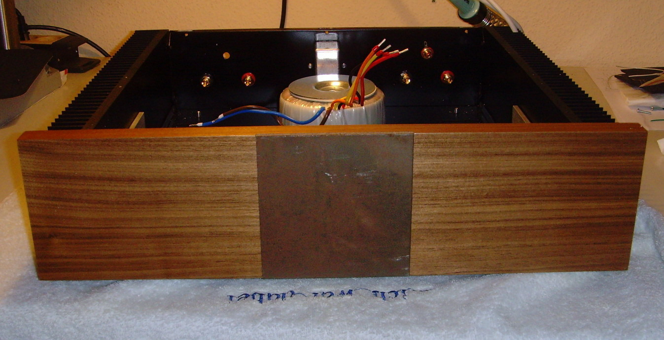

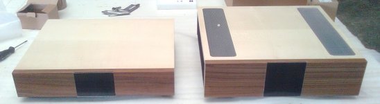

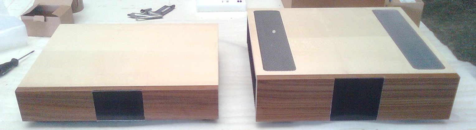

I need to wait for my carpenter-friend's Pre- and Amplifier (dedicated to the red-and-gold TO3-SYMASYM) cases, before I will go on!
Gerhard told me that I will have them before the end of this week!
Best regards - Rudi

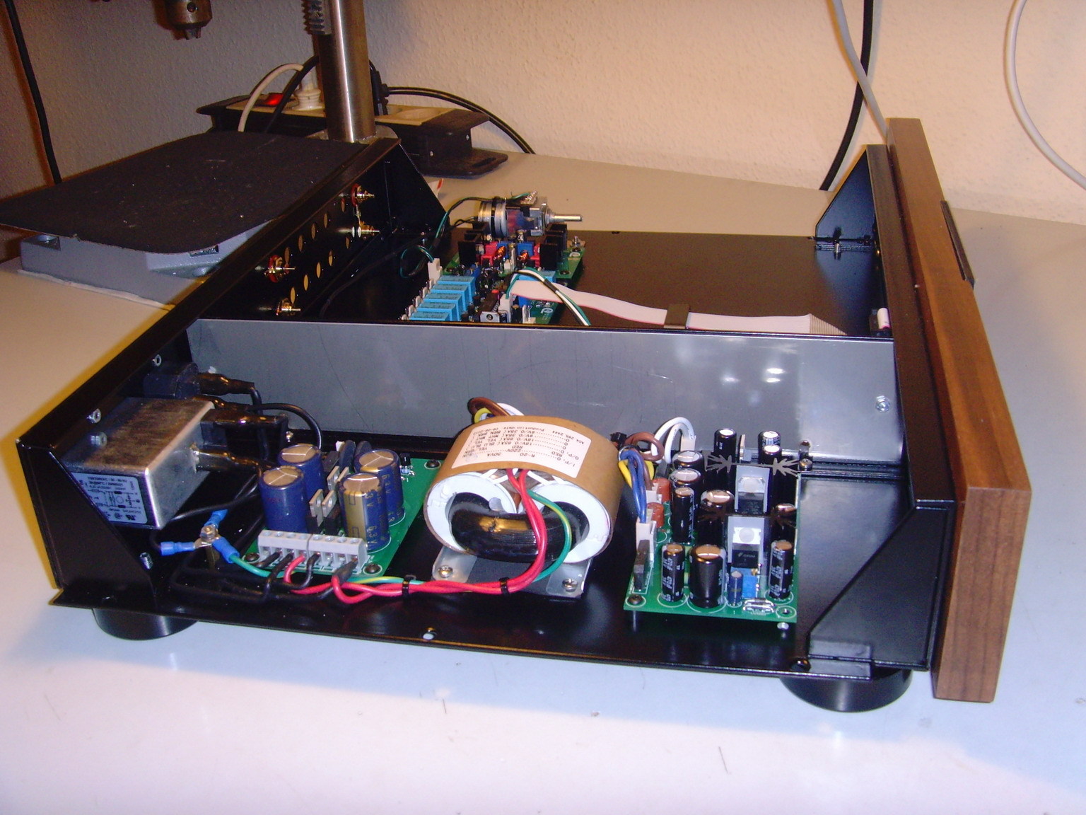

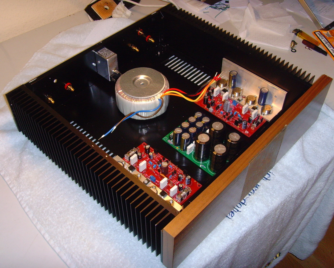

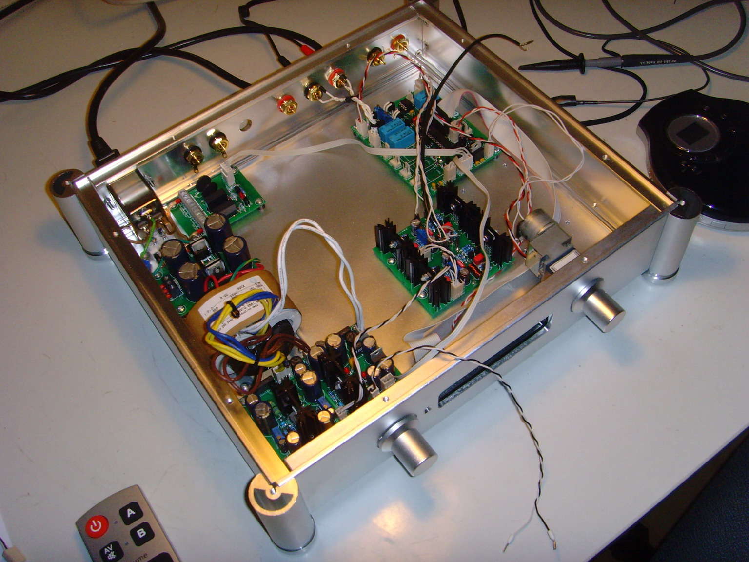

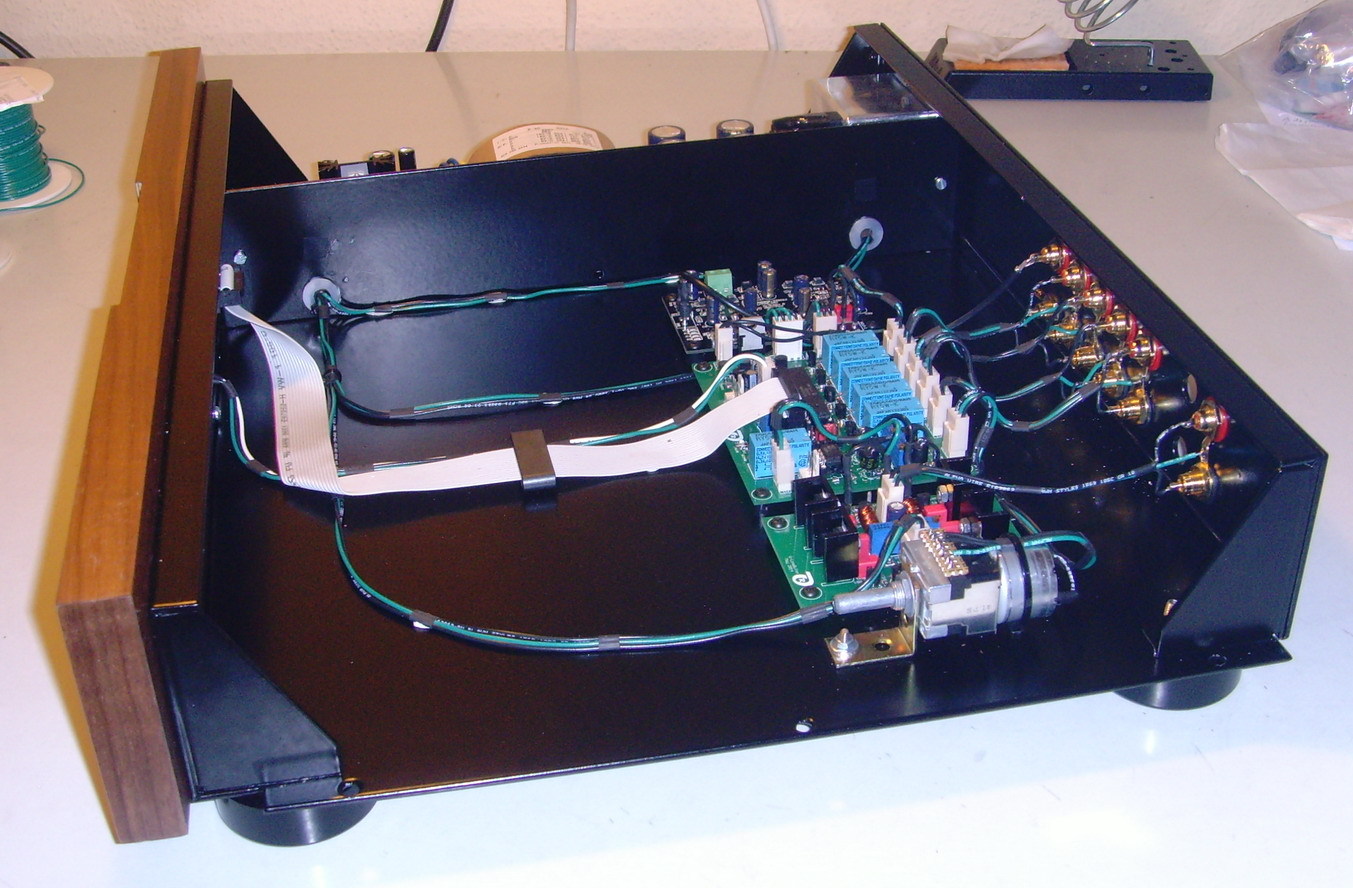

I have completed the build of the PRE in Gerhard's Pre-Amplifier case.
The PRE contains Jean-Paul's DAC, my R-PRE and a line-buffer.

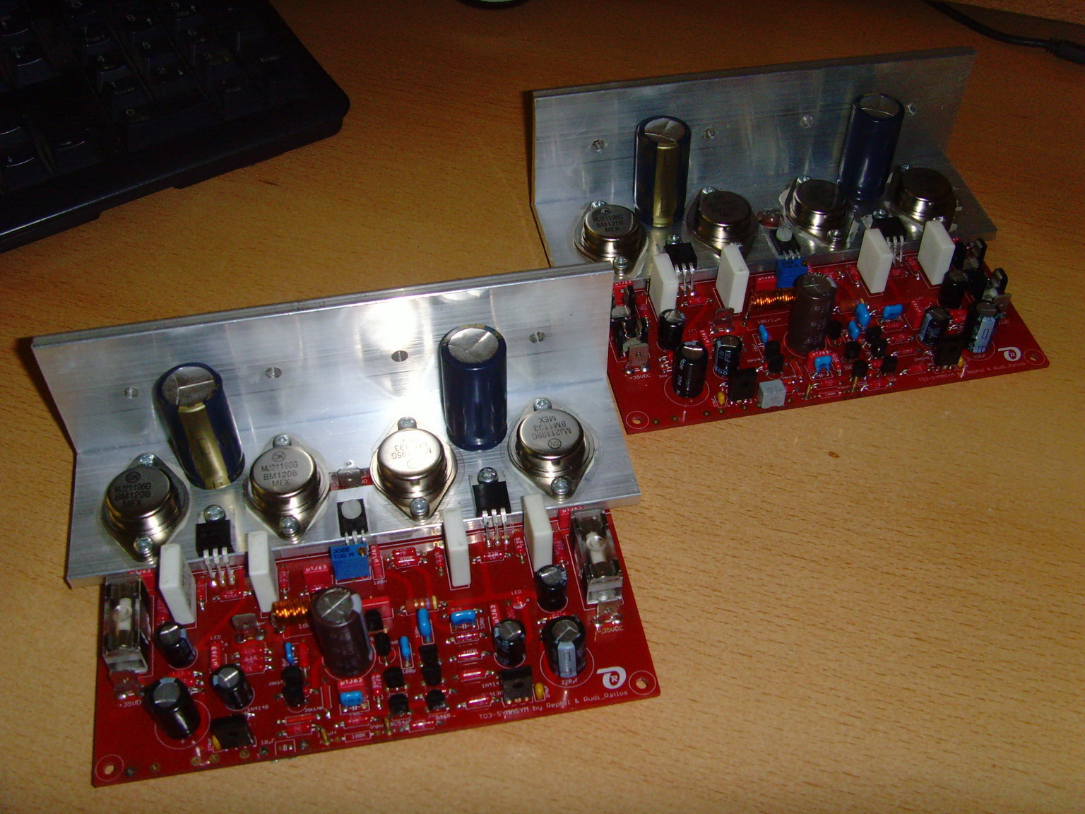

Omar and I are currently working on the replacement of the analog motorized-potentiometer by a digital version (based on MCP4151, followed by a VCCS).
There is still a lot of room in the case, and I am already thinking of installing a RASPBERRY PI with WLAN-connectivity into it as well.
But I will go on and install a TO3-SYMASYM into Gerhard's amplifier-case first.
The quality and "look-and-feel" of his cases are really excellent!

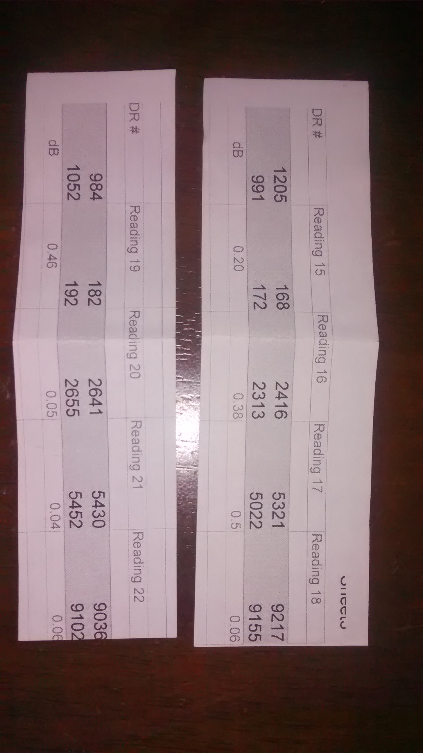

My problem with vcpre as far as I remember is wrong soldering of LDR's top ones are soldered to the bottom and vice versa (shunt and series ?). I remember adjusting vol and putting trimpot in balanced position, but with change in vol - balance was going off.
I have attached pic with values of ldrs, if it helps.
I ve seen a method of adjusting balance feeding 5vdc into inputs , will it help to balance it ? I will try it for sure.
It seems better matched ldrs are in the bottom position, thether values of less matched are too off, and I should find another pair to solder ?
