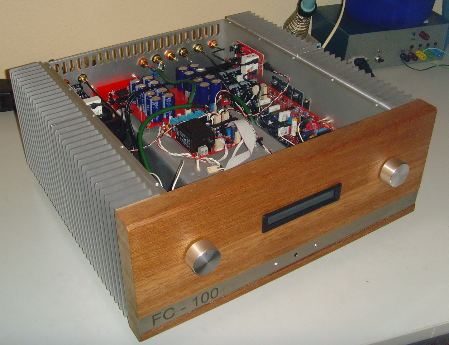

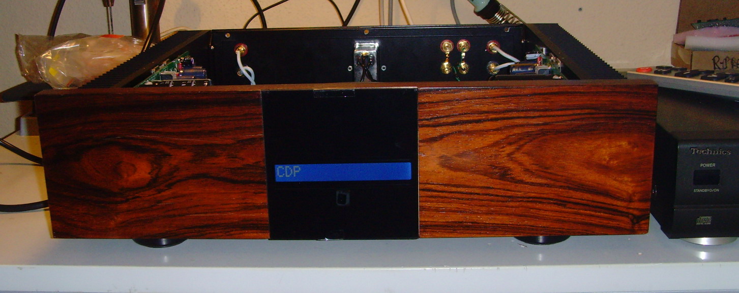

Rick, find attached 2 pictures.
I have incorporated a VCPre into my FC-100 amplifier and made it an integrated amplifier.
Since some time I have been working on integrating the VCPre into a stand-alone PRE-amplifier.
But since the VCPre (its LDRs) is not able to drive a long pair of RCA-cables and (or) a low-impedance amplifier, I decided to connect the VCPre's output to a buffer.
I have chosen Calvin's buffer.

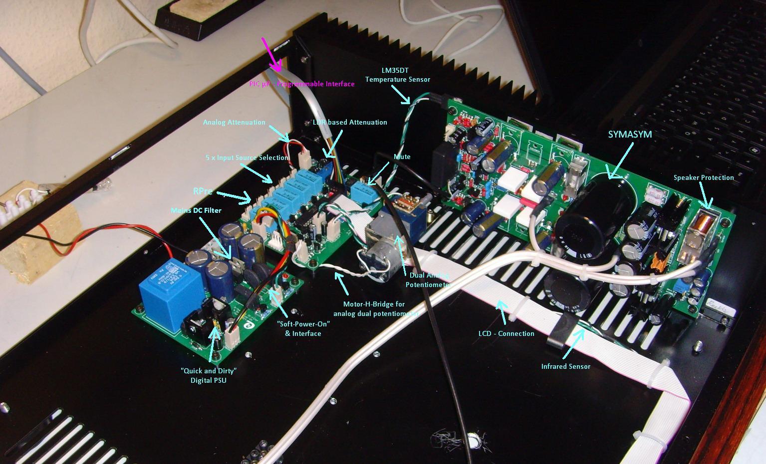

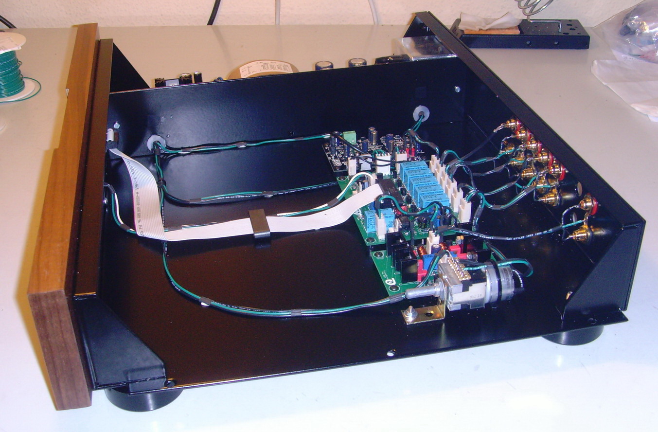

since all the functions (Power On/Off, attenuation, source selection, ...) of my PRE can be controlled via a remote control unit, I do not need a switch, neither do I need a knob on the front panel.
This is the reason why I have currently installed the motorized dual potentiometer right into the case (see attached image 1).

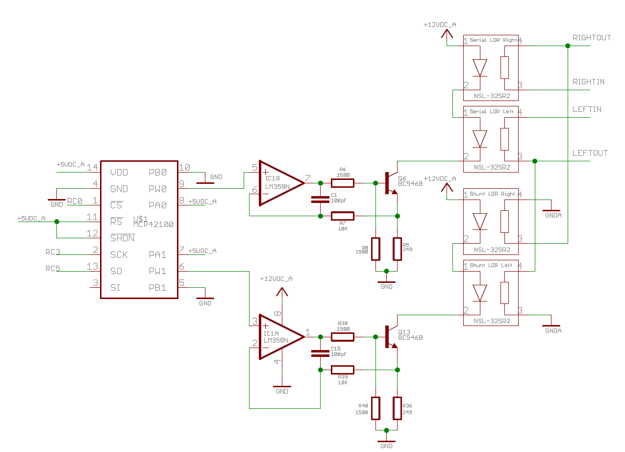

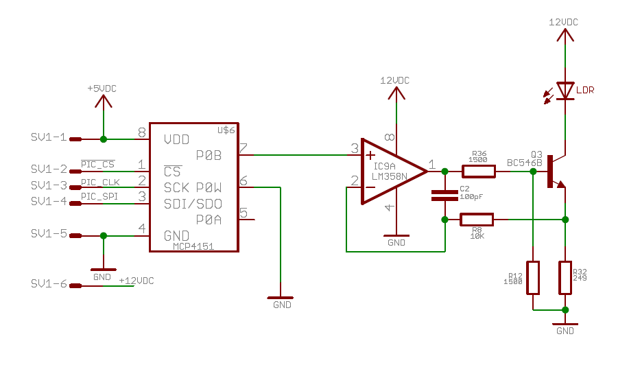

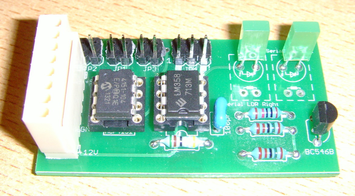

But this potentiometer looks like (is) a real anachronism, and I would like very much to replace it by a "digital potentiometer" (MCP4151, which has 128 wiper steps) followed by a VCCS (see attached image 2).
I have already done a layout for this schematic and have etched and populated two of the resulting PCBs (see attached image 3).
I am using simple LEDs instead of LDRs on this "evaluation-PCB".
My problem: I am no good at programming a PIC - µProcessor in "C".
I have been programming IBM-mainframes in Assembler for more than 35 years of my life, but now, when I program a PIC in "C", I get lost and desperate, if I forgot to insert a ";" or a "}" into the code.
I am of course able to change the existing VCPre's code (whose inital programming has been done by METAL), if required, but implementing a new function, ...?
If there is anybody among you, who has the time to assist me, who knows the internals of the PIC16F887 and has a PIC-evaluation board and who knows, how to program it in "C" (for example the SPI-interface):
I will happily send him one of the two evaluation PCBs and will program together with him the digital potentiometer interface.

Look at this very quick demo video Rudi, this is what I just proposed to you to do when we first started this project back in 2013, just use a digi pot, I tried it already back in DEC 2012. Anyway, the initial setting is at volume max, I just press down button to lower the volume, look how the upper LED fades and the lower LED brightens..

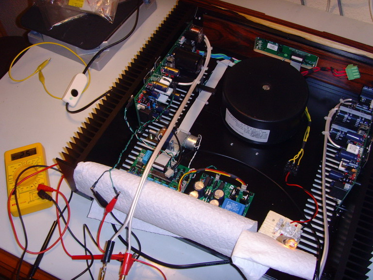

I am able to adjust the quiescent current of my current SYMASYM_PCB (see attached image), but when I want to "marry" it to my (your) PRE: it is saying that " Startup.as." is missing!
I feel very happy that you have answered my post!
You are the very best to assist me!!
Best regards - Rudi_Ratlos

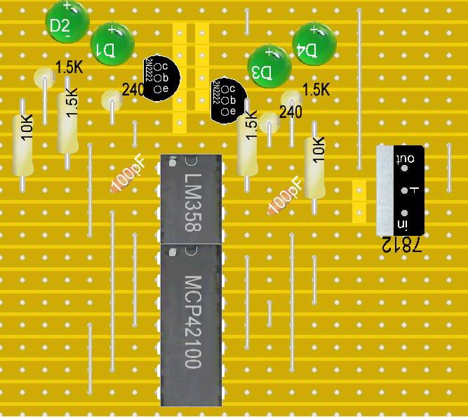

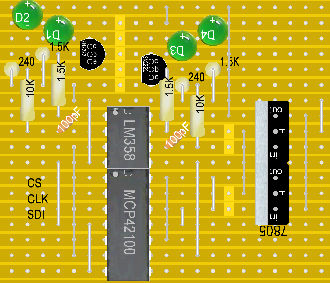

Together we will get rid of the motorized analog dual-potentiometer (which is imprecise, costs a lot, ...is an anachronism) and will replace it by a laser-trimmed dual digital MCP42100 potentiometer (being followed by a VCCS). 😛
The MCP42100 will give you 256 (!) wiper steps for both inline potentiometers!
I have attached two images of our current progress.
We are working hard on it!

This is great news Rudi! I have a proposal and a question. The proposal is to put also two switch to be able to adjust volume manually not only from remote control.
This digital pot will be like a retrofit module for the old preamps or will be a completely new version of preamp with relays and everything ?
Adrian: there will be no knobs neither switches on the front-panel of my SYMASYM's case! 😱
I like to sit in my armchair and do everything via remote-control!
The "new R_PRE-PCB" will no longer support an analog motorized potentiometer with Motor- H-bridge.
We have entered the 3rd millenium - didn't we?
Kind regards - Rudi_Ratlos
