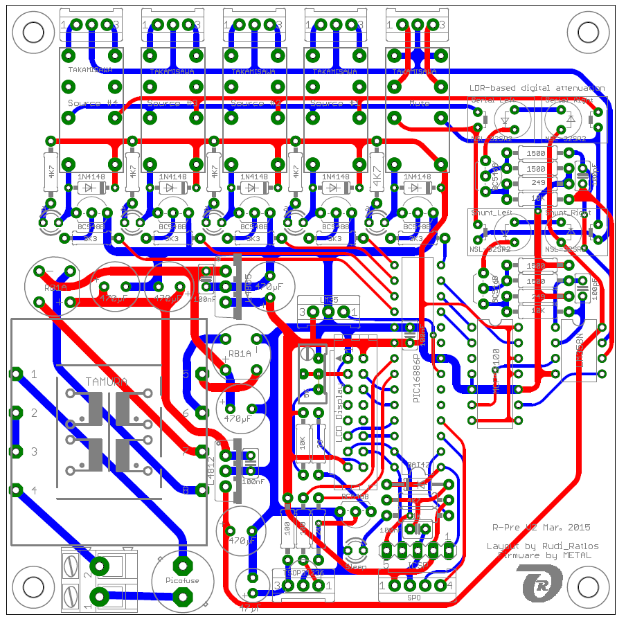

whilst METAL is busy programming the firmware for the digital-potentiometer MCP42100 being followed by a VCCS, I myself am layouting this passive RPRE_V2 (see attached image).
Let me once more summarize the capabilities of this small (100x100mm) PCB:
- Source selection (between 4 music-sources)
- LDR - based attenuation
- MUTE - function
- Temperature display
- Interface to Soft-Power-On / Mains-DC filter PCB (thereby switching on/off your amplifier)
- Every function can be done / will be displayed by a Remote Control Facility / LCD
Is there any function missing?
METAL and I know one another for a couple of years.
Together: we are a very strong DIY - team.
Best regards - Rudi_Ratlos
P.S.: I will need to do a couple of "cosmetic" changes to the layout, of course.
P.P.S.: My personal impression is: "Software" (like the one to implement the MCP42100) will play a major role in future, and it is best to get used to it right now. 😉

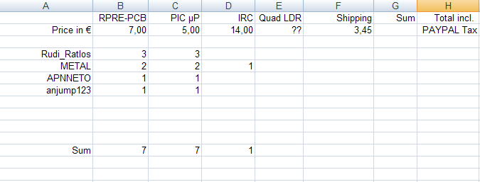

I have ordered 10 of the RPRE_V2 - PCBs (as shown in post #785) today.
The size of the PCB is 100x100mm.
I won't do a "big group-buy" this time, but will offer some "spare" PCBs and some of the needed parts in a "small group-buy".
Have a look at image 1.
I will keep 3 PCBs for myself, METAL will have 2.
So: there a 5 PCBs left that I want to offer.
The "small group-buy" will include:
- the RPRE_V2 - PCB; the price will be 7€
- a pre-programmed PIC µProcessor; the price will be 5€
- an Infrared Remote Control Unit, brand: SEKI-Grande; the price will be 13€
(if you already have a programmable IRC, I will tell you the system-address and command code, to which the µP's firmware is responding)
- a quad of well matched LDRs (I do not yet know, if I will match them myself or take an approriate offer)
The EXCEL-sheet shows APNNETO and ANJUMP123 having interest.
Please confirm!
So there are 3 PCBs left.
About the time-schedule:
I ordered the PCBs today, meaning that I will have them in about 3-4 weeks.
I will send 2 PCBs to METAL immediately.
Then METAL and I will begin to solder the PCB and implement and test the firmware.
After a thorough check of the firmware I will program the µPs.
So it will take about 7-8 weeks, until I will send you the ordered parts.
If you are interested (if you want to know more about the capabilities of the RPre-V2): tell me.

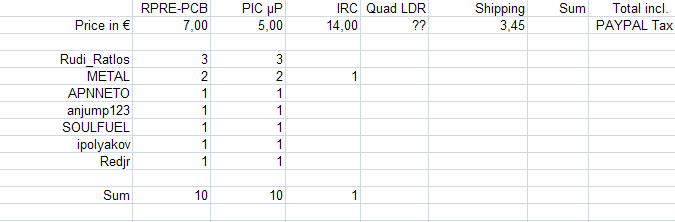

Gentlemen, all of the 10 PCBs that I have ordered are assigned (see attached image 1).
Please do not ask me anymore.

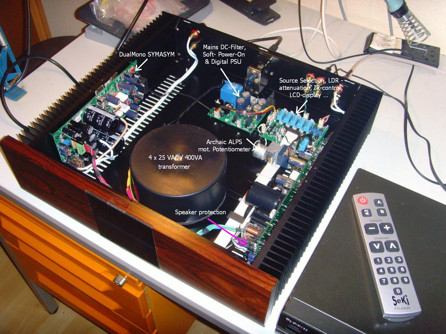

Rick: this PRE will be the perfect mate for your "BlackBeauty - SYMASYM" (see attached image 2 of my own SYMASYM).
The shown PRE (the current version) uses a motorized potentiometer.
The new, offered version will replace it by a digitally controlled potentiometer.
