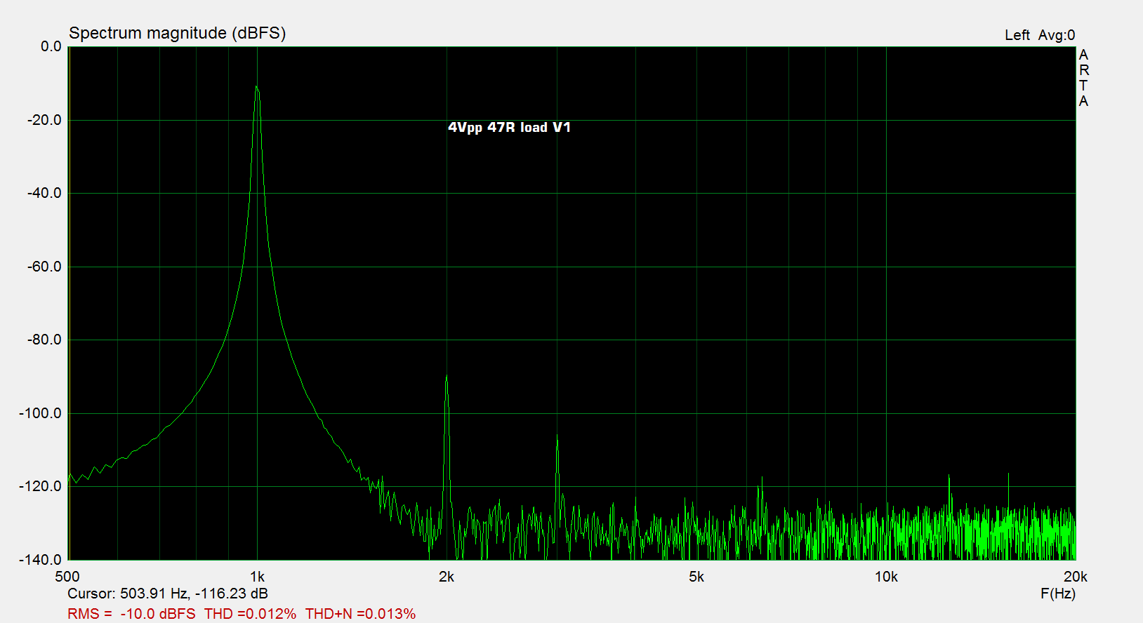

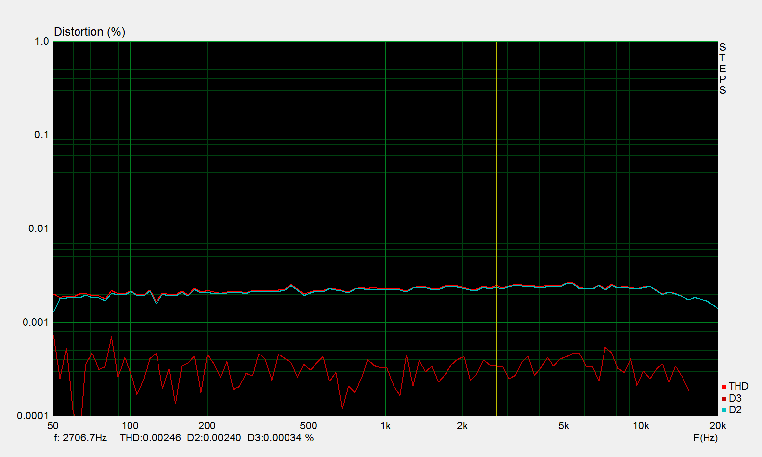

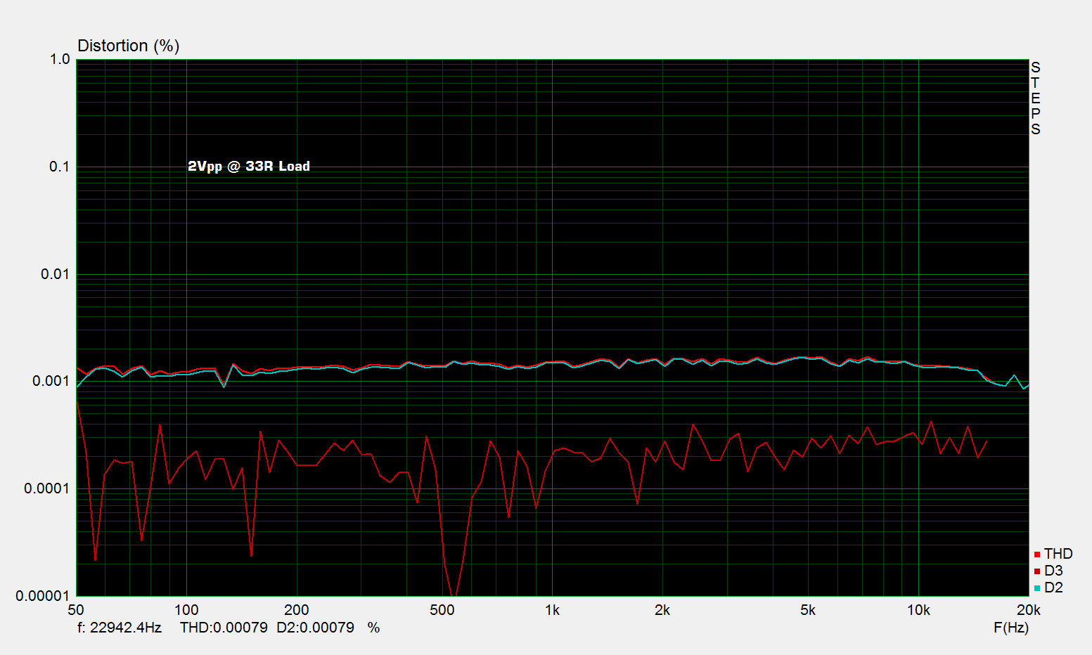

OK. I adapted the power supply rails voltage and the idle current for the headphone use and the measurements improved, as expected. These are the graphs for a 2Vpp amplitude at low 33R load - second harmonic predominant, no raise in distortion with frequency : Tonight I`ll do the listening.

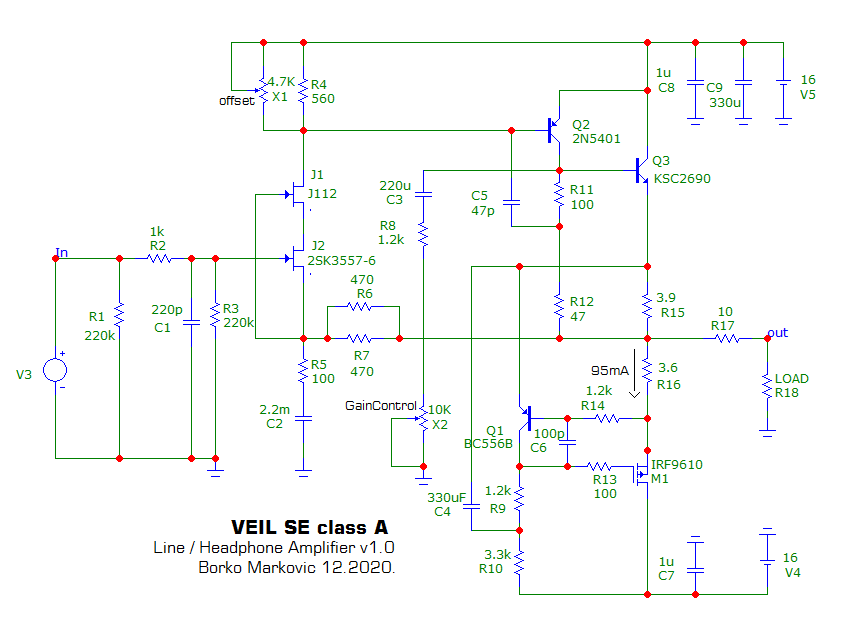

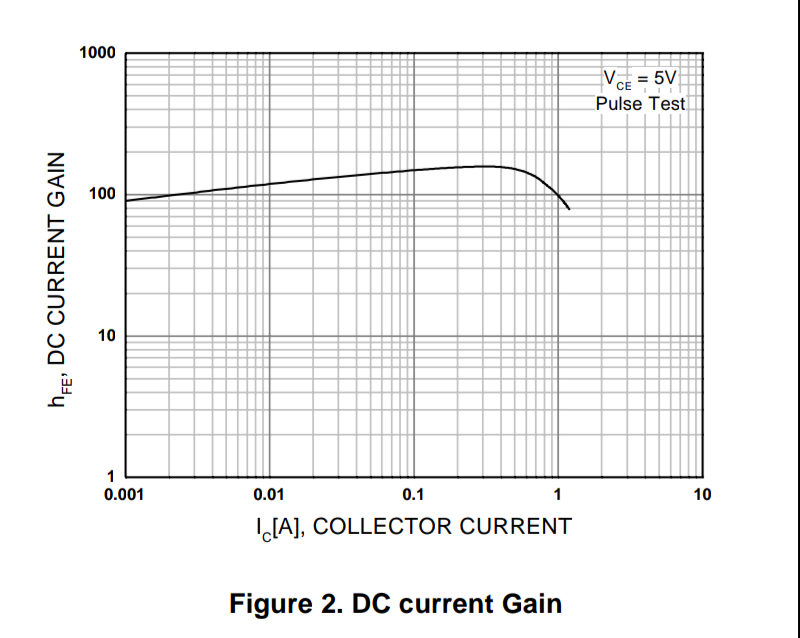

This looks great 😀. What transistor are you using for Q3? I see in the pic it's a TO-126 device. BD139?
Sorry, I mixed the marks.. 😁 I'm using KSC2690, KSC3503 is 100mA max. device and shouldn't be used for a headphone amplifier.
Btw, KSC2690 has interesting current gain characteristics, with new japanese devices is mostly flat line. On the graph you could see for KSC2690 the gain rises with current so it's kind of self compensating as I see it, higher the current, higher the gain.

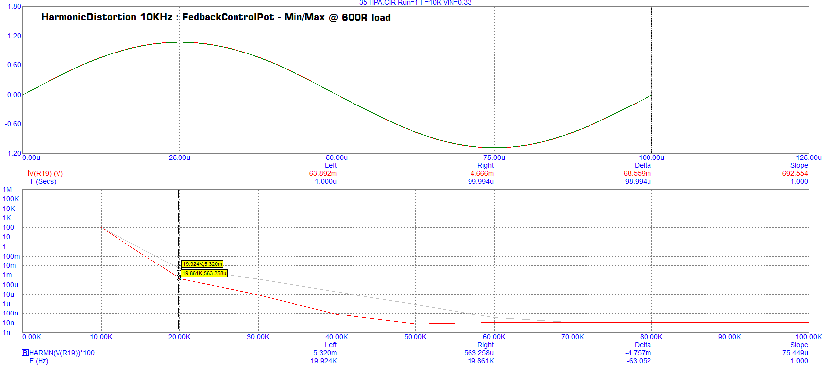

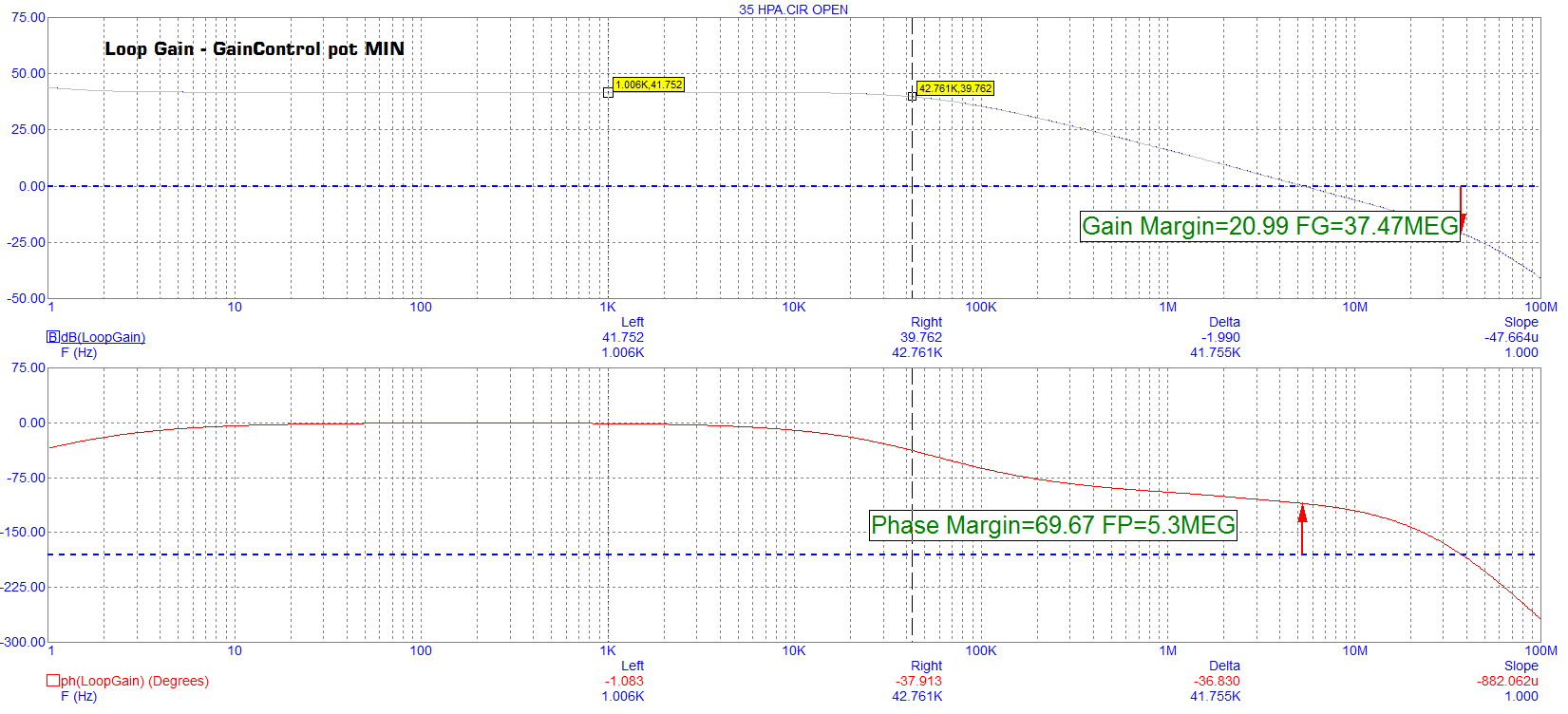

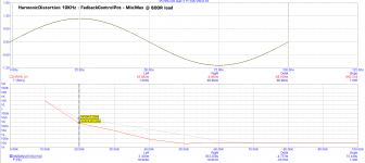

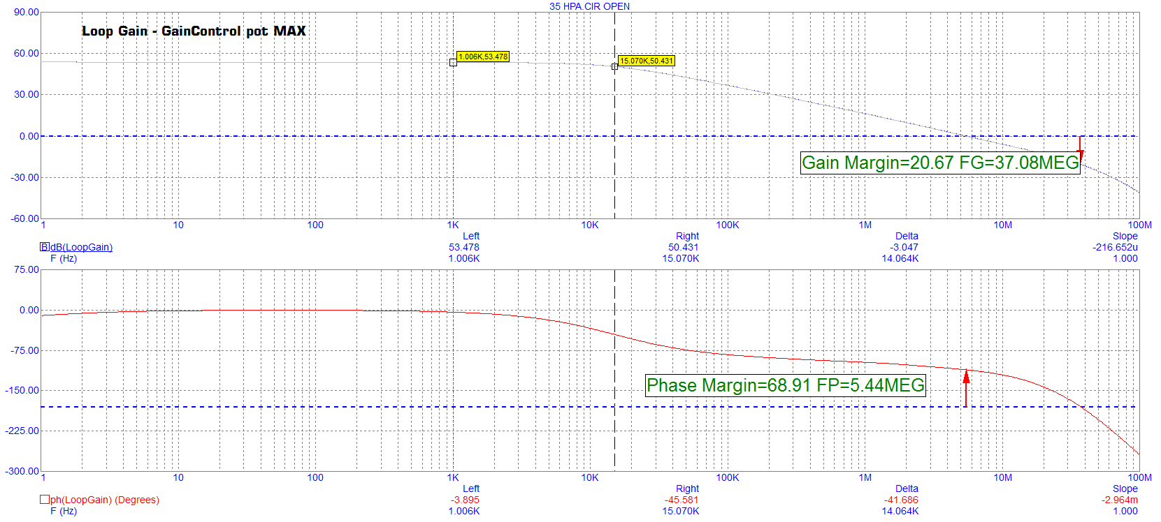

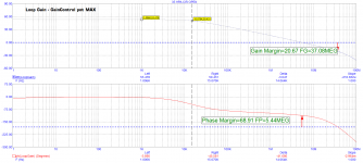

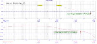

Something from the simulations, the following is FFT of 1Vpeak 10KHz at 600R load for FeedbackControlPot Min and Max positions and how it affects the loop gain. As you can see it`s adjusted to 10x ratio.

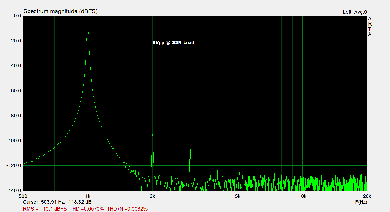

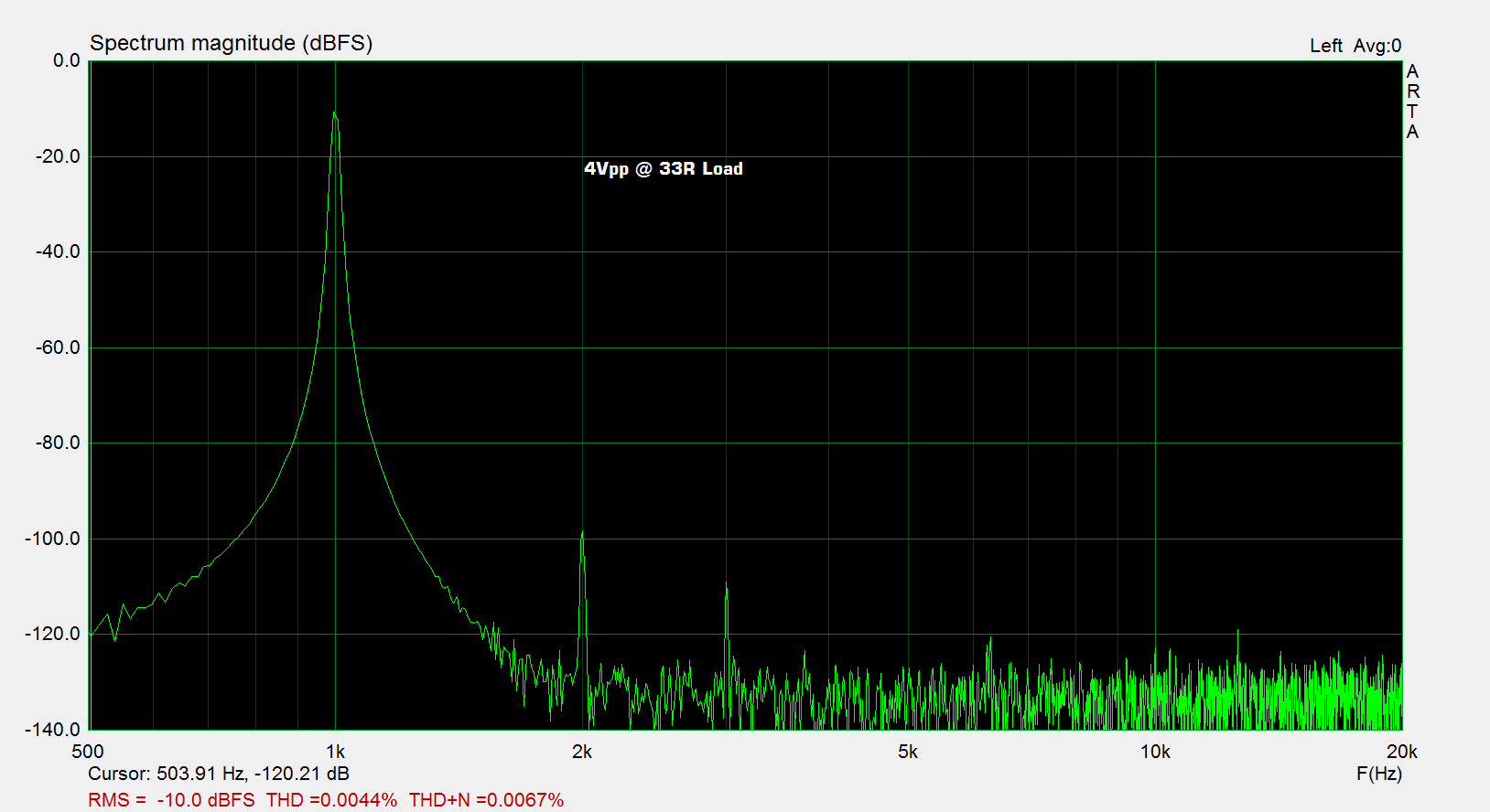

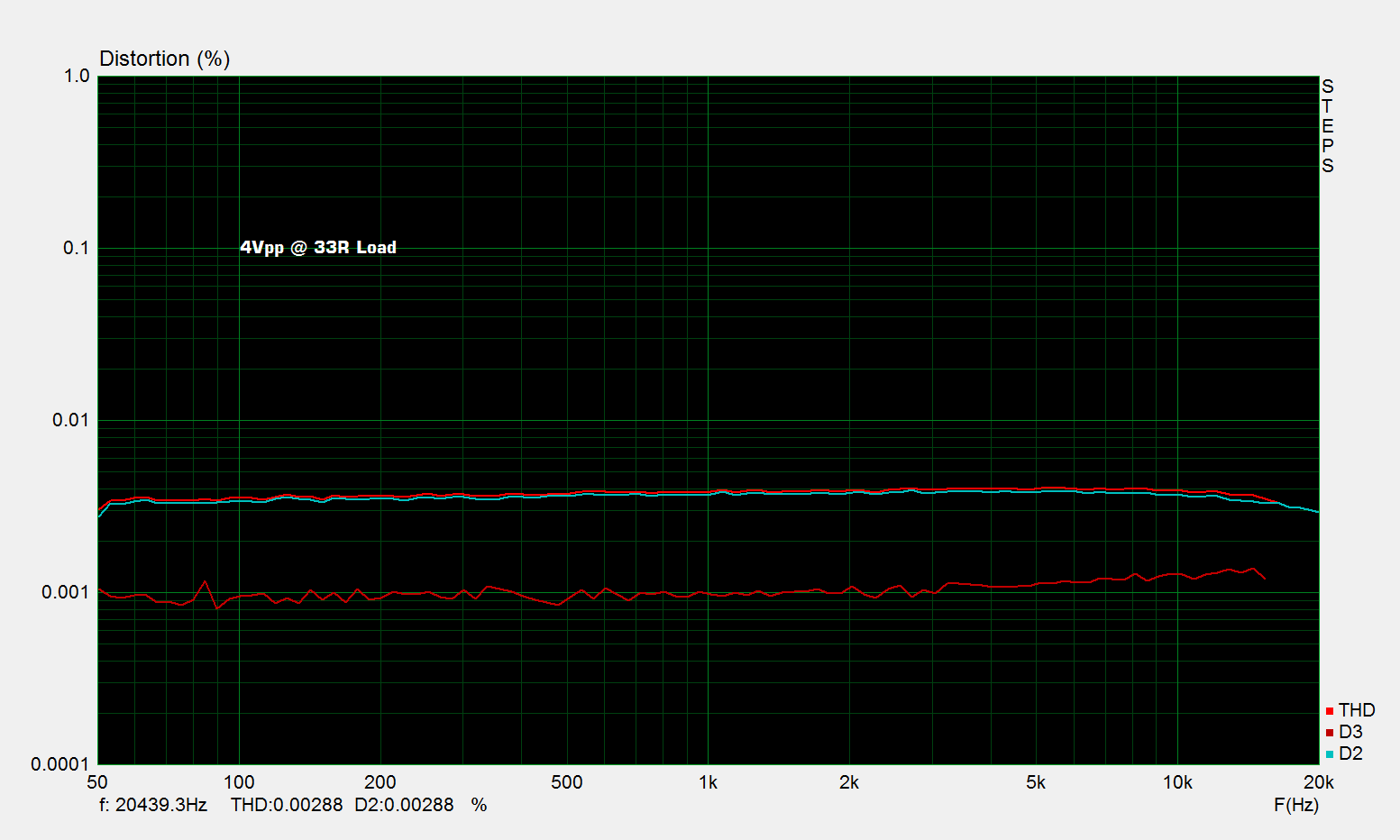

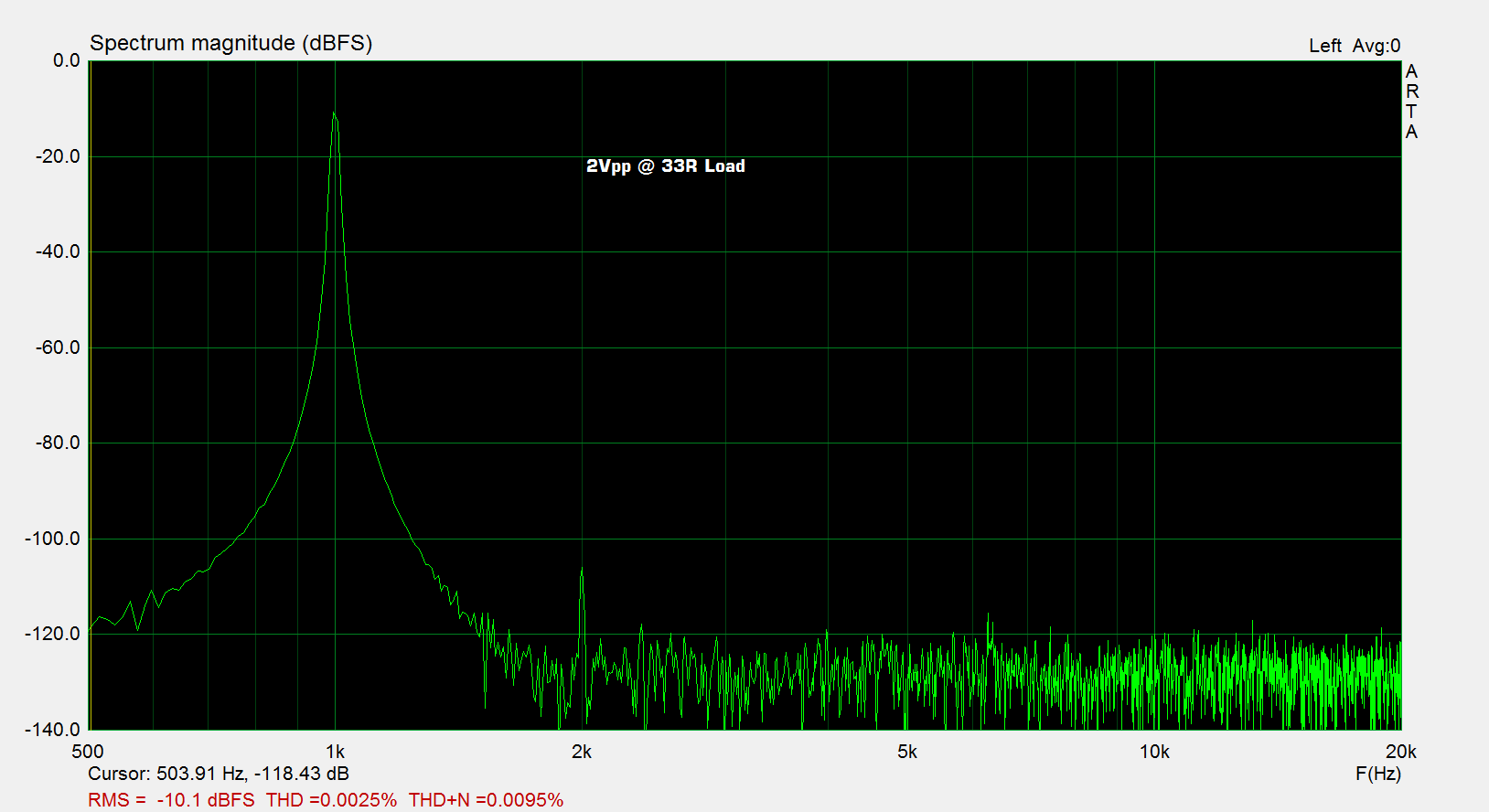

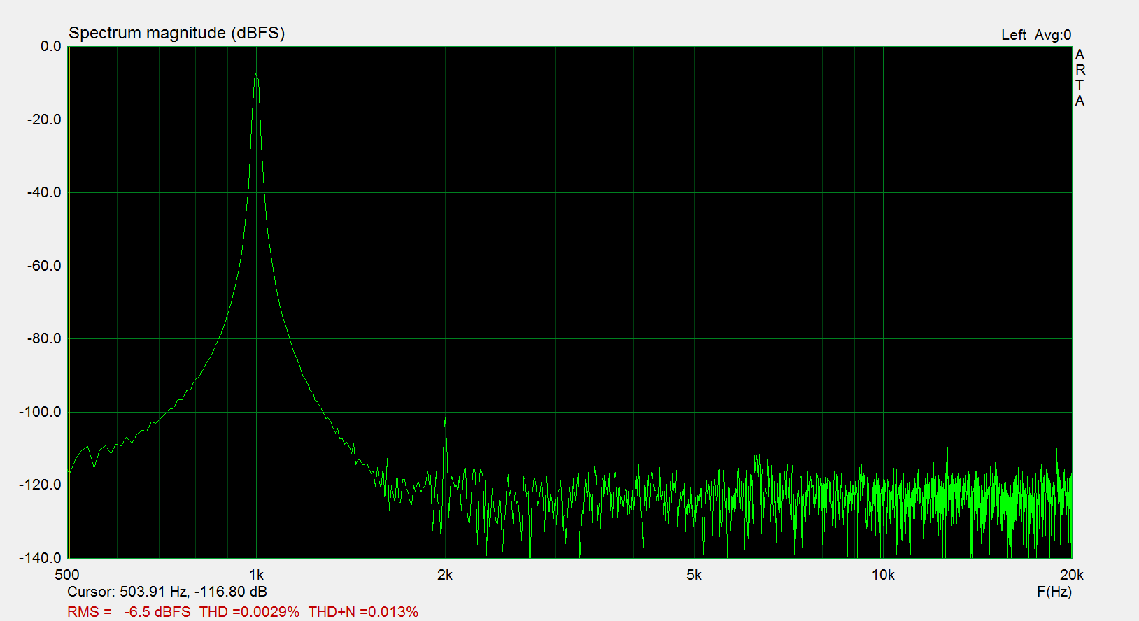

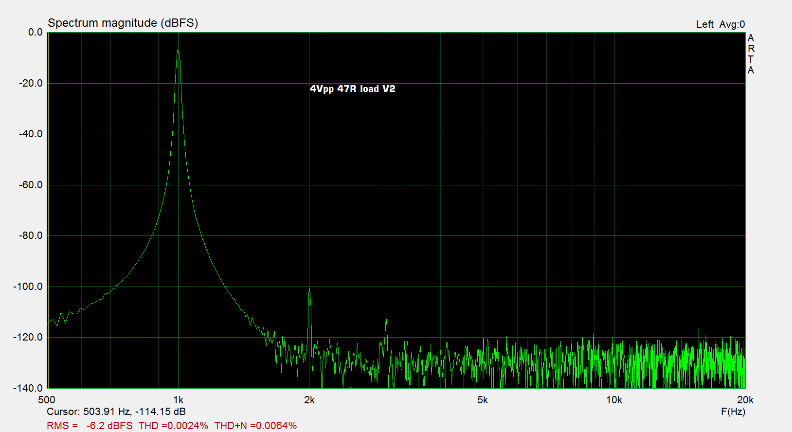

This is the new set of measurements for 33R load of the Version 2. These measurements are done with power supply configured to +/-15V and the bias is 83mA. With higher rails and higher idle current the results could be even better if needed. Tomorrow the PCB file will be ready. 😉
Cheers, Borko.

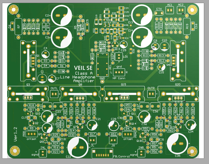

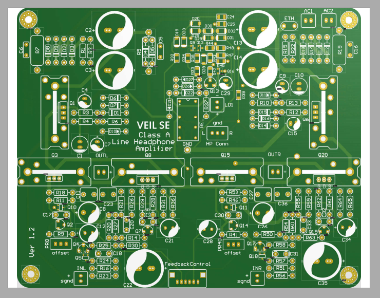

PCB File
This is the render of the finall PCB file. Anyone who wants to try it, send me an email in pm. PCB is two layer, 166 x 137mm.
Heatsinks are Ficher SK-104-25, for higher bias version, SK-104-38 or SK-104-50, should be used.
