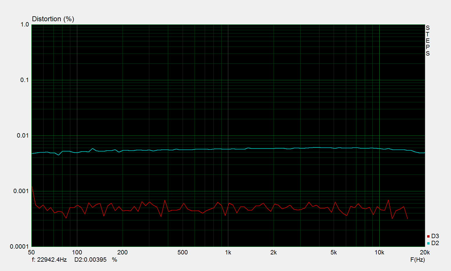

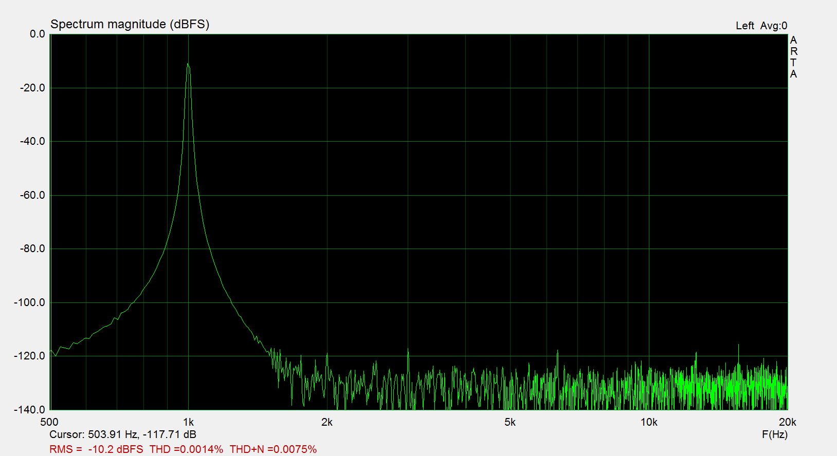

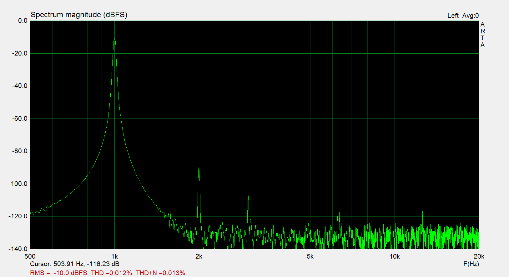

Thanks xrk971. Ok, for the measurement you want I neeed +/-24V rails to do it properly, but, for a quick test, near that range, this is measured with +/-21V rails and the amplitude is 36Vpp at 5K load. Btw to be able to do this measurement I had to raise the gain (lower value for R4-47R).
Btw the circuit is quite flexible and this configuration at the moment is probably not adequate for such requirement. Besides the power supply rails, idle current is about 65mA right now, so I guess lowering it, one could find the sweet spot, that would also benefit performance.
Never the less I think it preforms very well in terms of measurement for a such low part count, 2 stage amplifier...
Cheers, Borko.

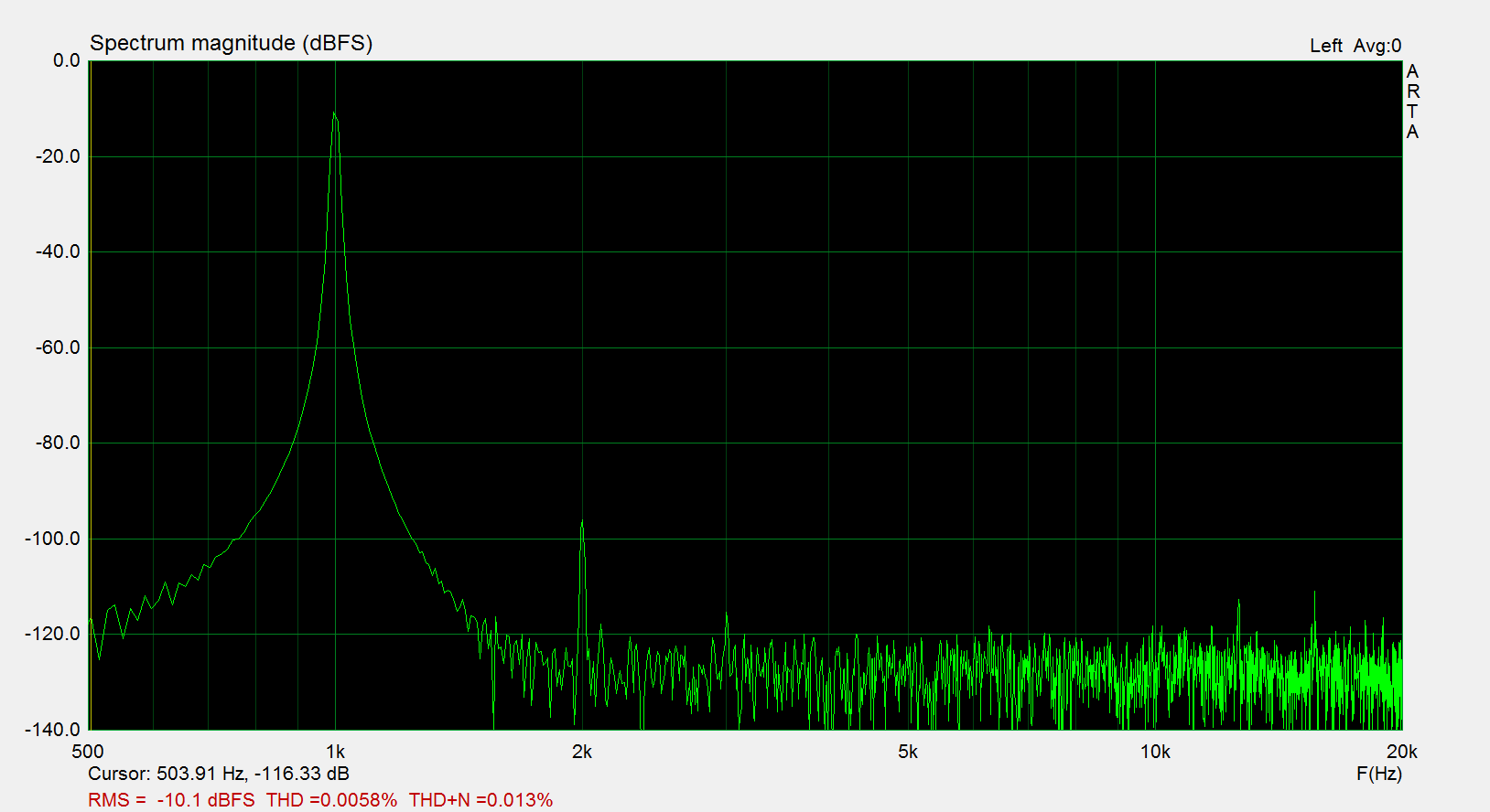

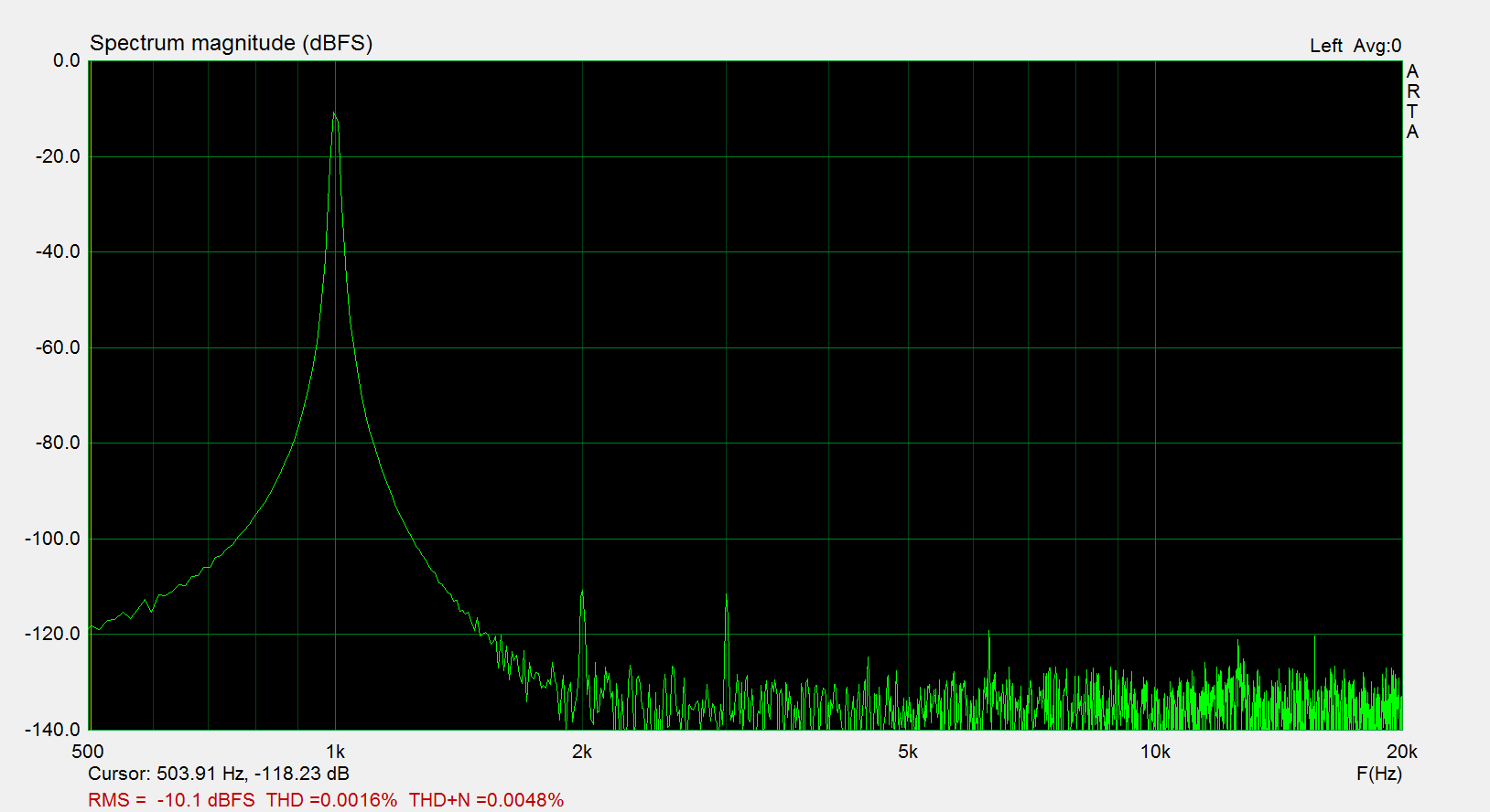

Thank you for running the test so quickly. That looks very good. I believe Hugh Dean’s Aksa Lender preamp’s output stage also has a CCS and BJT with a mu-follower. I found this to work very well at driving lower impedance loads while keeping distortion at reasonable levels. I am surprised that the H3 rose a bit above the H2 given that it is SE Class A and a singleton input stage. But still excellent looking result and very clean sounding I bet. Nice work!
H3 is begining to rise when gets close to rails (clippiing territory) it should be lower with little higher rail voltages. I guess the mu follower is helping in decreasing 2nd harmonic, due to the "push pull" operation and level of second harmonic is easily adjusted for the taste with the "feedback control" pot on the front panel (look at short video attached on the first page).
