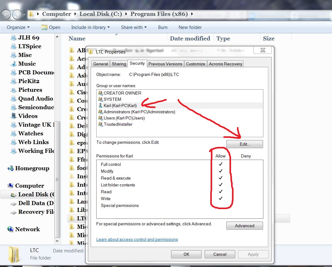

Maybe you can help me. Whenever I launch LTSpice directly from a folder by clicking on an .asc, I get an error message "There was a problem sending the command to the program". Yet, LTSpice launches withe the schematic but the error window remains. I tried a variety of things to no avail. (Windows 7.) Have you seen this?

Yes, there are a couple of problems with W7.
Easy one first. Clicking a .asc file brings up that message for me too. I always open files from within LTspice. Right click the empty workspace of LTSpice and select "open" and then browse for the file. I also save nothing to the LTC folder in program files but save all my work to a folder in documents. Its easier to keep tabs on everything doing that I find.
The other thing I had to do was alter the permissions for the LTC folder in program files. See the picture for how it should look.
Goto the folder 'C:\Program Files (x86)\LTC' (or the folder where LTSpice is installed).
Right-click on the folder 'LTC' and open properties.
On the tab Security press Edit
On permissions (the edit dialog) press Add.
Now add your name to the list.
When returned in the Permissions dialog select 'Full Control' (with your name high-lighted in the list of names)
It was FdW that put me on to that one... thanks 🙂
