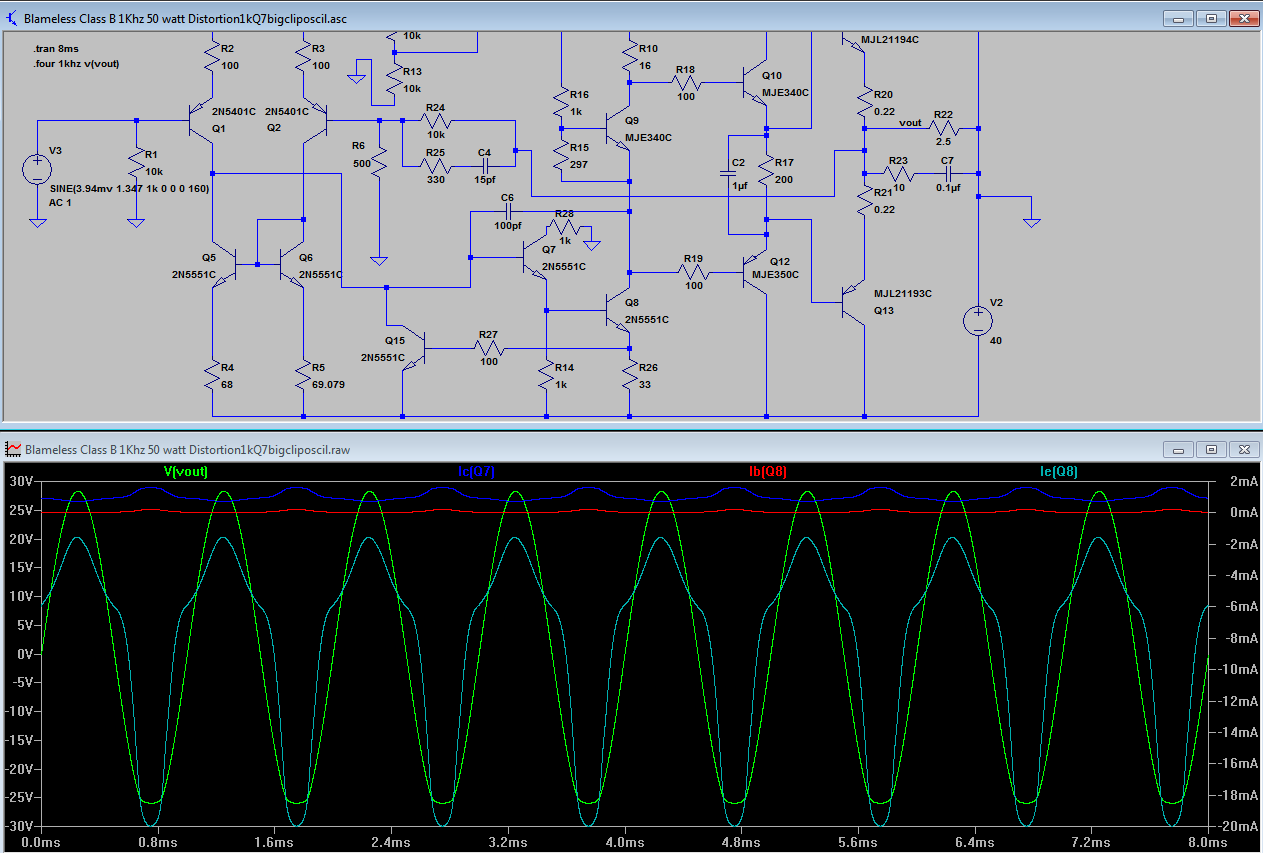

Hi Andrew can you post a .jpg of the oscillation. I don't see it when I run post 54
I'll try, I was successful a couple of years ago, but I'm on a different PC now.
Or
change the 8r0 load to 2r0 and then run.
probe Ic and Ib of Q8 and Ic of Q7
Pic left shows a zoomed in view of the protection oscillation
Pic right has the input voltage reduced from 1.6Vpk to 1.347Vpk, still feeding 2r5
There is very noticeable distortion in the -ve voltage output but the protection is not on and thus no oscillation.

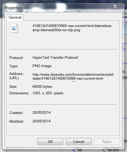

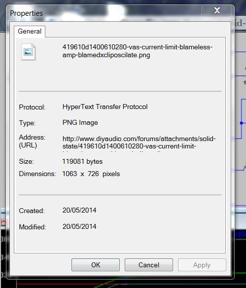

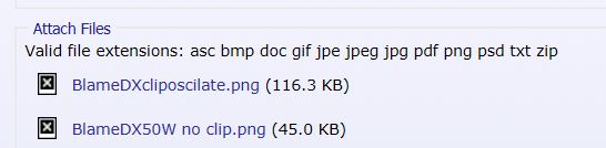

In turn by clicking each picture to its full size (and then right click it to see the properties)we have the left picture then the right picture. Finally the files as uploaded.
