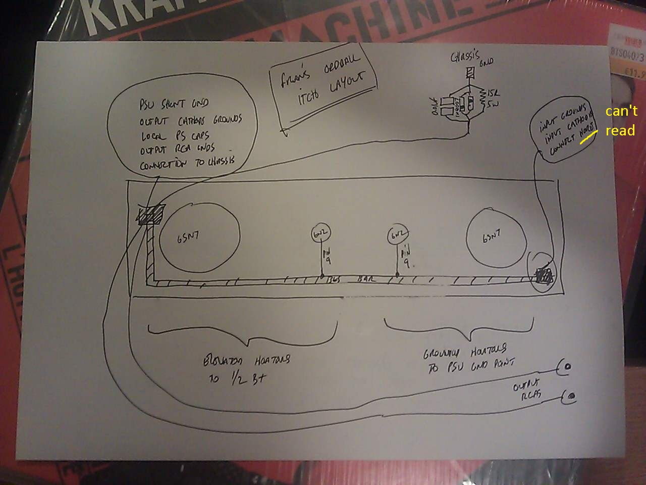

OK,
It was easier to sketch it than photograph. That would have meant turning it off..... 🙂
So bear in mind that the layout used here is most likely not ideal. I used it because it suited a case I already had (holes drilled etc). So I'm sure having the 4 valves nearer one another or laid out in a different way would be better.
So, the basic premise is that 1 long bar runs along the lenght of the 4 valves. Low current grounds (inputs and input valve cathodes) are connected right at one end. Next up along are all the RIAA grounds (close to the input grounds) and then right at the far end of the bar I have connected the PSU ground, output grounds, heater ground, connection to chassis and the output cathode grounds. The shields on the 2 x 6N2 are along the bar.
As I said, I'm sure there are better ways, but I now have very low hum.
http://www.diyaudio.com/forums/attachment.php?attachmentid=222297&stc=1&d=1304973716
Fran

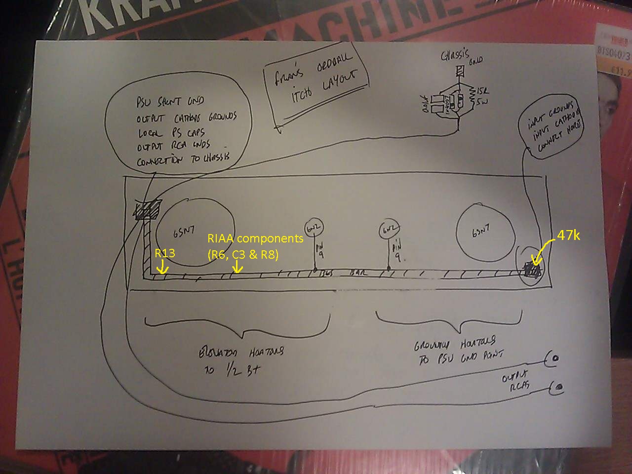

Thanks for pic Fran, I have several questions about grounding:
-Where do you connect 47K load resistor, togheter output cathode gnd & output RCA gnd?
-Where do you connect RIAA components (R6, C3 & R8), between 6N2 pin 9 and output cathode gnd & output RCA gnd ?
-Where do you connect R13, togheter output cathode gnd & output RCA gnd?
Felipe

Fran can't read, could you help me?
Maybe "connect here"? Wish I could help with the buss bar in general but this is very Fran specific to narrate.
Make sense thanks Salas.
"Input ground and input cathode connect here"
Bad handwriting I know!!! Sorry for that.
The general principle is that the lowest ground currents are off at one end of the buss, and progressively bigger ground currents are positioned up along the bar until the output cathodes, output RCA gnds, the shunt ground etc right at the opposite end.
Also, I used shielded wiring for the inputs, plus I followed that link posted earlier about tyng the RCA input grounds to the chassis via some cheap ceramic caps - IIRC this has to be done right at the entry, every few mm really matters.

Thanks Fran, more or less I understood your grounding way, was only to be sure.

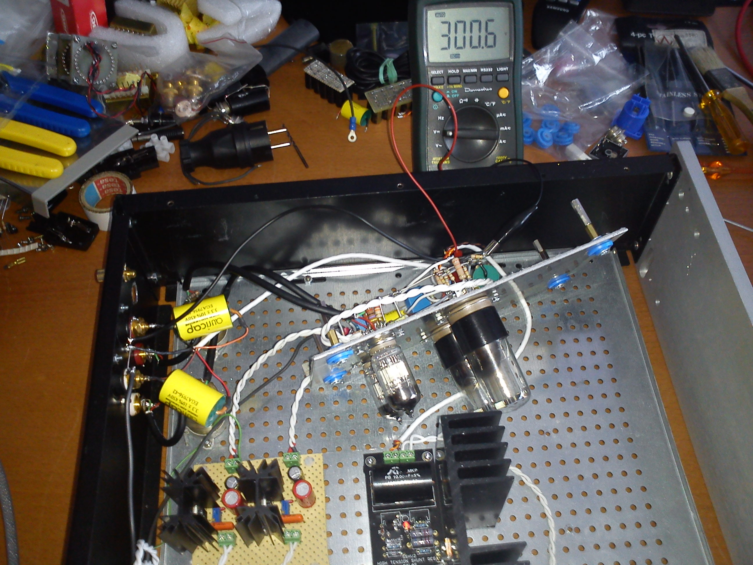

Yes, measurements:
B+ 300.4VDC
floating heaters 6.1VDC
elevated heaters 6.1VDC
B+ elevated heaters 121.9VDC
B+ 300.4VDC
