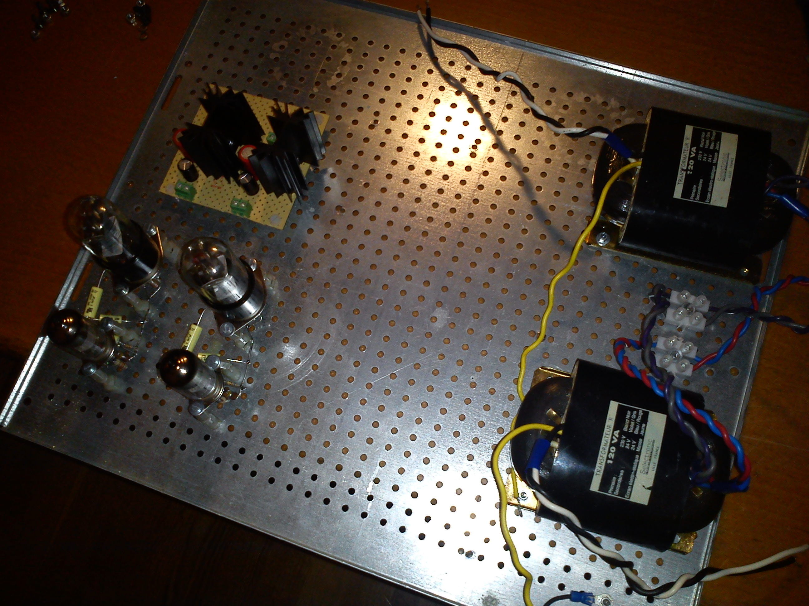

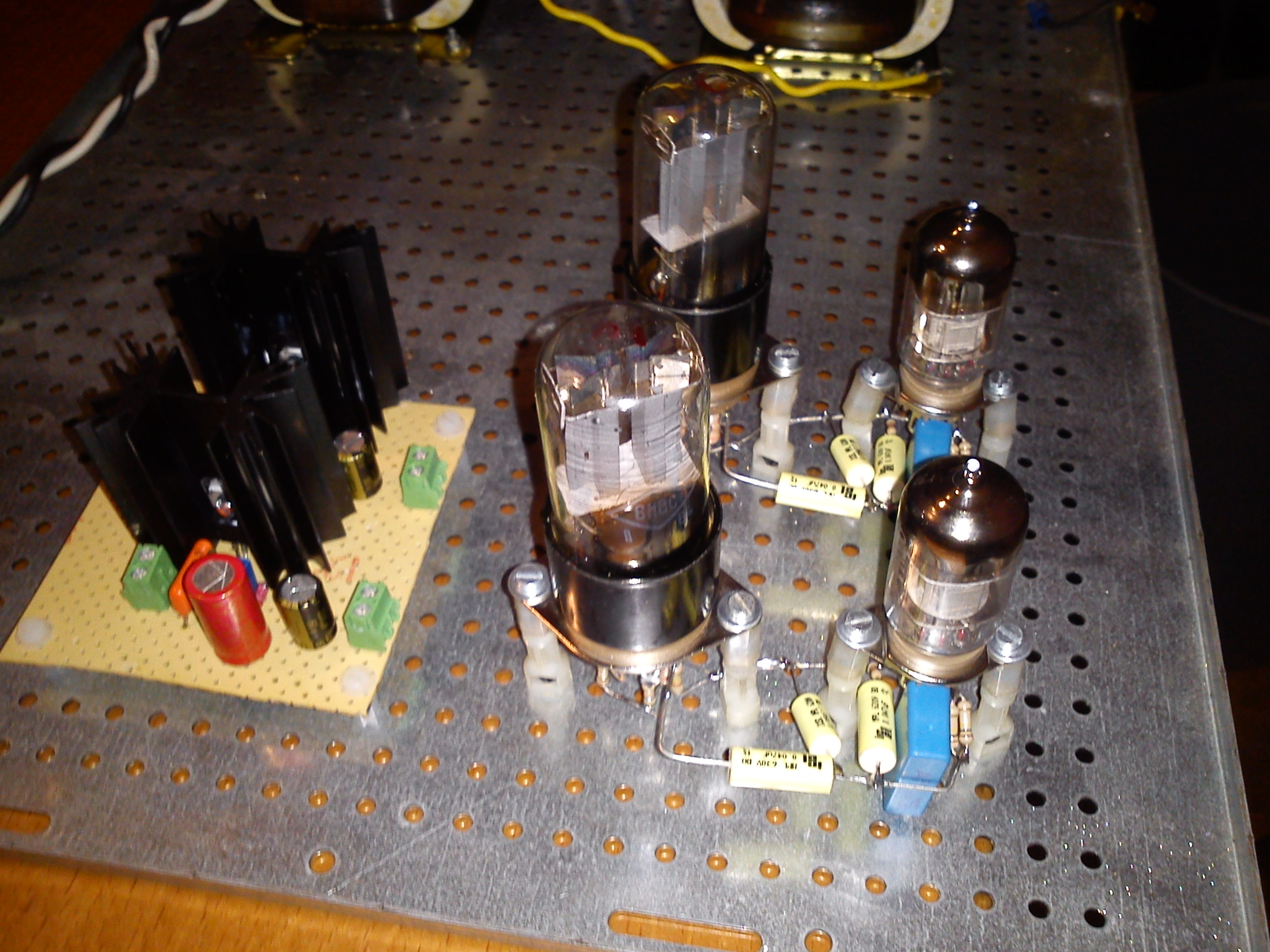

Herewith the final production photos. Taken a little while but works great.
Very neat looking and compact build, well done! Is that a copper top plate?
Looks like you used the same heatsinks on the LM317's as I did. I found they got a bit too hot for comfort inside the closed case in my build, so I doubled the size of them by making a small extension plate.
