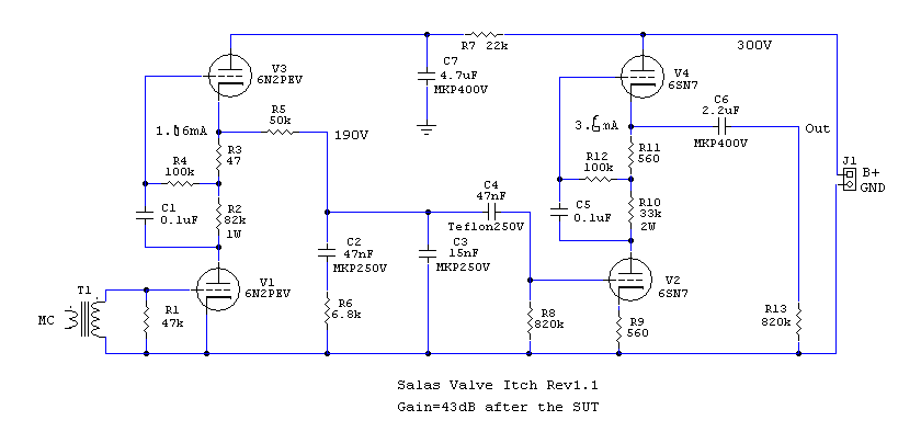

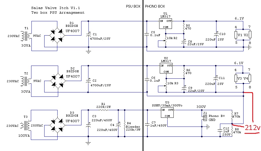

By "elevated cathode" you mean top triode's cathode, right? Still at 90V heater to cathode if so. What value resistors you use in the heater elevation divider? Maybe you could divide B+ to 150V heater elevation so to have better distance.
Must be load related, the values should still be the same between them for 1/2. Do you have 2 470K to parallel each one existing or 2 220K in their place? Should boost the now 122V reading I would expect.
Both 470K

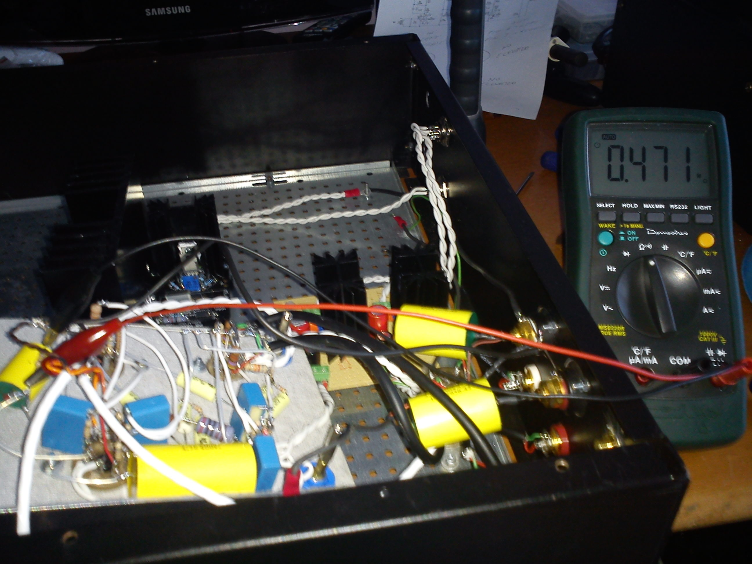

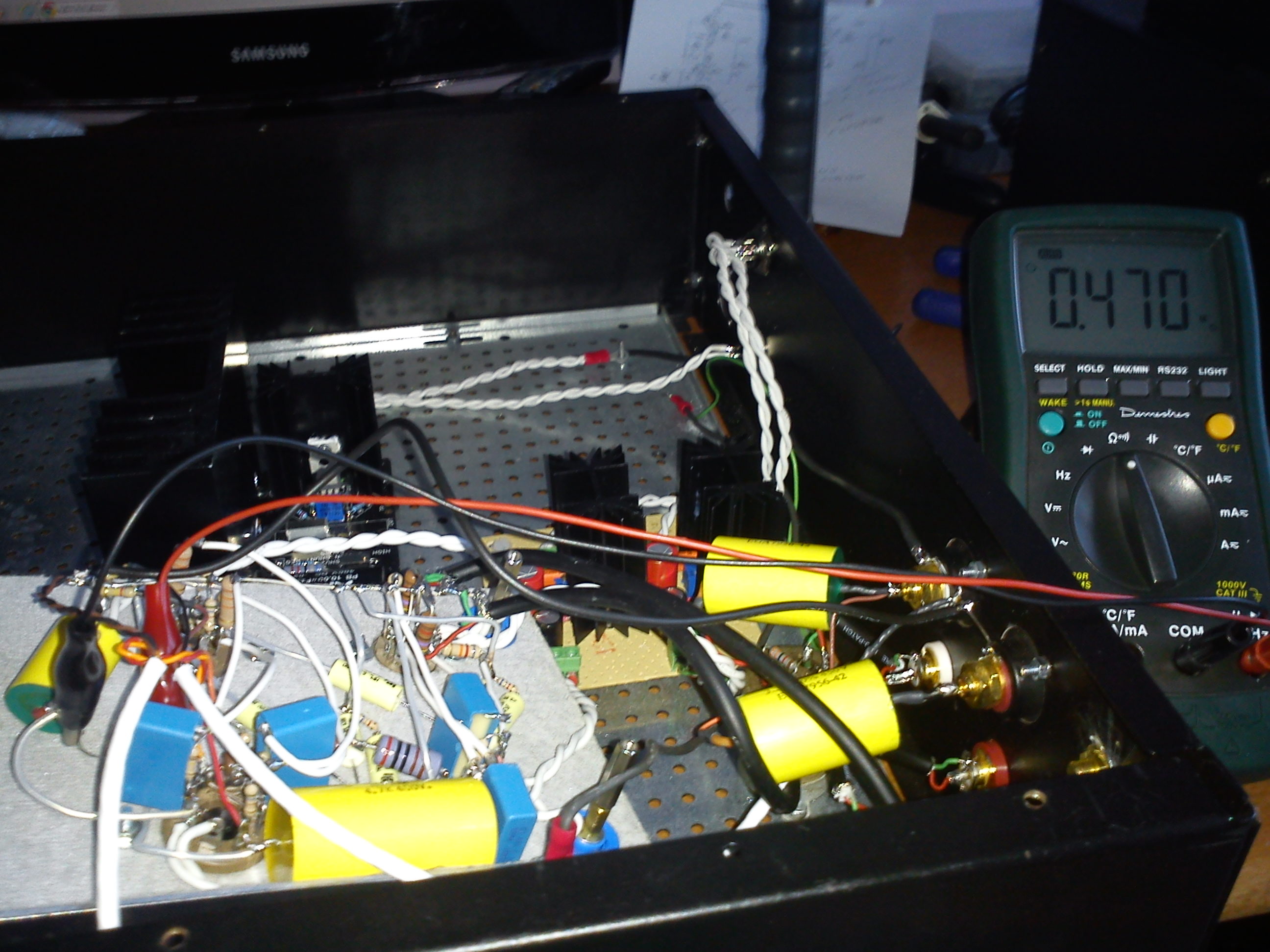

Voltages acros valves
V1 6N2PEV
triode pin 1-3 70.8V
triode pin 6-8 62.8V
V3 6N2PEV
triode pin 1-3 100.9V
triode pin 6-8 93.4V
V2 6SN7
triode pin 2-3 89.3V
triode pin 5-6 88.5V
V4 6SN7
triode pin 2-3 88.8V
triode pin 5-6 88.9V
