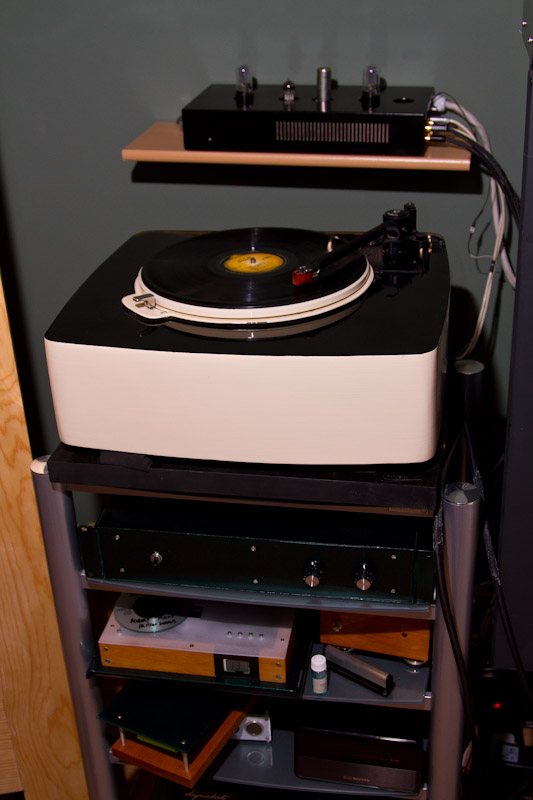

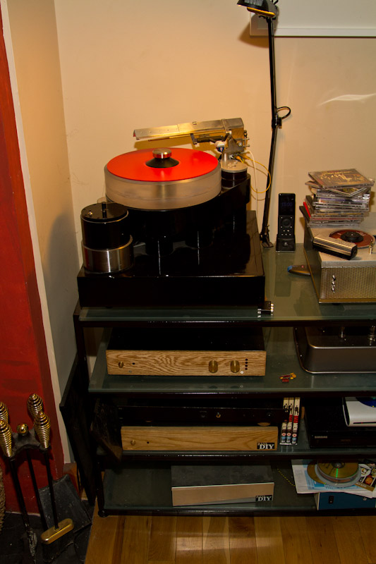

I will take better pics, because these ones are old now, but these are the quads:
And the lenco is below.
The other system is zyx R50> air bearing arm>teres 260 clone>pass pearl with lundahl step ups>DCB1 (some crazy greek guy!)>tubecad EL84 triode PP and sachiko horns.

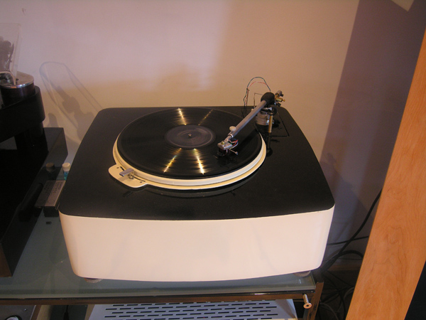

First pic shows the lenco arm and the itch in the background, second is the Teres with the air bearing arm (DCB1 is in the top oak fronted box underneath). The last one is the sachiko horn - adorned with the posters my daughter made to cheer jedward on in the Eurovision last night!!
