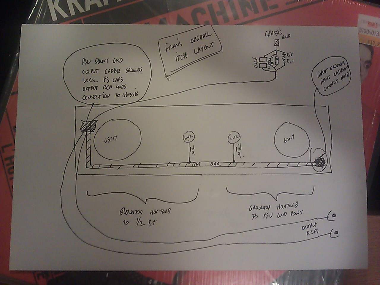

P.S. Any under the hood pictures will help people visualise what we talked about bus bar GND and fixing.

It was easier to sketch it than photograph. That would have meant turning it off..... 🙂
So bear in mind that the layout used here is most likely not ideal. I used it because it suited a case I already had (holes drilled etc). So I'm sure having the 4 valves nearer one another or laid out in a different way would be better.
So, the basic premise is that 1 long bar runs along the lenght of the 4 valves. Low current grounds (inputs and input valve cathodes) are connected right at one end. Next up along are all the RIAA grounds (close to the input grounds) and then right at the far end of the bar I have connected the PSU ground, output grounds, heater ground, connection to chassis and the output cathode grounds. The shields on the 2 x 6N2 are along the bar.
As I said, I'm sure there are better ways, but I now have very low hum.

Just to clear something up, from Salas' advise on bar grounding, I thought that the bar should only see chassis ground at the input end and power ground at the output end.
However, Fran's sketch shows chassis ground at the PSU grounded end. Naturally, Fran, if it sounds good, it is good. I just thought I'd make sure I hadn't missed something.
Tani.
On a bar we ground at the input side to chassis only, and we go from lighter to heavier currents in a row on it ending at PSU. Something must be mixing there most likely.
Tani.
From the linked article: ''You only want your buss to connect to chassis ground at one point, either at the power supply first filter cap or at the other end of the buss at the input jack. If you connect the buss to ground at the power supply, you will need to use an isolated input jack (run the shield connection over to the ground point of the cathode components of the first stage). Then you will need to add a 0.01uF capacitor (ceramic disk caps are good for this) from the shield terminal of the input jack directly to the chassis with the shortest possible wires. This will keep radio frequencies from getting into the amp.''
So it can work both ways depending on input sensitivity and PSU nodes distribution. I usually go to chassis input side. I use the small capacitors (MKT for me) from RCA rings to nearest chassis spot in phonos if I ground at the PSU end. I don't necessarily take the plastic spacers out if I ground input side, I chassis ground the bar on a screw and nut near the inputs and link them RCA rings there too. By ''only'' I mean chassis link at one point.

I went back and rewired the inputs and outputs and input 6n2 cathodes to ground with shielded cabke. Like in the articke, I then took a 0.01uf cap from each input jack plus the shields to the chassis right at the input jacks. Interestingly, I first tried running a short piece of wire from the 3 caps to the ground point, this was about 50mm long. Result was buzz, at low level but still there. Cutting the wire short and tying to the chassis closer made all the difference.
So now that done its dead quiet. Listening now for a little while and then try the k42y coupling caps.
