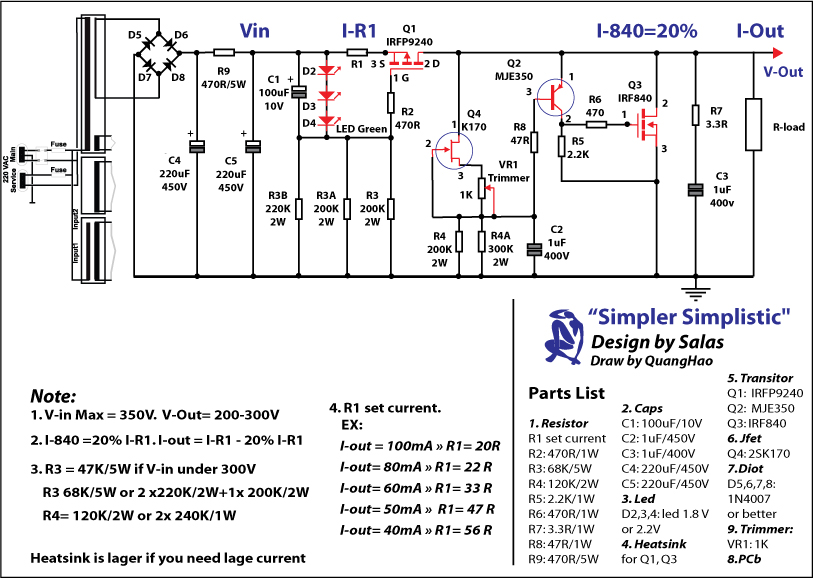

Well, I got the new transformer today and hooked it up. Unfortunately, when I was testing it on the bench, I shorted the HV supply and managed to let out some smoke from the HV shunt 🙁
The current set resistor blew (47R). Replaced that and it all powered back up OK.... but.... there is a difference. When I turn off the power, the 3 LEDs now go out immediately. Before they would take some time to dim down. Also, now I have a nasty buzz when I hook it up to the stereo.
The circuit I followed is this one: quanghao SSHV also here:
So in that sch, R1 blew, and I also replaced C1, the cap at the LEDs. I've checked most of the resistors and they all seem OK. The circuit still regulates, heatsink still gets warm as before and voltage slowly climbs as heatsink gets hotter until it settles.
Any ideas?

Ah, I'm afraid nothing much to report tonight. I've made a bit of a balls of the shunt. I replaced Q1 - but when I powered it back up I got no regulation at all. So I ended up replacing the MJE350 and the SK170 with no joy. I think at this stage I might just start from scratch and rebuild the whole thing. I still need to check the diodes too.....

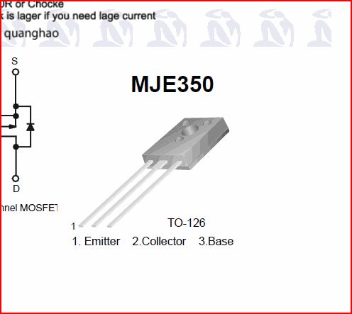

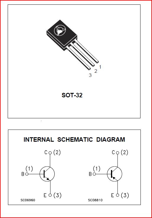

I wonder if someone would double check me here. I'm confused about the pin out of the mje350...
See here: the first one is from the mouser datasheet for the part I bought:
http://www.diyaudio.com/forums/attachment.php?attachmentid=222014&stc=1&d=1304811857
The second is from the SSHV DVB-projekt wiki page:
http://www.diyaudio.com/forums/attachment.php?attachmentid=222015&stc=1&d=1304811917
So, looking at the front of the MJE350, plastic facing you, metal piece to the back, legs are numbered 1-3 L to R and you have E, C, B.... correct?

Correct.
So I got the shunt rebuilt today and have it working OK again. FWIW, I rebuilt it using your the schematic linked back in this thread (i.e. the Salas one, not the Quanghao one).
But....I still have hum at an unacceptable level. I'm pretty much convinced that this is PS related because when I turn off the PS the hum dies instantly even though the phonostage stays playing for a while (lifting the earth makes no difference). I've checked the diodes on the HT - all check out ok. Looking back at the PS, I dropped the filtering on the first CRC to 100R (from 470). I wonder if thats coming back to bite me now.
