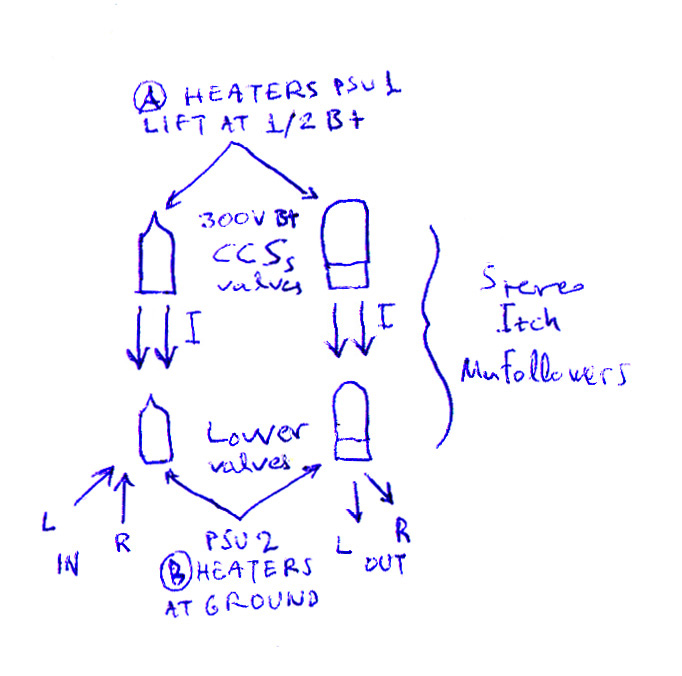

I have a simple question as a new-comer to valve work, that I was not able to answer clearly through research. It relates to the valve sections and the relative envelopes that each one resides in. As far as my knowledge takes me, it is customary to use one valve envelope for two valve elements in a given channel. In the case of the Itch, the two valves in the input section (2x 6N2PEV) would reside in the one bottle. However, I think that this is not correct for the Itch as the voltage potential between the two valve sections is not safe to have within the one envelope... hence why the heater voltages must be referenced differently. Assuming this is the case, then the "upper tier" 6N2PEV of each L & R channels would be in one physical valve, as would the "lower tier" input valves of each channel... similarly for the upper and lower output valves.
Could someone please clarify which valve sections in the schematic can share the one valve bottle? If what I have described above is correct, can this influence crosstalk performance, or does the dividing grid in the 6N2PEV take care of this?

Thanks Salas,
That's what I thought. I'm thinking about layout at this stage so I figured I'd clear it up now as it could make a difference as to where I decide to place the inputs/outputs and so on.

2 x regulated supplies, one reg for the upper 6N8 + 6N2 wired in series, same for the lower.
I had plenty of spare 15VAC transformers to use... so went for the heaters in series.

Don't know about series heaters, wasn't tested that way. Still those two tube types draw about same currents, hope they will share well. You lifted the upper bootstrap CCS valves of the mu follower totem as prescribed? Nice collection of listening stuff, especially the stacked Quads, you will have good discrimination of tone so to tune up parts, Riaa values, etc.
Sure, I know its a risk. I have read (only once) where someone said it didn't suit 6SN7 types - but broskie says no problem, plus I have used it in the aikido with no noise issues. We will see soon enough....
Heaters for upper pair will sit about 80V off gnd. Actual circuit is exactly as per itch rev1, heater supplies - exactly as per, except I don't have cap on the output of the regs yet (only 1.0uF PP), HV shunt is done as mentioned previously.

The schematic Rev1 asks 1/2B+. So you need to divide near to 150V heater lift. The upper cathodes are at around 200V elevation. 80V isn't enough to bring the heaters in less than 100V distance to cathodes as the tubes spec asks.
