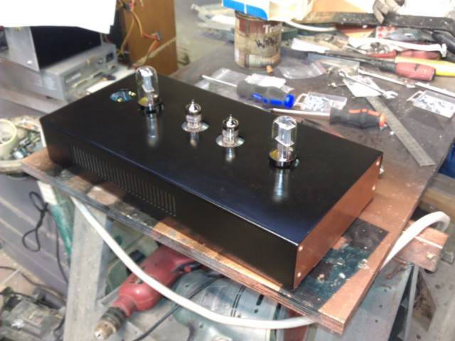

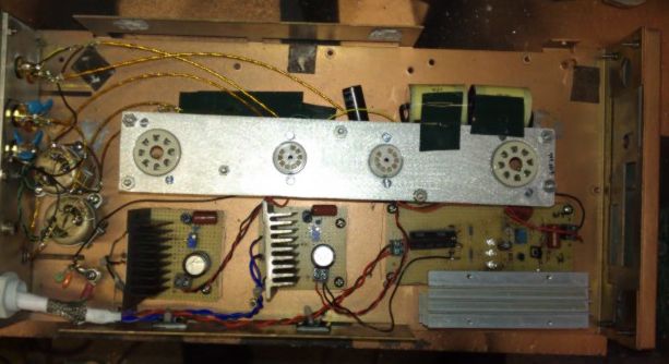

finally some pics:
http://www.diyaudio.com/forums/attachment.php?attachmentid=222883&stc=1&d=1305409449
You can see the shunt and the 2 heater regs, and then the platform that holsd the valves. At the rear you can see the input transformers.
http://www.diyaudio.com/forums/attachment.php?attachmentid=222884&stc=1&d=1305409449
One more interesting thing. The left hand 6N2 in that pic is the input valve. if I put my fingers around it, I get an increased/decreased hum - doesn't happen with any of the other valves. I put a valve shield over it and get the same effect - if I push the shield down so it contacts the chassis the hum drops away. Its not an issue really - I won't be listening with my hand around the input valve! But if you are building this and have some bases that can take shields, it might be worth using one for this valve.
Anyway - I've easily played 20 albums today since powering up and it seems very stable!! What a nice way to spend most of a day... and beats the Eurovision any day!!
