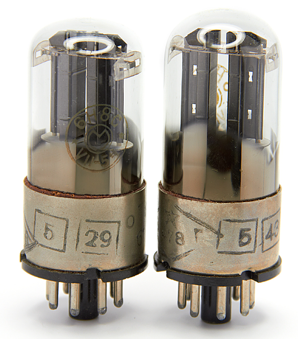

You will like to try 6N2P-EV bcs of its low leakage & microphony, and 6N8S FOTON or MELZ bcs of their being the Russian Sylvanias & Bendixes of yore.

I don't know about the 6N8S - I don't know what factory my ones came from - there aren't any marks on the tubes, bar the "6H8C" and "8706". Maybe the "8706" is a date code june 1987?
On the base (phenolic) there is a diamond with a "0" and a triangle with a "1" in it. Getter is in a small cup at the bottom of the tube, and the plates are grey. Came in boxes like the ones shown here:

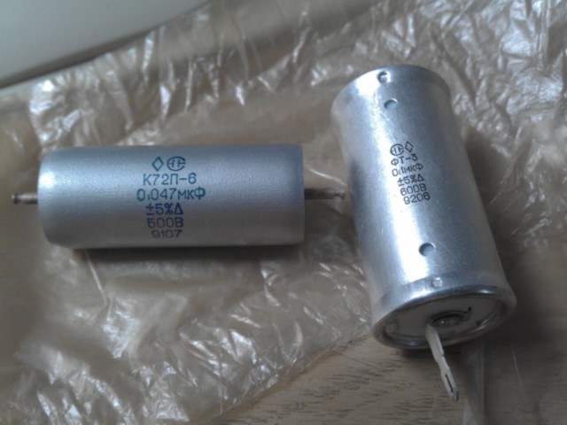

After a bit of waiting, the russian caps arrived today. I have FT3 0.1uF and K72Y 0.047uf ones to try out.....
Salas, I think you were recommending the K72Y, correct?

I know K72 as Teflon. But as P-6 or -11. Can I see a pic of the K72y? I recommended the k72 0.047uF as inter-stage coupler and the FT-3 as a bypass to the main output coupler. They do combine very well with K75-10 hybrid green as main IMHO. But its worth a try to bypass whatever you got as output cap with the FT-3 anyway. There are enough types they marry well, some not of course. If you will find the K72 0.047uF objectionable, you can save the FT-3 for testing as inter-stage too, they have different signatures. Do ground their metal cans when used as inter-stage (both types).
Yes, sorry, my mistake, they are K72 P6. I also bought some MGBO types to try on the outputs. I've attached a few pics below. I used the MGBO on my pass ono to great effect, so thought it would be worth trying them on the outputs of the valve itch too. I bypassed them in the ono with some wima fkp, but on the pass forum Zen Mod recommended using some MKC for bypasses. So I have some of those as well.
So, first up will be the K72P-6 0.047uF for interstage. Then I'll try the MGBO with either FT-3 or MKC on the outputs. Of course all this is for a phonostage which is already top notch, so I do ask myself why am i even doing it!!? 🙂

Interstage teflons in place and they add clarity alright - not huge, but there. It doesn't seem to have affected the sound - and the soundstage is still there. I've only had 2 short listens since I put them in though.....
