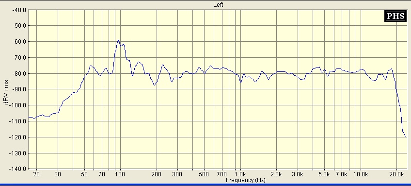

*I checked again my listening position RTA for my PC desktop spkrs the other day. Beyond a room mode from the sub, its balanced enough. Can't hear the 100Hz nowhere as heavy as it looks, you know with subs it takes a room average to see better.
