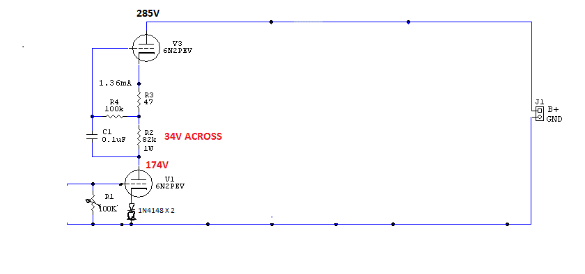

I got two remote controls IR LEDs one measures 1.07V and the other 1.09V with my DVM

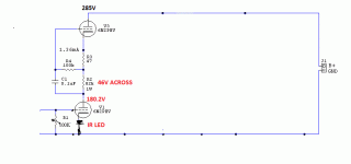

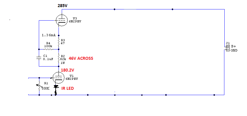

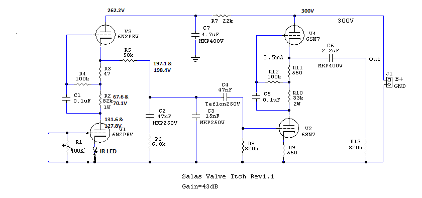

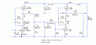

Measurements with IR LED in place 1N4148 x 2
Both measurements with IR LED!!!!
