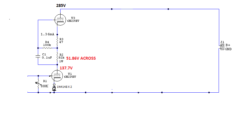

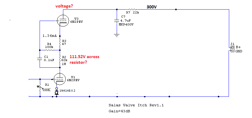

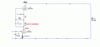

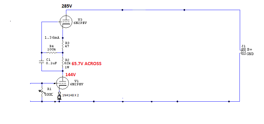

Salas before changing for E283CC I want to check in the real schematic if the E283CC tubes are good, attached schematic.
TIA
Felipe
I measured E283CC cathodes pins 1 & 6 to center tap heater pin 7 and is open circuit so looks good, also I measured heaters 4 to 5 and measures both tubes 3 ohm, is right? I ask because I have other 12AX7 brands:
JJ 10R5 I have only 1 tube
Groove tubes 9R5-10R
Sovtek 17-18R
6N2P-EV 7R-8R rocket logo
Sovtek HQ 32R-34R
RSD 12R5-13R5
Siemens states 313-347mA heater current in its manual so the tubes are good. The current in the stage looks normal like 0.63-0.80mA. Try with IR Led too instead of 2Xdiode to see if the bottom readings will match voltages better.
