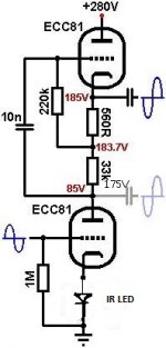

Salas could I do the IR LED mod to the ECC81 mu-follower (attached schematic)?
You should measure the voltage drop across the resistor you want to substitute with IR Led. If it is compatible with the amount of Vf one or more IRs can give you, you change. Be aware that while it is not out of concept in the Itch, when for higher bias and voltage swings in different stages a resistor may still be preferable. As it follows the bias and aging of tubes better. So don't think it will necessarily perform better. Maybe worse. It depends.
